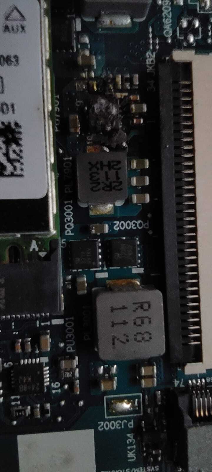

    Hello how are you?
    Did you find if there is any problem with this change??... because there is a lot of difference in cost. I have one with short circuit and it cannot be rapaired , that is why i am also looking for a new motherboard.
    I hope can you help me , thanks 😄😄😄😄

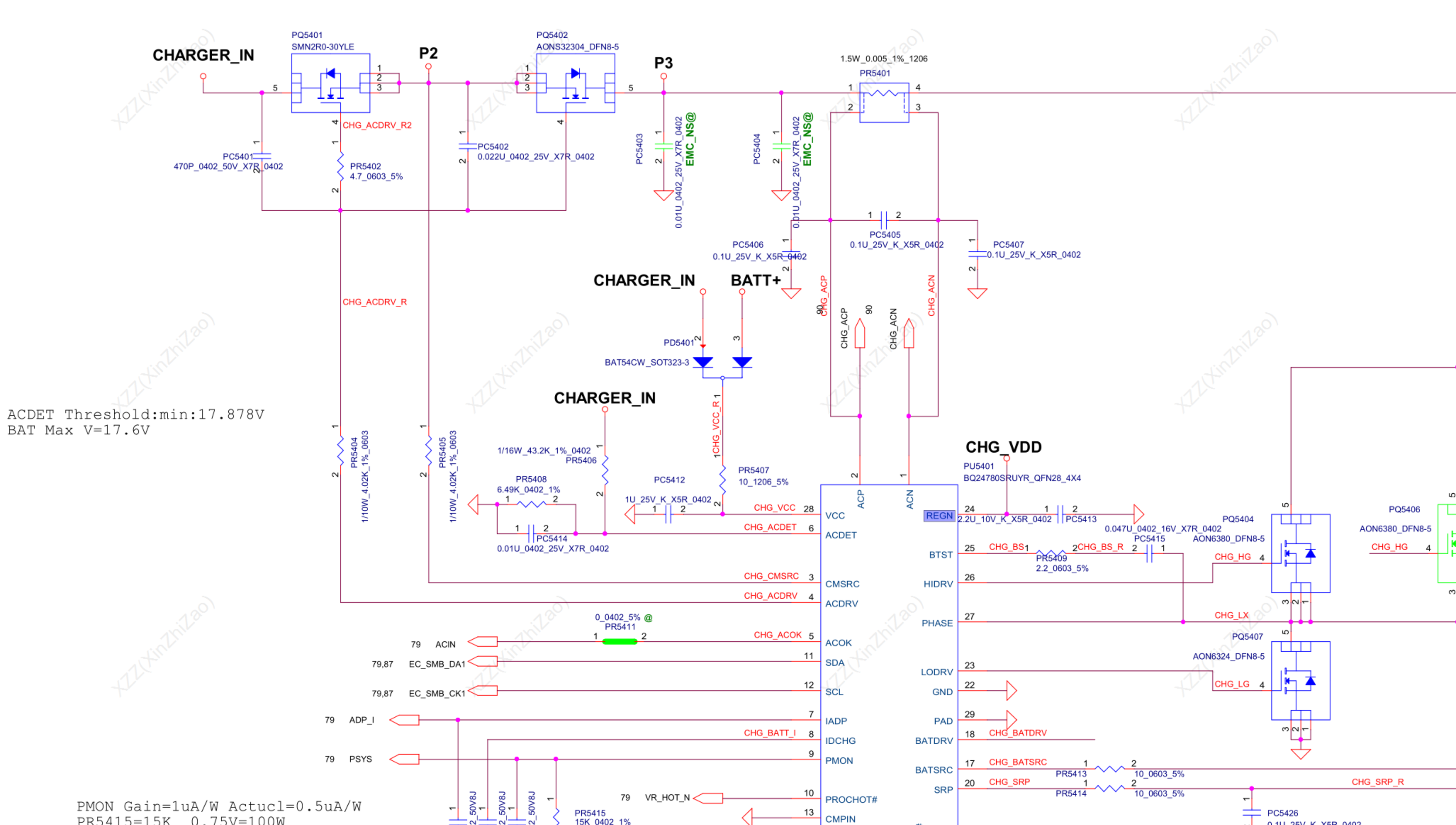

      What is the problem with the board? It will not power on? Can you link the schematics? (only if they are in the dedicated schematic forum on this website)
      Measure the voltage to ground of the DCin mosfets @ PQ5401 / PQ5402. Measure the voltage to ground of the source (1-2-3); gate (4); drain (5-6-7-8) pins.
      If the voltage at the start of this power path is not the same as the adapter voltage, then the fault is before this charger circuit (before PQ5401).
      Click image for larger version  Name:	power_path.png Views:	0 Size:	716.8 KB ID:	3263832
