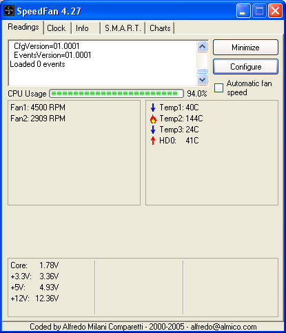

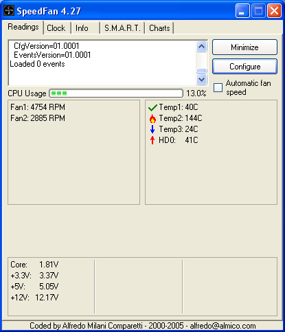

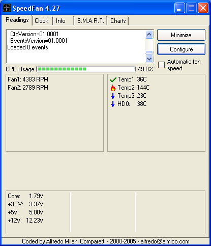

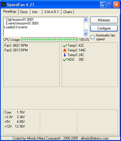

    Here's how my voltages status during various conditions (refer to attached pics) :
    (1) First pic ("01.jpg") - under normal CPU load, just some downloads running (FreshDownload & BitComet).
    (2) Second pic ("02.jpg") - during files transfer from PC harddisk to external USB 2.0 portable harddisk. I just managed to get about 2.0MB/s (around 1.9-2.1MB/s) on a USB 2.0 connection.
    (3) Third pic ("03.jpg") - an alphanumeric keygen running while FreshDownload is building (and moving) output (completed) 215MB file from TEMP directory in drive C: to destination dir in drive D: (same disk). This is quite a high disk activity, I think.
    (4) Fourth pic ("04.jpg") - the condition after the previous action (1 minute later).
    -Note that the rating for my Pentium 3 1000EB is 1.76V. I noticed that while Core, +3.3V, & +12V tend to rise when the CPU load is high, the +5V seems to decrease on the same condition.
    -Also, under high CPU load for a long time (e.g. playing FIFA 2005 for 2+ hours), the system never hangs.

      -Also, just ignore the second temperature reading (which says 144C); this obviously some error in the SpeedFan app.
      -Musafir_86.

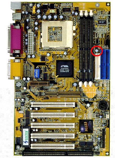

            -Hmm, I'd like to take the pics, but for now I don't have access to any (good) digicam yet. FYI, there about 6-7 caps around the CPU socket that are bulged, & there is (something like) rust on the upper part of the caps.
            -The attached picture I got from the Soltek China website; note the bulged caps are mostly around the CPU socket & one near the DIMM slot/IDE connector (circled red). Again, this is NOT my actual board.

              Re: High CPU Usage When Using USB 2.0 Storage.
              its gotta be taken out of service and recapped soon
                  Then by now, processor taxing tasks will fail. Thus crashes are right around the corner when gaming and thus if you continue to use it before replacing the caps, don't be surprised if you get a BSOD!
