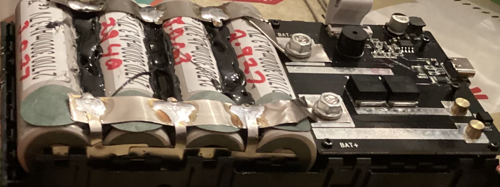

    I have a battery operated tab welder and the battery does not have enough current for the battery tab welder because after about 30 welded it does not have the same current output it voltage has gone down by at least 0.500 volts or maybe a more than that
    I can fit 21700 battery cells in the enclosure it is very tight fit for four of them that are 35 amp high current capacity 35X4=140 high current output this should work a lot better than what is installed right now
    I tested the battery cells there are installed right now and they are testing good with no issues that I can see
    Parameters are as follows
    charging current 2 amps
    discharging current 2 amps
    but these battery cells are not high current version and can see why the voltage drops so fast in this device it actually has a voltage meter read out and seems to be fairly accurate from what I can determine
    My only issue with doing this modification is I want to fuse each individual cell to maximum of 20 amps each but the size of the fuse can not be very big because of space constraints I think I might use automated type of fuses and put individual tabbing to each of the screws on the circuit board
    Dose anyone have any concerns about doing this modification to this battery operated tab welder if so please let me know so I can make a decision about safety and other issues that you can think of
    one note putting four battery cells in the enclosure it does make weight about twice the amount of the original battery cells that are in there now

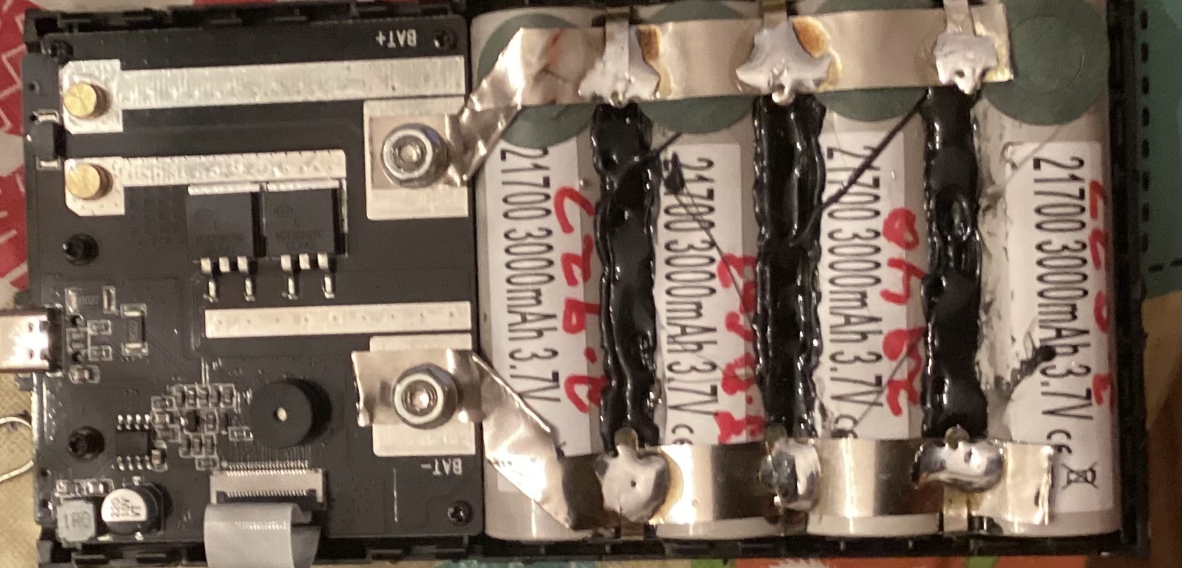

                Battery pack for the battery operated battery tabbing machine I am torcher testing this battery pack
                I finally put together the 21700 battery cells 1S4P configuration and now I am testing the battery pack at 10 amp charging and 10 amp discharging cycle and let see how warm it gets doing this type of testing which I not done this high of amperage on a battery pack in quite a while
                  • Jul 2011
                  • 6059
                  Here is the battery pack for the battery operated tab welder machine
                  With the charging current only being 1.10 amp it going to take about 12 hours to charge completely up
                  With the battery voltage only being 3.4 volts it saying that the battery pack is low and turning off by itself
                  From what I see here I am not going to let the voltage go below 3.8 volts because of how long it takes to charge up completely

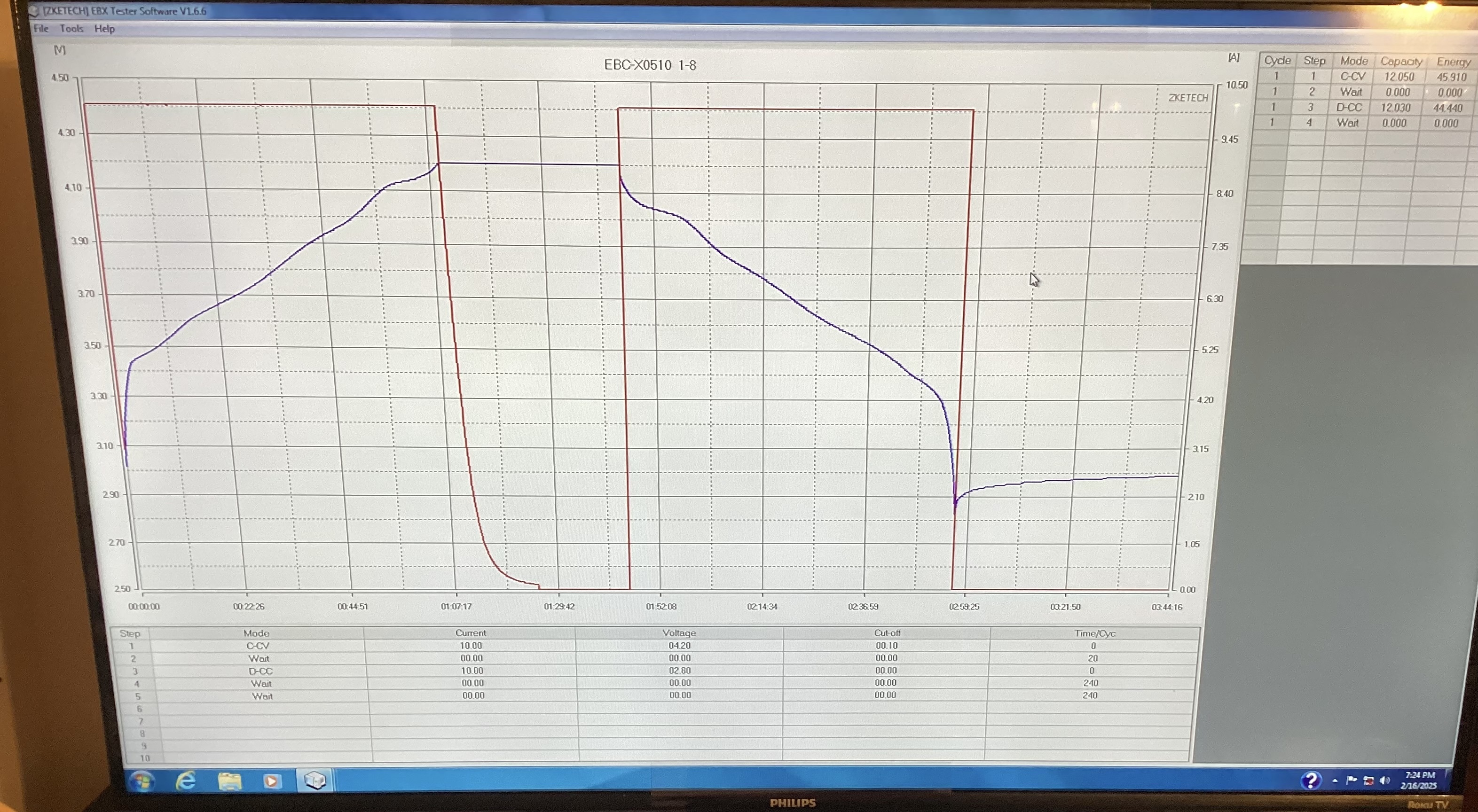

                  The test done on this battery pack is as follows
                  charging current 10 amps
                  discharging current 10 amps
                  The charging and discharging graphs look very good for testing the battery pack at 10 amps took a little bit over an hour to complete the discharging test which is what I expect to see
                  These battery cells are high current capacity battery cells 35 amps continuous loading which is 140 amp capacity and in pulse mode it would still have more to spare than 140 pulse amps
                  According to the battery tabbing machine current was averaging around 200 amp pulsed current
                  One note it is not easy to drill a hole into the tabbing material you have to use a paint stick and a piece of wood and sandwich the tabbing material in between the wood sandwich to drill into it for best results

                                      Well the pouch battery cells came in today in the mail now I have to drill holes in the tabbing to be able to hook it up to the battery tabbing controller board
                                      There is enough room to put two 117080 pouch battery cells in this enclosure which I was hoping this would be the case
                                      Now I have to order two more of them for the other battery operated tab welder I have two of the exact same model number and both of them use the same exact pouch battery cells
                                      Now I also have to test each pouch battery cells individually at 10 load and see how they perform with this type of load
                                      It turns out that the maximum space for the battery thickness is 22mm or it might be a little bit more than that this but I am not sure how to find out the exact specs size instead 21mm

                                        Here is the results of the torture 10 amp load test on these two pouch battery cells the results are very good surprisingly enough for Chinese made battery cells now how long they last is a hole another story
                                        I am only showing one results because they are so very similar in current/voltage curves that it does not make sense to post both of them unless they were very different to each other
                                        The current/voltage curve is somewhat steep but you expect this for a load of ten amp load these pouch battery cells are not 10 amp hours as I stated above they five amp hour pouch battery cells so the total amp hour for both pouch battery pack would 10 amp hour but would still take 10 hours to charge at one amp which is acceptable if I can tab weld a fairly large battery pack I would not be disappointed at all the cost of each pouch battery cell was $10.00 each plus shipping which was not much because I had ordered two other pouch battery cells and two high current battery post for a project that I going to do very soon
                                        I will be ordering another set of 107080 pouch battery cells for the other battery pack for the other battery operated battery tab welder so both of them will be the same capacity so can alternate from one welder to other battery tab welder so I do not have a temperature issue when building a large battery pack
