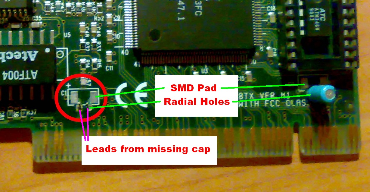

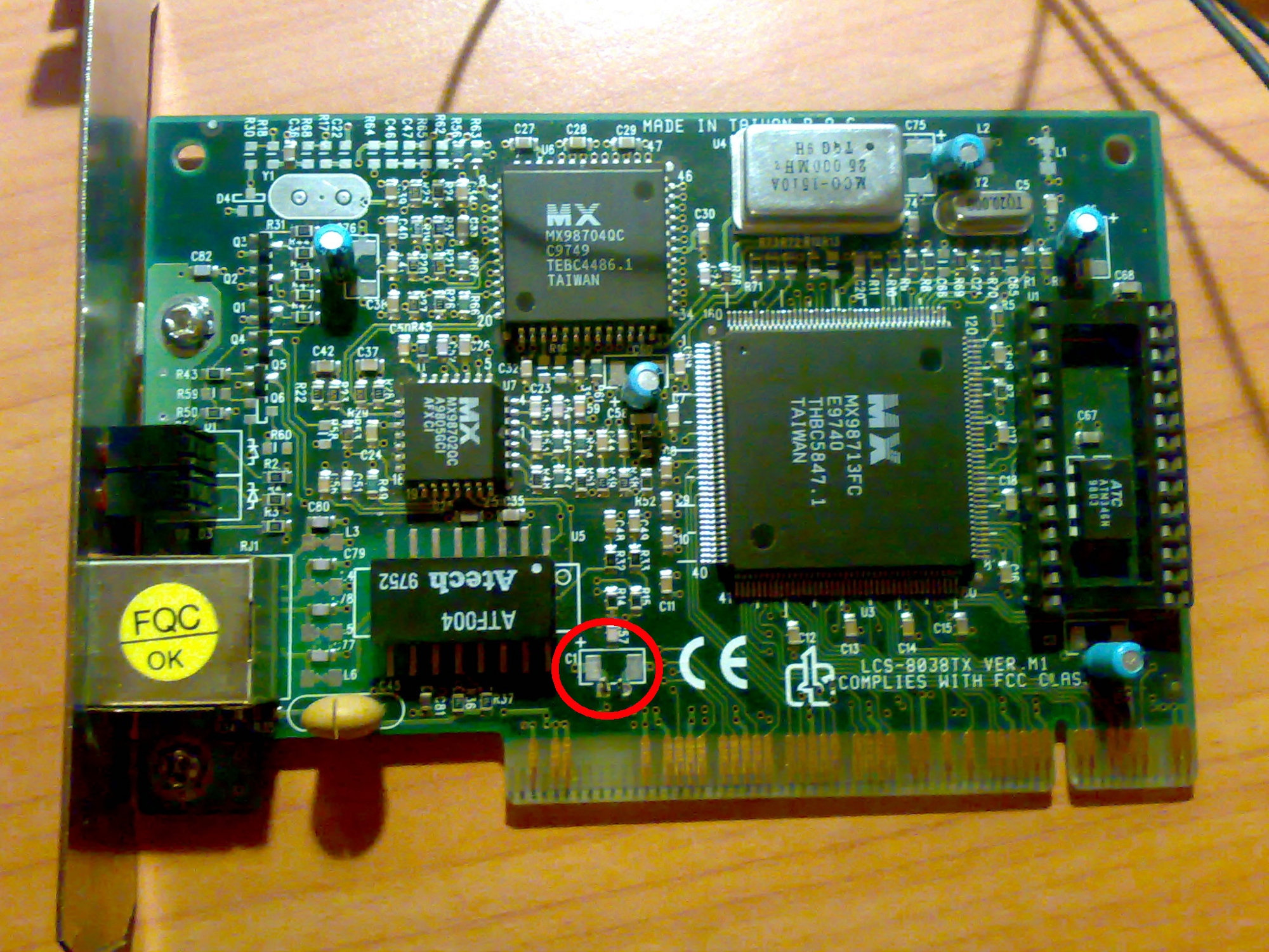

    Hello everyone!
    This is my first time to post on Badcaps Forums, so I apologize if I say something ridiculous.
    Anyway, as the title says, I have got a Longshine LCS-8038TX ver.M1 LAN card from a friend of mine. The problem is that it isn't identified on my PC as a network device, and the LEDs on it blink hopelessly.
    In the picture you will see (hopefully) that capacitor C1 is missing. Could it be the culprit?
    TIA,

    Re: Lcs-8038tx
    Most likely
    The picture of a LCS-8038TX in the attached PDF does seem to have a capacitor in that place
    Even though yours has a Macronix chipset, and not an Intel like the specification says, the capacitor is probably still necessary

      Re: Lcs-8038tx
      Yes you have a missing cap.
      The design is to use either radial or SMD in every spot.
      The spot you are worried about has the legs from a missing radial still on the board.

        Re: Lcs-8038tx
        So, I popping in a 10uF 25V cap (that are the specs of other caps on the board) should solve the problem?

            Re: Lcs-8038tx
            Can't tell you that for sure. I dunno what was there.
            - Often cards like that only have one size cap but that is absolutely not 'always' the case.
            Chances are that will work but no guarantees..
            As Uranium-235 said, replacement NICs are readily available and cheap [or even free].
            Fix or replace would depend on what your priorities are.
            If repairing this is a learning experience then go for it, if the system is important for whatever reason then replacing it might be better.

                  Re: Lcs-8038tx
                  That cap is likely on the 12v rail so use a 16v. Try a 100 or 220uf.

                      Re: Lcs-8038tx
                      You can probably figure out what voltage it's on with a DMM and the pin-out.
                      http://pinouts.ru/Slots/PCI_pinout.shtml
                      A 16v or 25v cap would be safe anyway because the highest voltage is +12v.
                      They probably upped it to 25v for a larger can and a higher ripple rating.
                      Messing with uF on a NIC might have bad results because there are timings and frequency dependent circuits involved.
                      If you are SURE it is -only- for power to the IC chips then getting the uF exactly right shouldn't matter that much.

                              Re: Lcs-8038tx
                              The value........
                              And the tolerance is +/-20%. That's loose but not THAT loose.
                              Asker stated the other caps are 10uF.
                              The missing one was -probably- the same...
                              100uF and 220uF aren't within 20% of that nor are they within 20% of each other.
