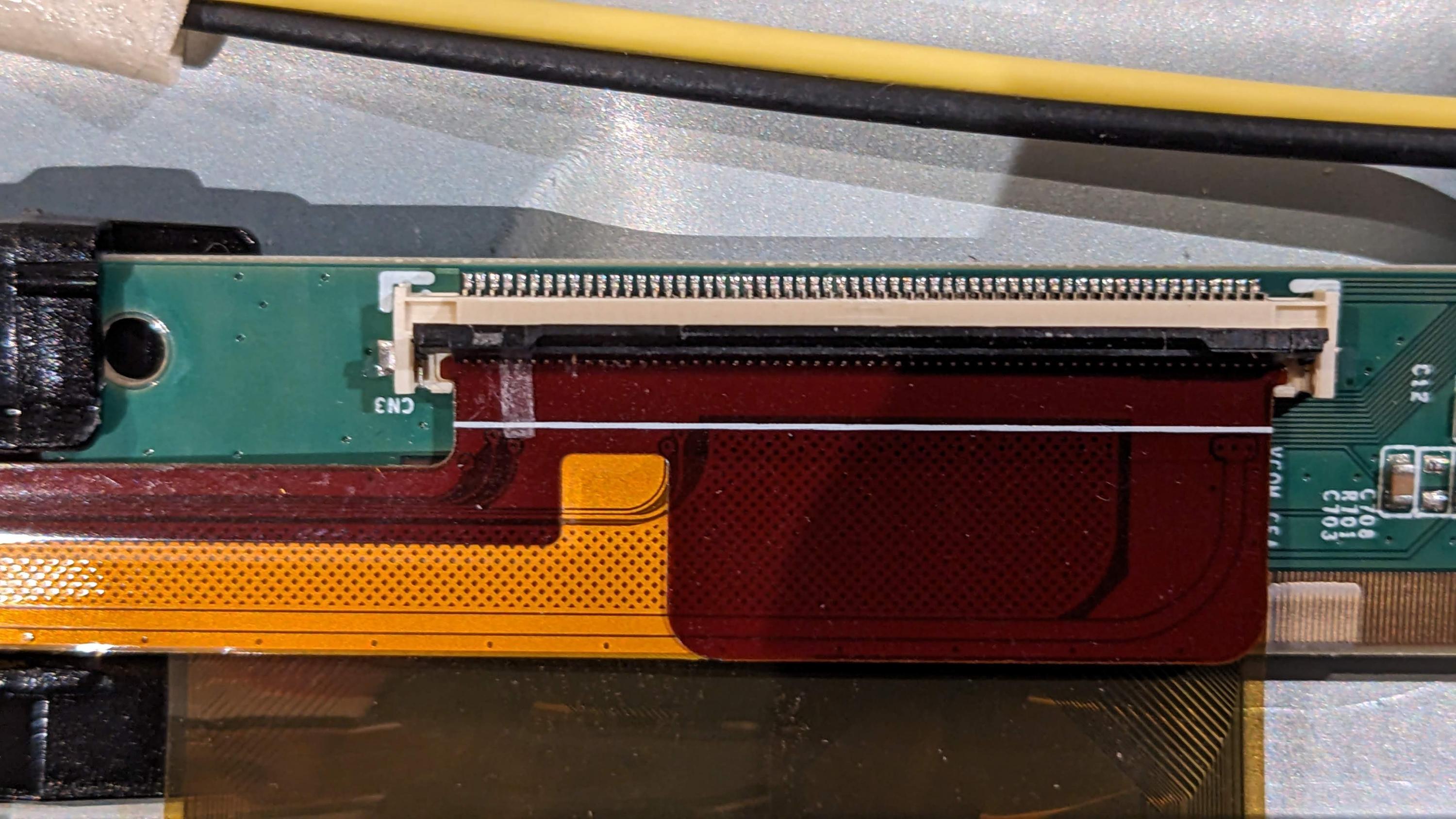

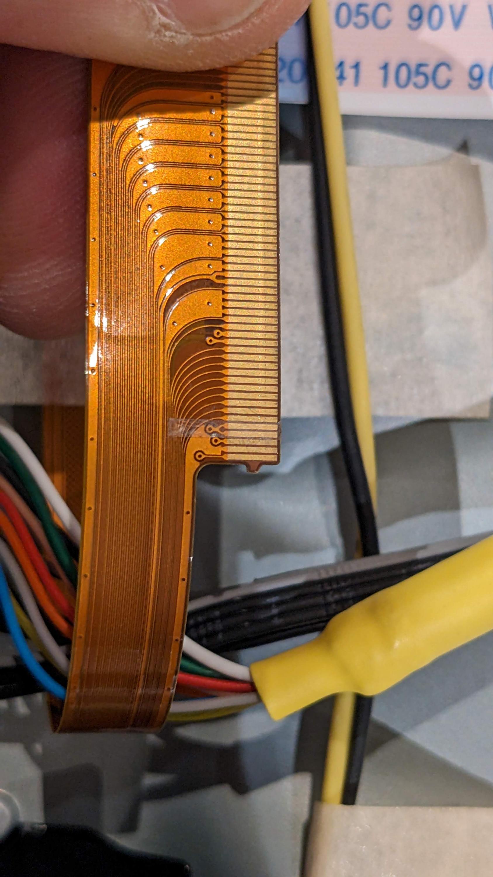

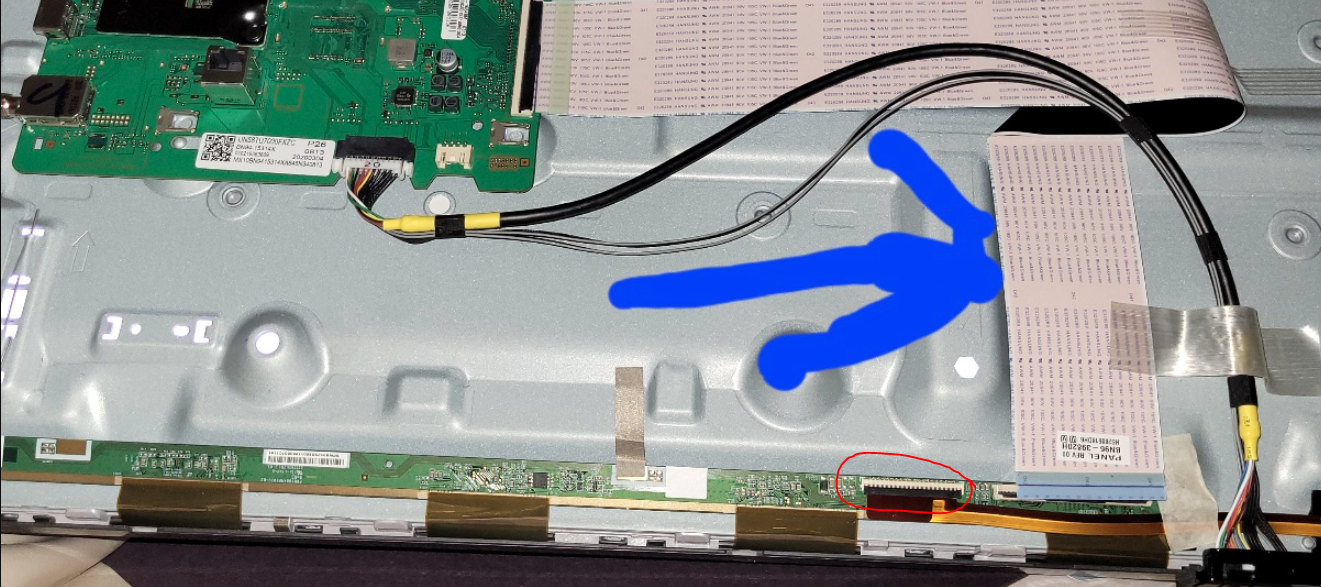

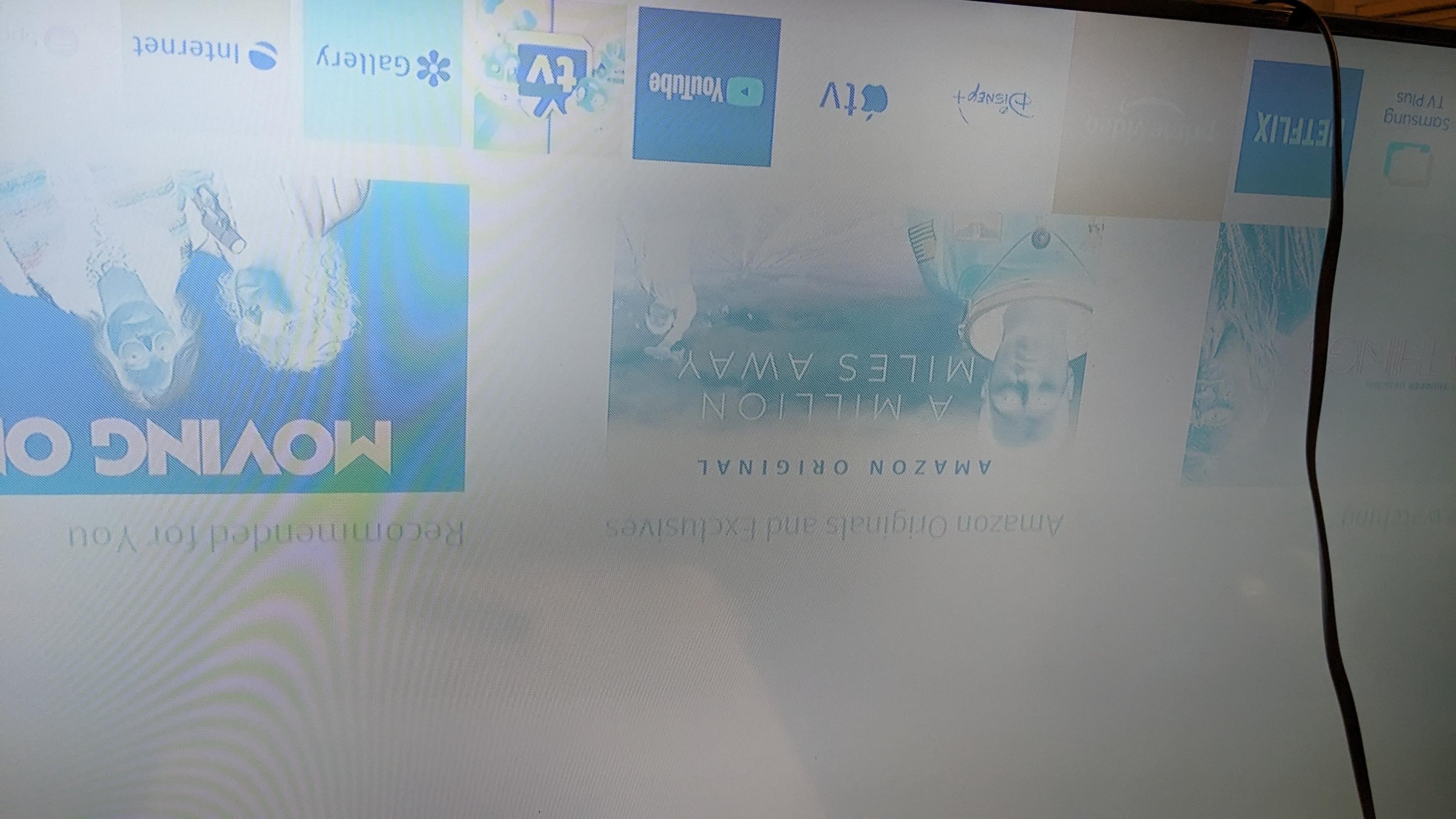

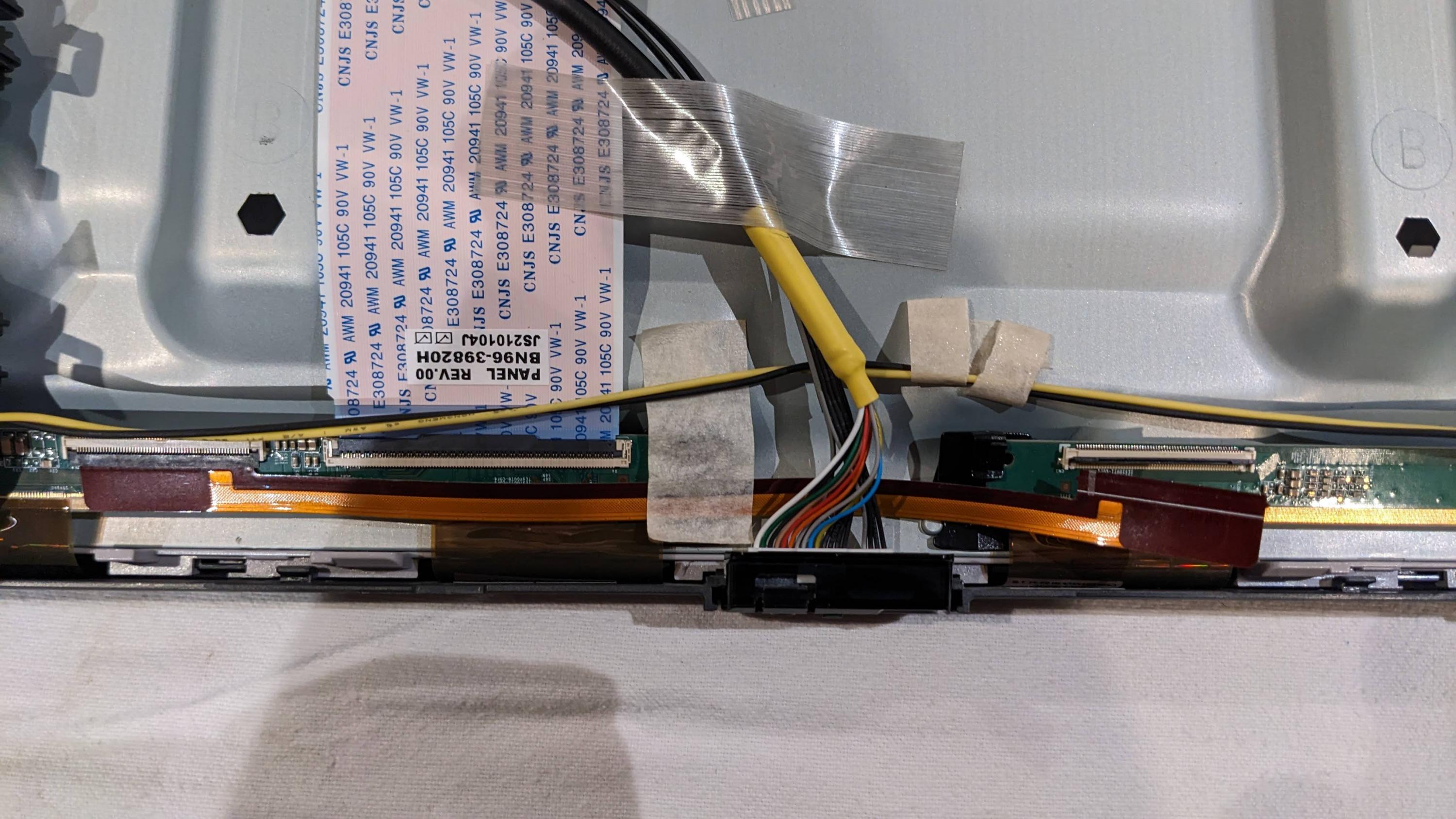

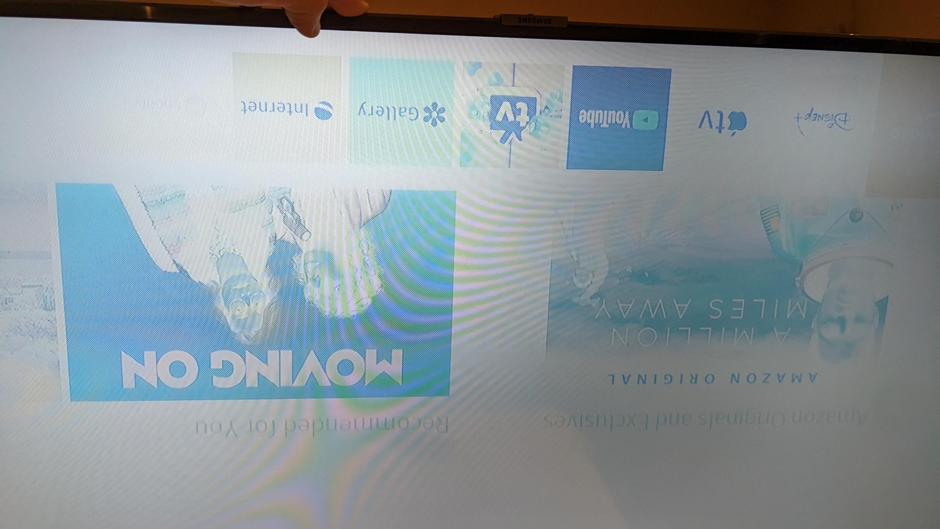

                        Re: un58tu7000 reboot loop
                        I have the same issue with the same TV. Managed to isolate two contacts on the ribbon cable that joins the left and right driver boards (see pictures), and get a crappy picture. Wondering if someone knows what signal is on these pins and if there is an area to focus on to improve the picture (lines are acceptable, but the picture right now if really bad).
