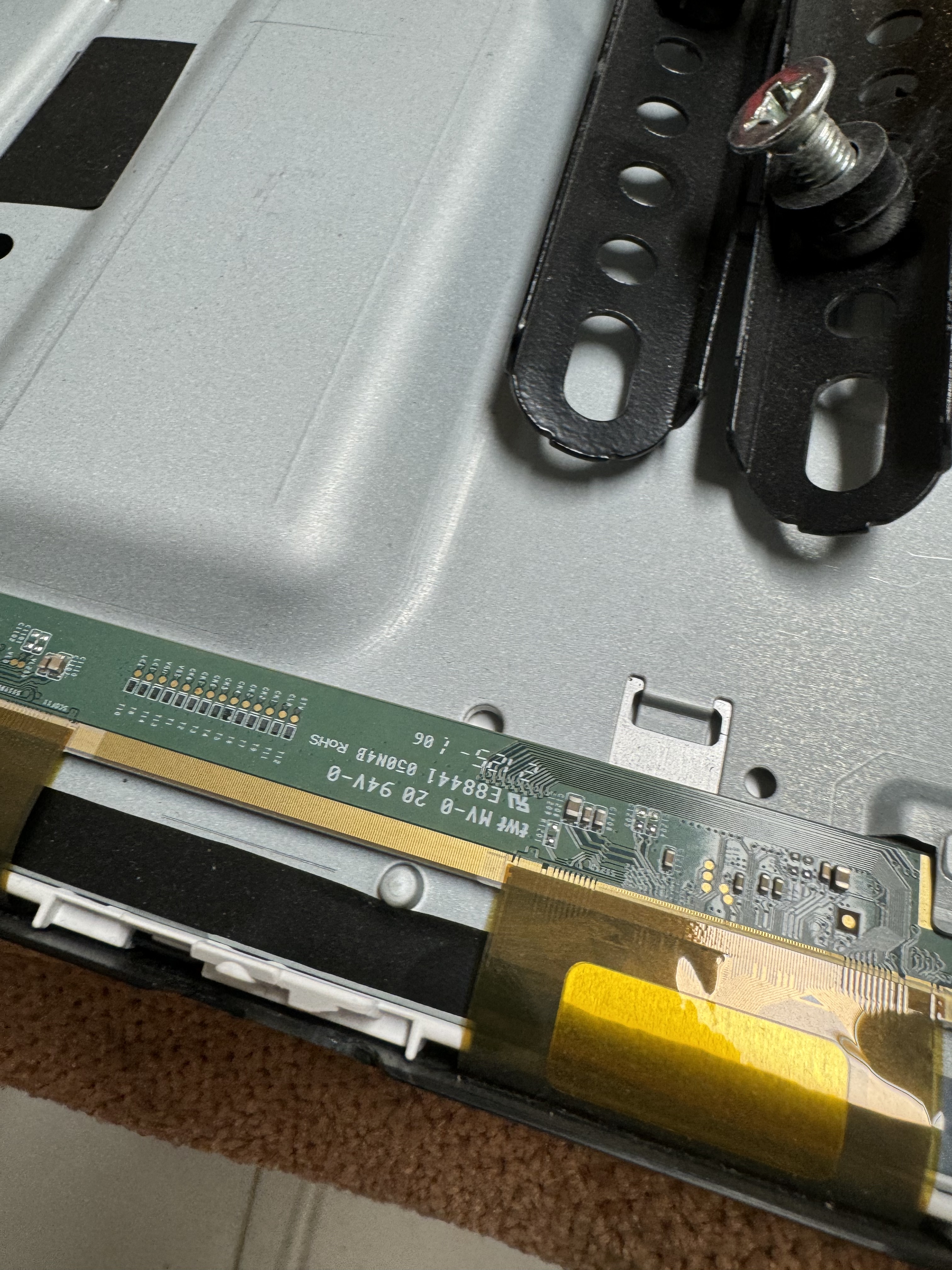

    Does this have diode packs? Show pictures of full buffer boards. And how many pins are you blocking with tape at a time?

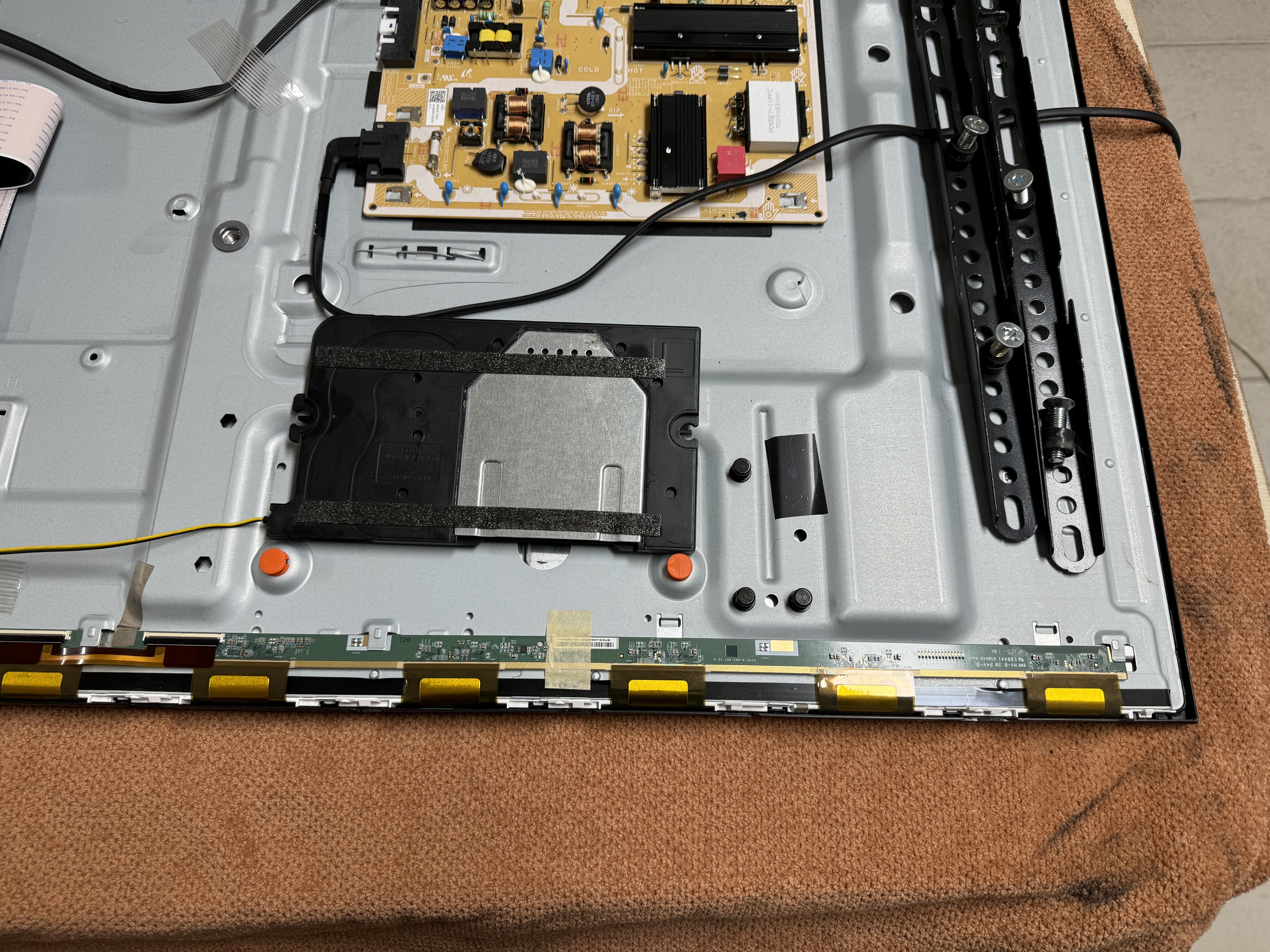

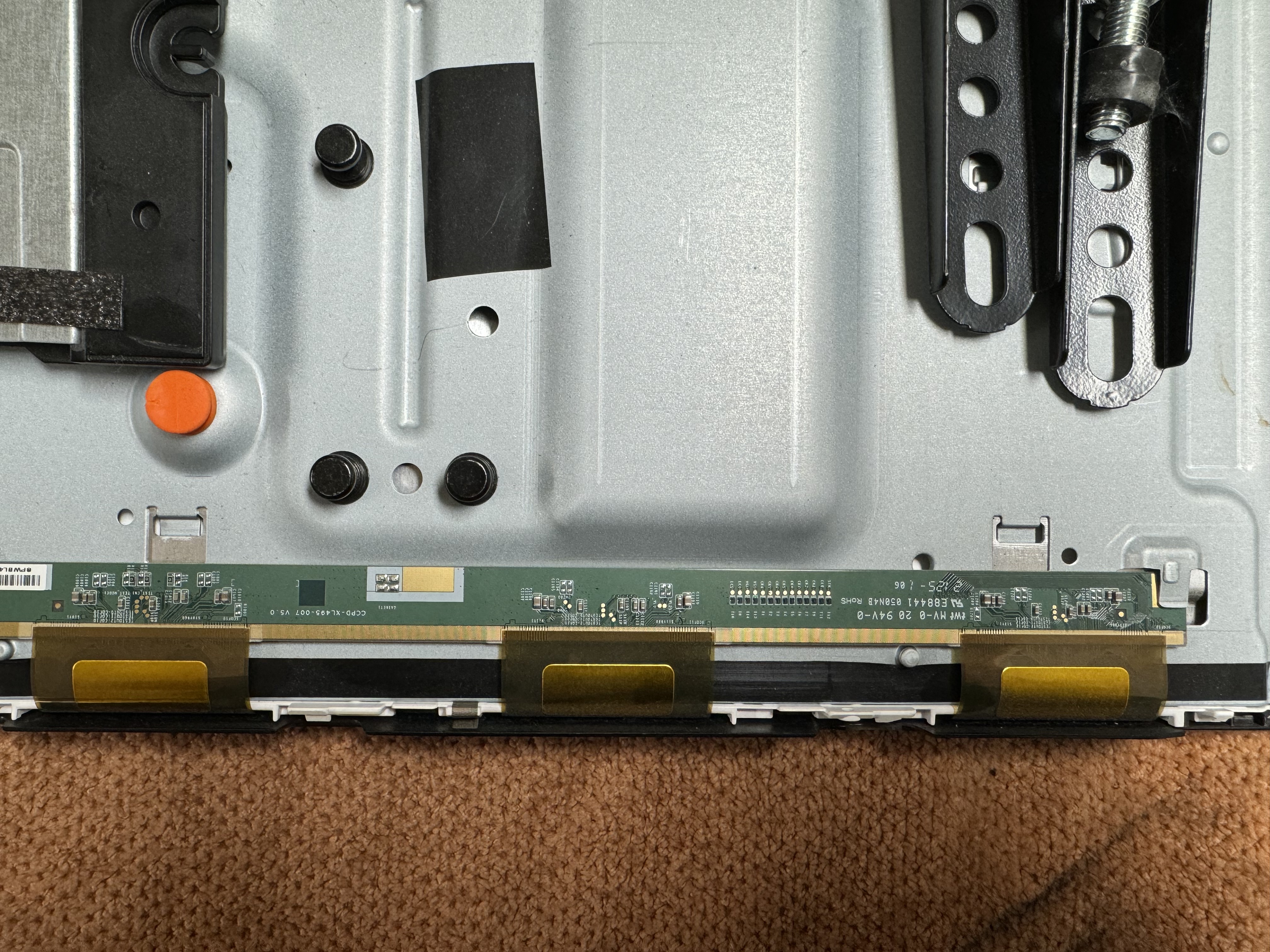

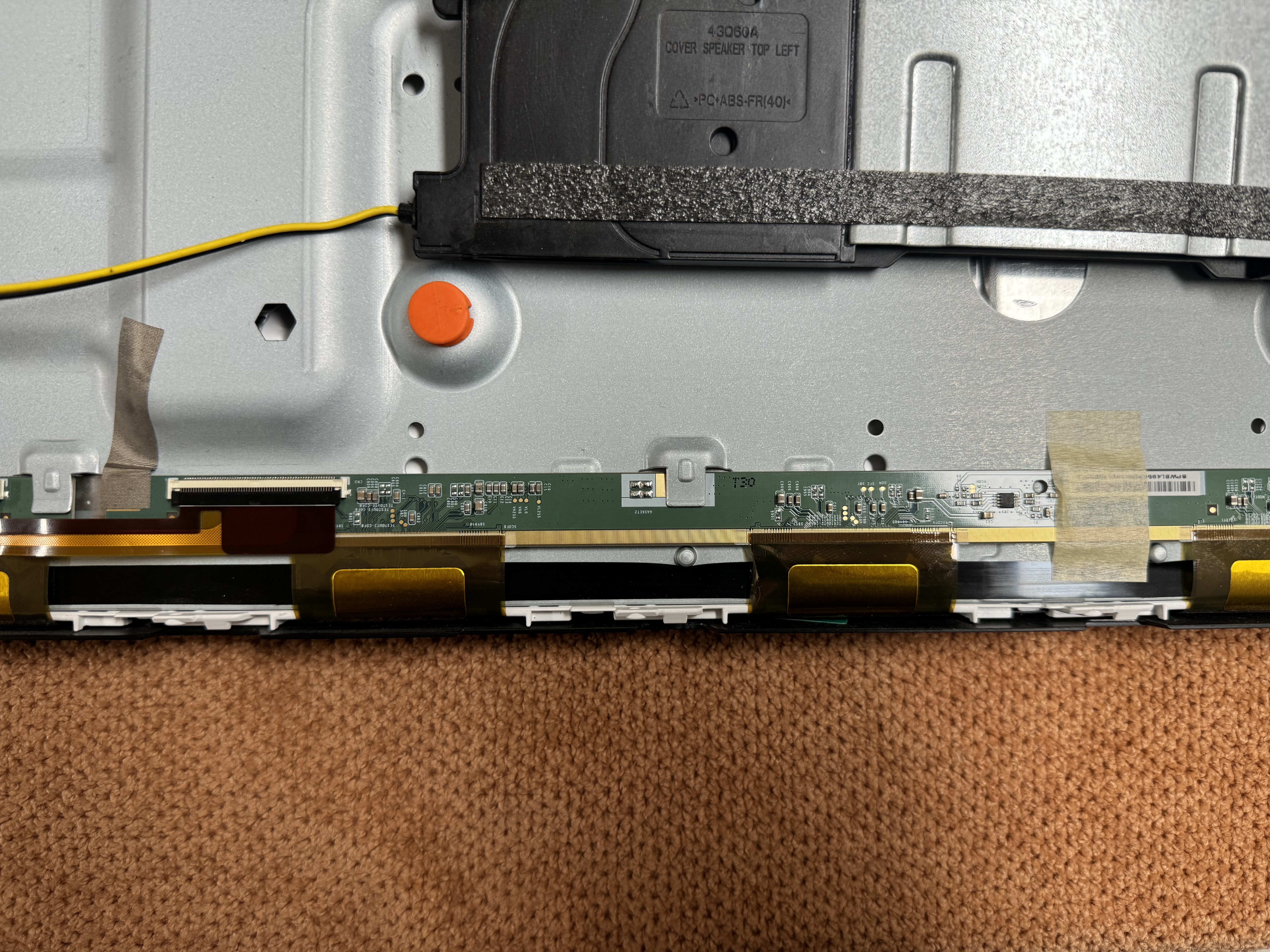

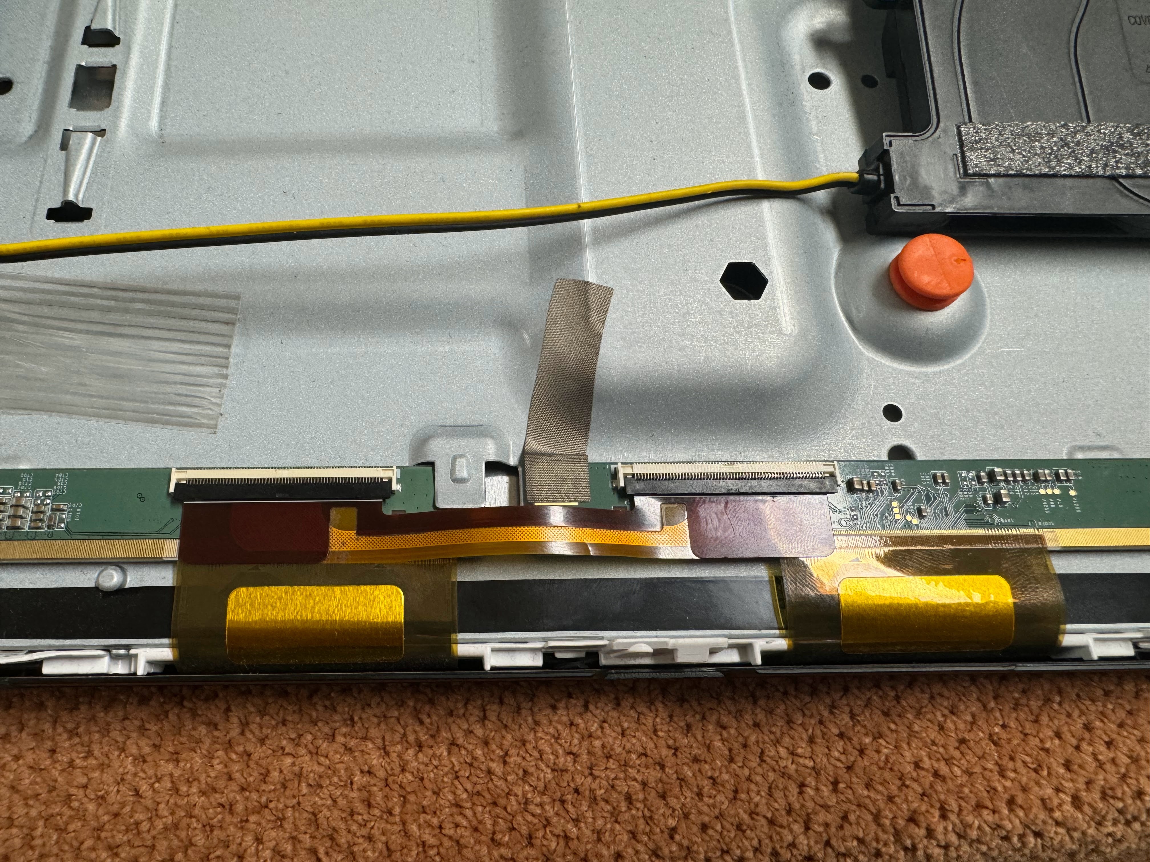

      No diode packs, attached full board.
      I tried many variations, among this: https://www.badcaps.net/forum/troubl...95#post1840595

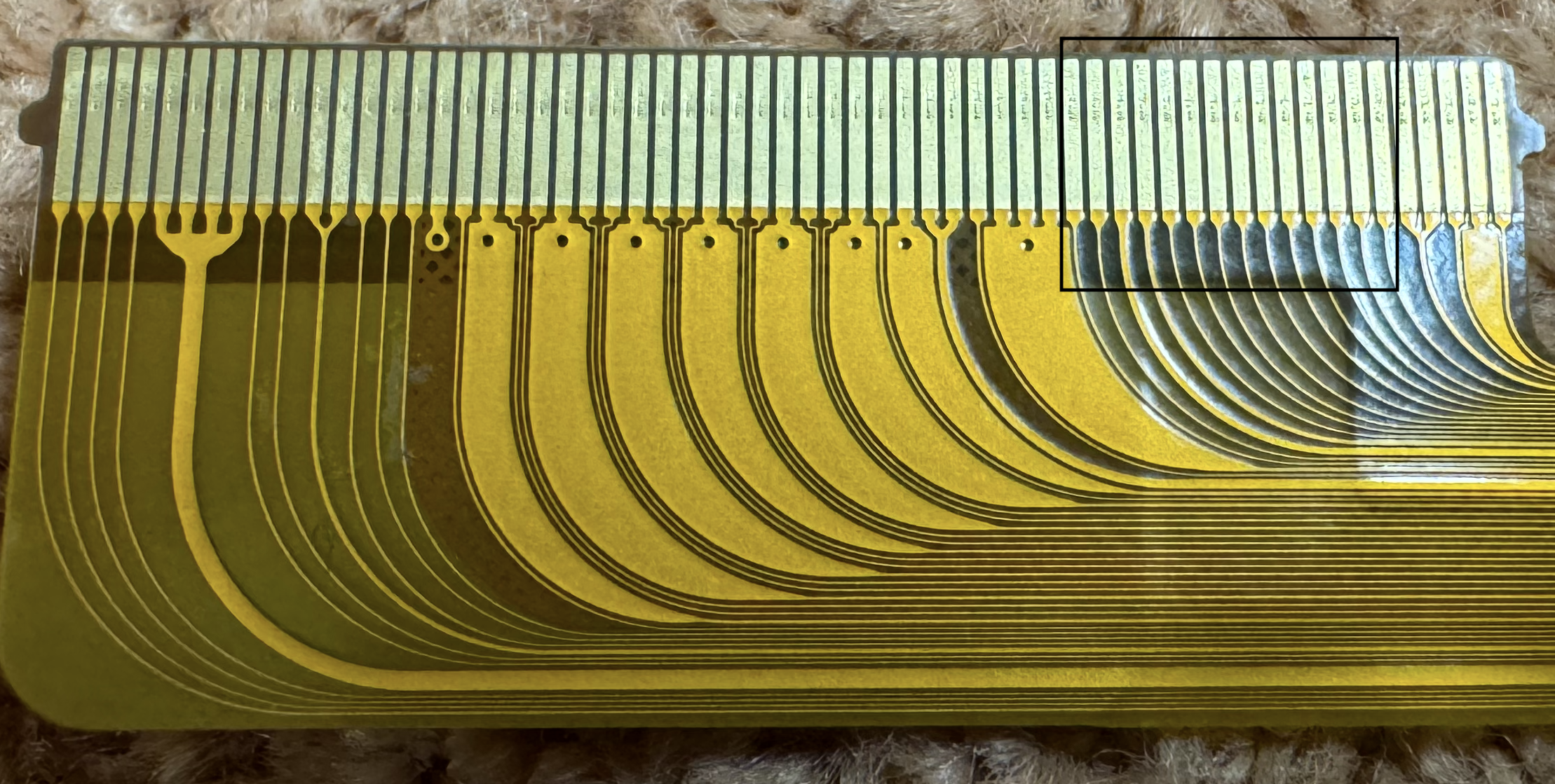

        Is this damage in the picture? On the ribbon.
        But if above don't work, you are probably screwed. There isn't much of a solution for these yet that I've seen on here for the Samsung reboot besides diode pack/tape and occasionally bad caps on buffers.

          That side of the ribbon does have a bit of a bend on the side but it doesn't look damaged.
          As for the the tape method, wanted to make sure, those are the pins the need to be masked?
