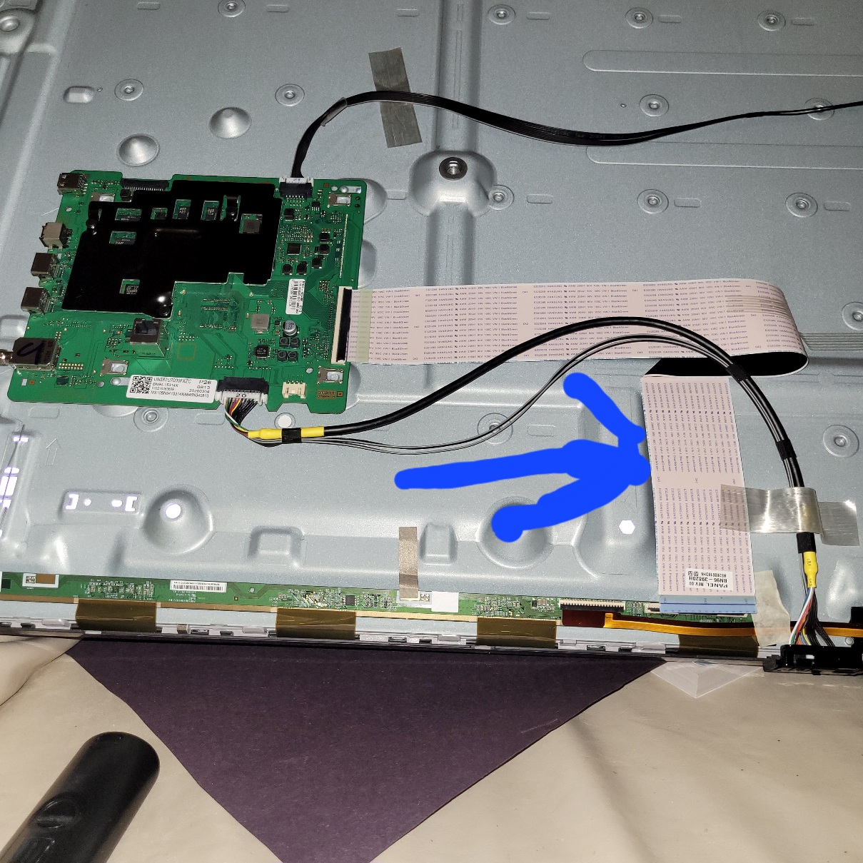

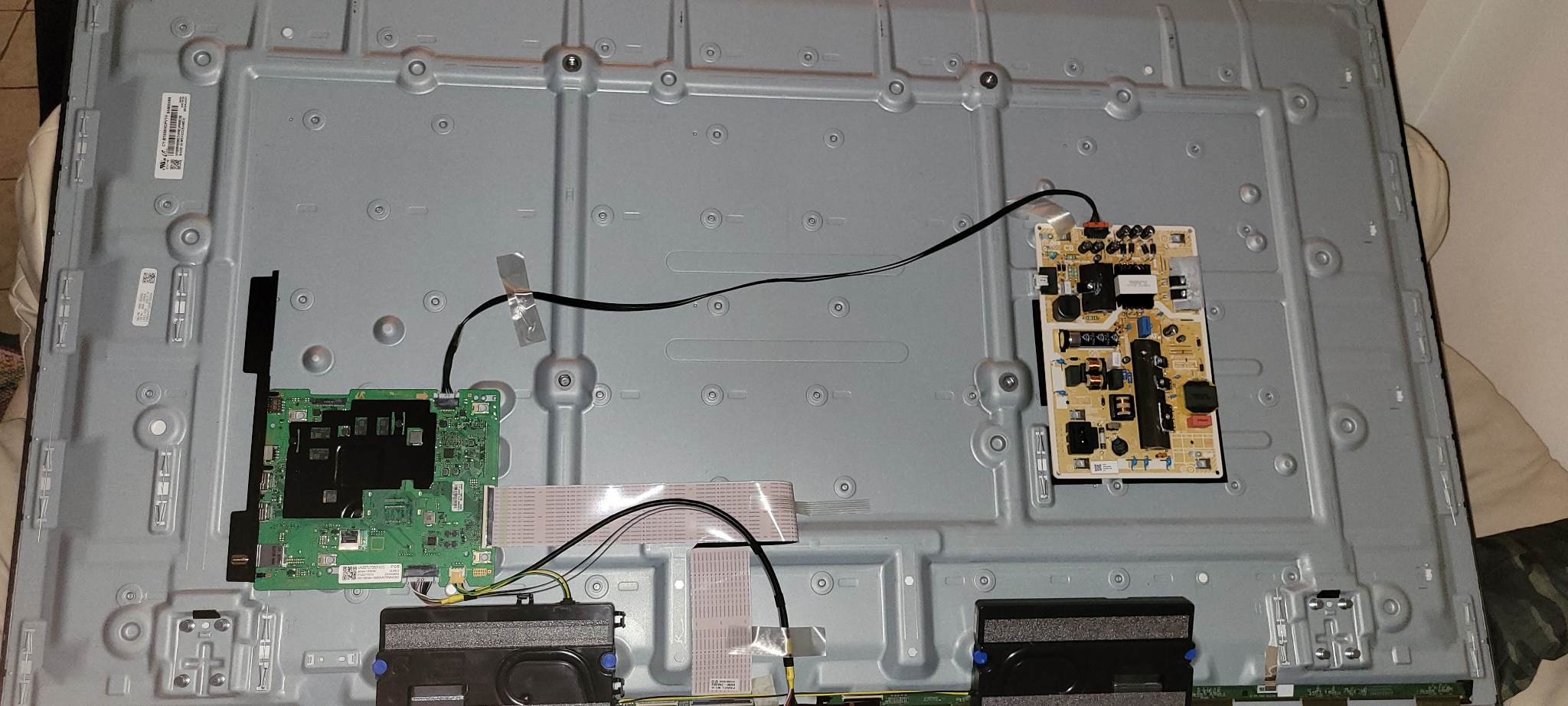

    I was recently given a Samsung un58tu7000 tv that was broken, upon plugging it in the tv constantly reboots after every 10 seconds or so
    found youtube video of a same series tv that had same issue and they removed a "led dimmer" wire from the power cable feeding main board and it fixed there issue but it didn't fix mine, also if i completely unplug that wire and start tv the screen stays on
    another video i found suggested pulling off one of the surface mounted chips and reprogramming it then resoldering it back on the board
    any suggestions ?

    Typical panel problem with these particular series.
    Unplug the cable from main to panel and see if it's still rebooting.

      Re: un58tu7000 reboot loop
      that rebooting is probably a mainboard issue.
                when i unplug the cable completely from the mainboard the screen stays on
                  ok, so that usually means that your powerboard and backlights are alright.

                    +1 on the panel issue. Try “tape method” and you should get a picture after some playing around. Unfortunately the picture is usually degraded in some way. Ie; loss of color/s and sometimes lines
                            to be clear, which cable, the one from powerboard to mainboard or flat cable from mainboard to panel?

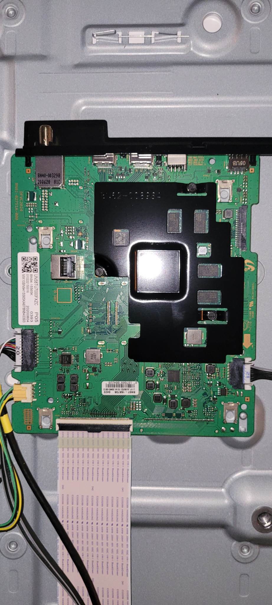

                                So I have a replacement main board coming for this tv today, is there anything special I have to do when I plug the board in and turn tv on, does it matter if I update it over internet or should I do usb instead, and if usb where can I download the updates for usb from ?
                                  pop it in there and try it, might work without anything else needed.

                                        I received the new main board today, swapped boards and it is still doing same thing, I figured out that also if you leave everything plugged in but remove this cable from the main to the panel also that the panel stays on
