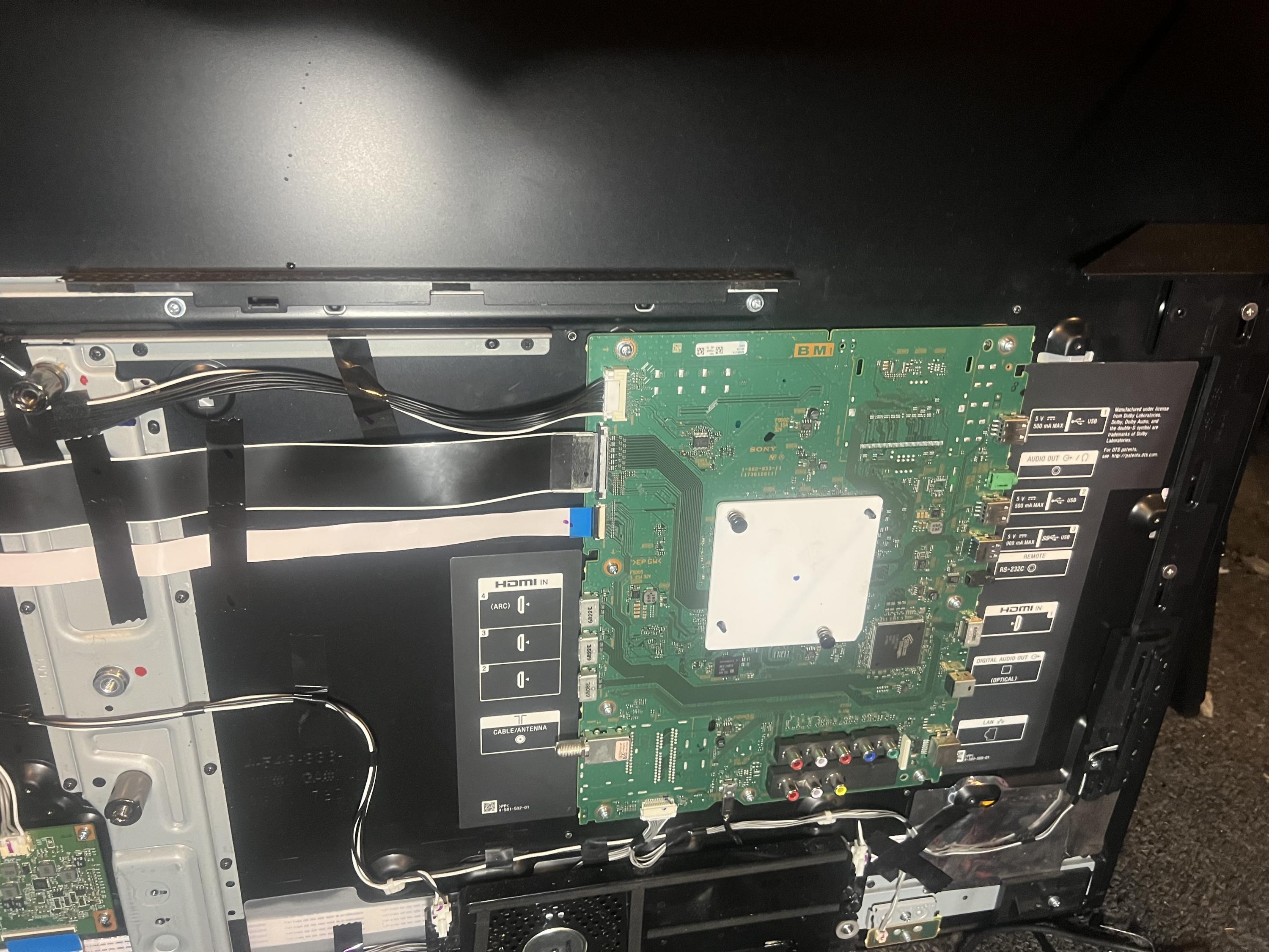

      Yes with all three main boards no 12v at the T-con fuse.

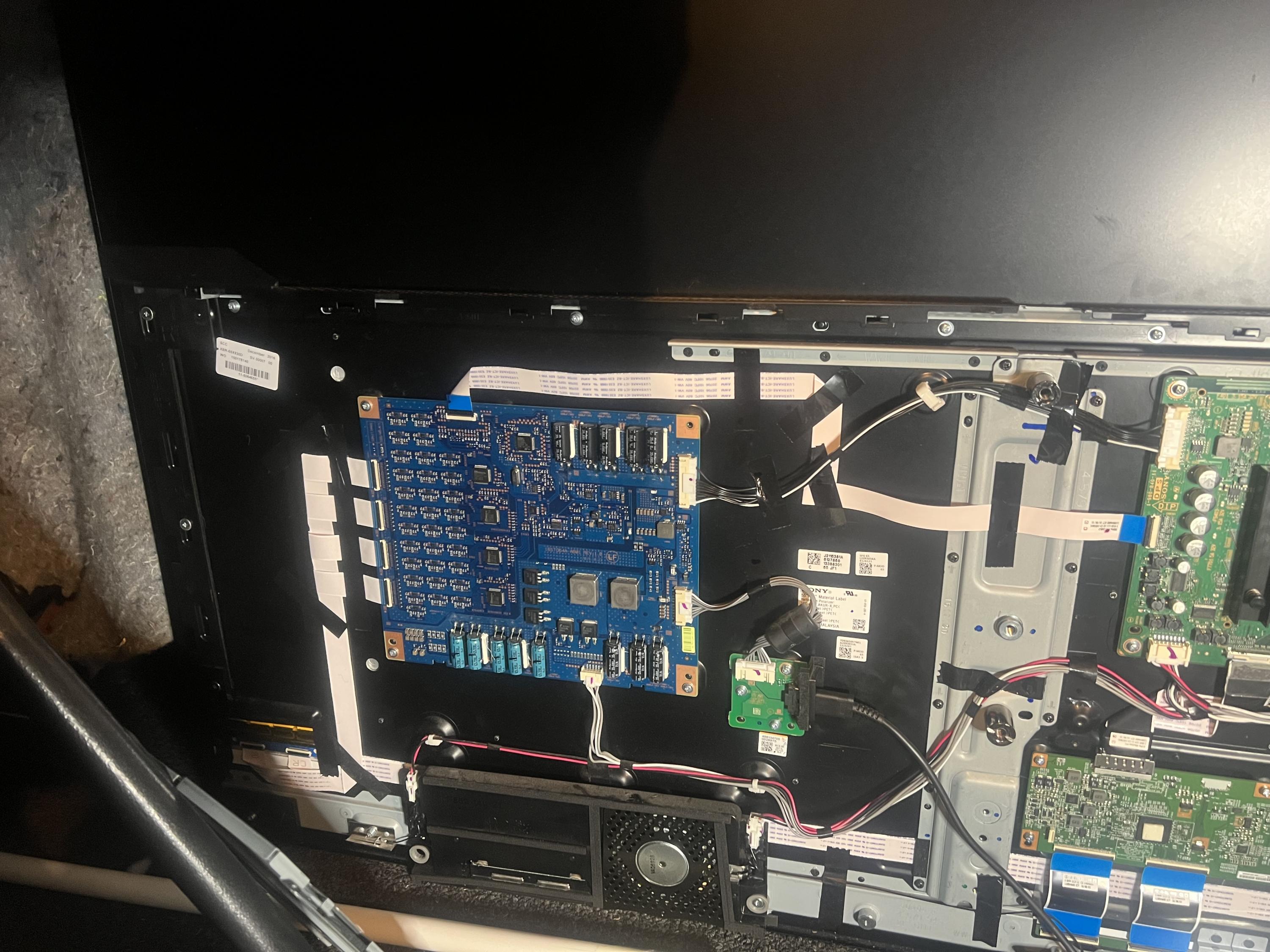

          can you post a picture of the whole back, as to see how everything is connected?

            Yes give me a minute let me take a picture and post it thank you.

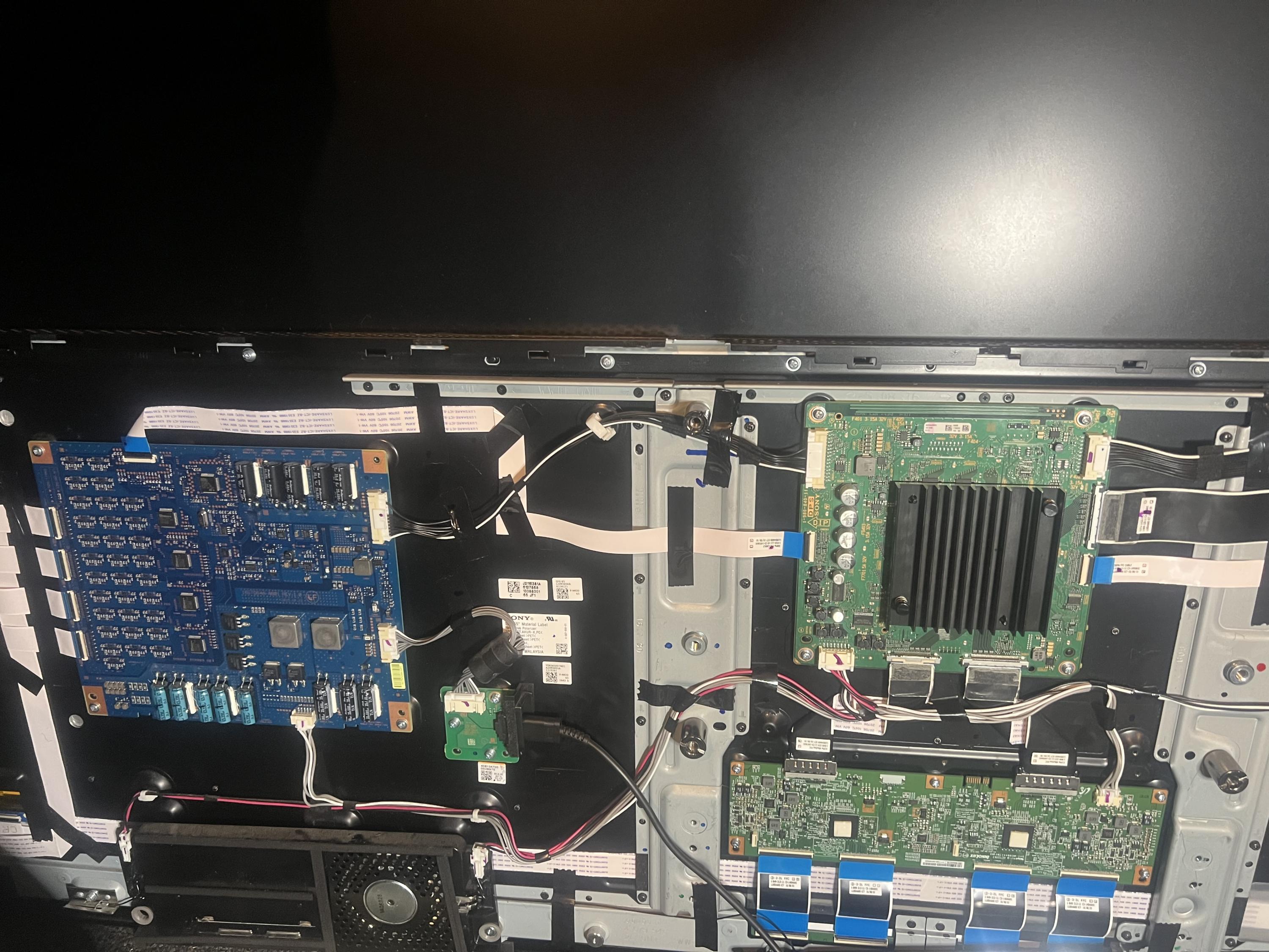

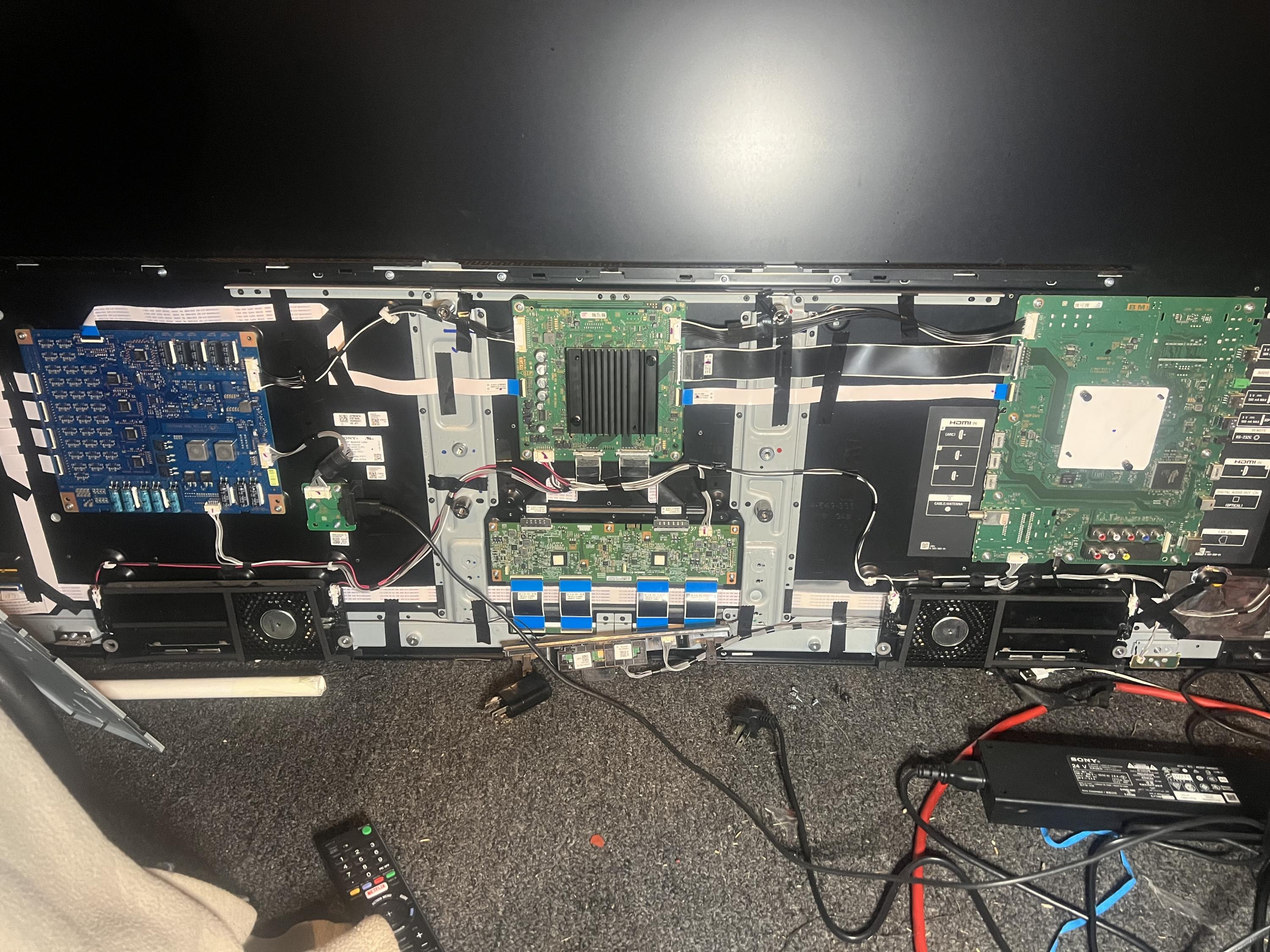

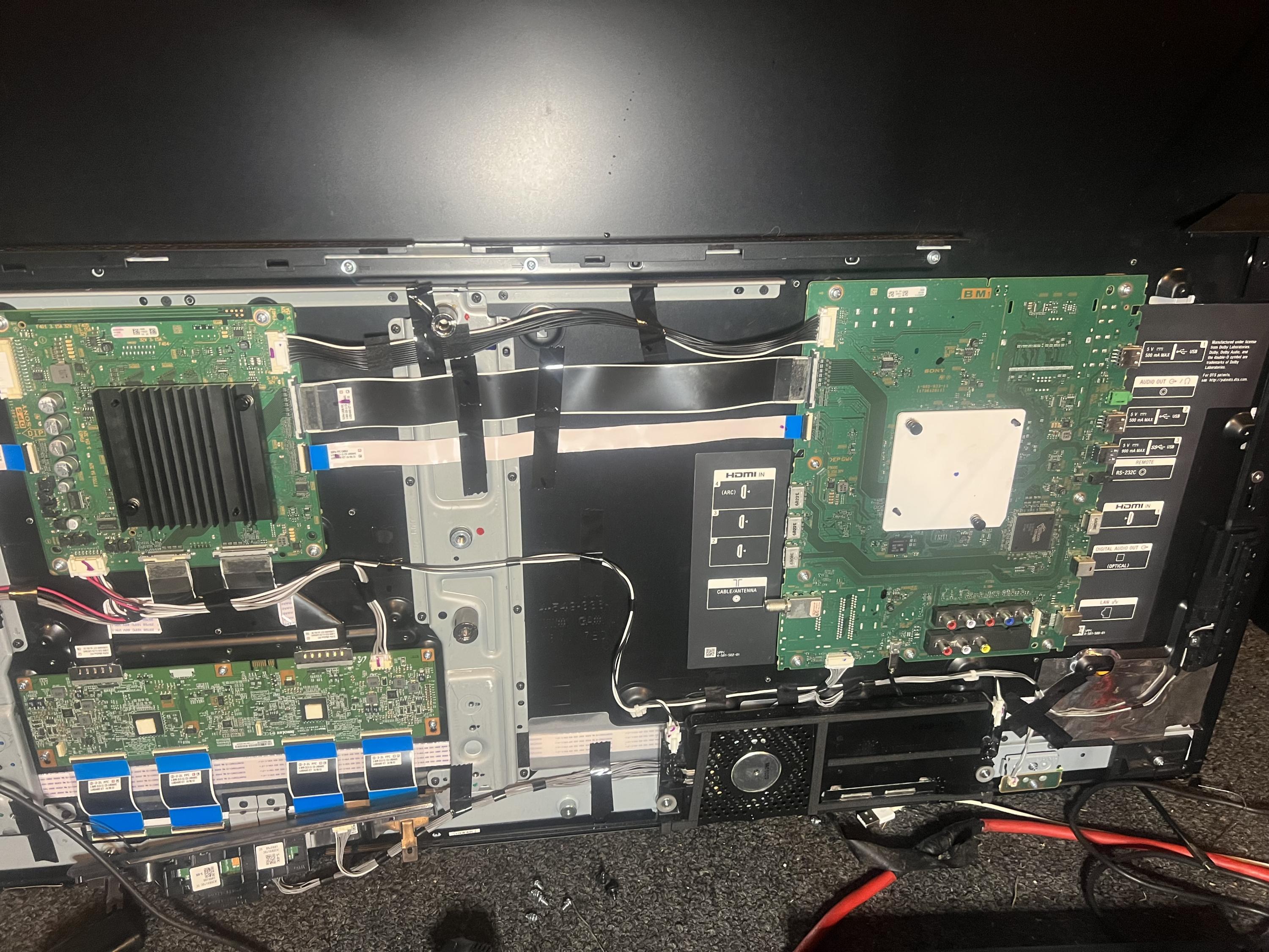

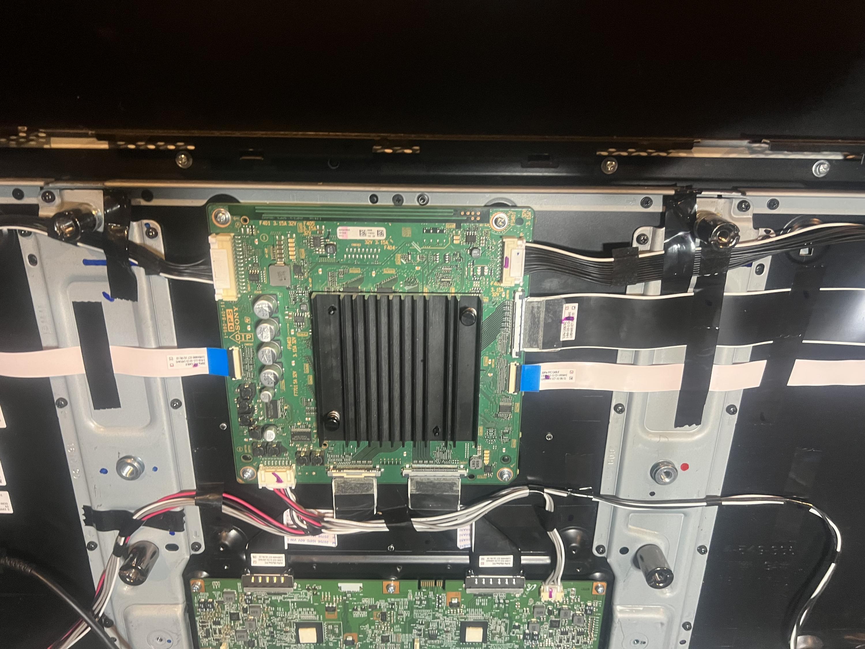

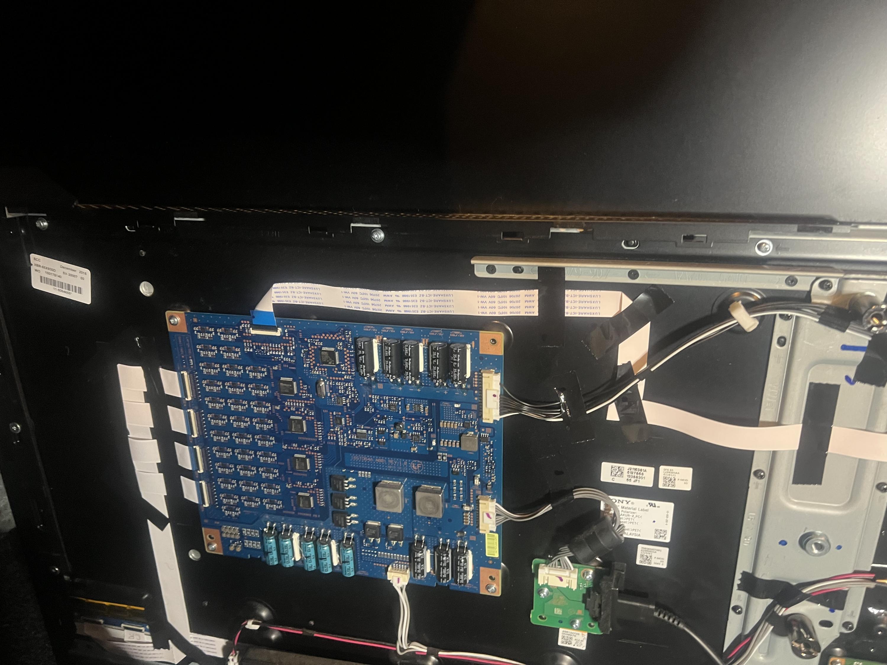

              here are the pics.

                did what post #19 showed no difference.

                  if I unplug the white ribbon going from dps board to blue board and what I believe is the led driver board I get back light no picture. plug it back in and back lights go out.

                      ok, thats a good sign, I never could get my backlights on, except with a bl tester, that should mean that powerboard and backlights are ok, problem could be in dps/backlight driver board or mainboard, I think prolly mainboard.

                            I went thru all the video still having same issue could it be a bad t-con board not letting 12v get to the fuse on the t-con board?

                                did you check for shorted caps on the mainboard and dps board, and for those voltages he checks? see how he checks several caps around the chips, do that if you haven't already.

                                        yes I have done the checks all seems good just not getting 12v at the fuse on t-con board, if you unplug the tv and plug it back in you have the amber green light on bottom of tv. then if you push the power button on remote you can get the white stand light but no picture. but each time its unplugged and plugged back in same thing over again.

                                          Follow the path back from the fuse on the tcon too the mainboard look for any burnt or short components
