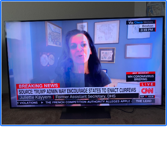

    Hi, this is my first post - so thanks in advance for any assistance.
    I have a Sony XBR 65x930D (manufactured in July-2016), which was initially showing a black screen, faint backlight glow, and played musical sounds when powered up. After some experimenting (mostly unplugging cable and re-plugging), including attempting hard-reset and firmware update, it is now showing video, but the left side of the screen is fuzzy/grainy. (See attached pic)
    I am trying to decide if this could be the T-CON board, or the DPS board.

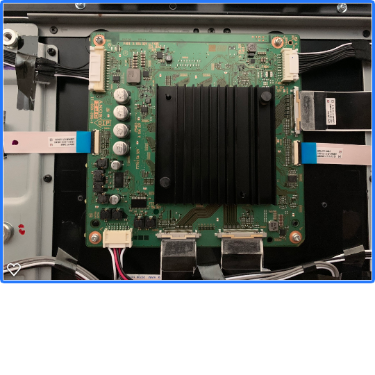

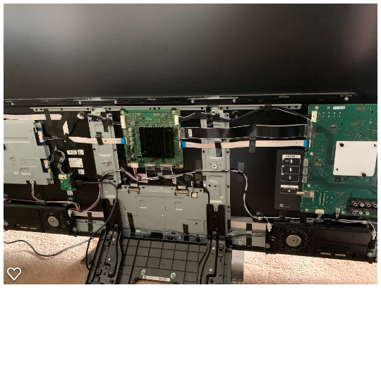

    I've attached pics of the overall back of the set as well as the DPS board which seems to be sensitive to causing the symptom.

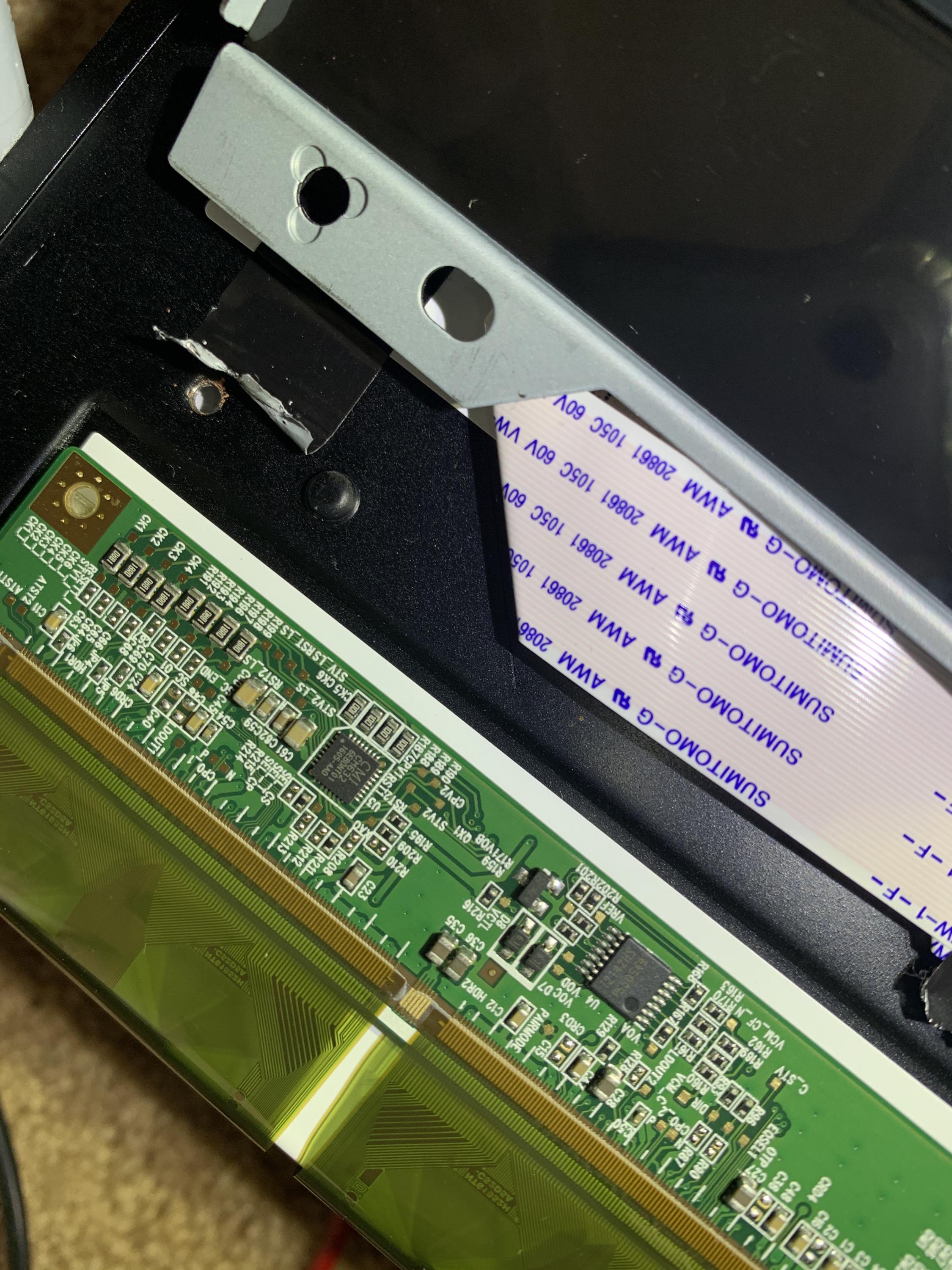

                        Well, a few updates, no success yet.
                        First, I had ordered a replacement TCON board before posting this thread, and as predicted, it didn't change anything. They key being that when the right-most of 4 LCD edge boards are disconnected (remove ribbon connecting two right-most edge boards), the TCON voltages are normal on both sides.
                        I've done a bunch of checking capacitors on the edge boards, found nothing less than kilohms - most are megohms. There are a couple of ICs on the edge boards. Googling didn't give a datasheet, although I could order them. I wonder if either of these ICs could be the problem? Pins are so small, hard to compare the left/right sides while powered up.
                        U3: "CMI CM632 6EBDNT01 1605-AAD"
                        U4: "i2142HS P550549"
                        (see image attached)
                        I'm having trouble thinking about how to trace the signals along the edge boards to decide what is altering the VGL and VGH voltages from what the TCON supplies. Is this best done while power off and ribbons removed?
                        Could it be the panel?

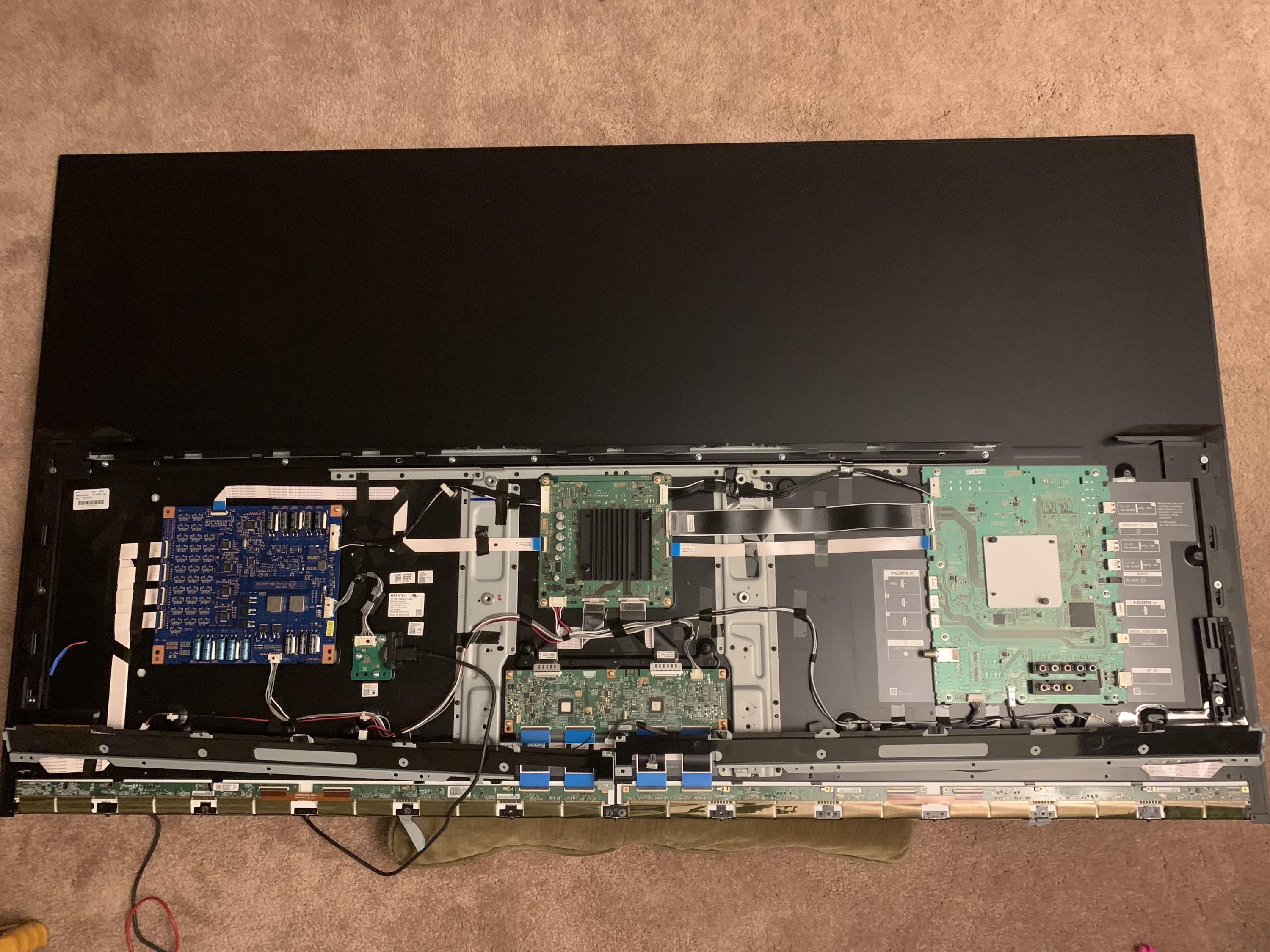

                          not sure I follow the "edge board descriptions", can you post a picture of the bottom of the panel / edge boards on the side of interest. Are you saying that there are a pair of edge boards on each "half of the panel"? If so, then there is a "U" ribbon that interconnects the "pair". Please confirm my "understanding".
                          • misterhaus
                            • Dec 2019
                            • 24
                            Re: Sony XBR65x930D - left half screen is grainy
                            Yes, exactly. There are two edge boards for "left" and two for "right" half of screen.
                            The right two are connected with a ribbon cable between them. Same with the left.
                            Image attached.

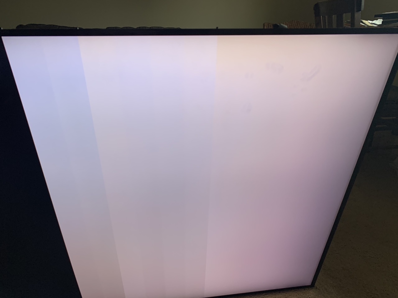

                                    With the interconnect between the two right edge boards disconnected, I get the image attached.
                                    The right side of screen is split in two patterns. Far right is evenly bright white.
                                    Other half of right side is vertical strips of very light grey, with varying darkness from center to middle right.

                                        sorry but I don't think that is right or I am not seeing the whole screen. Plus, it looks like you don't have the tcon cables in place as requested. Please confirm.
