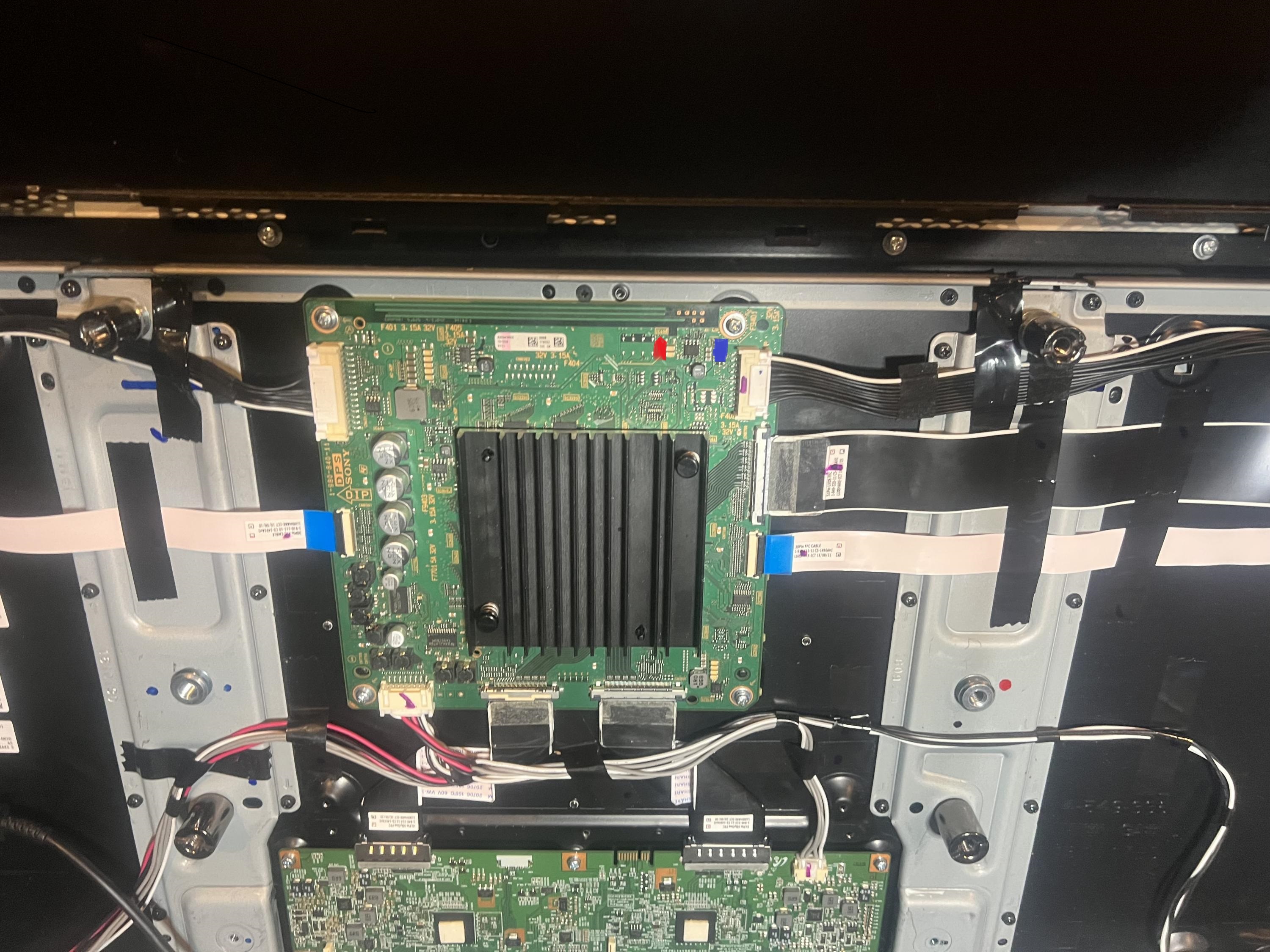

    Let me check and ill post my findings. One question can 12v be supplied to the fuse just to see if it will come or will do more damage?

      Re: Sony XBR-65X930D No screen
      Originally posted by yankys
      yes I have done the checks all seems good just not getting 12v at the fuse on t-con board, if you unplug the tv and plug it back in you have the amber green light on bottom of tv. then if you push the power button on remote you can get the white stand light but no picture. but each time its unplugged and plugged back in same thing over again.
          it does seem a little strange that all 3 boards would be bad tho, it may be something else but I don't know what it is.
            check second link down, post #29, see if that dps board is sending proper voltage to the mainboard if you have not.
                On the led driver board (it does not only that) there are 2 coils in series, grey big square, i've read a problem in those coils in another thread, check their resistances
                        been working on a couple of these myself this weekend.
                        If it turns on, your dps is fine
                        the cables that go from the dps to the tcon
                        examine them check for any damage they are easy to damage.
                        also on these if you power up without the tcon conencted up u end up with amber green lights flashing..
                        when that happens just let it power on then connect usb and leave it for hour or so ..
                        it mostly updates fine..
                        some times if it on blinking white connect the usb then it starts the update..
                        some time it takes longer..
                        when update dated it should respond to the remote.. power on and off etc..
                        also try menu commands to see if you have sound.
                        v unlikely u have 3 dead boards..
                            Check the led driver board as advised by davi.p
                            you should have 12v going from the led board to the tcon.
                            if you don't you have some issue there ..
