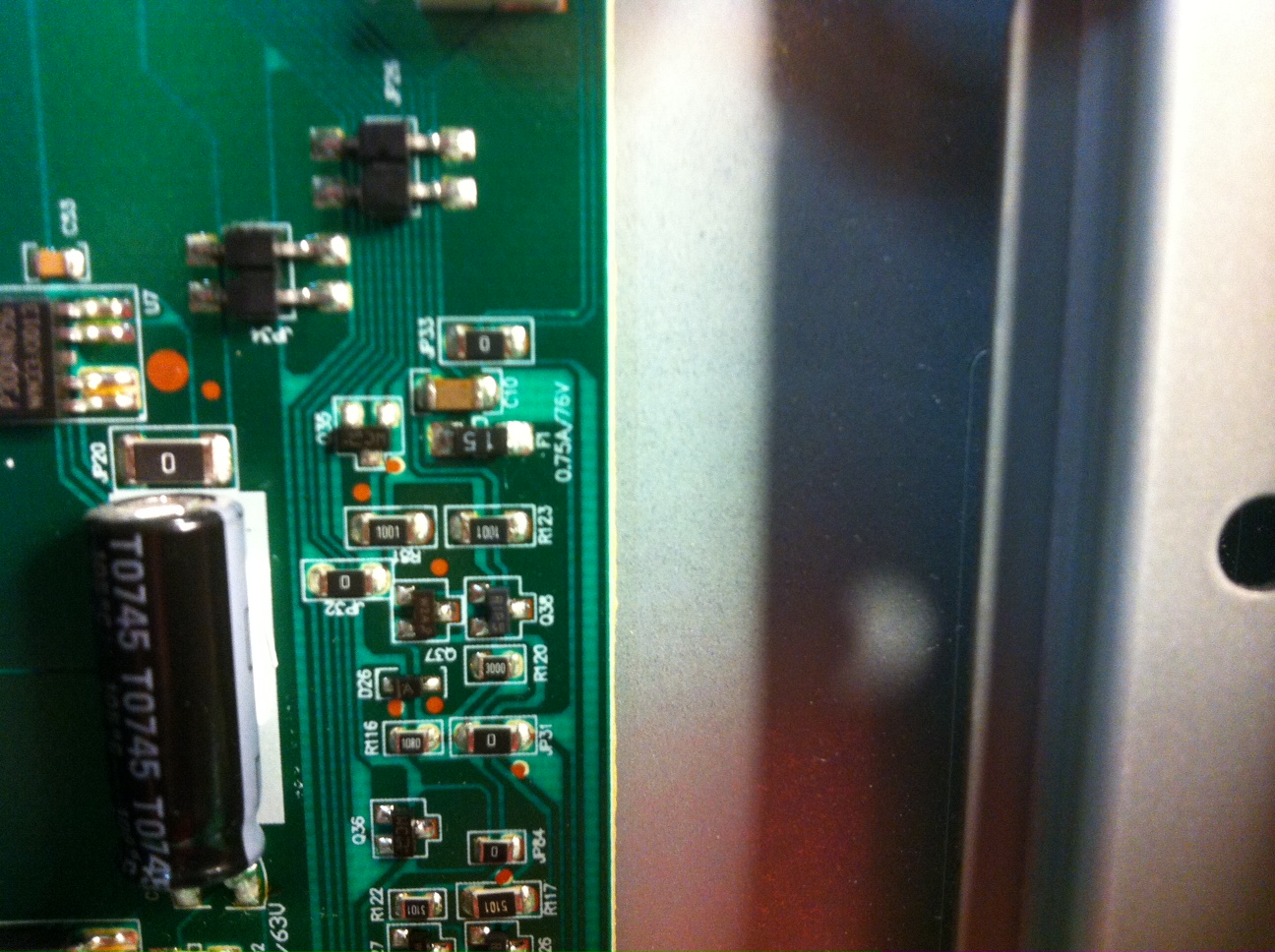

                I'm having the same issue as Torpex505. Plug the TV in, I get the red standby light. I press the power button and the blue light comes on, but no backlight on the screen. The flashlight test does show the menu on the screen, so it seems like just a backlight issue. Caps all look visibly ok. I also checked to make sure the 4 white fuses on the master invertor aren't open, but just noticed dpal's mention of the black fuse, which I'll test in the morning (near my bedtime here).
                Torpex, did you ever find a resolution?

                  The black fuse was the issue. I studied this TV for a couple of weeks off and on overlooking that fuse. The voltage measurements going in and out of the master inverter was not enough for me to diagnose the problem area. I did replace the inverter caps as well and ended up using a pico axial fuse soldered carefully. It is still working great.

                        Dgtech, not necessarily true about a fuse.
                        Fuses are thermal devices. They usually consist of wire that breaks when a certain temperature is reached. Now, they do not blow at their rated current -- in fact, often it takes two or three times that current to fail within one second. Fuses are rated as being time delay (they take around 30 seconds to one hour to blow), or fast blow (they'll blow within a few seconds at the rated current), as well as other categories such as anti-surge or very fast blow. BUT, if your fuse blows at, say 1 amp in 1 hour, it can also blow at 0.5 amps in 4 hours! It's an inverse square rule. (Note -- The characteristic tends to be inaccurate at low currents -- a 1 amp fuse will essentially indefinitely withstand half an amp or so. But it gives you a good idea about how the fuse behaves.)
                        In many cases, these fuses simply fail because they have run at a continuous current for too long and thermal fatigue has caused them to fail.
                        It is very rare for components to fail partially leaky, such that the fuse would blow now and again, and if they did, it would usually result in a lot of heat very quickly. For example, say the device did draw 1.5A at 24V continuously, enough not to blow the fuse. It would dissipate 36W of heat. For comparison, a typical small IC on that inverter can safely dissipate about 1W of heat before failure. So, if a fault were to cause 36W of heat to be dissipated, it would likely result in flames.
                        I do sometime board swap, but for something like a fuse, I'll replace that first and not worry about it. I might increase the current rating slightly; there is no harm in doing this, as the fuse is simply designed to prevent short circuits, not leaky current draw.

                          Thanks for the info. I somehow missed that the black fuse was the OP's issue.
                          I can simply put the leads of an ohmmeter on each side of the fuse while there is no power to test if the fuse is open or not, correct? I've been a bit hesitant to work near the inverter boards with the TV energized.
                            #93
                            Re: 42LG50 no backlight
                            You should test the resistance of the fuse when the TV is off.
                            A good fuse will read less than 2 ohms on most multimeters (the 2 ohms account for the resistance of test leads.)
                            A bad fuse will read "OL" or a single "1" on the 200 ohm range. It may read a few hundred kohm or a few meg ohm but it is still blown.

                              So, the 4 white ones measure between .3 to 2 ohms, so they are good. That one black one, when I put the leads across it, starts around 15 M ohms and slowly goes down until it settles around 9 M ohms. Is this what you were saying would happen if it's bad?
                                Yes it is bad.

                                  The bad news is that I can't seem to source this board (1420H1-20D-Master) on ebay (or anywhere else through a simple google search). I'm only seeing the slave inverter board, not the master. I suppose I can try to source the fuse itself and perhaps get lucky that nothing else is shot.
                                  DPAL - do you recall where you found that same fuse?

                                    It is bad... but that is good . Replace the fuse. Only if the replacement blows should you look for a new board.

                                        Since there are no real local stores that carry electronics supply/parts anymore and I don't really want to wait a week or more to order something with the chance it won't work (and not have a TV in the interim), I ran out to Radio Shack to see what I could find. Picked up an in-line fuse holder and a standard fast-blow glass fuse rated 3/4 amp. Since the fuse holder wires were a bit beefy for the surface mount soldering, I also purchased some 22 awg wire to transition from the lands to the fuse holder. Put it all in place and did a quick test before taping the holder inside the cabinet. I now have a functional TV again! And just in time for Dexter and The Walking Dead tonight. I'm considering ordering a few SMT replacement fuses for a permanent fix. I see Mouser has some that seem to fit spec in stock.
                                        Thanks for everyone's input on this problem - it's much appreciated.
                                        Oh, and pics of the jury-rig:

                                          Well, since you know the holder works... you can switch to using a proper fuse. Nice rig!
