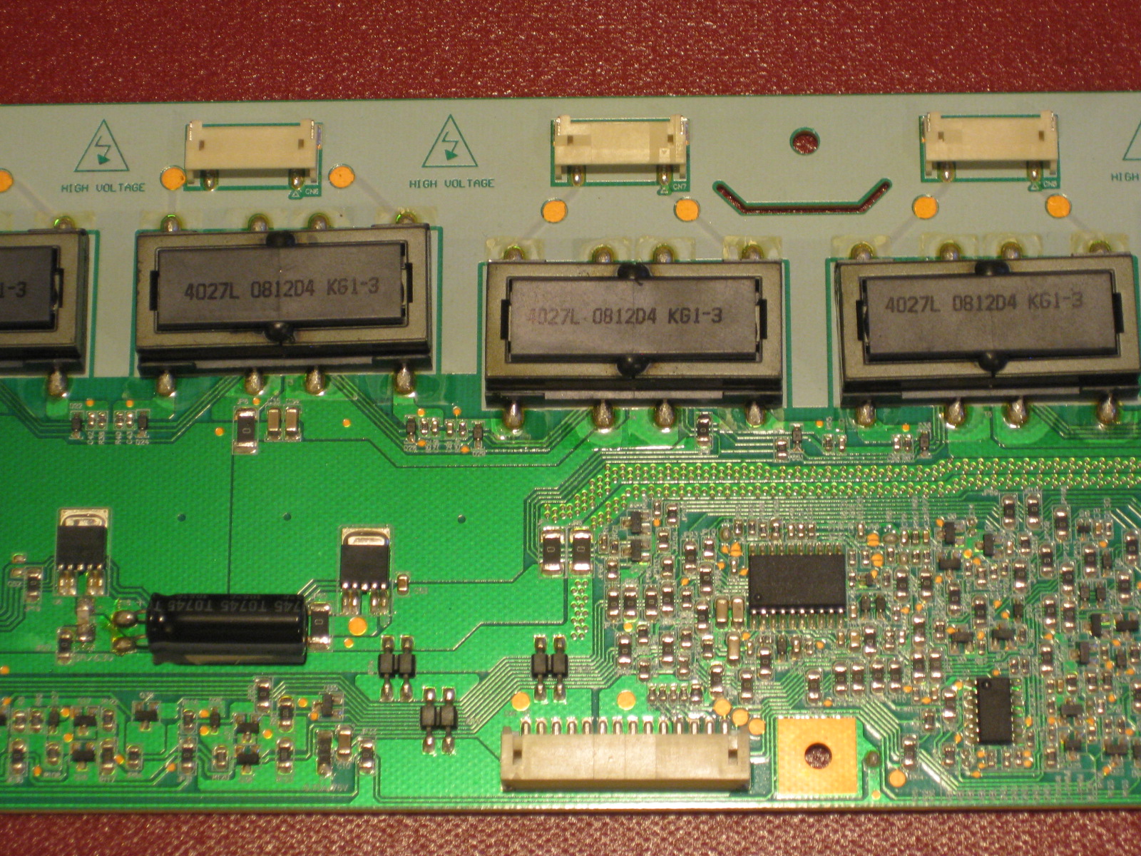

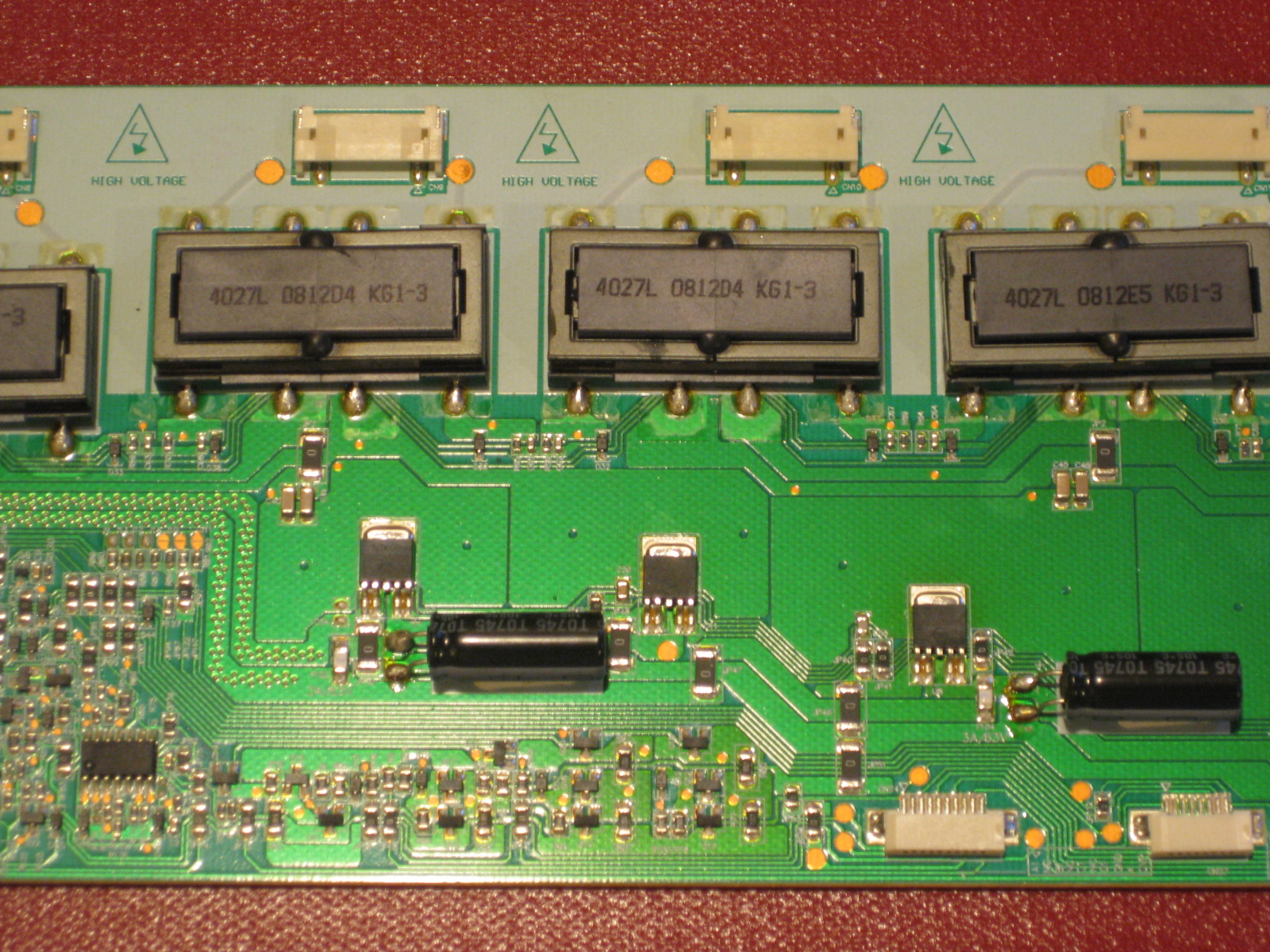

                    I would like high resolution pictures of the top and bottom of the inverters. Knowing the part number of the inverter controller IC would be a good starting point. Depending on your skills, replacing the inverters may be the only practical solution.

                      The model on the sticker on the pack panel is 42LG50-UA. There are dual inverters, I took the best pictures that my camera is capable of, hopefully they are good enough. There is nothing on the bottom of the boards, so I didn't attach them. Here are the pictures of the top of the main inverter. I took the pics in sections to get as close and clear as possible. Thanks.

                        What is the part number of the 20 pin IC?

                          I'm assuming thats the chip above the grounded mounting pad in the second pic? if so, it reads:
                          OZ964GN
                          T14932.2T
                          0746C
