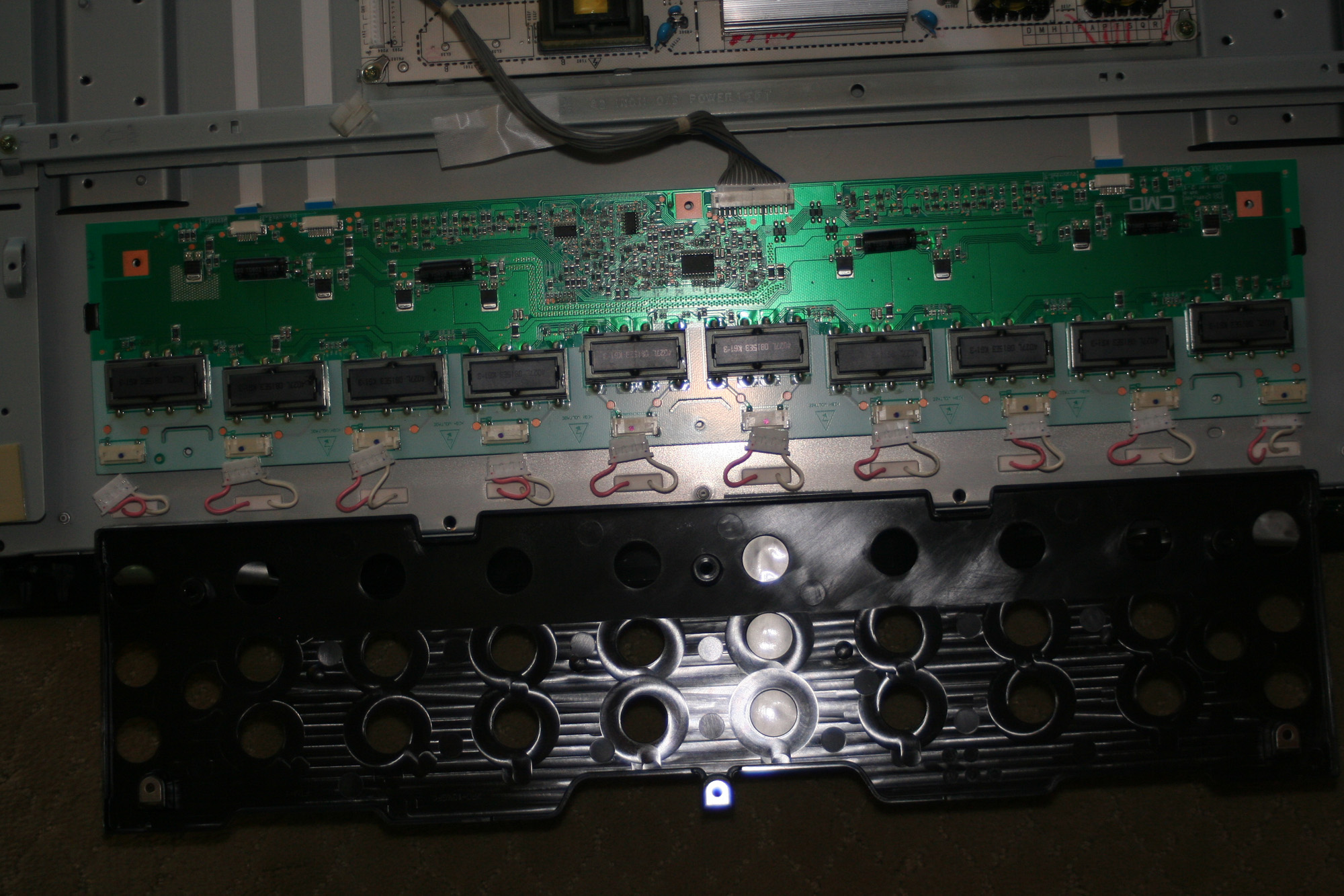

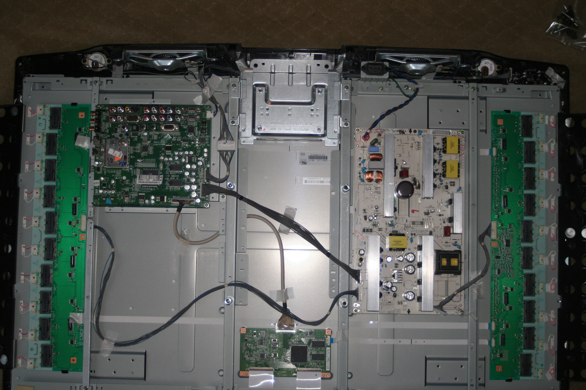

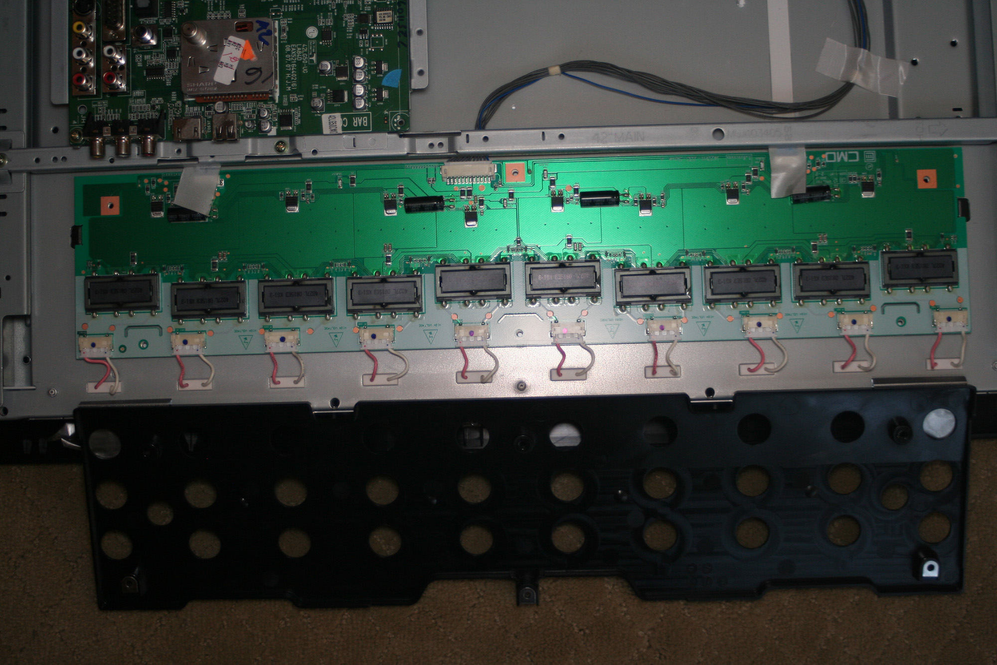

      Some photos of the 42lg50 innards

        Re: 42LG50 no backlight
        Looks like dual inverters. Scratch most of the ideas. Check the power supply to the inverters, as well as the control signal.

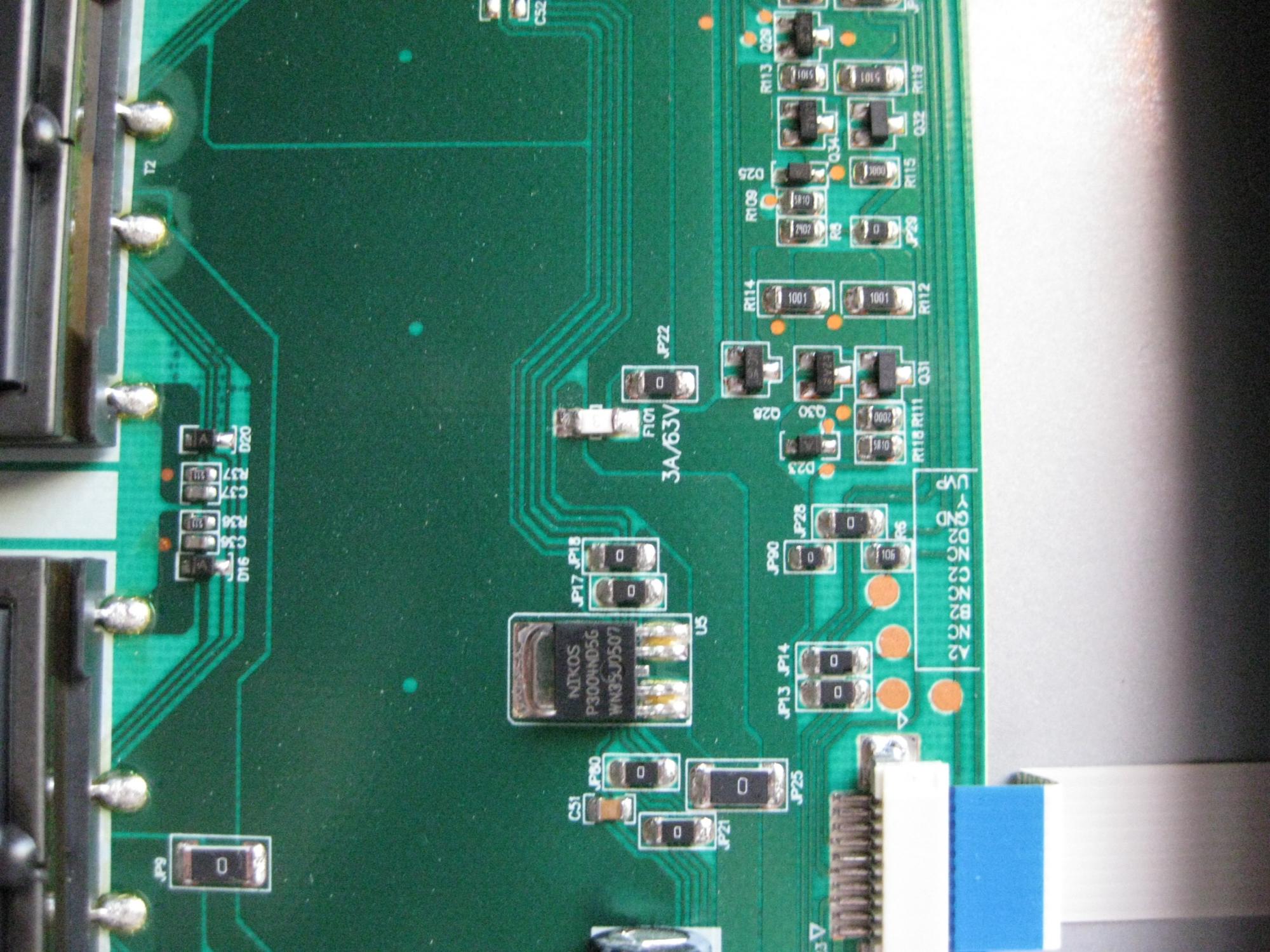

                              "the one single cap tested @ 14v..."
                              I found where the voltave drops is at a 3amp fuse on the primary inverter. It tests at 24v on one side of the fuse and 14v on the other side. Is this just a bad fuse or could something else be causing this? Am I better off forking out the $100 for a new primary?

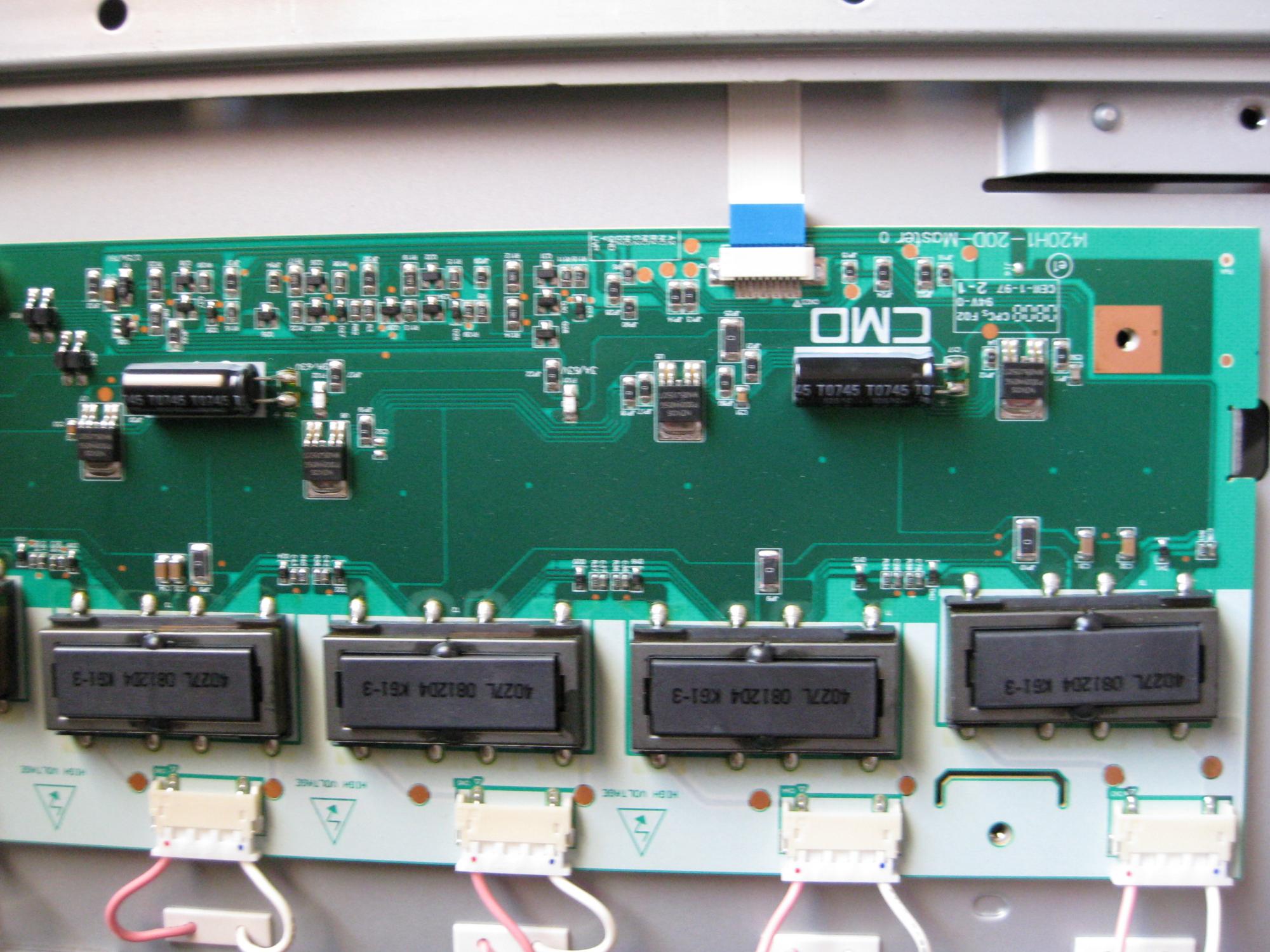

                                Here are the pics of the Primary Inverter around the area of the problem. One is a close-up of the fuse there the voltage drop is occurring.

                                  Remember this: there should be no voltage (0V) measured across a good fuse. What you did was perfect. If there is 24V on one side of the fuse and 14V on the other, this means that if you read directly across the fuse ( one lead on one side and the other side has the other lead) you will read 10V. Your fuse is bad. Now you have to ask yourself what took it out. It may have just blown due to a spike or you could have something shorted in the circuit.
                                    By the way, I'd check the FET's on that board too. Make sure they are not shorted. That could possibly cause that fuse to blow. If one is shorted and you only replace the fuse, the fuse will blow as soon as you power it up.
                                    Attatched is the data sheet for that FET. Only really needed if you need to find an alternative to the original part. (if the original type cannot be obtained)
