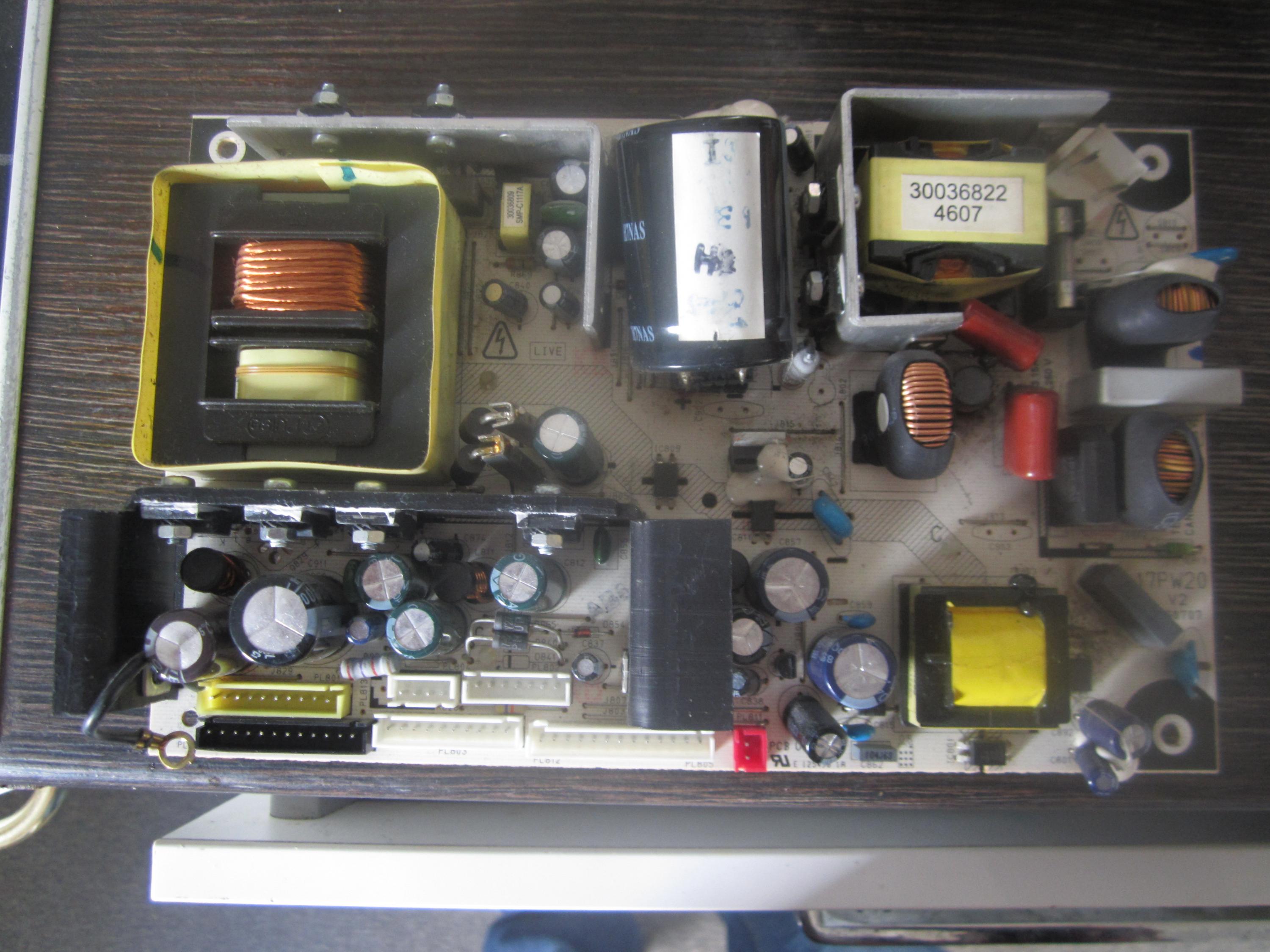

    I have a technika tv, 32 inch, around 10 years or so in age and last night when watching tv i heard a hissing sound and the next thing i saw smoke coming out the back of the tv, i instantly unplugged the tv. I took the back off tv to expose power board, then plugged in tv and saw smoke coming out of a capacitor, i will try and attach a photo below, see below for attachments of board and cap, and keep reading, maybe you can advise ?

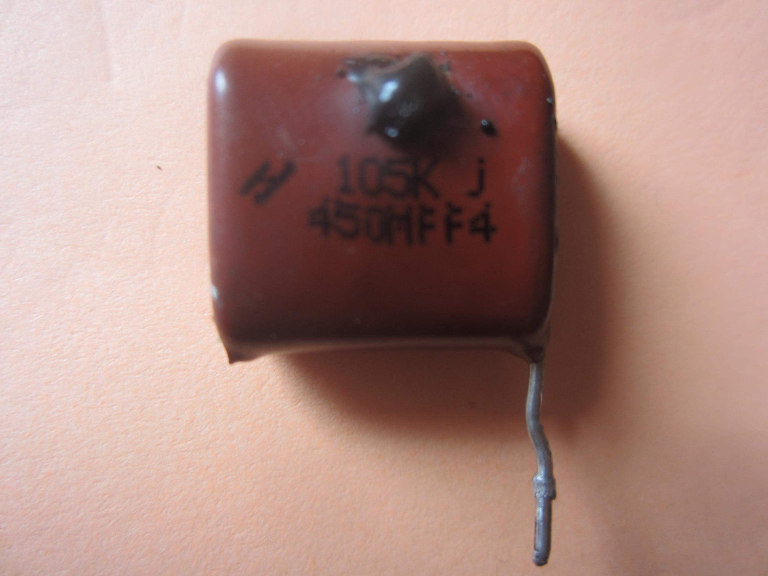

    The cap says on it: 105kj450mff4. This doesn't mean a lot to me as i'm an amateur when it comes to electronics, though i've undertaken some repairs such as fixing a washing machine replacing the carbon brushes etc.
    Although its a cheap tv id like to have a go at fixing it by soldering on a replacement cap. Also near to the cap that blew is another of the same type and same numbers written on it. This seems ok.
    My question: which replacement cap do i need to purchase ? Can anyone advise which one i need to buy, or a link to one etc ? Much appreciated if you can advise on what the numbers on the cap mean too and which cap to buy, not too cheap, nor too expensive, but something that will work, be reliable for a few more years.

    105=10x00000pF=1.000nF=1uF/450V
    Conclusion: 1 microfarad at 450 volts. Non-polarized.

      More Mff - Metallized Polyester Film Capacitor.

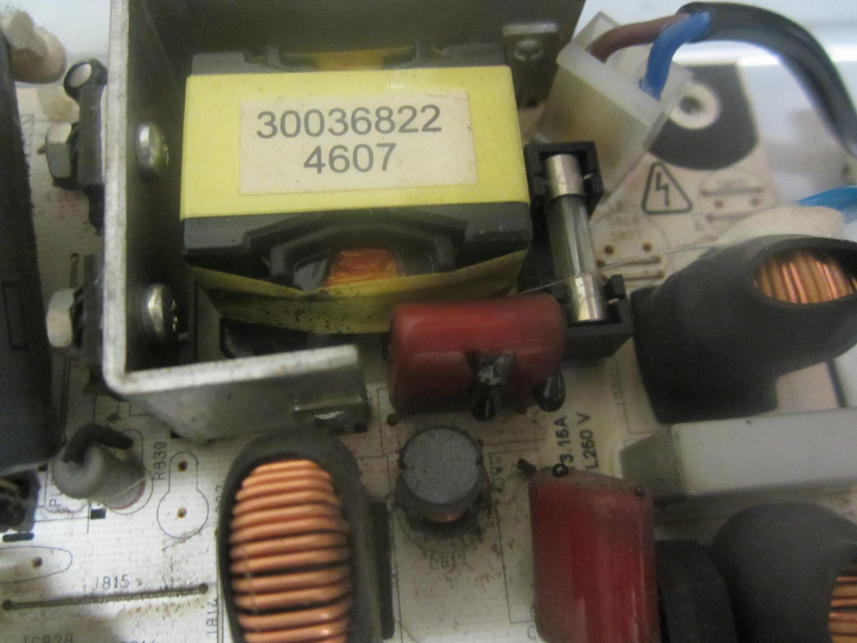

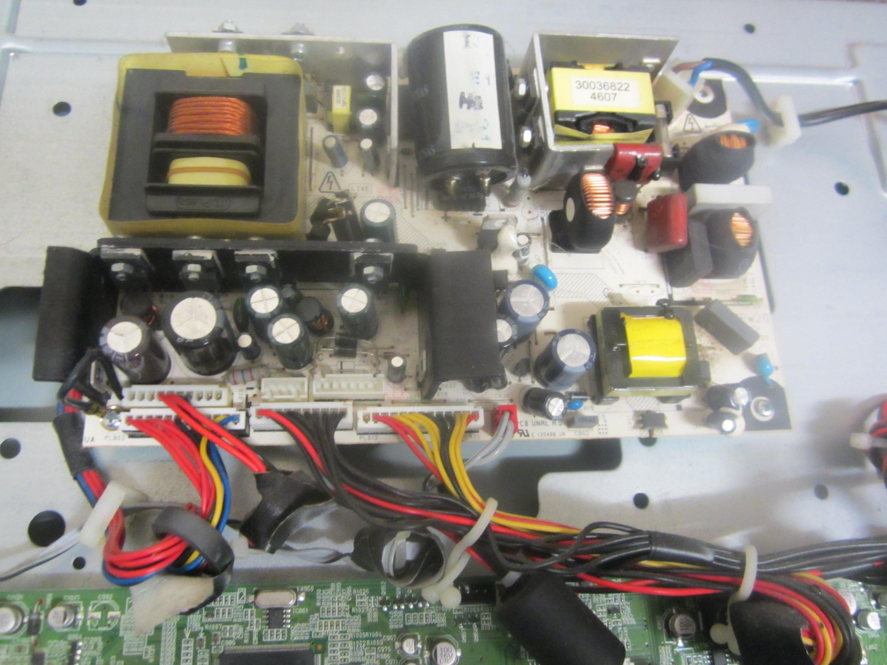

                  Ive attached a photo, its near to the top right in the photo attached to this, there are 2 of them, the one nearest the top is blown, the one on the slopping angle, its like that because i put it back in for the reasons of the photo.
                  Do you mean the tv may work ok without the capacitor on? It's removed ( the cap) but ive not tried the tv yet.
                  Also, what is an emi filter ? Im a novice at this stuff and gathering information as i go

                    The EMI filter is a filter that stops the oscillations from the power supply to reach the voltage network. Anti-oscillation filter. It can disturb medium-wave radios.

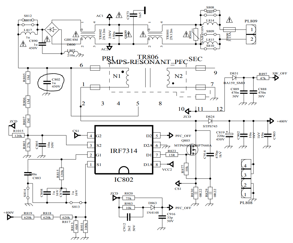

                        Too bad you never mention the model number, board number or even the caps location number. So I will guess that it is a 17PW15-9 and the location is C802 and if it IS this cap, you can try the tv with it removed.

                            Yes, it seems to be the 17pw20, C802 is the location and it should operate without it installed for testing, but should be replaced.
                              • 31281
                              Re: technika tv, 32 inch,capacitor replacement question, useful advice needed
                              important question is is it across mains (X1 class) or between the primary and secondary (Y1 class)

                                        The component location number is next to the component on the board (sometimes it is on the bottom as well) This number will be next to the component in the schematic.
                                        The board number can be located anywhere and can be more than one, this one is 17PW20 V2. The schematic for these boards can be hard to work with as the schematic covers many similar boards with some components installed in some and missing in others.
