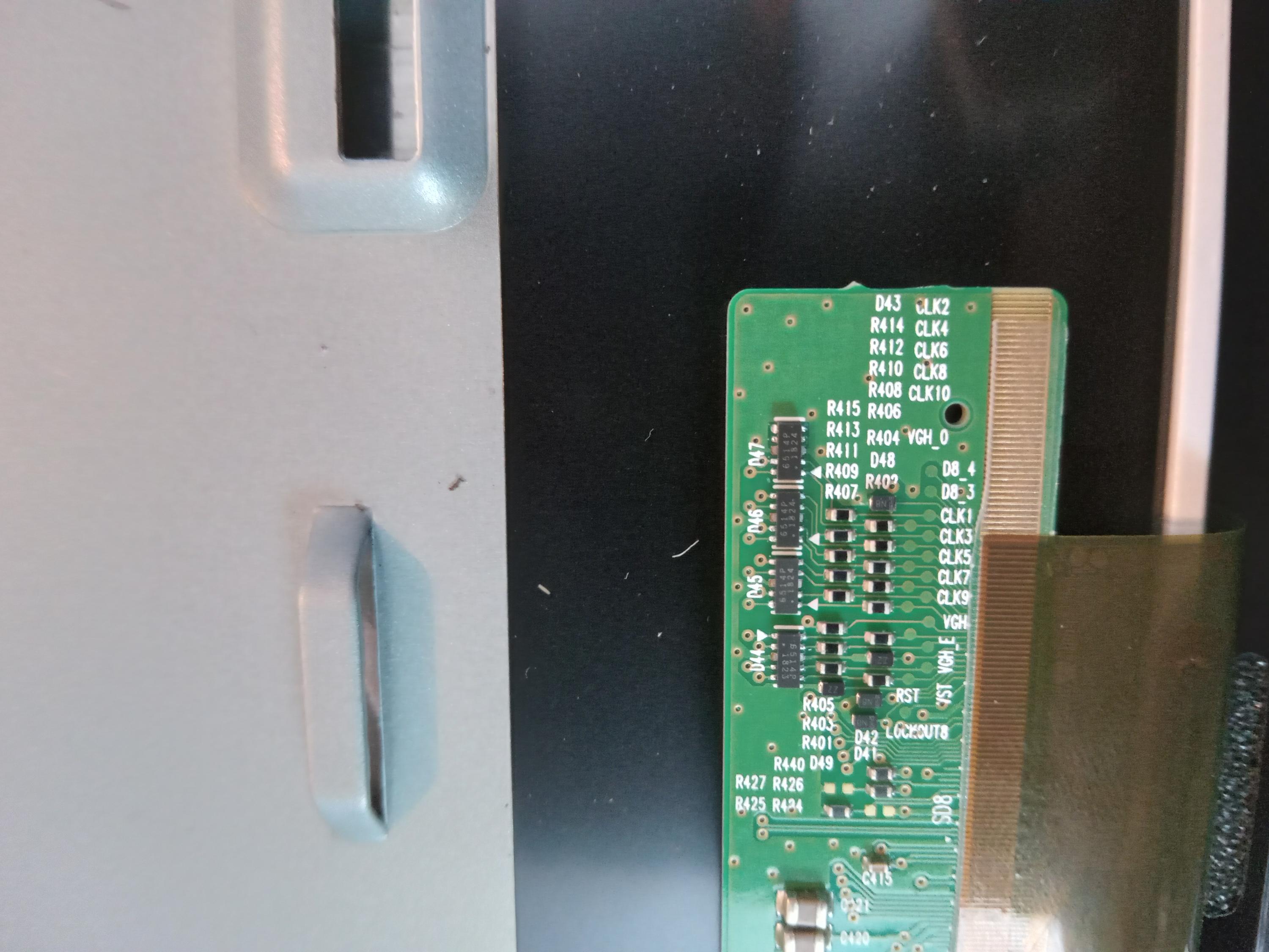

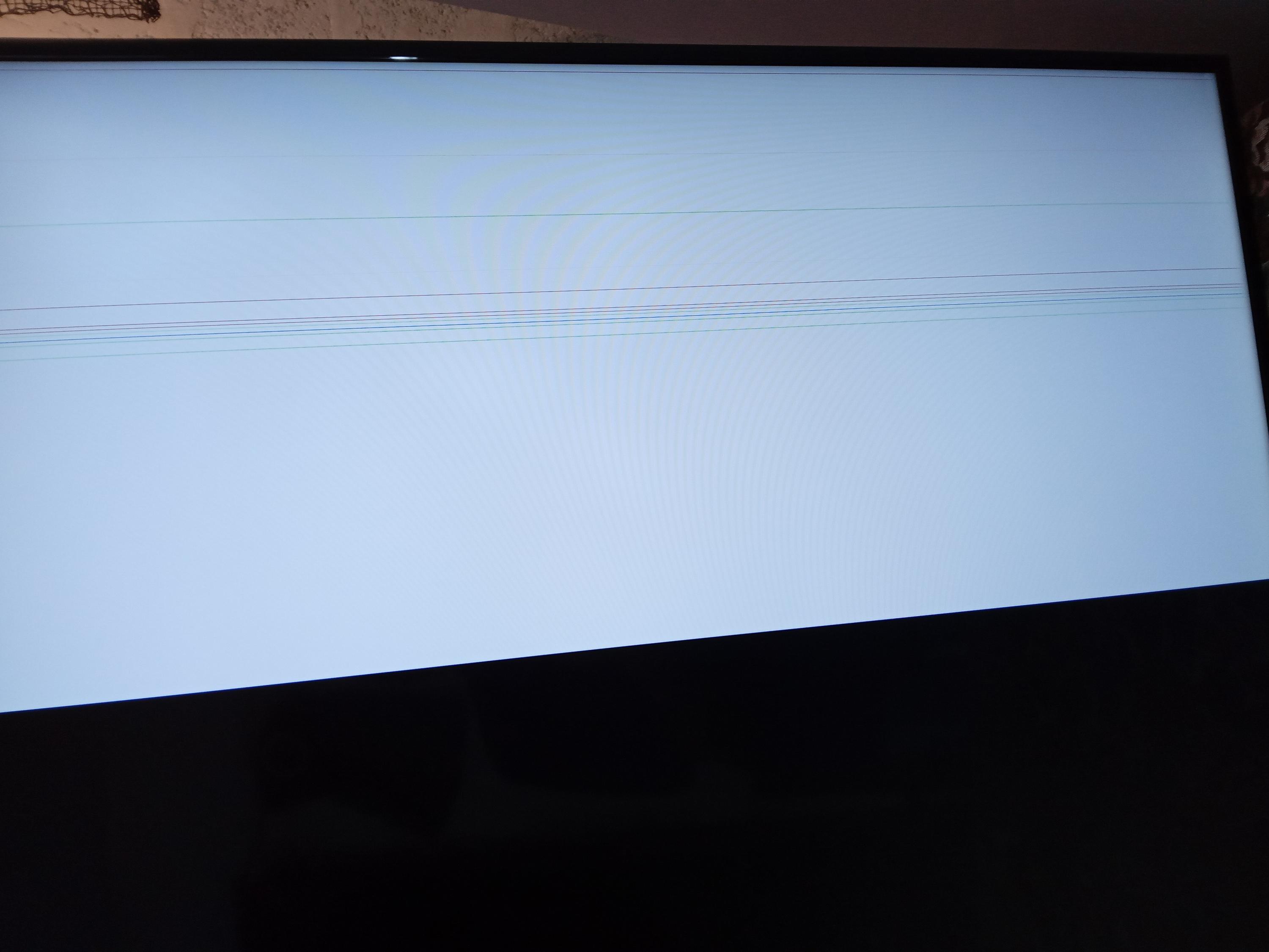

    Set turns on normally, backlight stays on, after about 20secs or so thin vertical colored lines appear on the left side of screen.
    First i tried disconnecting the lvds ribbon cables one side at a time to see if i would at least have half a picture, i got nothing.
    Hooked both back up and started probing voltages on both ribbon cables, got nothing, disconnected one and got all the main voltages/signals on both ( supply - 3.2v, 26.2v and 1.8v for signals).
    So started checking for shorts on this side - right driver board, mainly caps, nothing found, so decided to hook it back up and try the reverse with the left driver board and to my surprise the voltages all came up nice and steady, so hooked both back up, voltages all gone.

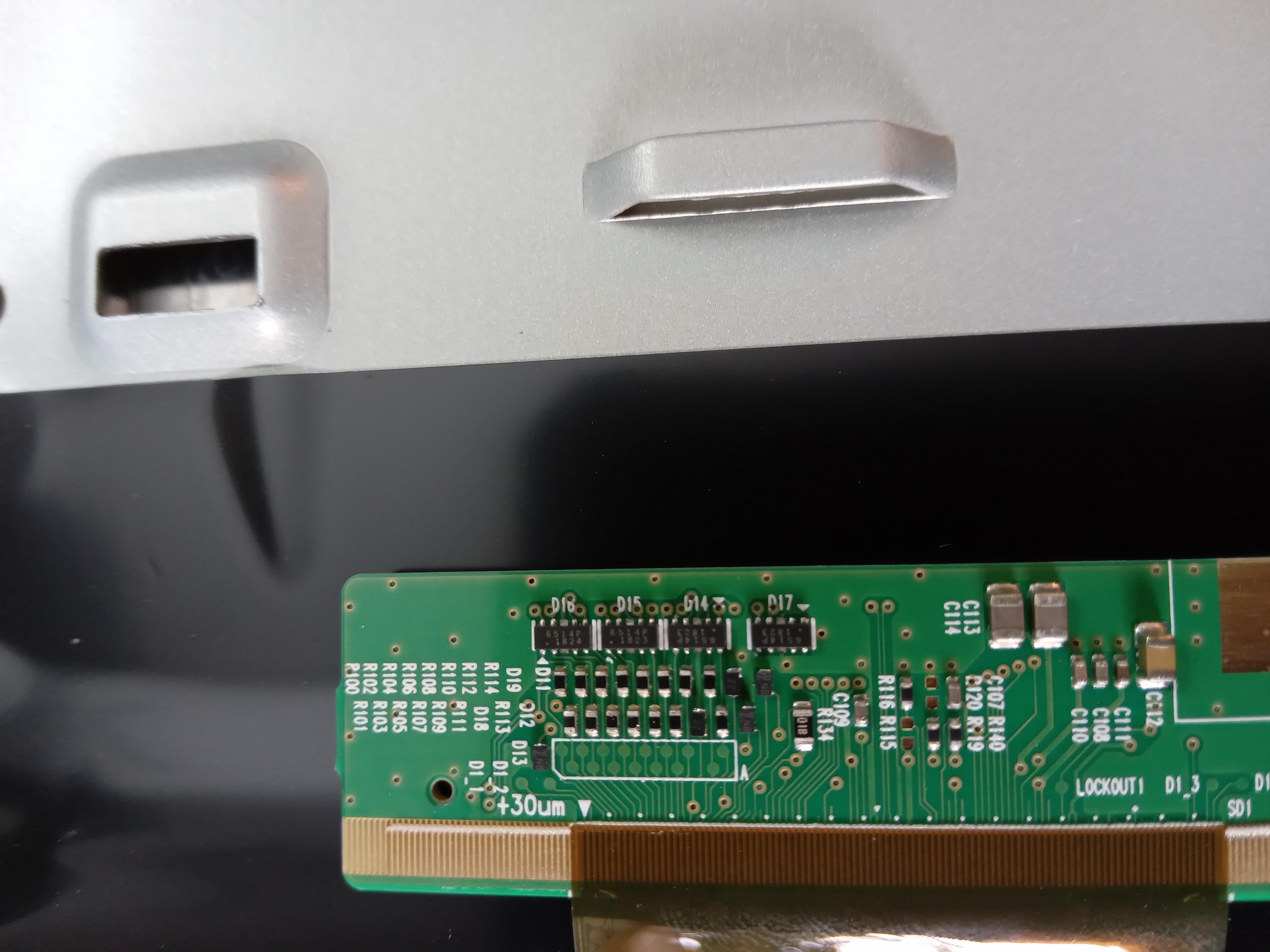

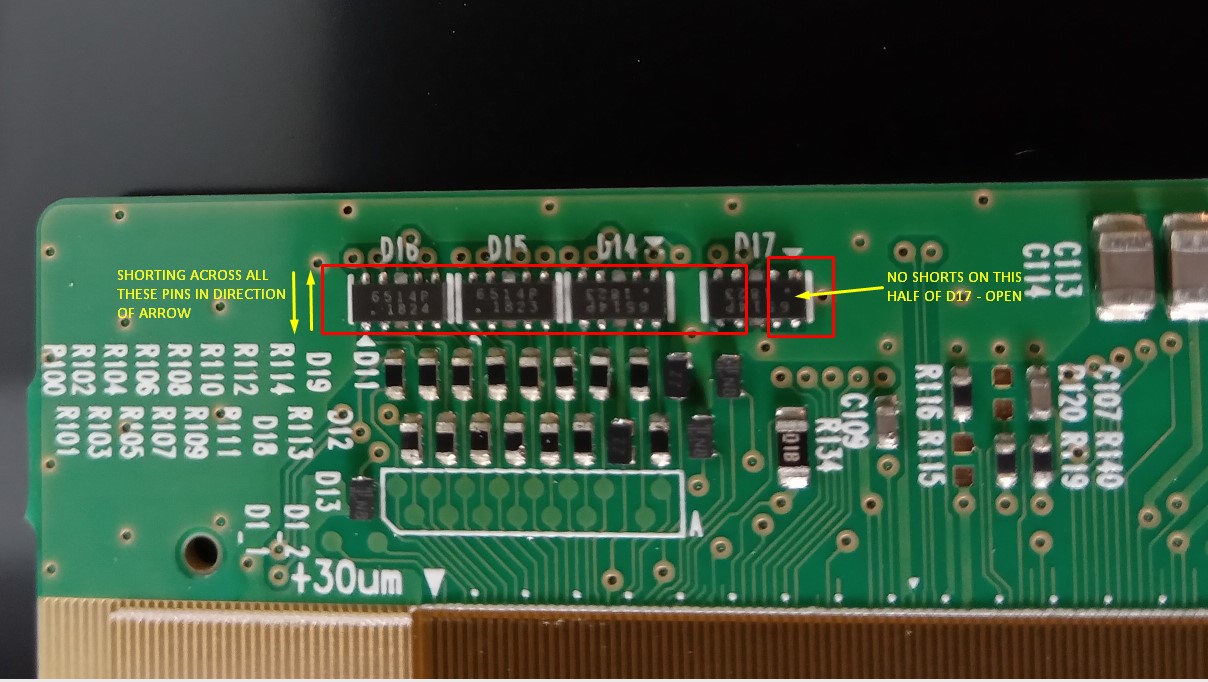

    So went checking further into both driver boards and found these packs (see pics below) all reading short across their pins on both boards, my question is are these the famous diode packs or resistor packs, if they are diode packs, how should these normally read/test.
    only d17 on right side board and d47 on left side board shorts on half of the pins, all the other packs on both sides read dead short/continuity across all pins, there are 4 driver boards, the two boards with the packs are the ones on the outer ends, i disconnected the other inner boards and still had the shorted readings, any ideas or help is appreciated as always.
    Also if i disconnect the outer driver boards one at a time i get a white segment, one side is all white,no lines (right side) and the left side is same white segment but with thin colored lines see last pic.

    Remove all those diodes. As far as I remember those are for protection purposes. You can either replace them or leave the board without diodes.

      So they are diode packs i take it, my screen must be really screwed for all those to be shorting like that, i will try your suggestion and get give an update later, Thanks so much for your HELP.

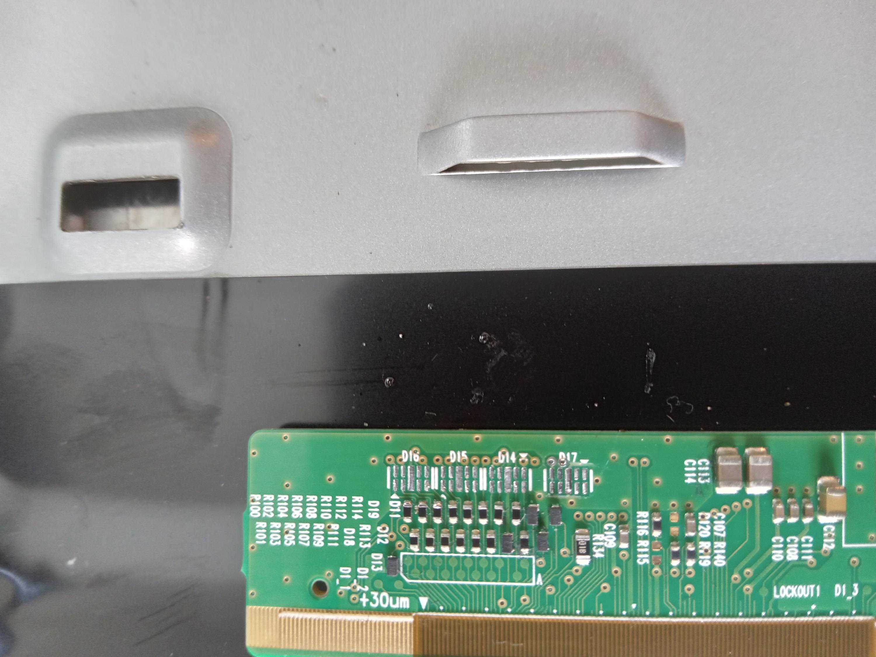

        Removed all packs on both sides, still shorting across on all points as seen in my previous pics above, packs give no reading by themselves, so i'm guessing they are open?
        checked remaining diodes in the area where packs were removed, they don't give me any readings, it's difficult to get my needle meter leads on the contact points but as far as i can tell i am making good contact on the pins while checking, as i said i don't get any readings, so there's not much else left in the surrounding area's, do you guys think i may have a totally shorted out panel,maybe the COF's?, as far as i can tell i don't see any signs of burning as they are under some sort of glue.

          Something will be causing a short, any Mlccs near by showing up shorted ?

            Try a small voltage injection and see what gets hot. It might be a component or the screen itself.

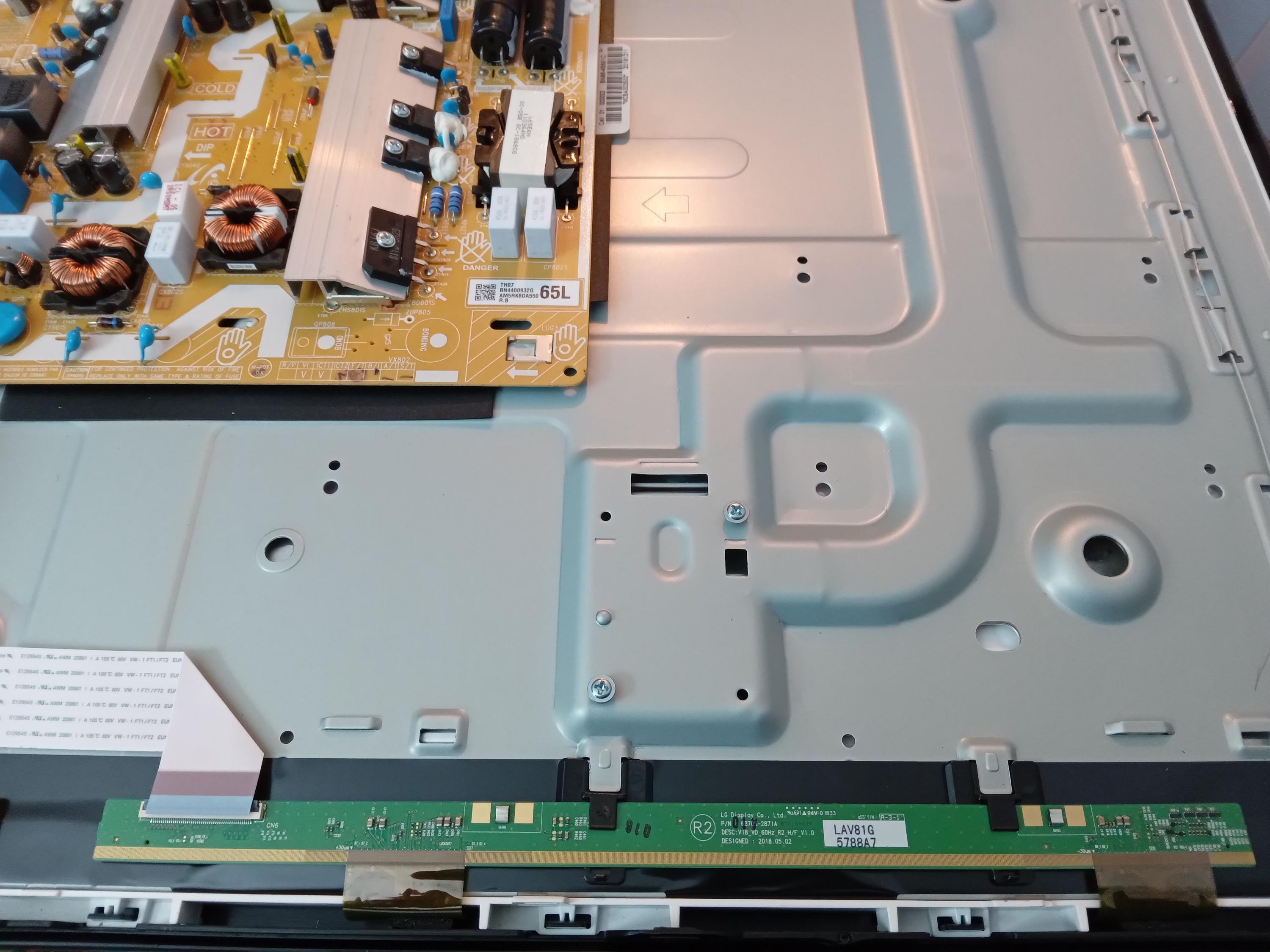

                          I spent countless hours looking and testing for shorts and poking and prodding. Nothing would make this TV work. Turns out it was a bad panel. TV gets sound when the ribbon cables to the panel are disconnected from the mainboard (there is no TCON in the TV in any one is wondering).
                          After removing the metal covers that protect the scalar boards, I found one of the ribbon cables from the scalar board to the panel must have shorted out and caused the problem. Under a magnifying lens, there was evidence of heating and damage caused by the heating.
