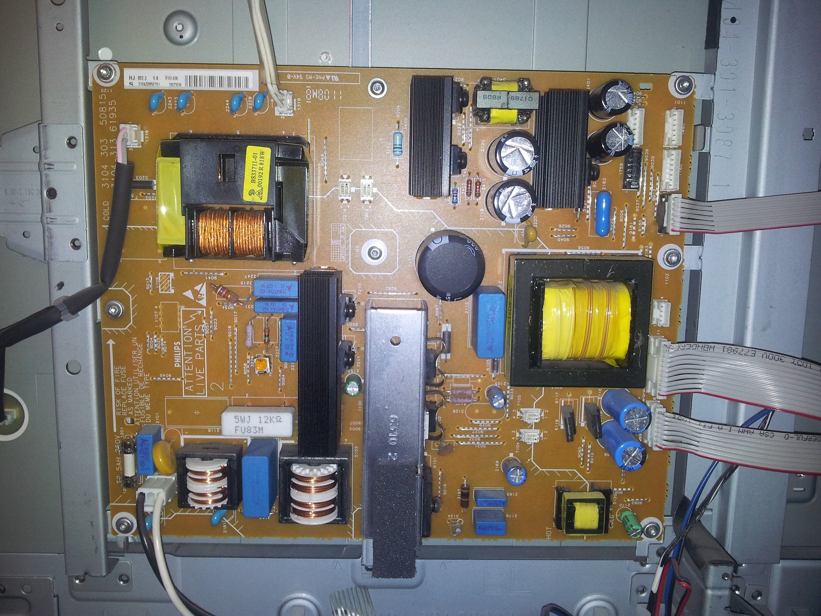

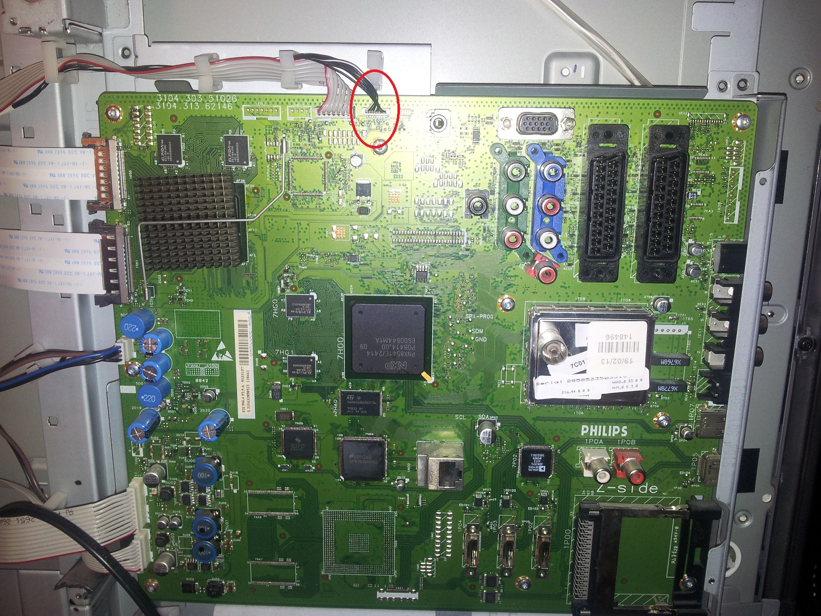

                        I just picked up an 42PFL9603D(/10) from a buddy that said it didnt turn on and didnt want to spend time fixing it.
                        I'm not very technically inclined, but I can something and want to learn more. I have turned away back cover and started troubleshooting. Can not see any obvious errors, but I have discovered a few things.
                        There is a buzzing sound when I plug the power cord in, not very high but just so you can hear it.
                        There are NO signs of life in the standby LED. Completely dead.
                        If I remove the cable that goes from "standby led board" to the motherboard, illuminates a green LED on the back (of the motherboard). If I plug that cable back again, the same green LED turns off again.
                        Is it bad caps as many suggest, or do I have to troubleshoot some more first? Could someone please point out which ones I have to replace?
                        I dont have a multimeter by hand right now, and if you guys mean its something else than bad caps that causes this error, I will just trash it..
                          Re: Philips LCD 42PFL5432D/37 - Bad PSU
                          Forgot to insert the pictures of psu and motherboard
