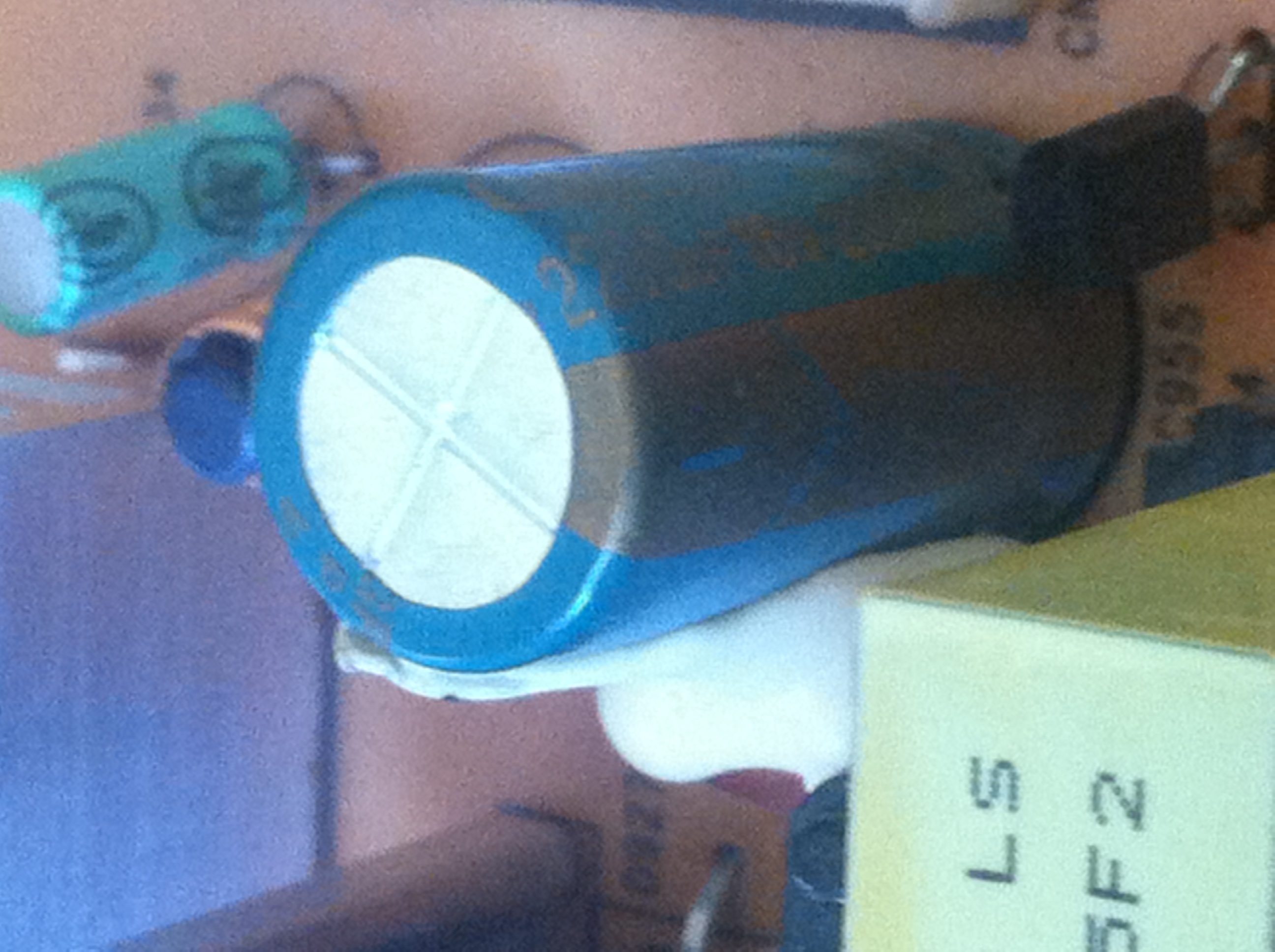

        Re: Philips LCD 42PFL5432D/37 - Bad PSU
        Originally posted by trixter
        Working on the same case. Just opened the tv and the caps on psu were buldging. Same values as the ones posted in first thread. Once caps A,B,C, and D come in, I'll solder them in and see results. The tv is now doing that chirping sound with no screen. I've fixed quit a few things in my time. Hopefully I'll add this on to the list.
        I always like to think to go back to the original problem. The caps were found to be bulged. It's hard for me to beleive that there are two separate problems. There may be a problem caused by the first, sure. There was never a whole clear picture posted of the original board (top and bottom). This is the one where the diode was changed as well as the caps. If you can do so, we can work from there.
        By the way, I think someone either shipped you the wrong replacement board or a non working board. You may be injecting another problem altogether into the set. Board swapping is ok as long as you know the other board works.

          #84
          Nuclear posted some decent pictures on page 2 (though I will admit they are a bit fragmented). These are the two posts:
          https://www.badcaps.net/forum/showpo...5&postcount=31
          https://www.badcaps.net/forum/showpo...4&postcount=38
          and schematic can be found here:
          https://www.badcaps.net/forum/showpo...6&postcount=71
          Well my board is still in the same situation. Seems no one has been able to fix this chirping issue.
          I just looked back at your previous posts in this thread. You said you have recapped the PSU, but what brand and series of capacitors did you use? Did you also replace the small caps?
          Other than that, clear, well-focused pictures of your boards would be helpful. Sure we already do have pictures and a schematic from other members, but sometimes there may be slight differences in the PSUs.

            #85
            If I am looking for burn marks or some disfigured component, I dont see how nuclear's pics are gonna help me. That is, of course, unless Trixter bought the set from nuclear. Each person should post pics of their TV due to the many different revisions of each board, or tv.
            Please post a picture of YOUR whole set opened up and one of each board inside.

                      #90
                      OOPS!!! Replace all of them again and pay attention to the markings on the board underneath. Sometimes it will be a circle with one half of it bolder than the other half indicating the negative side. Sometimes they will just print a negative sign on the board itself.
                        master hoarder
                        • May 2008
                        • 12175
                        • Bulgaria
                        #91
                        According to the pics on page 1 and 2 of this thread, the negative side of each cap (the side marked with a stripe) should be aligned with the shaded semi-circle on the board.
