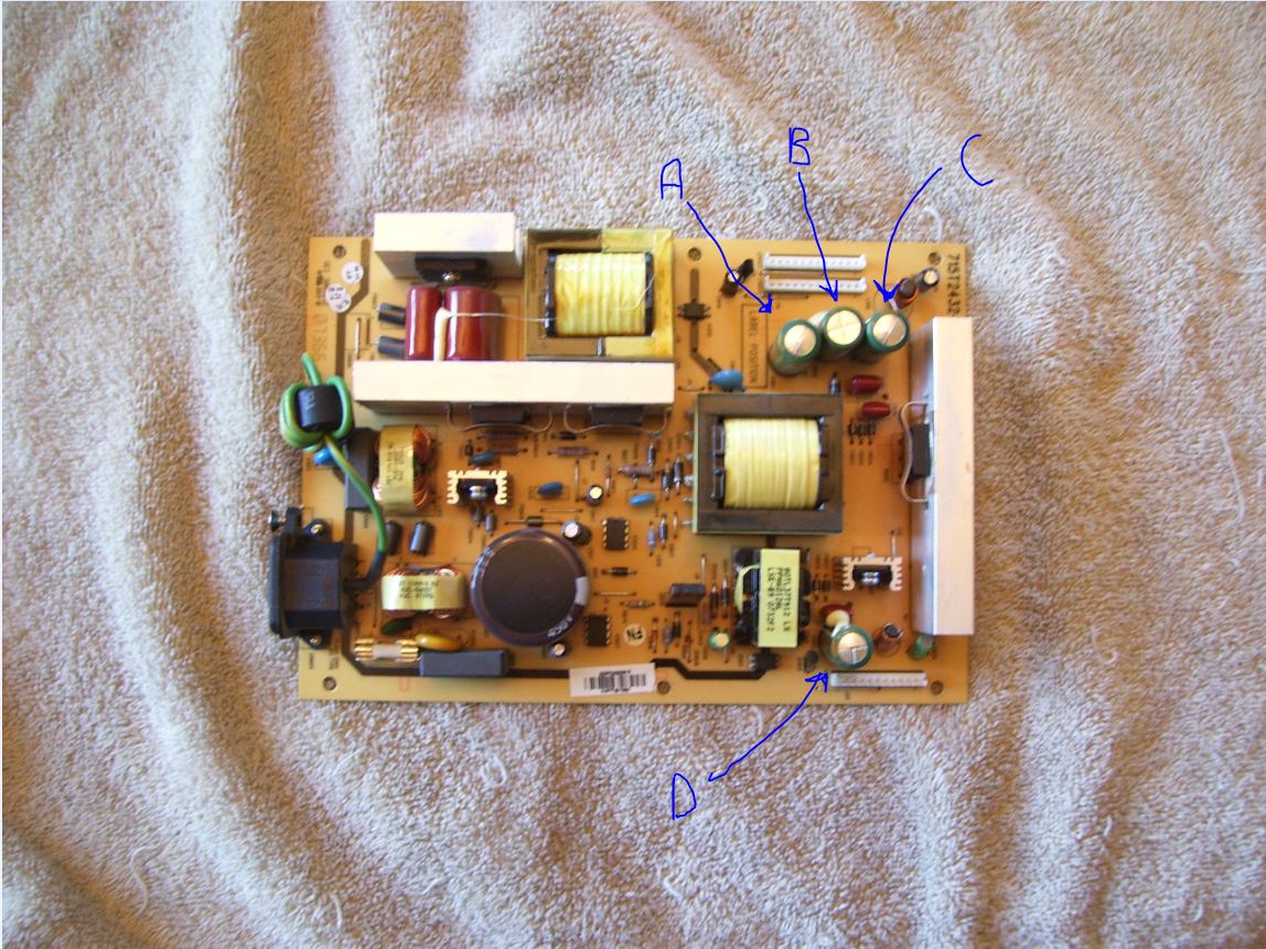

    Hello, I'm new here and new to replacing capacitors. Luckily I'm in the right place, I have learned a lot by poring over the helpful forums and I'd like to thank all the experts for their info and advice. I've always been a bit of a tinkerer and have experience in building/modifying PC's and a little experience with soldering so I believe this PSU is fixable.
    On to my problem. The pics I have attached show a PSU from a Philips 42" LCD. It made a sort of humming/hissing noise for about a week before it crapped out. I can turn on the TV, it stays on for a second or two and then goes back to sleep mode (red light).
    Doing a little reading here I learned that the caps on this PSU are cheap garbage. (Capxon) I found a replacement PSU for a reasonable price and ordered it. But I would like to attempt to fix this one and replace the caps with better quality ones. I need a little nudge in the right direction on which type/brand of replacements to use.
    Bad Caps:
    A, B, & C - 1500uf 35V GF 105 degrees C
    D - 2200uf 16V GF 105 degrees C
    I'll post my results, success, failure when I'm done and thanks in advance for any help.

    Please post diameter and height of the existing caps so we can help get the right size. Caps come in different size and shapes.

      Re: Philips LCD 42PFL5432D/37 - Bad PSU
      Sorry, trying to track down something metric to measure them, hehe. A rough estimate using standard inches and converting to metric is something like:
      A, B, C, diameter 1.3 cm - length 3.5 cm
      D, diameter 1.3 cm - length 2.7 cm
      Hope this helps

        I would wait for others to verify since I'm just learning and don't know all the different lines associated with the different manufacturers, but assuming you live in the USA
        Panasonic FM
        http://search.digikey.com/scripts/Dk...name=P12409-ND
        and
        http://search.digikey.com/scripts/Dk...name=P12369-ND

          Wow, too bad you ordered the replacement board already. If the cap problem is the only problem (most likely it is) then you would get away with only spending about $4.00 to fix this. I hope you can get a refund.

            or this might help
            A, B, C, - diameter .5-.51 inches - length 1.375 inches
            D - diameter .5 - .51 inches - length 1 - 1.0625 inches
            yeah, I didn't want to resort to ordering a new board but I need this TV working ASAP. Since I am also new to this I don't know how well I will do replacing the bad caps. Also, I didn't really expect such quick replies, This site gets better by the minute

                Replacing the caps is very very easy in your case. The caps are out in the open and they're normal values. It might be quicker for you to get the caps and put them in rather than to wait for the board to arrive. Who knows, maybe you can find a member who has experience that lives near you. Seriously, these 4 caps, I can remove and replace within 5 minutes - having soldering iron and stuff already of course.

                    Size (resist jokes) should be similar or a bit smaller, I think. Obviously, if you get caps too wide or tall, they may not fit in the tight spacing or you may not get the cover back on. So stick to as close as possible.
                    The ones I listed are right on or a touch smaller than what you listed. Of course, if this were a carpenter's site, you must measure twice and cut once! So please double check your measurements and the website.
                    From the picture, cap B is the only real concern diameter wise. If the replacement caps are too fat, you may have troubles getting B in. Assuming the A, B, C, and D are all shorter than the tallest thing on the board, height should not be an issue even if you are a few mm off in measurement.

                      One other thing. I count 7 smaller caps (2 green, 5 black). You may want to list those values, size and get replacements for those as well.
                      Caps don't have to bloat or leak in order to be bad. You may not end up using the caps, but these smaller caps should be cheap (like 40 to 60 cents each).
                      So replace the bloated caps first and test. If that doesn't work, post another clear close up picture (use macro mode) of both sides on the board.

                        What you're looking for is caps with a 12.5 mm diameter (or less if you want). For the height - doesn't have to be exact match, just somewhat close. As long as you can put the power supply cover back on without hitting the caps, that's all that matters.
                        Now the replacement caps - you need to find out the series of the CapXon caps. It's usually a 2 letter code printed on them (KF, KM, etc.). This will allow you to determine what replacements you need.
                        Generally for KF series, you can use Panasonic FM or equivalent (possibly Chemicon KZE?). For KM, you can use Panasonic FC or equivalent (Chemicon KY/LXY/LXZ, or Nichicon PW/HE).

                            Does "GF" sound right? The only other writing on all four is p727 and "VENT" under that. In the meantime I'll look around and see if there is a Capxon GF series, but I will need help matching that up to a quality brand. Thanks in advance.
                            Update: It appears there is a GF series Capxon. Can you confirm?

                              Dude seriously, with there being only four caps to replace, this is getting to be too scientific. Keep it simple, this is your first recap.
                              Lets be real for a second. Even if you replaced these caps with the same brand (which I dont suggest), the unit may work for years. Some monitors with these bad brands dont fail until year 6 or longer. Even if you soldered in new capxon caps just to see if this fixes the unit, fine. Then you can take the time to enjoy what you have until you've done some research into some better caps just in case the unit fails later. Depending on how hard it is to take this thing apart though, you might just wanna do it right the first time.
                              Just dont get too caught up in the science of it all.

                                Yes. Now I see that you even mentioned it in your first post, but I just never saw it .
                                Anyways. Looks like United Chemicon KZE and Rubycon ZL are good matches for those CapXon GF caps. That means Panasonic FM would also work so any of these 3 choices should be good. According to datasheets, Nichicon HE and Chemicon KY are not as good as CapXon GF. But then again, CapXon GF are probably much better on paper than in real world applications, so HE and KY might also work.
                                You can get Chemicon KZE and Panasonic FM both from Digikey and Mouser. Same goes for Nichicon HE and Chemicon KY. Rubycon ZL is avaliable from here (badcaps.net), but I'm not sure if Top Cat has the ones you need, so you should check that.
                                Let us know how it goes and like Dgtech said, keep it simple and don't worry too much. Those CapXons are already bulged so you can't get much worse than that.
