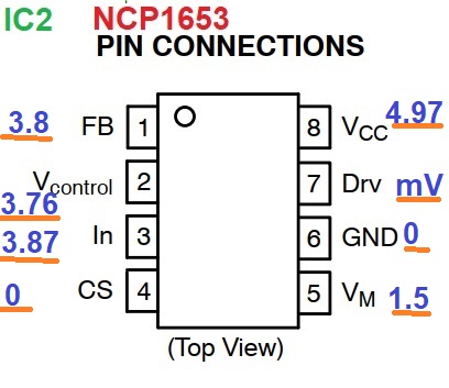

      Re: Can you dignose from the photo ? . Toshiba 65S2650EV
      R37 replaced . measures ~5.6k Ohm in-circuit.
      PSU powered : 5VSB = 5.2V
      PSU Auto-Started : 5V pin = 300mV. 12V Pin = GND . SHORT ( I didn't realize that before ). No High V
      IC3
      Pin12 VCC = 6.24V
      Pin16 Vboot = 6.04
      IC2 - See Image

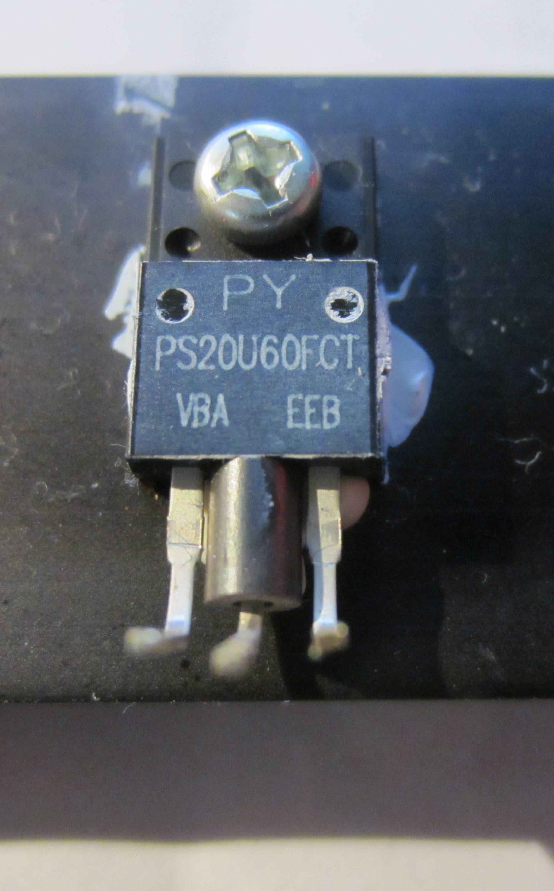

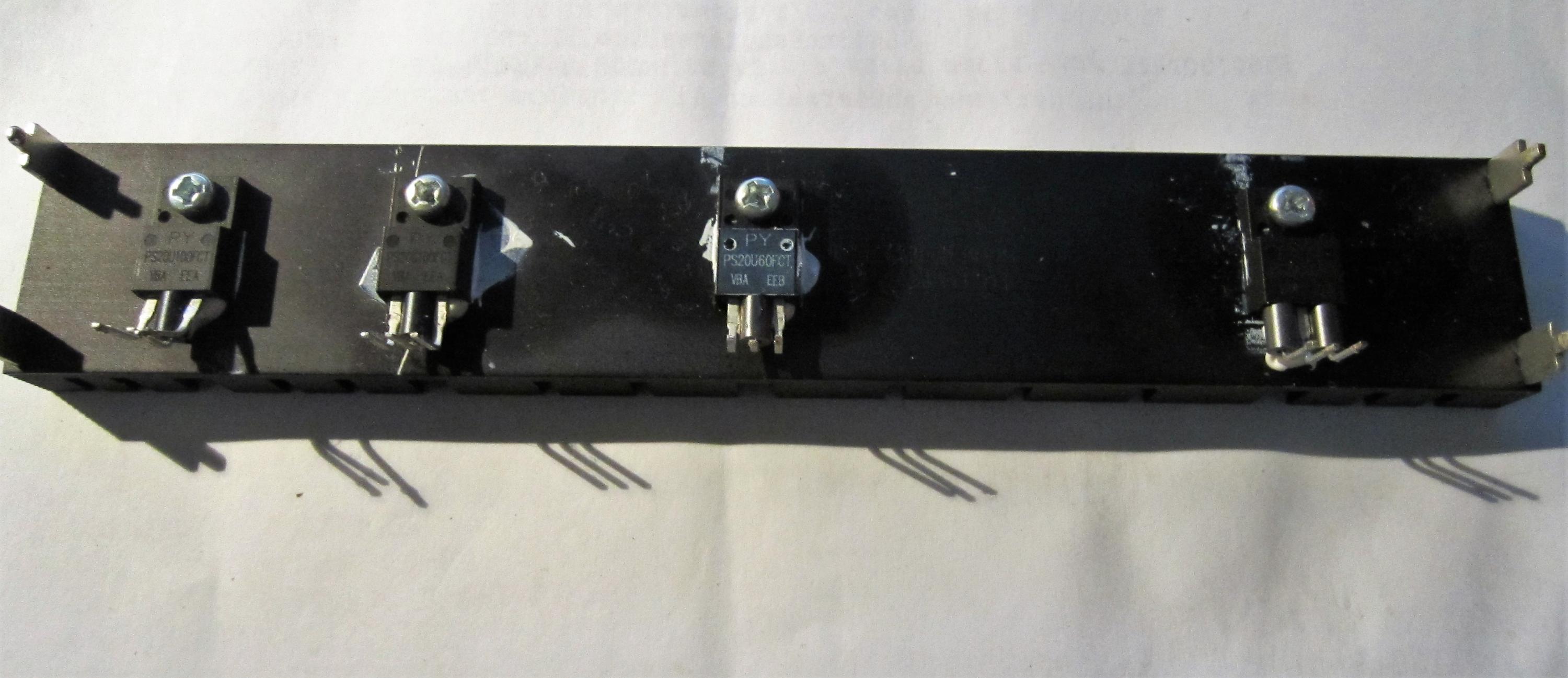

                        Heatsink out
                        2 x 60FCT
                        2 x 100FCT
                        Any special way to check these Schottky ?

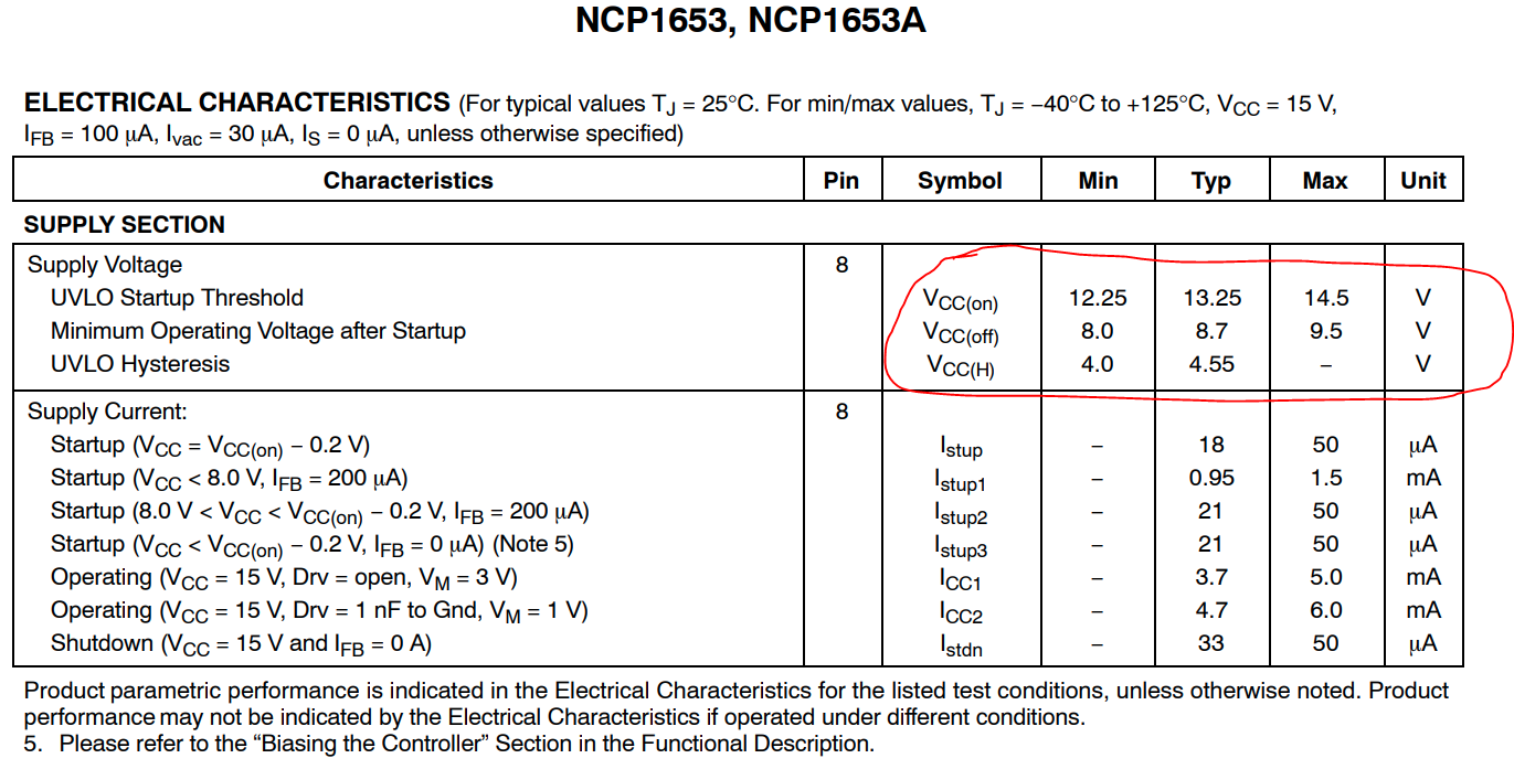

                          The PFC is not working, this because its vcc is below 8,5v, i told you to measure pin1 q10, i guess it's a bit low, test also pin2, if it's around 4,9v then remove ic2 and test again pin1&2... the idea to remove heatsink is not good because there's no short in the output, forget D13 for now, it is good until you don't test it outside and it's almost 100% ok
                            IC2 is PFC circuit. you say its Vcc is below 8.5V = too low ?
                            report Pin1 Q10 Voltage, and Pin 2 & if it is ~4.9V - remove IC2 and measure them again.
                            I'm sorry, but I can't find q10 ? where is it ?

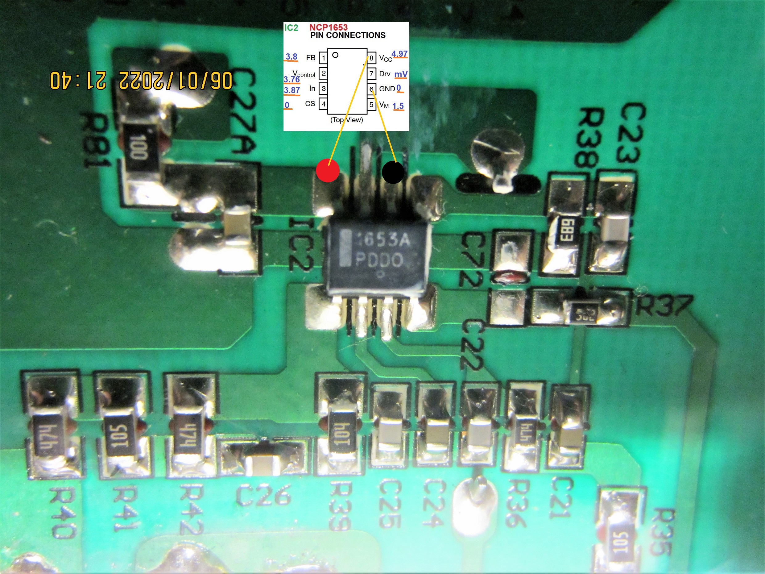

                                IC2 is PFC circuit. you say its Vcc is 4.98 below 8.5V = too low ?
                                report Pin1 Q10 Voltage 11V, and Pin 2 10.9V & if it is ~4.9V - remove IC2 and measure them again.
                                So, Q10 looks OK , but IC2 Vcc is very low
                                I uploaded IC2 Vcc test to be sure I did not make a mistake in the pins
                                  Where it is the fast reply box??
                                  Check the path from q10 to ic2, so D6, Q11, ZD3, R81..
                                        See Photo
                                        Q11 is a transistor
                                        Resistors near IC2 are OK
