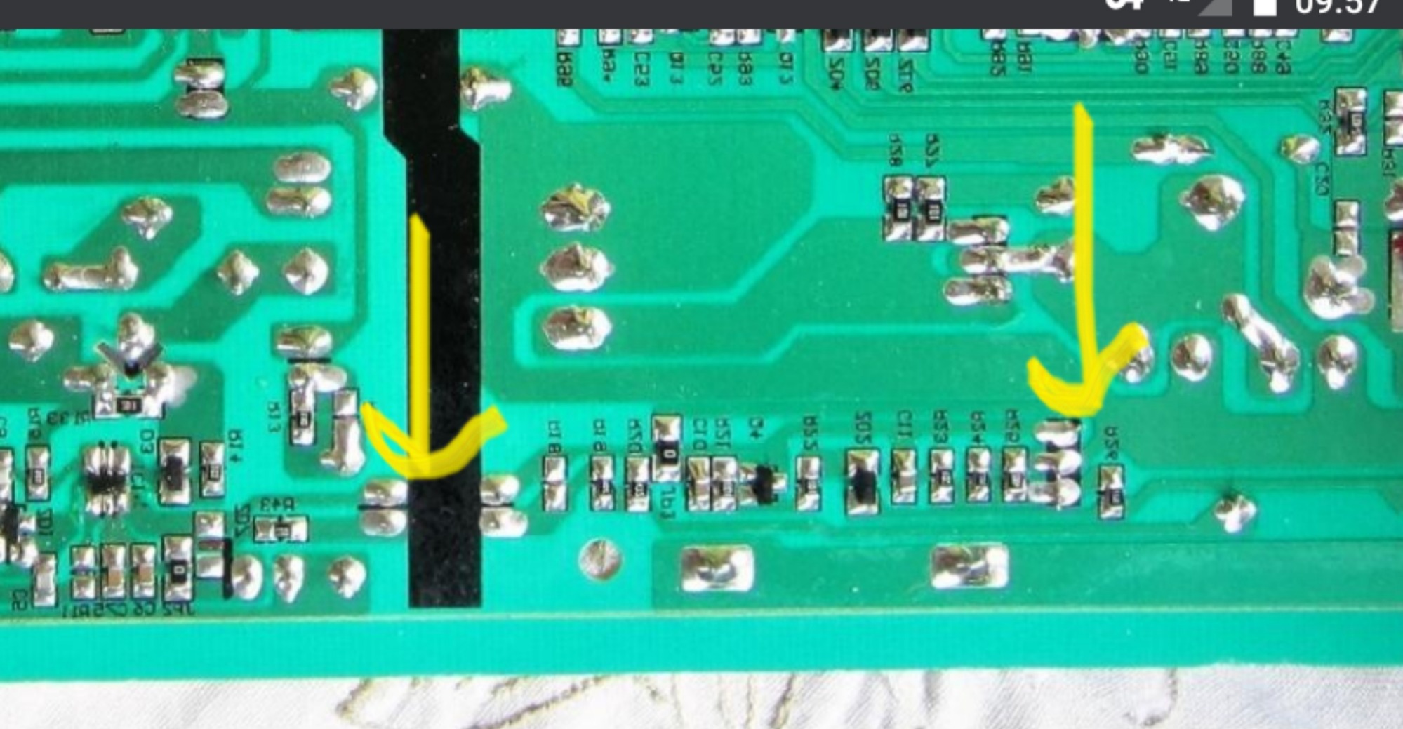

    I made a mistake watching the pins because under side photo is mirrored, so the test become so:
    Test in volt on the IC3 pin12 with psu alone.. try also to jumper PS with to gnd and test again IC3 pin12
    the red glue doesn't matter..

      Re: Can you dignose from the photo ? . Toshiba 65S2650EV
      I am just curious about that red .. paint ?
      I can check Pin 12 V with PSU alone, in standby of course. This means the IC gets VCC ( maybe not proper V
      than you suggest I short PS pin to GND ? directly or with 1kOhm ? and check #12 again . Like, sounds a bit strange to short PS Pin to GND . Is this is like the ON signal ? because as I understand, if PS is PSU-On line it should get Voltage, not GND
        Red thing is glue as i said. Since PS is not gnd with PSU alone then is pull-up-ed by a resistor to 5v somewhere, so no need for resistor..

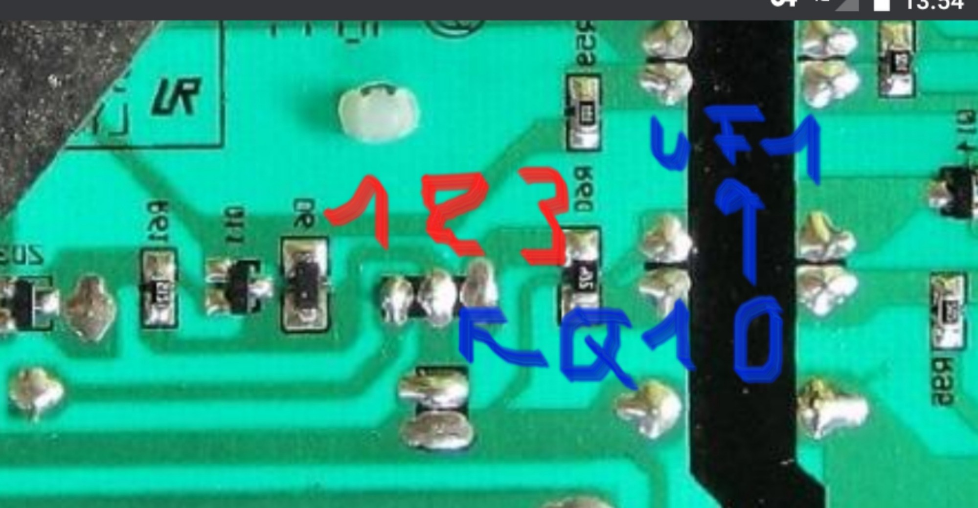

              * From what you say , it is obvious that you focus in the Q10 transistor : I will take it out and test it.
                i was happier if you did what i had suggested, the pfc is on when you get about 400v on big caps
                  OK
                  I want to write what I understand the steps are :
                  1. Connect Opto.HotSide Pins
                  2. Check Pin12 on IC3
                  3. No VCC ? -> Check Q10 Pin1 ( as you marked ) : If 12-16V ? -> Connect Pin1 and Pin2 ( As you marked ) on Q10
                  4. Do 2. again and Check if Outputs exist ( 12V, 24V)
                  The only thing unclear is " making primary vcc rail goes to the said 2 ic, " , because the smaller IC is IC2 . I assume you mean VCC Rail goes to Pin12 of IC3
                    steps are ok, the last question i was meaning that the auxiliary of the standby transformer can provide vcc power to pfc ic and main smps ic (ic2, ic3)

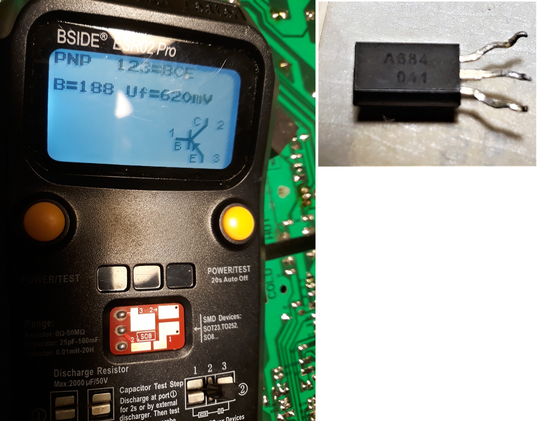

                          I forgot to upload Q10 photo, so here it is : A684
                            These are the two that must be changed, AZ431 is the same as TL431, them are IC:
