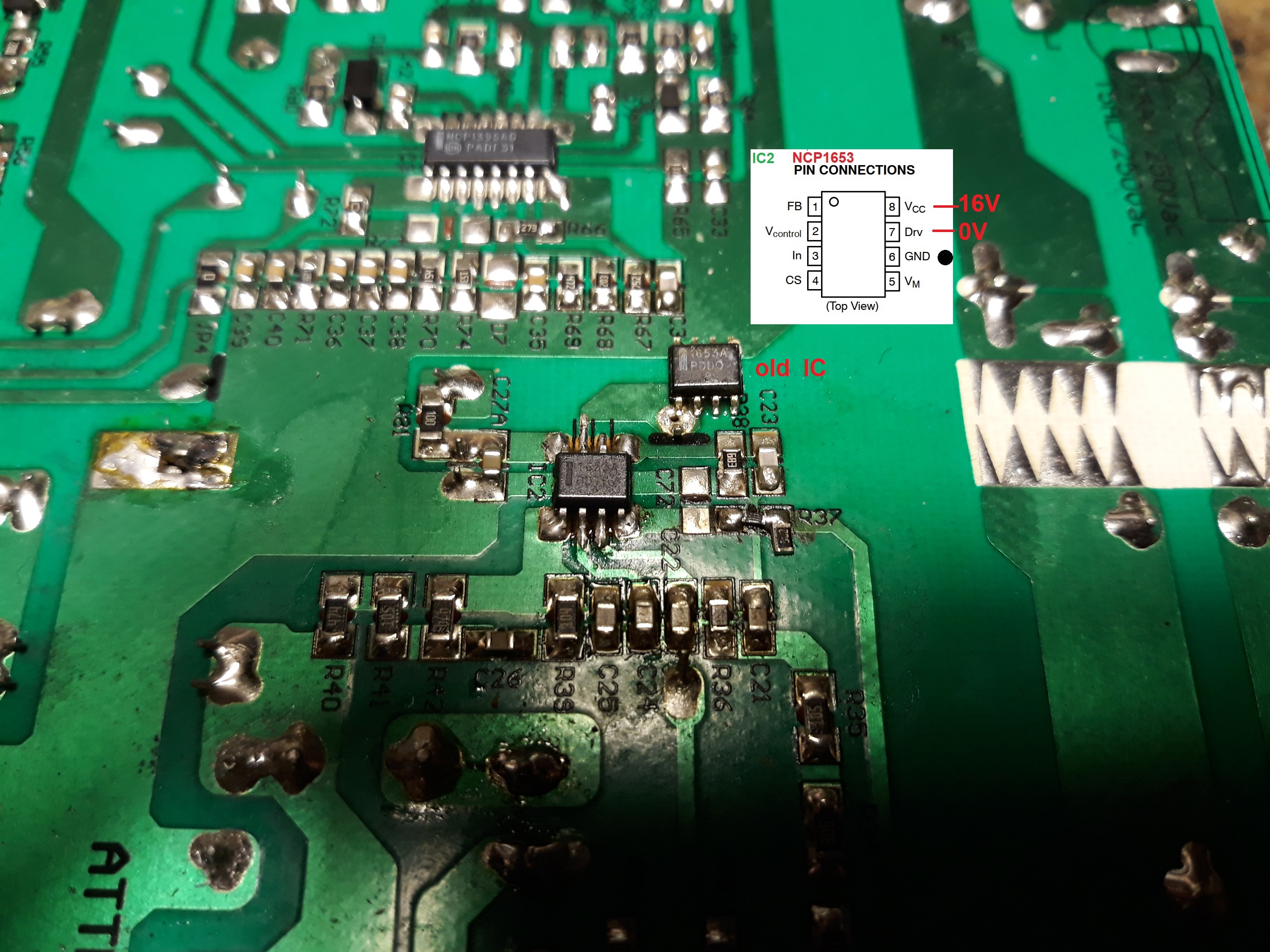

      Hi . I'm back on track
      New IC2 installed.
      Vcc ( Pin8) is 16V .
      Drv ( Vout , Pin7 ) is 0V !
      What Pin should I investigate first

      P.S I bought 2 ICs. But I don't think the new IC I soldered is defect.

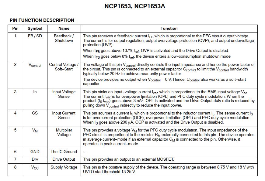

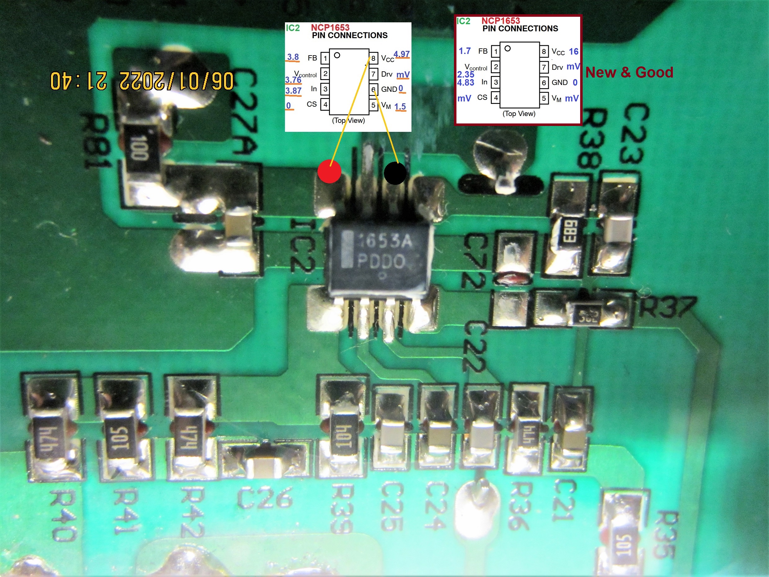

          I took new V measurements of the new IC2 : Pin 5 deserves attention.
          Nearby tracks are fine. Though this is a low grade board it seems , the tracks layer bulges easily

              "i recall this is an old photo that you re-edited with right square," YES, Brown is new IC, I added so we can compare.
              "in that the measurements are ok," New IC look fine ?
              "so let's discover if PFC is ok.." definitely

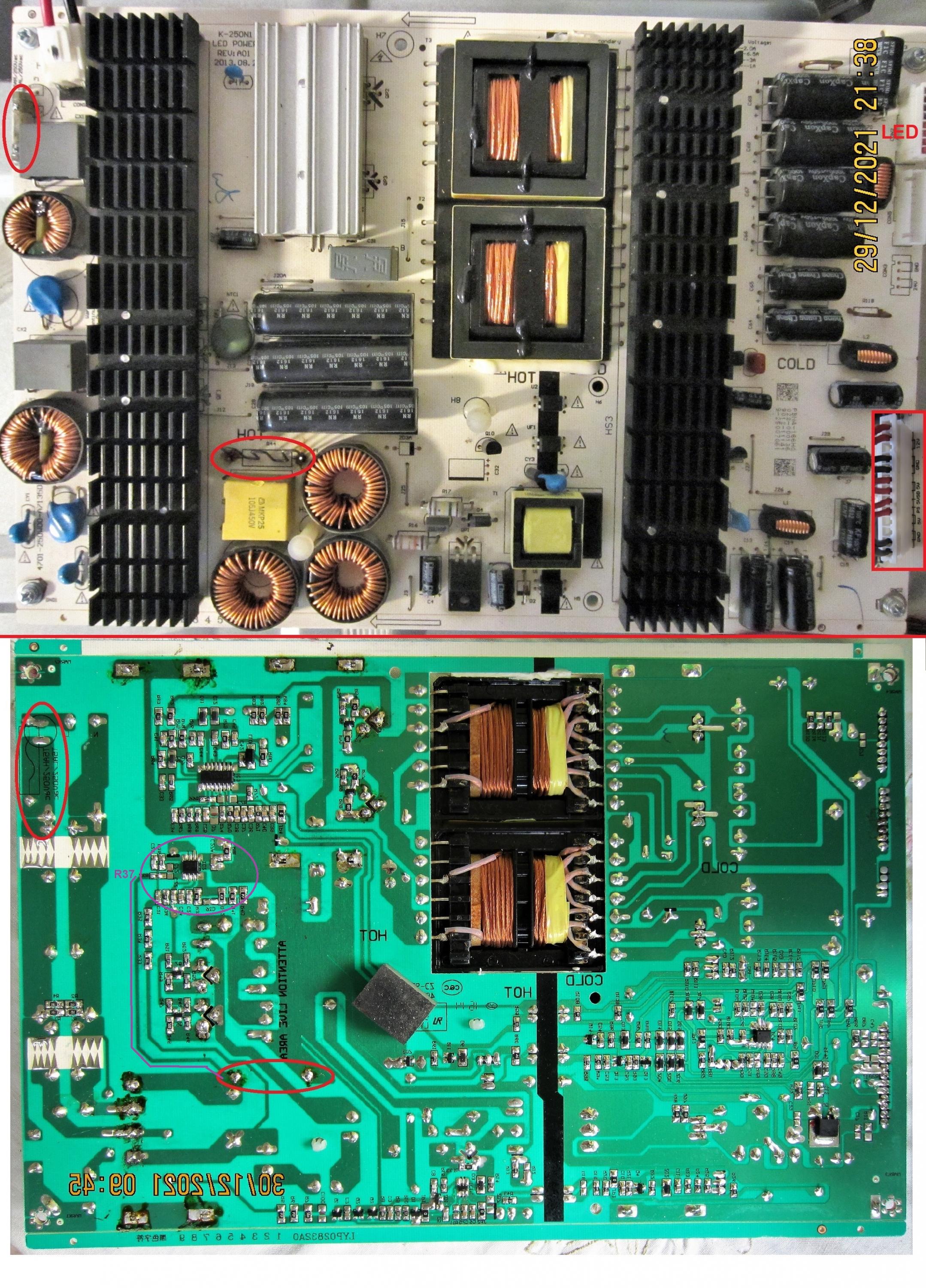

                    R37 connects to the Wire-Resistor . see image
                    Main Capacitor measure 307V ( I want to measure all 3 , just in case, mehh)
                    I don't know where to check next, because I don't have a clear image in my mind on how such a PSU work. As I understand, 5VSB part is fine, but the PS-On line does not activate the high V ( 24 12 etc). I assume PFC starts to work from the PS-On line but how ? does Vcc presence mean High V or another pin is needed to turn it On ?

                      Vcc on IC2 makes the PFC to start, as i have told PFC mosfets are suspected, you told you've tested it but i insist because since the sense resistor can't burn well , the mosfet can go open with a pleasant hole, the fact that the wire resistor burnt its ends stays there to demonstrate it..

                        I'm on it: under the black long heatsink.
                        But, is it possible to measure the output of this stage instead of the components in it ? If so where ?
                        What do you think is under the aluminum heatsink ?
