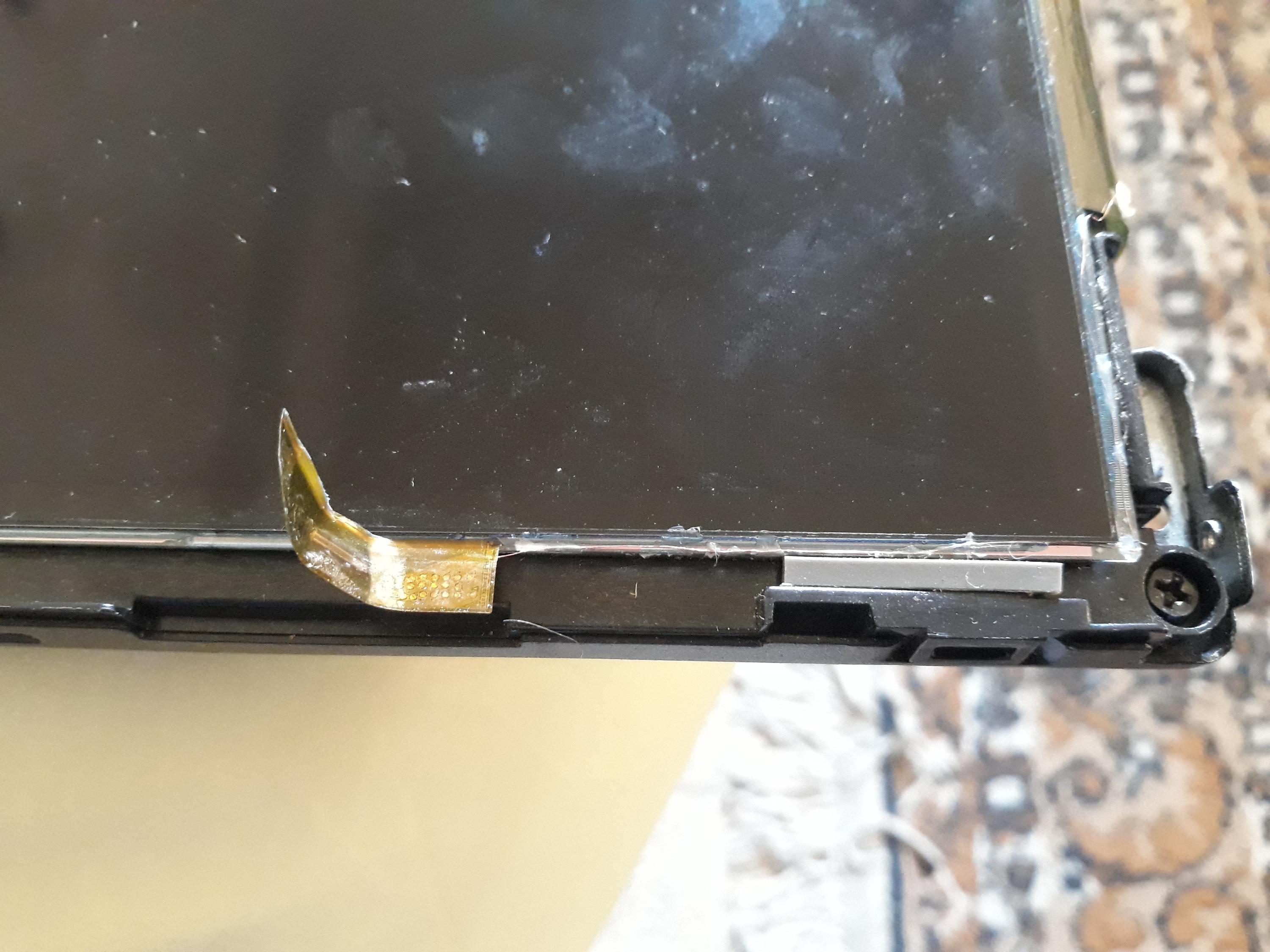

              I plan on : low heat ( heat gun ) and slowly peel off .
              sounds ok ?

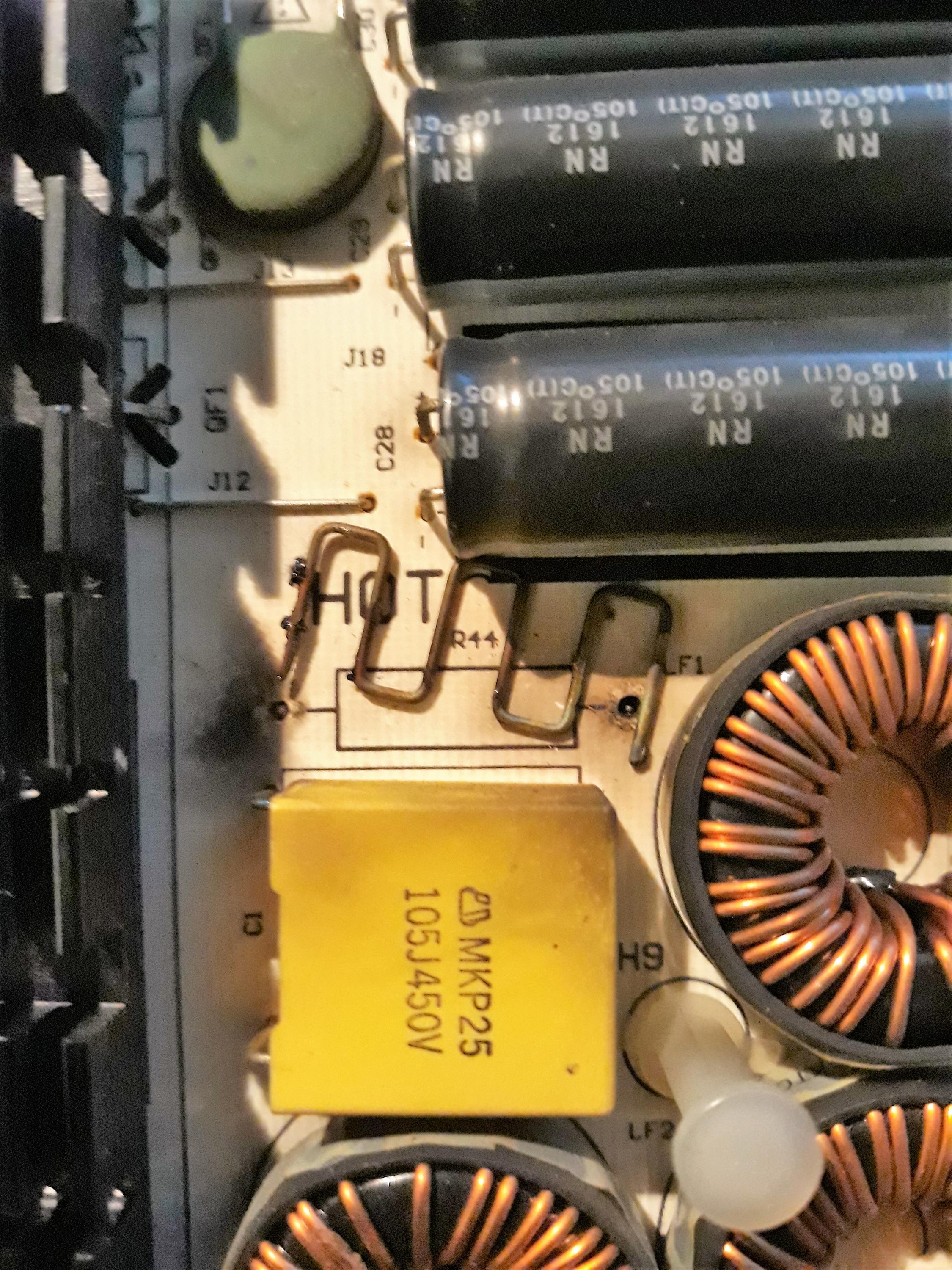

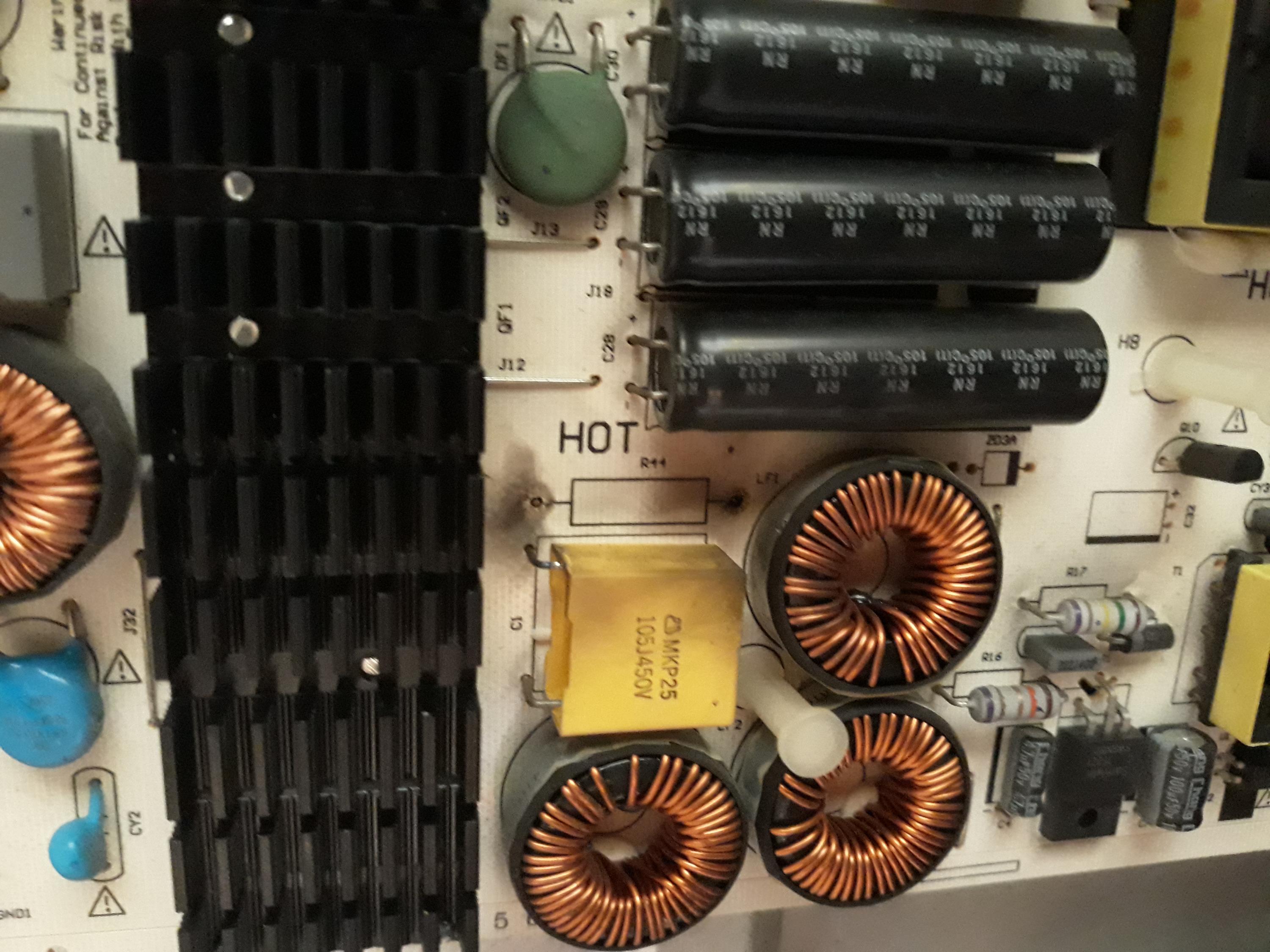

                  So I pulled the TAB out
                  On power connect , something blew on PSU , I think a coil . Burnt through the blanket under.
                  No idea why as I did nothing unusual.
                  Total Loss
                  Thanks a lot for your help ! awsome !

                    Fuse is blown.
                    Any clue what this : R44 , is ? one end melted

                        Originally posted by Ancient1
                        by the way :
                        Fuse is blown.
                        search Current Limiting Manganin Wire Shunt Milliohm Resistor

                          Re: Can you dignose from the photo ? . Toshiba 65S2650EV
                          Total Loss
                          IF the picture of the tab that is shown is how you powered up the set at the time, it is possible that the "half removal" was not a good idea. It should have been totally disconnected.

                              Budwich : The TAB was totally removed.
                              vinceroger69 : Thanks ! Is it possible to solder back ? I want to check the Panel at least.
                              Davi.p : The blow up occurred exactly with Wall Power connect. I don't think Power Surge is possible and I have my PC with surge protector in same room - the Surge protector would have "jumped". I don't think the wire resistor was the fault i.e if I change the Fuse and solder this Resistor back the PSU would still not work . You agree ?
                              A TV from Hell. I put so much work time and money in it..

                                This problem is not related with work on panel, i can only say this. Have you removed the thin wire from the panel before?

                                  Yes, of course I did. I don't want a wire with electricity floating around.

                                    Hi not sure about re using the r44 it depends i guess on how much has been lost in total lengh as may alter the resistance. I cant see how removing the tab could of caused it though.

                                        vinceroger69 : Agreed. This is what makes this a TV from hell. I put down the TV same way I did many times before..
                                        In the image you can easily see that the Wire Resistor was cut clean at the VIA.
                                        Thing is, its unlikely it caused the Main Fuse to blow i.e something else is damaged.
