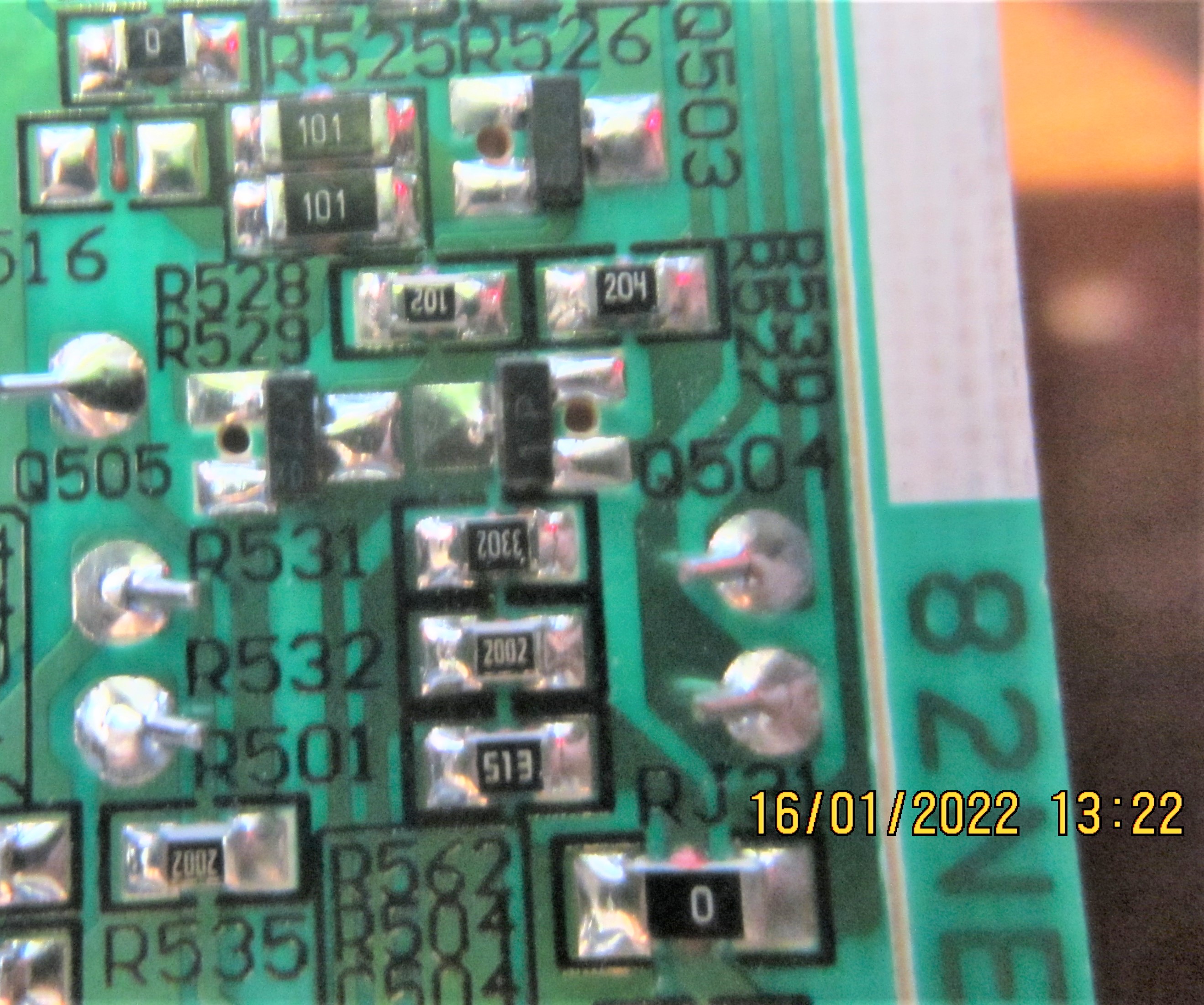

    From what I search , BZX84... variants is Y5 , SOT-23 .
    What minimum wattage ?
    I think Mouser , DigiKey would be a good place to search for candidates ?

      Re: Can you dignose from the photo ? . Toshiba 65S2650EV
      yes in the previous post i told you from my searches BZX84-A16, in the truth by its datasheet of the series the true one in BZx84-C16 tha has same Vz but more tolerance, 250mW, but for a fast test you can avoid filling the place, so we see if the damn thing wants to show us a picture after 240 posts..
        So 17-19V, and 250mW preferably. doesn't have to be 3 pin. Now length issue .. 2mm max
        I am thinking what is the best way. The list is only 3 pin SMDs , but with the specs .. oy vei (thats yiddish)
          no 15-17v. Why don't you test the board itself? I'm impatient.. thrust the uncle, it's safe if you do a 1 minute test..

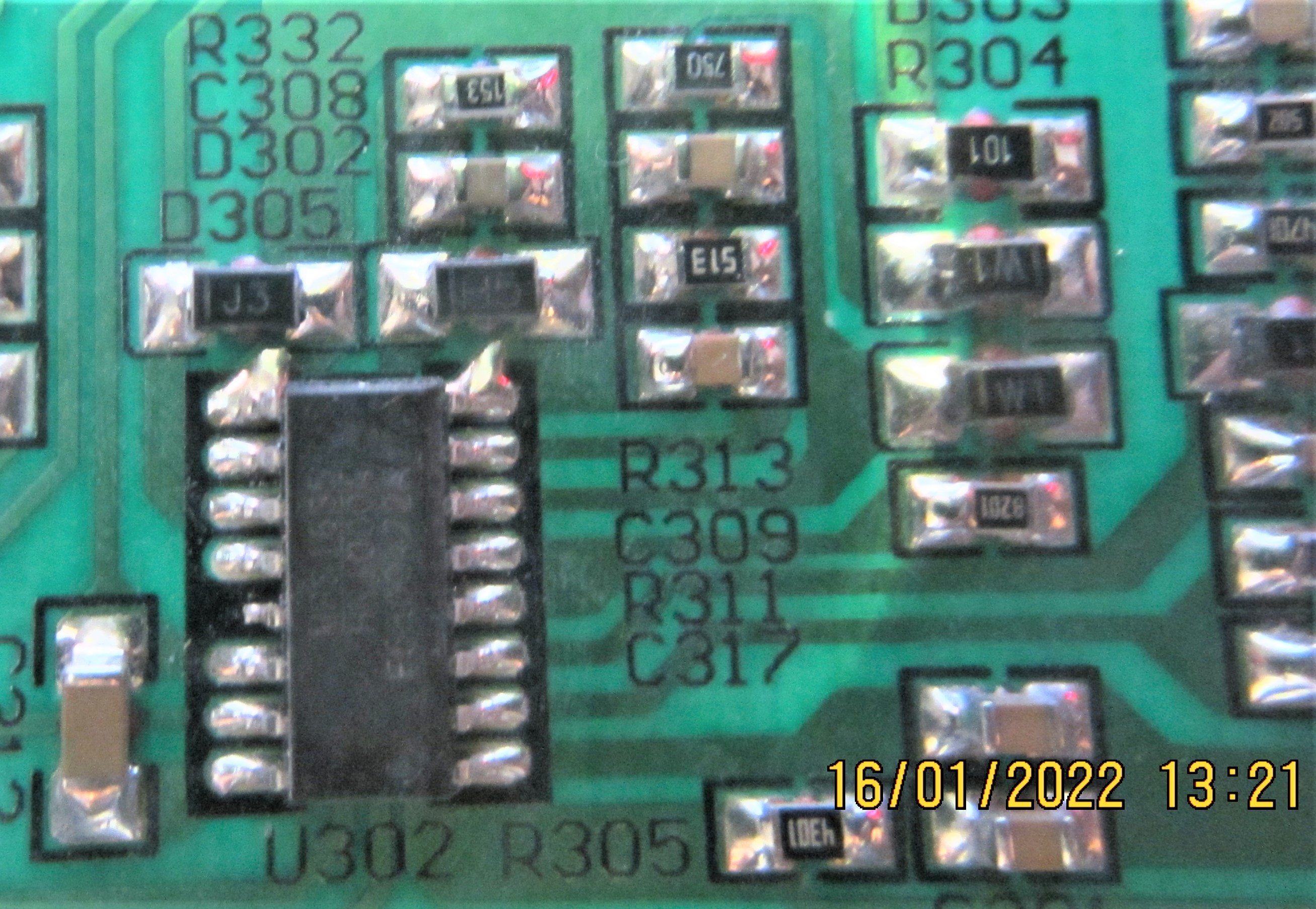

            Found a candidate J3 - see photo
            its data sheet https://cdn.badcaps-static.com/pdfs/...4ac533c6dd.pdf
            looks like an 18V Zener
            and 1P - see photo
            Both from a good board. I don't want to this PSU too , So if you confirm, I want to make sure I can buy those 2 in Aliexpress. But delivery time isn't a factor
            I'll use low melt solder to remove them. safer
              i said 15-17v (it has a range) 18v it's too high, why you show me photo? it doesn't matter..

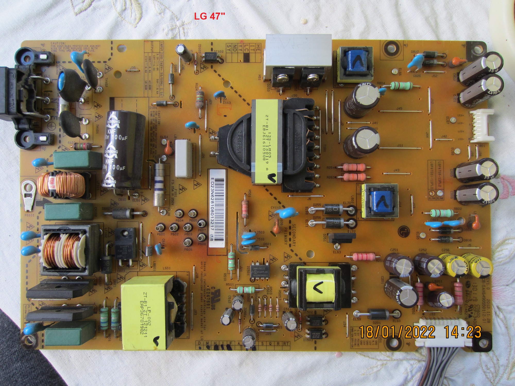

                        No joy with the LG 47" 47LN570Y. Hoping for a quick repair and to get back to the 65".
                        On start : BL blips. Image OK. BL Strips OK. i.e LED Driver issue. All PSU Caps look OK.
                        2 Quick questions :
                        first : With no BL connected , should there be output V on the PSU BL connector ? ( something I finally realized I need to clarify )

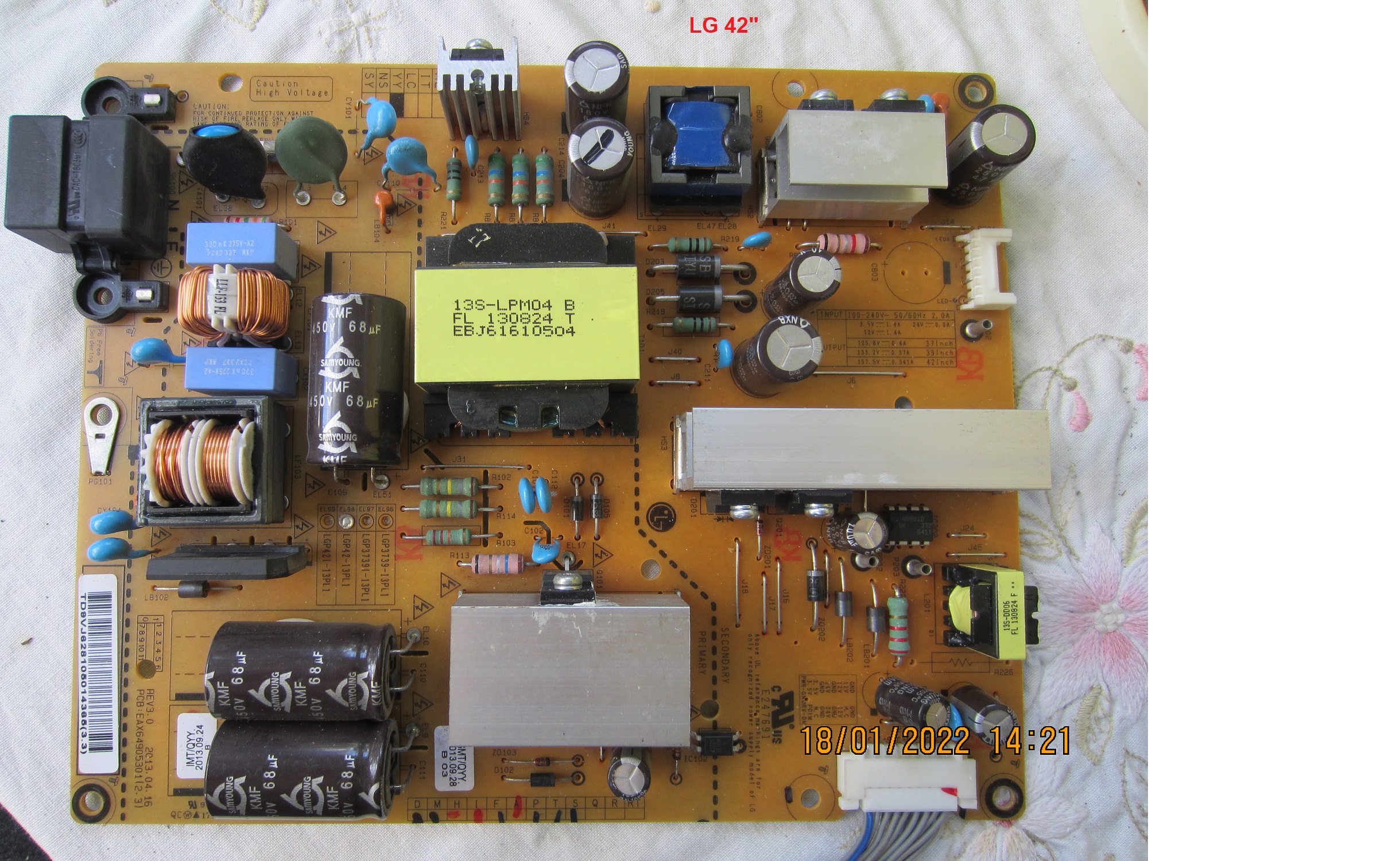

                        2nd : I got PSU of 42LN570Y , it is smaller. Main's connector identical EAX64905(3)501 ( 42 has 3 not 5) : I upload photo of the important info with them. Do you think it can be used instead? ( I will repair the board of the 47" later)

                          PLEASE! i ask this on the knees to all members, don't misk repair cases.. open one thread for each repair job, there are gigantic threads full of confusion in this forum...
                          Obviously not ic3, check again the previous list of components i made..
