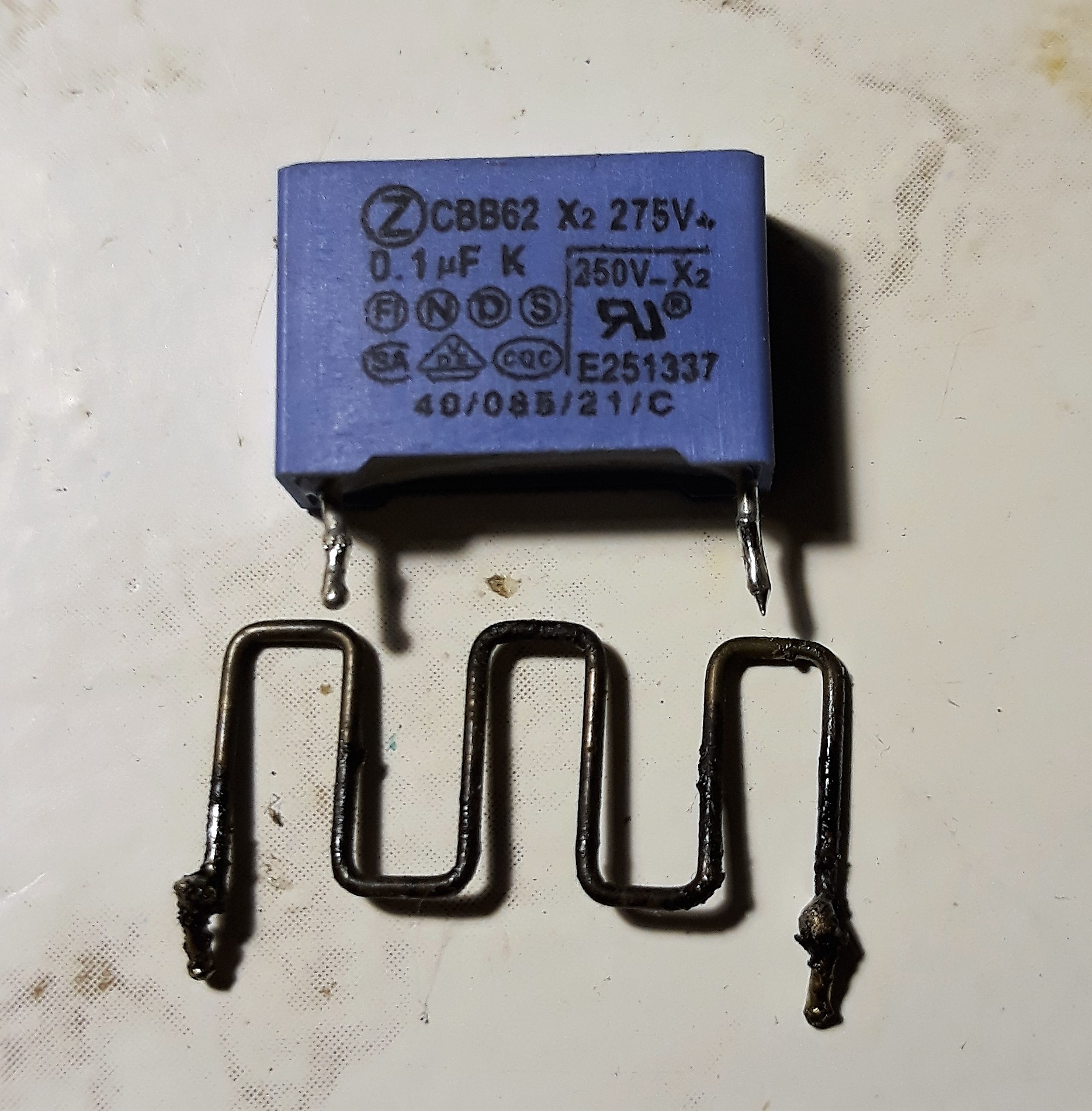

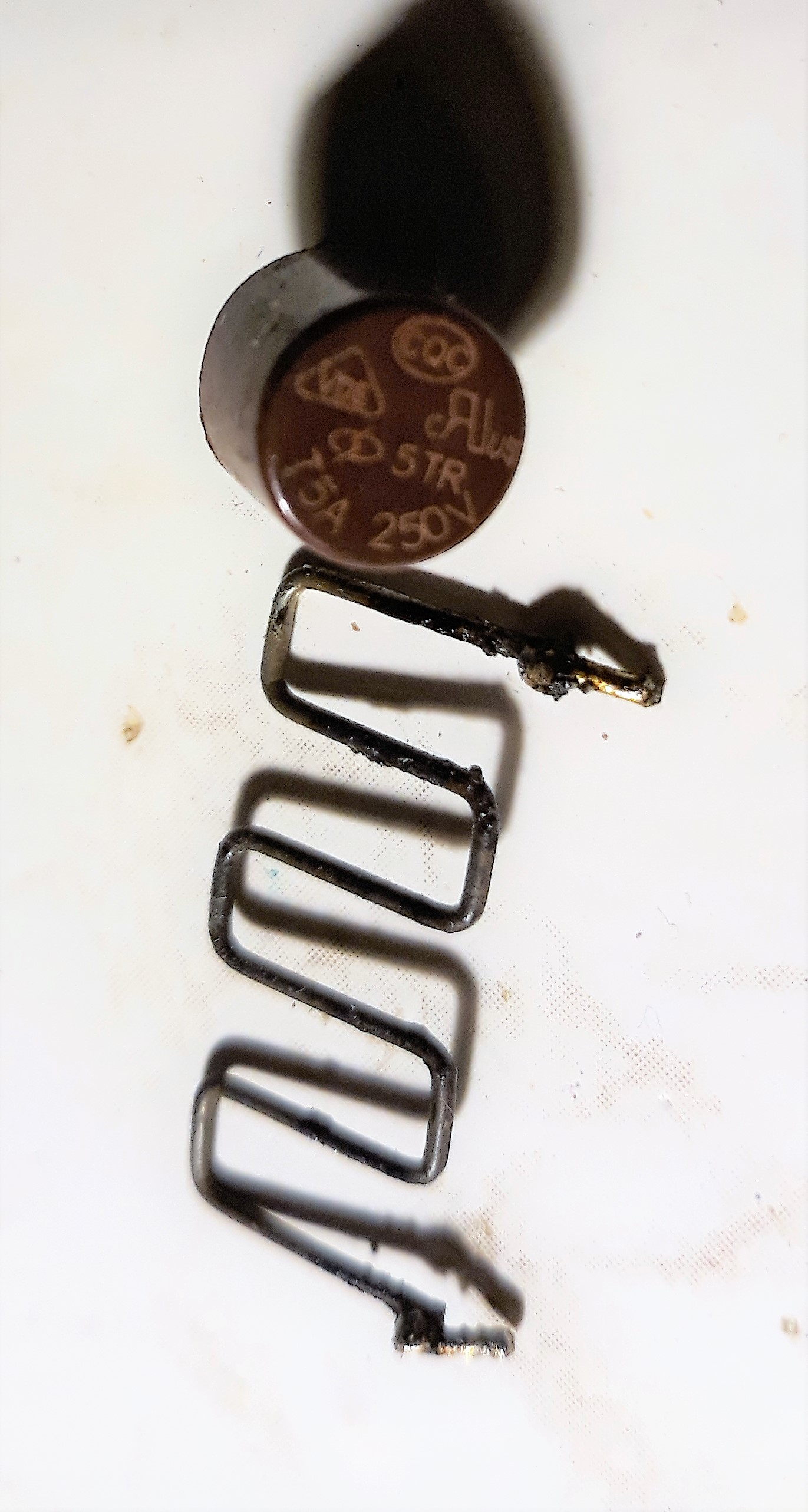

    locally I can get 0.22 Ohm 5W .
    Checking eBay , 0.23 n/a but 0.22 are common
    • Davi.p
      Hobbist Tech
      • Sep 2009
      • 4537
      • Italy - Milan
      #302
      Re: Can you dignose from the photo ? . Toshiba 65S2650EV
      but i need to know the a actual resistance of the wire resistor even with the prolonges, with the most precise tester you have..
      • Davi.p
        Hobbist Tech
        • Sep 2009
        • 4537
        • Italy - Milan
        #303
        when measuring don't touch both terminals with fingers..
        • petehall347
          • Jan 2015
          • 4450
          • United Kingdom
          #304
          in case you didn't know already touch meter probes together first and any reading deduct from whatever the resistor reads ,
          also you could build a wheatstone bridge out of precise resistors .
          • Davi.p
            Hobbist Tech
            • Sep 2009
            • 4537
            • Italy - Milan
            #305
            but thinking on there, normal meters have only 1 decimal so are not suitable for that task.. so try with the 0,22ohm but not 5w, them are unfit , to have got more room better 1w or 2w..

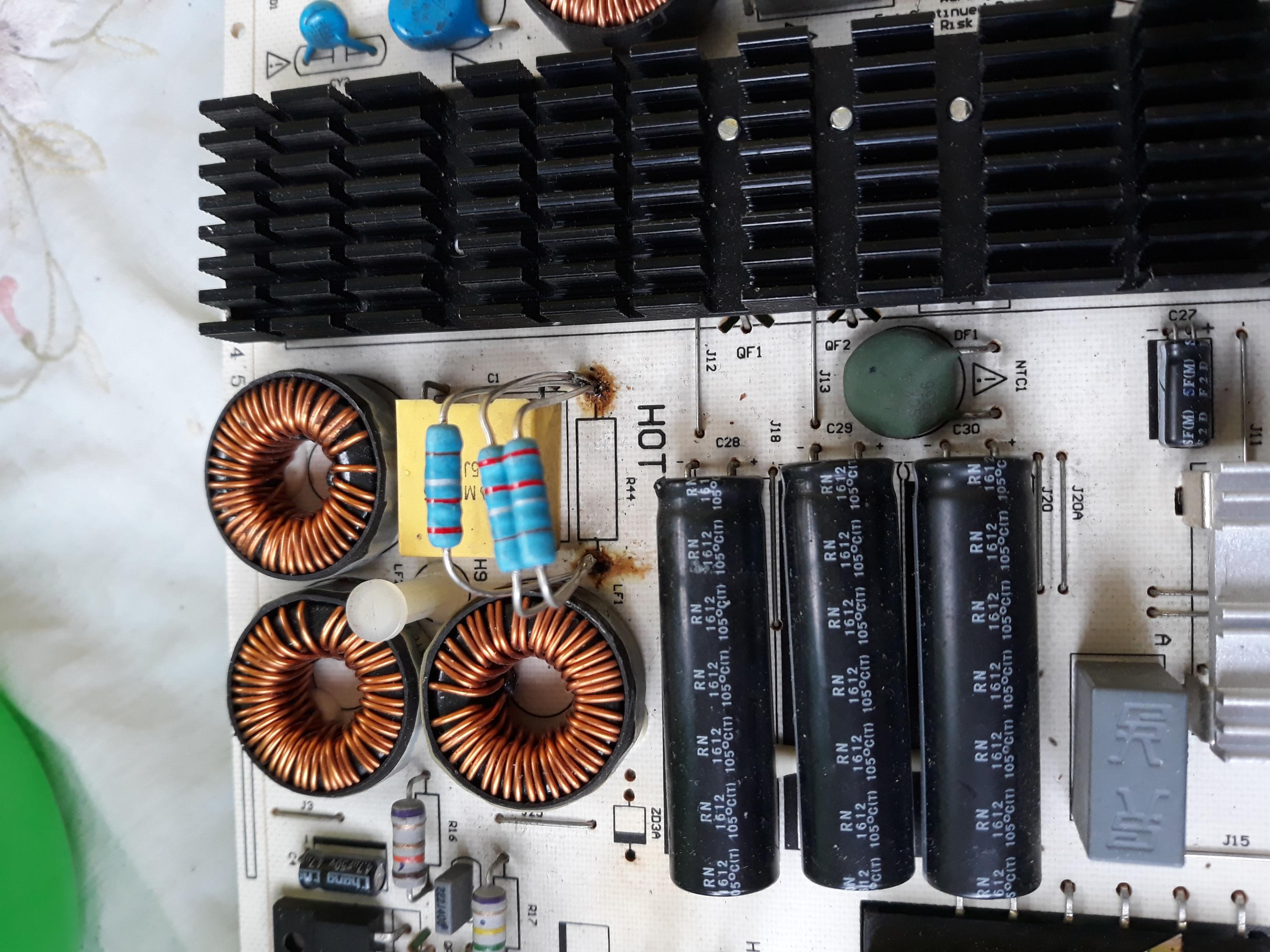

                                Hi
                                I got 3 the resistors , measured and installed - see photo.
                                No Luck
                                I will carefully inspect the board again, maybe I missed something
                                and than probably order a new PSU , I owe it to you guys , esp. Davi.P

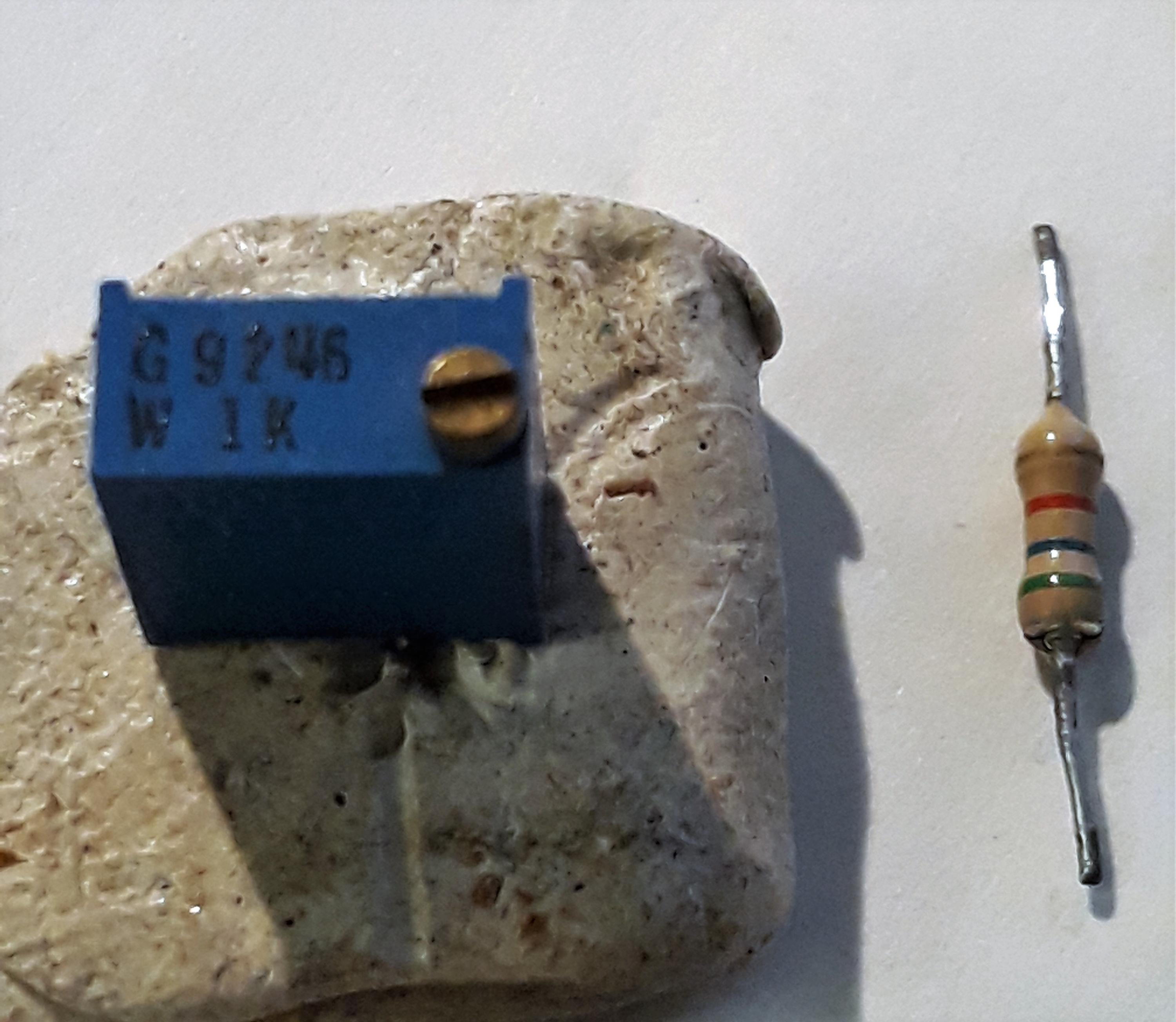

                                  you can try put back the original wire resistor, desolder r37, solder 2 wires on its pads, between those you put in series a through hole resistor same as r37, and a trimmer starting with lowest value and try increasing in many tries..
                                  • Ancient1
                                    • Dec 2019
                                    • 275
                                    • Israel
                                    #317
                                    I think have 1-1k trimmer. With R37 ( code 562 ) being 5600 Ohm, I think maybe I should use a lower value resistor , so I can get values above and below 5600 Ohm ?
                                    • Davi.p
                                      Hobbist Tech
                                      • Sep 2009
                                      • 4537
                                      • Italy - Milan
                                      #318
                                      you don't have to lower the r37 but only increase, so put a 5k6 resistor in series with trimmer.
                                      • Ancient1
                                        • Dec 2019
                                        • 275
                                        • Israel
                                        #319
                                        I don't have a larger watt Resistor.. I'll rig some cooling fins .. and hope
                                        • Davi.p
                                          Hobbist Tech
                                          • Sep 2009
                                          • 4537
                                          • Italy - Milan
                                          #320
                                          larger watt?? who have said that? that in pic goes well, it's a 1/4w..
