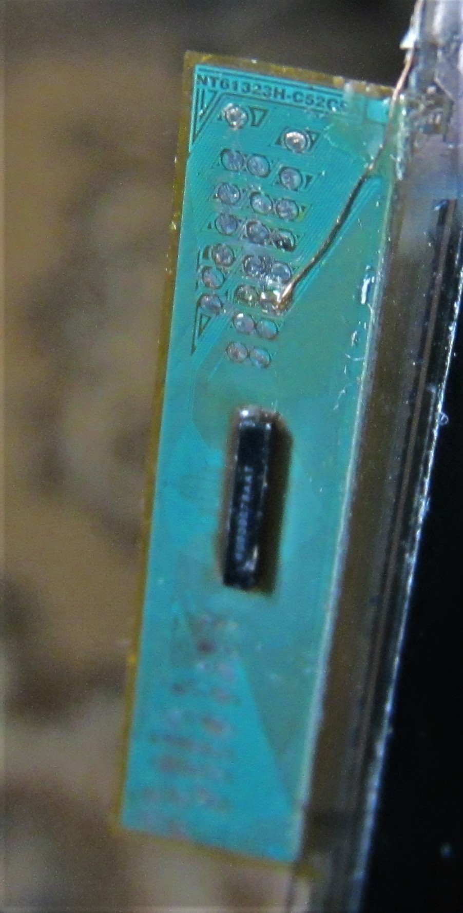

    Did one more time : removed the Rosin ( flux) with IPA. No solder to wick so I went with a needle over the thin border between those TPs.
    Nothing else I can do

      I did it one last time
      cleaned the Rosin and since there is no Solder to clean out , I went with a needle point on the fine line between those 2 TPs.
      Really nothing more I can do. Still, maybe there is . I don't want to smell a burning IC :/ .
      If I don't come up with a new idea, I will put the Panel back tomorrow.

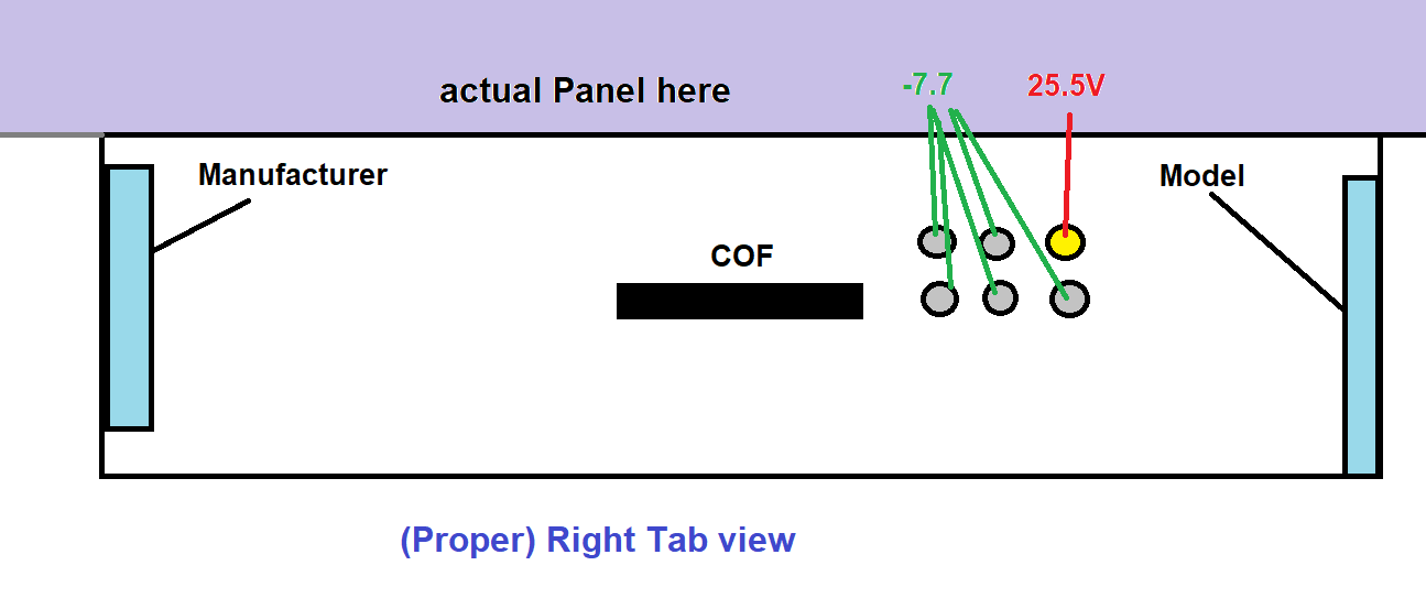

        #63
        Re: Can you dignose from the photo ? . Toshiba 65S2650EV

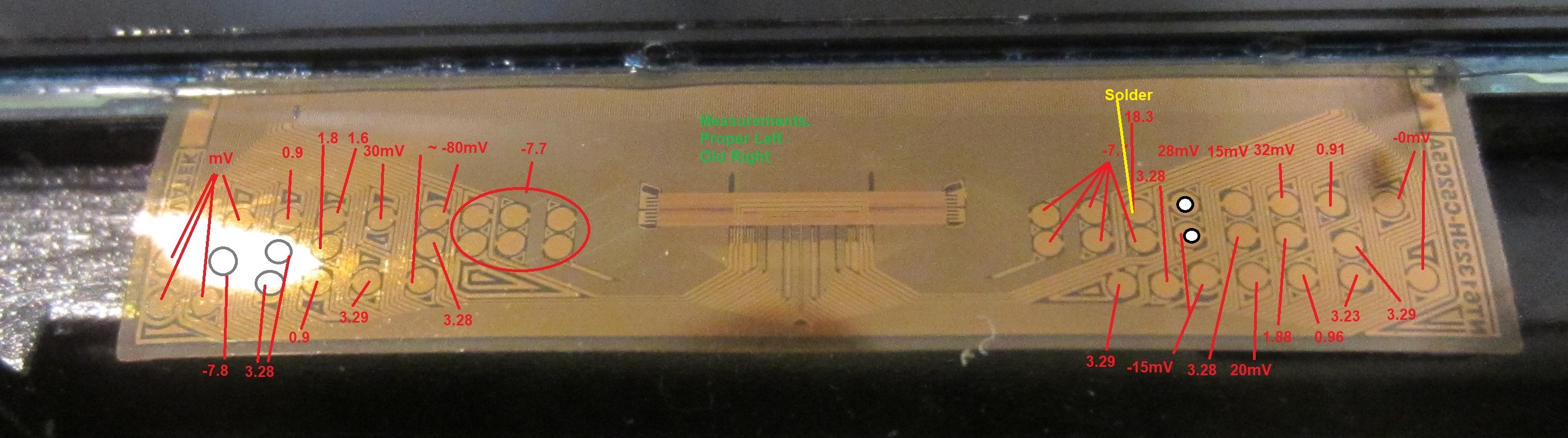

        so those 2 TP are different signals? can you show me which are in your past photo?

          #64
          The photo is of the other side Tab. I soldered Proper Left side , near the VGH VGL TPs (only) on the Distribution board. But the position is correct : Model Number side and TP order/position.
          Unfortunately I find it practically impossible to take close-up photos. But trust me , there is no more solder to remove. I assume what is left is stuck to the silver paint.
          And as I said before : the same ones on the other side are naturally shorted.
          Both with 0V

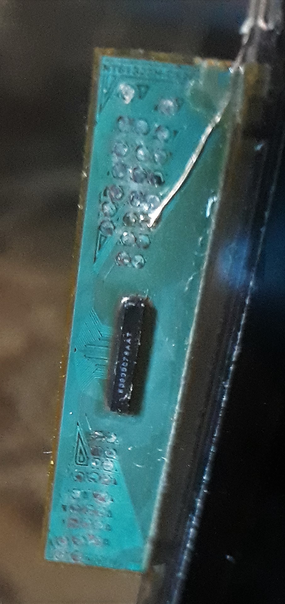

            sometimes I can, sometimes I can't edit.
            Anyway , managed to take clearer photos ( using 2 magnifying lenses )

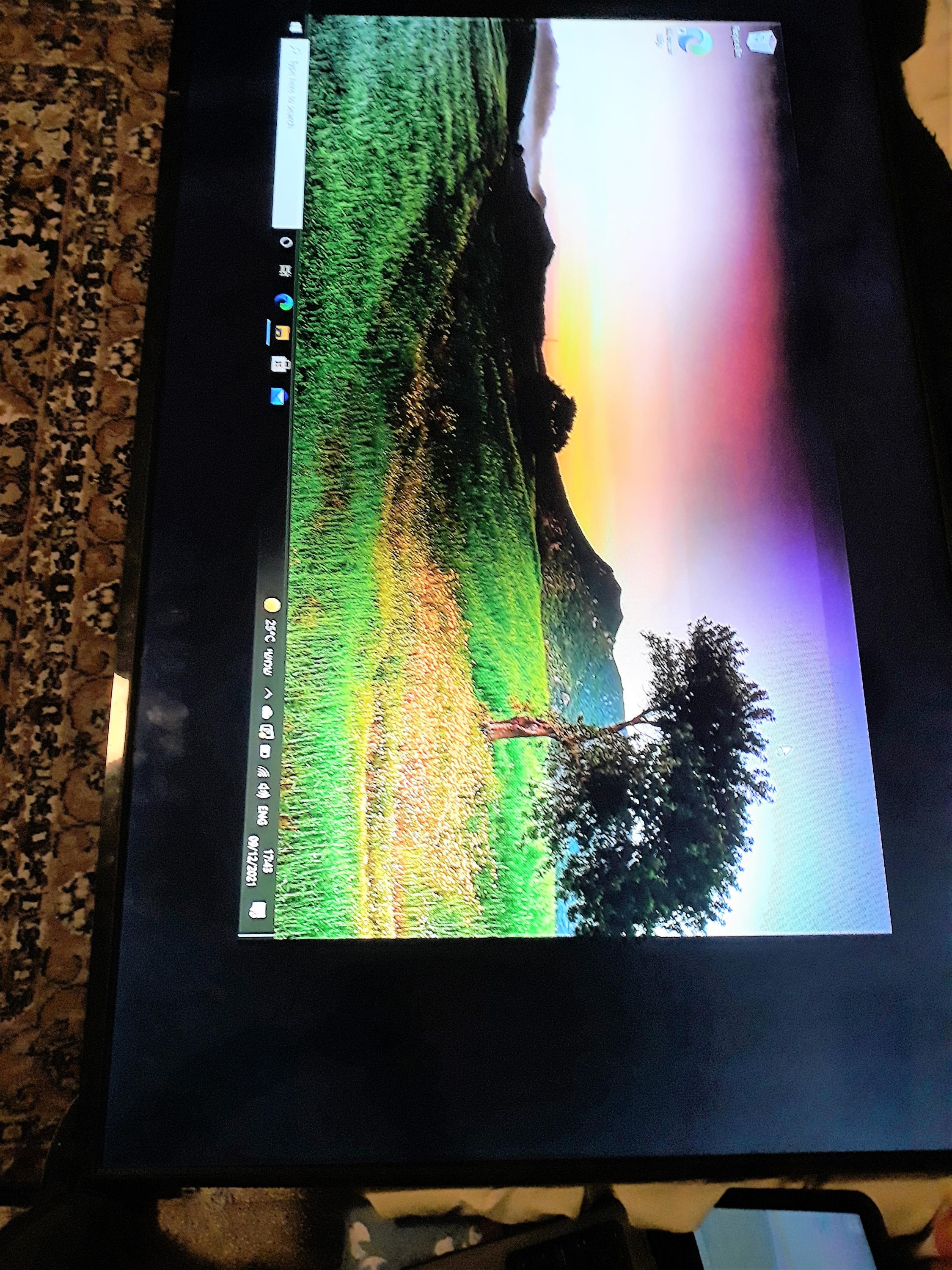

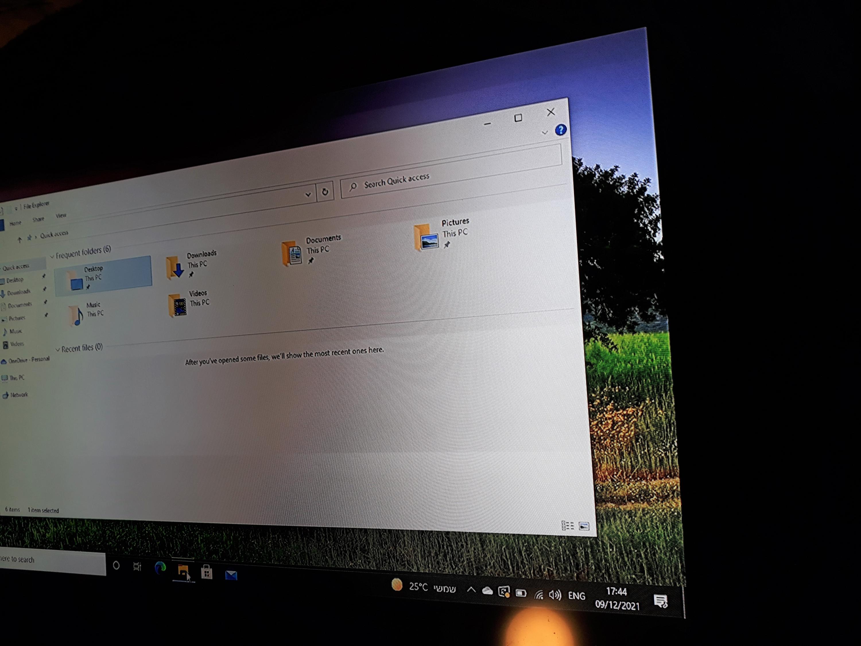

              Tested
              No Logo :/
              Re-inserted the Flex/s
              Logo : No short
              But : same image defects
              I will measure the Side Tabs again , perhaps another line needs repair

                  Well , the BL is new set. I do notice circles : probably the diffusers are too close ( or LEDs too bright ? )
                  These horizontal grayish areas .. I don't think they are BL related but I'm willing to test : suggestions ?
                  There is also a horizontal line

                          #72
                          but which are the measurements now? 'Sorry i don't have checked your last photos well, i considered that an easy job theorically speaking, but i have seen that you soldered the wire in the wrong tp of the tab.. if you watch your photos you have solderer vgh line onto vgl testpoints doing a short circuit, internal ones are vgl tp, external one are mixed vgh+vgl tp..

                            #73
                            I didn't measure yet because I am pissed off . I will tomorrow
                            The photo is one good photo I managed to take. So it fits either Left or Right ( forgot) .
                            What matters is the #Model side and inner or outer.
                            I soldered the mirror TP of the one with VGH
                            I doubt I made a mistake, especially since I measured continuity to every TP around it.
                            We'll see
                            Thx

                              #74
                              You don't understand maybe, continuity doesn't apply , the vgh tp is outer respect to the panel, your soldering is inner, it's easy...

                                #75
                                ok. I will test Right side for VGH ( I soldered Left ). We'll see if it is inner or outer.

                                  #76
                                  Hi

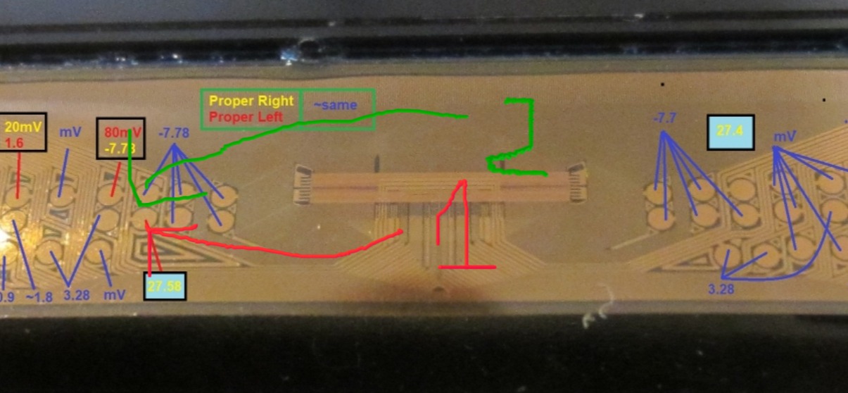

                                  You must be right since when I measured the Right Tab with BOTH Flex connected ( No image at all , no Logo or [not connected] ) : I didn't find VGH Voltage Nor -7.7V , just mV .
                                  When I disconnected Left Flex , I found VGH ( 25.5V YELLOW) TP, and VGL ( -7.7 GRAY) TP.
                                  The image is a short version of the tab : three double TP are nearest to IC from both halves.
                                  The image can, in fact, be called Left Tab since I soldered to the VGH TP as seen : closest to Board and the #Model half of the Tab.
                                  So obviously I am doing something wrong ! but what

                                    #77
                                    You are not following me, check post #41 your 1st photo, you see by yourself that's this last draw is wrong, this shows what you think you have been but VGH TP is not there.. it is under.. repeat, outer *respect* to the panel glass not the pcb..
                                    you solfered on 2, VGH is on 1...

                                      #78
                                      Oh wow
                                      You can see how in the Right half of the Tab ( #Model) VGH is INNER (to the Panel) and in the Left side ( Manufacturer ) it is OUTER.
                                      I will check again because it gets me confused.

                                        #79
                                        ok you are right, sorry..

                                          #80
                                          I will disconnect the VGH TP on the BOARD. See what happens.
                                          I will re-measure both TABs.
                                          Obviously with the VGH bypass , things are worse.
