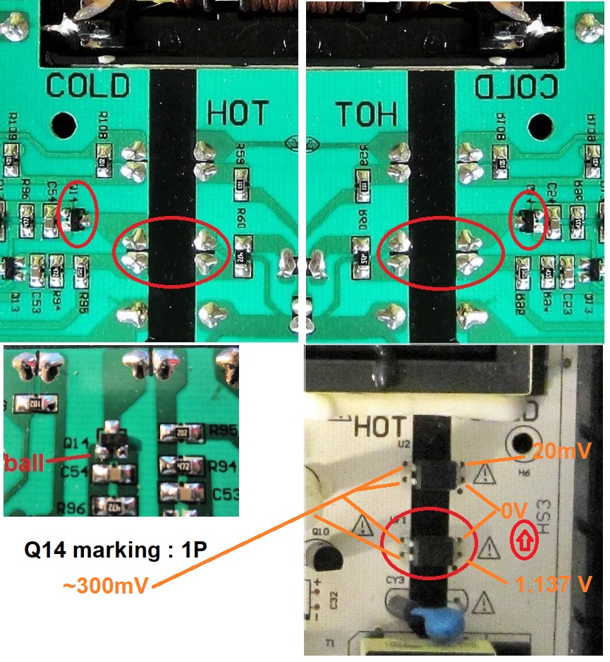

                                      #338
                                      Re: Can you dignose from the photo ? . Toshiba 65S2650EV
                                      Hi. Better late than never. sorry
                                      I don\t quite understand :
                                      * "not working PFC (possible)" - I put new NCP1653A ( Vcc was ~16V with IC off)
                                      * As I recall , I think we replaced UF1 ... with Q10( A684) connected .
                                      But "if bad U2, possible bad TL431 connected to it" . AZ431 is in Cold Side . What am I supposed to do ?
                                      * "probe the gate of the mosfet QF1/QF2 if i see well" - But I just did that in previous post , no ?
                                      I upload a photo of some tests I PREVIOUSLY made of the Optos
                                      • lotas
                                        • Jan 2016

                                          #340
                                          1. There is always a doubt when buying chips from China, especially of non Chinese brands, how do you have received it, in sealed blister or free in an anonymous bag?
                                          2. Sorry i say TL431 just to intend, the type is the same as AZ431, U2 i point at, not U1.. the test does not reveal a sure good part.
                                          3. I see QF1/2 , it's not clear, you tested QP1/2..
