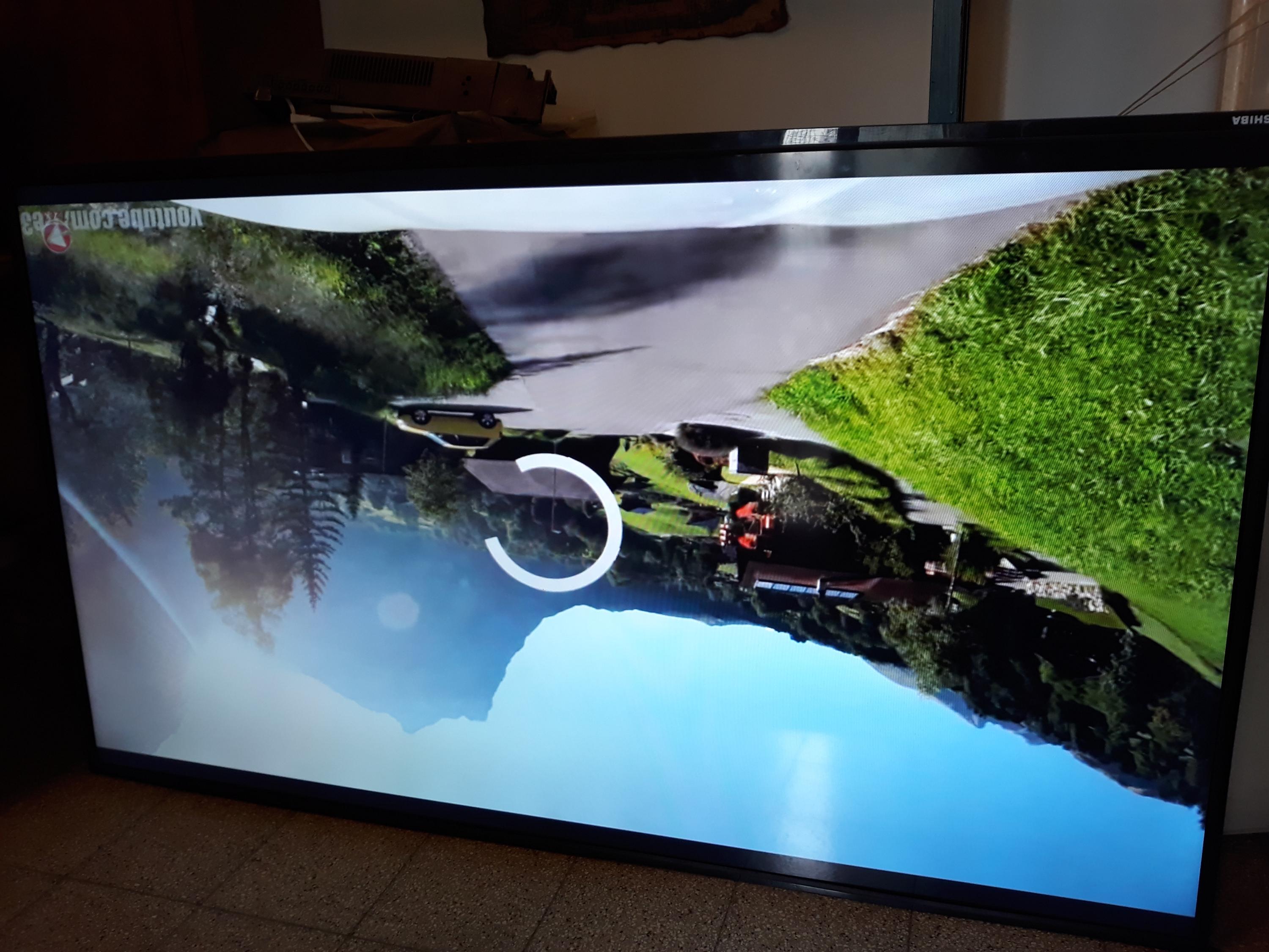

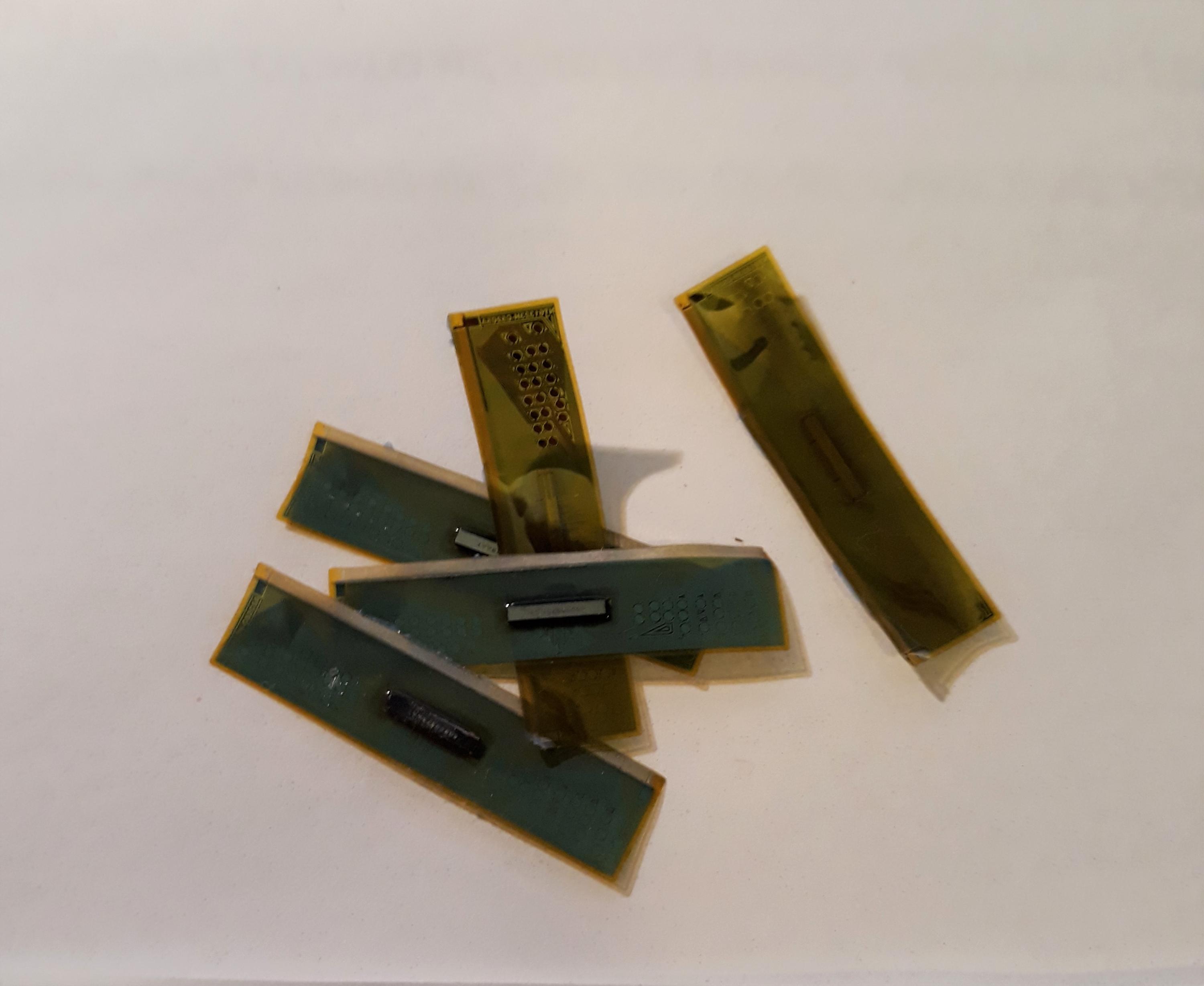

    Hehe .
    This story never ends.. unbelievable

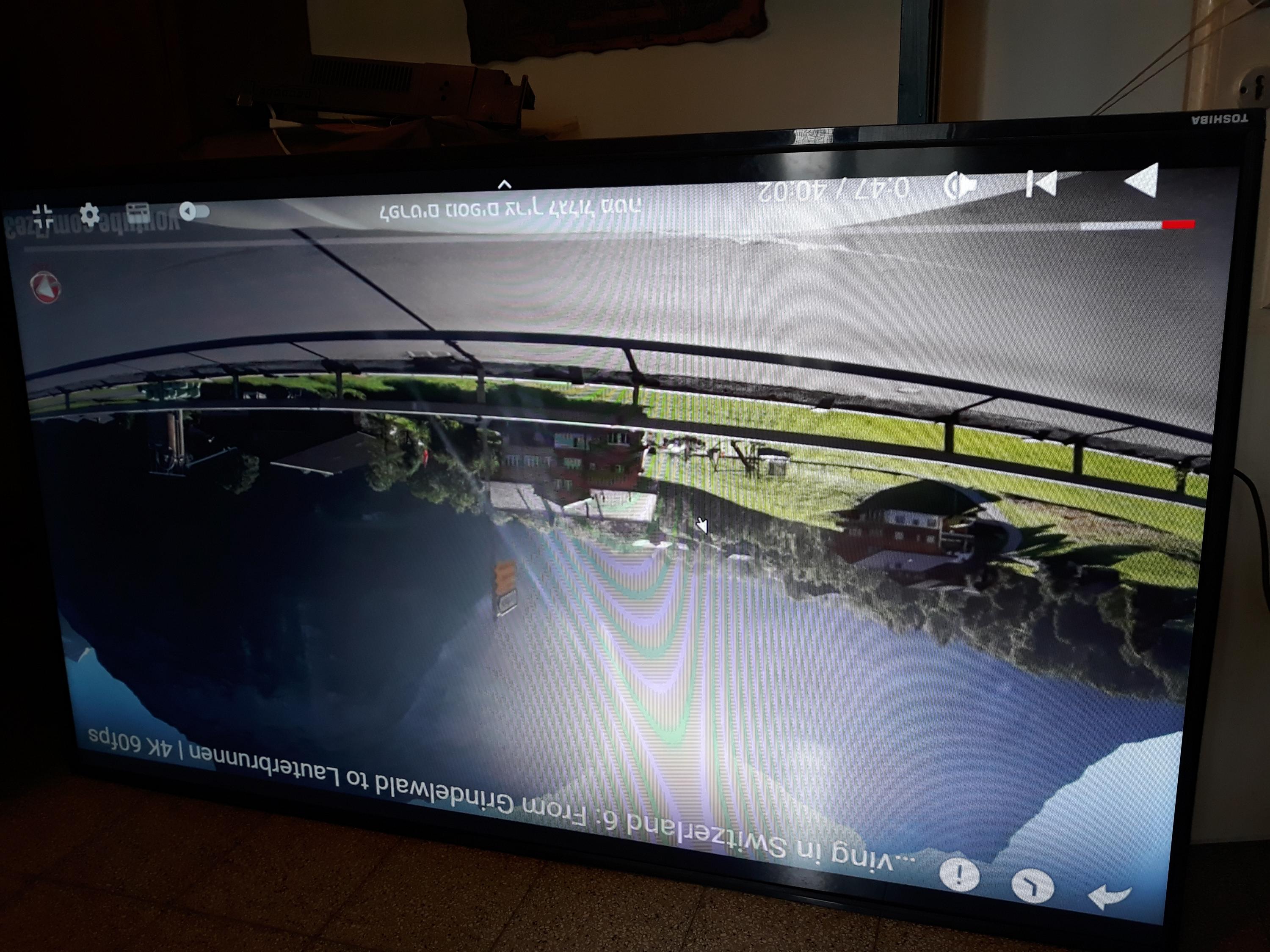

    OK, I will rip ALL Tabs on the same side - You agree ?

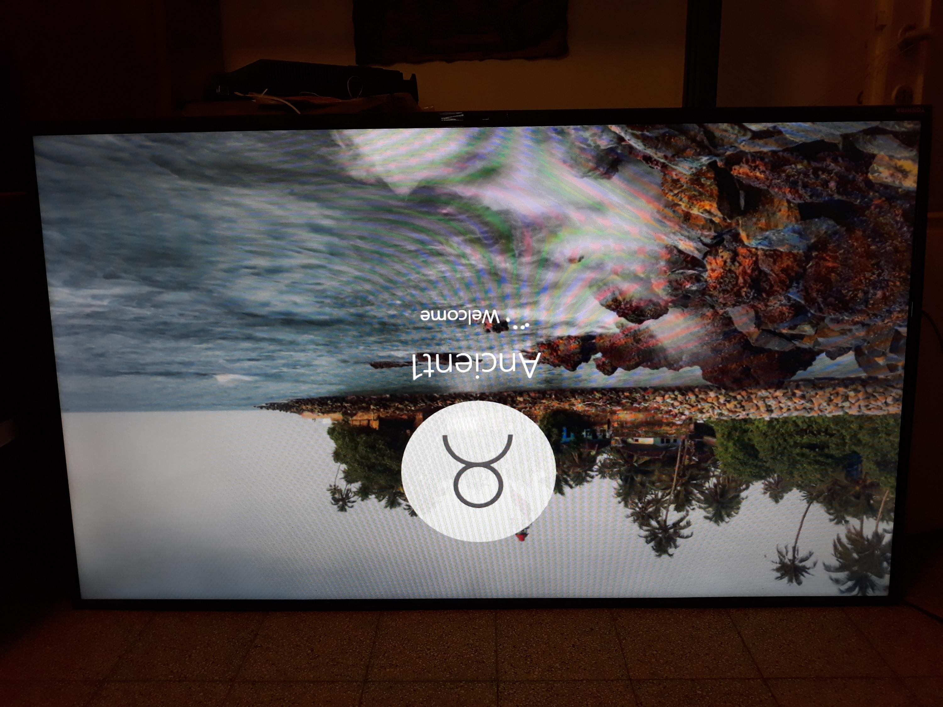

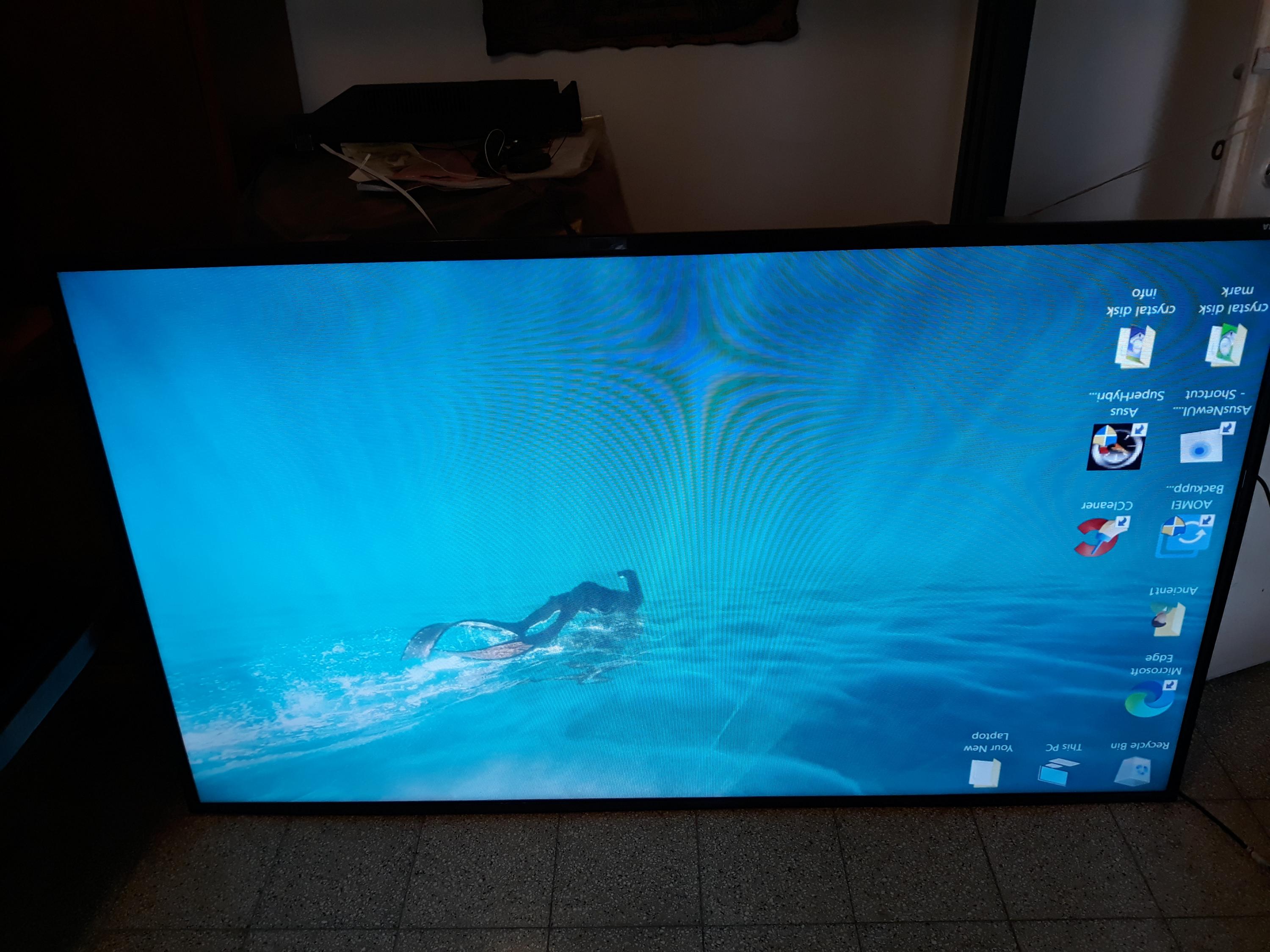

        Re: Can you dignose from the photo ? . Toshiba 65S2650EV
        smartphone photos look darker than the image on screen is actually is.
        I did not edit ( changed brightness )
        looks great
        Can we say FIXED ?
        What a story !
          It may of took a while to get too this point but yes a really good picture now, its actually been a interesting fault finding thread, with a good outcome.
            ok, so it looks like the problem was a bad powerboard and bad panel, "fixed" by tab removal, needed good powerboard to see the tell tale horizontal lines of the bad panel.
            • Ancient1
              • Dec 2019
              • 275
              • Israel
              #366
              Exactly. PSU died when trying to check results of 1 Tab removal.
              New PSU showed the result isn't good : lines , lighter shade strip were the Tab was ripped , and dark middle screen.
              I Verified the horizontal lines are no more, by using Paint with different full area colors, dark colors, light colors.. No Lines.
              Davi.P : How come the image seem fine with one side without Side Tabs ? Is there any degradation I don't notice ? It is important to me as I plan to put it on sale.
                The degradation can be showed mainly right after the removal but stories here in the forum tells that there aren't with time passing, i would be quite curious to see if a 4 ohm resistor could cure the original power board..

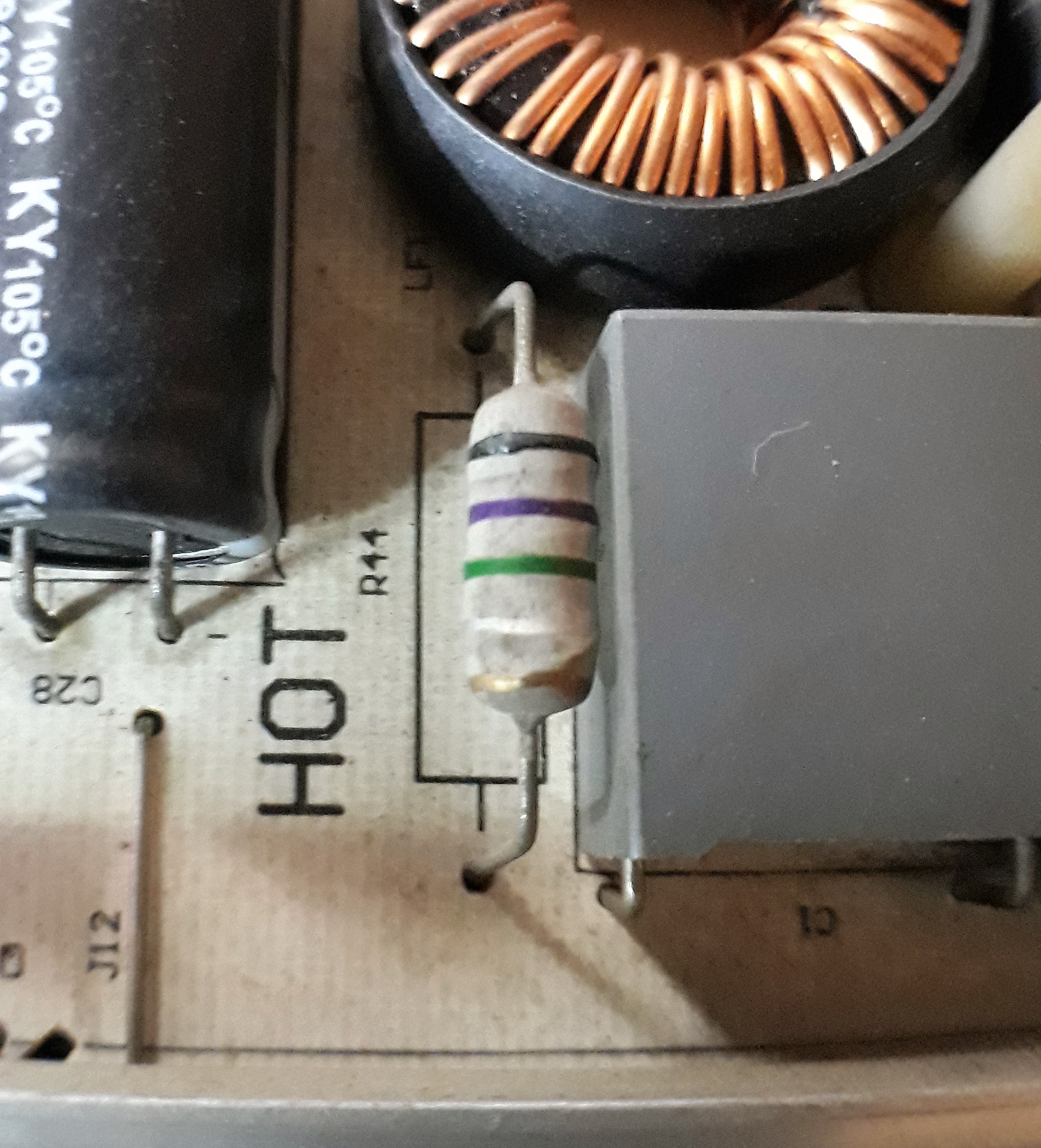

                  I don't understand : do you mean that the TV will be OK for a long time ? i.e stay fixed and image not deteriorating/degrading for years ?
                  I attach a photo of the Resistor in the new board : I can't find its value ! First strip can not be black ??!!?
                    i mean that probably will last long, if no other power surges happens..
                    if second band is violet that is a 0,75ohm, if it's blue is a 0,65ohm
                      I will tell buyer to use Surge Protector.
                      The band is Violet : 0.75 Ohm . I can't get logical reading now.
                      Do you want me to try 4 Ohm on the old PSU ?
                        Why, where did you get the idea that the resistor is 4 ohm.
                          I told 4 ohm because you said 4ohm before, but no you must use 0,75ohm..

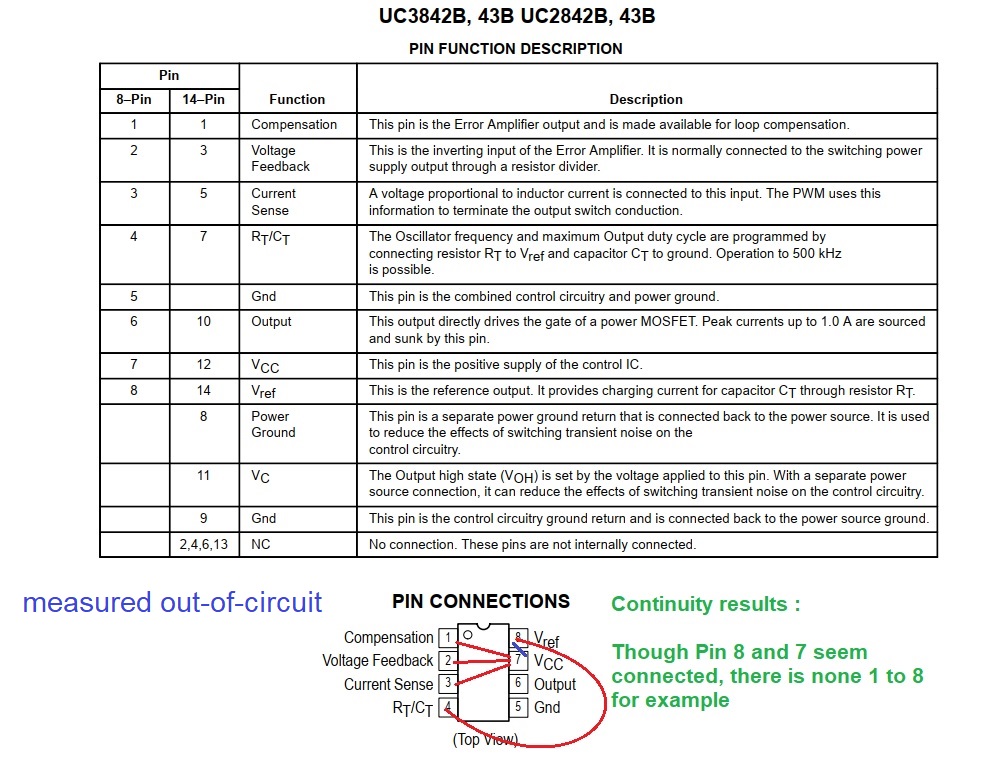

                                    I'll re-measure the batteries with another DMM
                                    I'll de-solder the probes and use something else
                                    by the way , do you see anything unusual in the IC from the 12V PSU ?
                                    I'm going to order it anyway, since I can't find any bad component
                                      Please don't shuffle things, the other psu in another thread..
