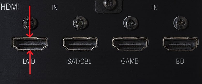

    I have found in the past that the hdmi connector expands the metal that holds the cable inside and by gently squeezing the two metal faces on the hdmi port in your PVR it can then realign the pins with your hdmi lead. The other thing is to use isopropanol on the connections on the HDMI connector and clean them with a old toothbrush in case the contacts have become dirty. I have remedied many hdmi ports using both of these methods in the past. The plugging and unplugging the hdmi lead from the connectors weakens them over time.
