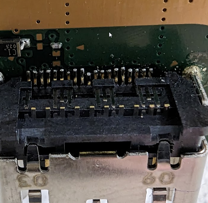

    I'm a little green when it comes to consoles. I've done a fair amount of hdmi port replacement but not really any diagnostics. I've got a PS5 here which powers up but has no video output. I've also tried to boot to safe mode, also with no video. The hdmi port does not look damaged.
    Where do I go from here? Thanks!
    **UPDATE** I take that back. The external part of the port looks fine, but look at the pins to the mobo. Those pads are ripped off. How does this happen when the feet of the port are still sturdily soldered to the board?
    **UPDATE 2** The pads were all OK. How the heck did these pins come loose?

    Hi Bloke
    My advice change the whole HDMI and give it a try, no one knows and check that cap under the hdmi is ok
    Hope to hear som good news

      You talking about the cap that's right in front of the HDMI pins? If you're referring to that one, it's missing and I'll replace at the same time.

        Remember to also check after removing the HDMI port, the diodes in the vicinity and if they are correct as well as the HDMI chip. Check that the values are not close to earth

          Thank you for that. I will check those as soon as I'm done the port replacement.
