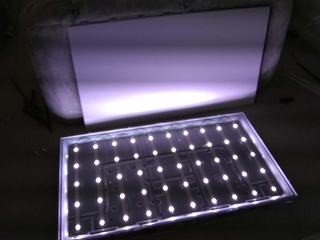

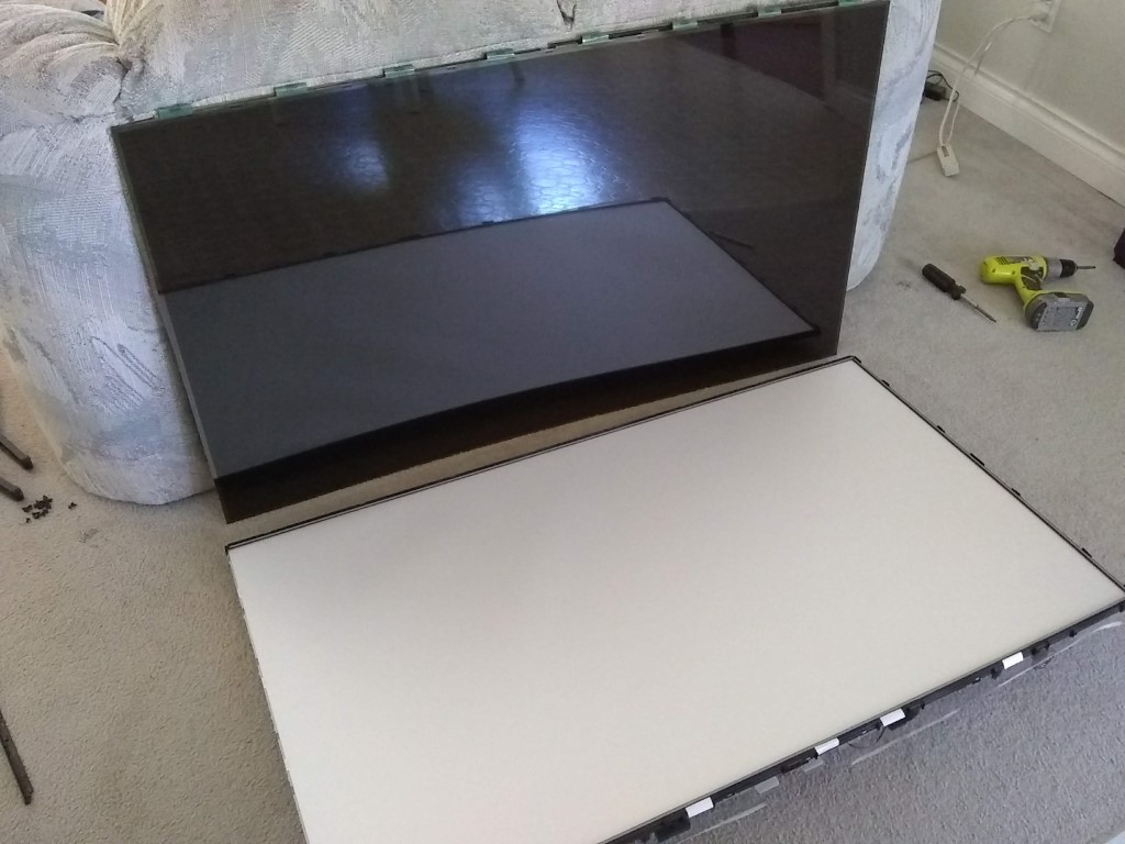

    Following some advice posted here, I do backlight replacements on a carpeted area behind a couch. When I am ready to remove the panel, I lift the TV and let the panel slide out so it rests vertically against the back of the couch. I then rest the diffuser sheets against it maintaining the order and orientation and to protect the panel. Reverse the process to reinstall though I may need suction cups for final alignment. Can post some pics in a day or two. Waiting for strips for a Hisense 55H5C with blue backlights.

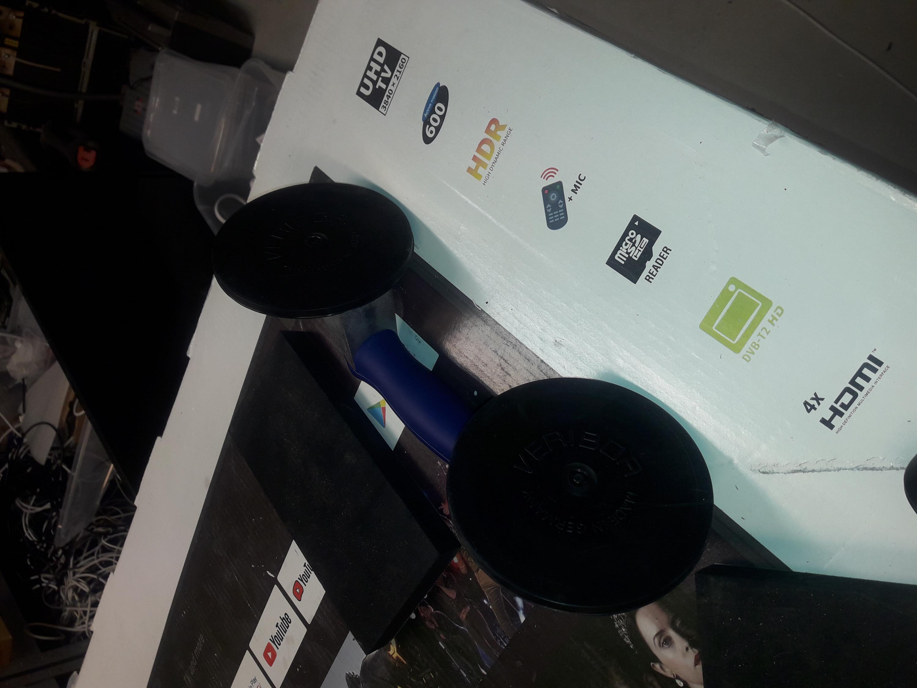

        For larger sets, I've used the suction cup tools that glass installers use, the cups are silicone and wont scratch and grip nicely. Smaller sets, I usually just carefully lift the panel out. I'm usually more worried about tearing/damaging tab bonds than I am actually breaking the panels....for some reason when they're flopping around loose, it makes me nervous.
          I’d be interested in seeing that process. Standing the thin panels on edge would make me nervous though, especially for those that have tabs on the bottom (or top) edge. I guess you’d just flip the TV so the non-tabbed side was resting on the floor.

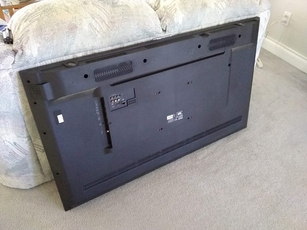

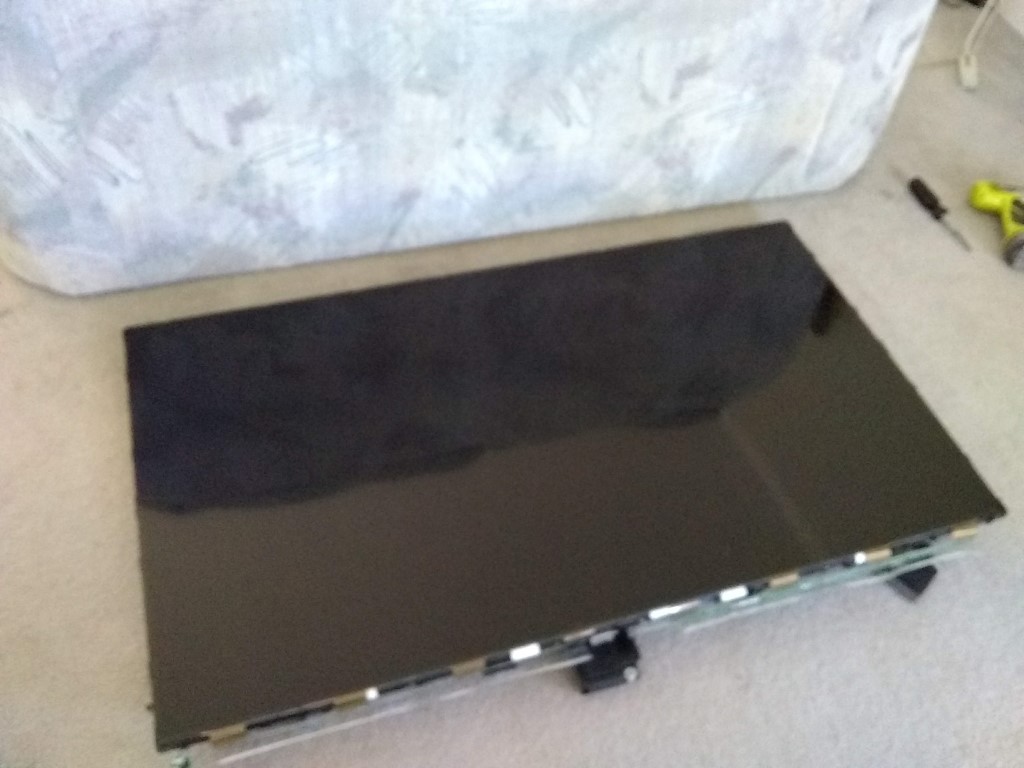

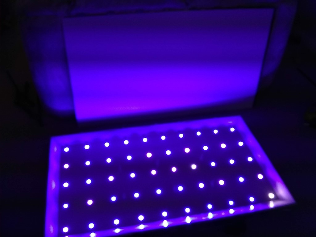

              Here are pics as promised for a blue backlight Hisense 55H5C. Yes the panel boards go on top. I remove the back screws with the TV vertical. I barely touch the panel and let it drop out (two small pieces of tape holding it down on this model). Used suction cups to adjust the panel down a couple of mm after dropping it back in. Better to have the strips in hand than to have the TV apart for extended periods. Always test the backlights with them exposed and with the diffuser sheets installed to check for dirt, dust, and evenness. Also be careful lifting up the chassis. I did a LG 50LN once and cracked the panel by lifting the chassis from the side and it twisted cracking the panel.

                Re: Removing large LCD panels
                I like your method!

                  My go-to tool for removing large panes is my pair of double suction cup grippers.

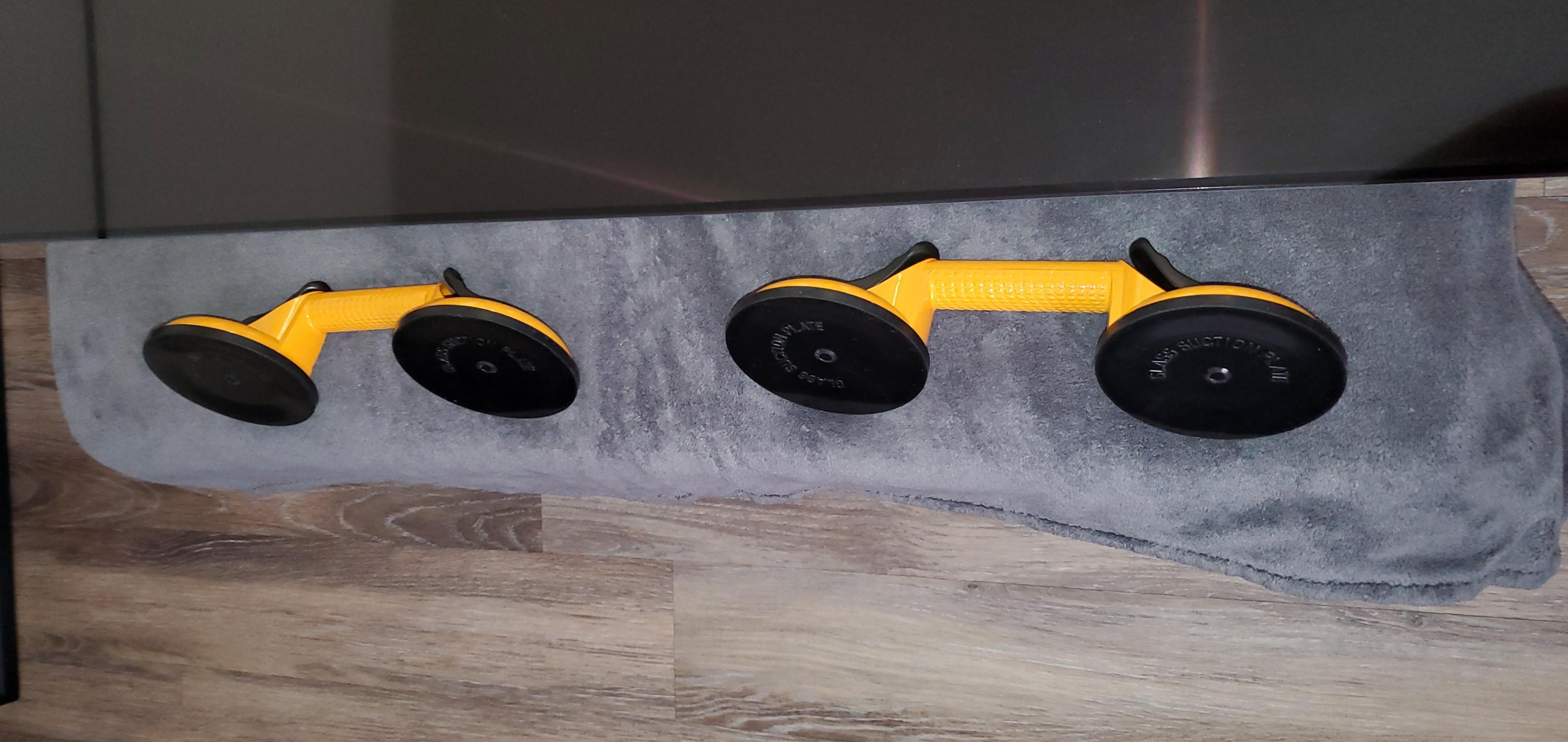

                      I recently got some suction cups that are meant for lifting TV panels and the first 2 TVs I used them on they worked perfect, although I did feel that the suction appeared to be very strong. Nonetheless, since it worked I used them on the next TV. Worked fine, but when I finished fixing the backlights and picked up the panel, there was a slight crack sound. I inspected the TV and saw nothing, so I continued assembling it. When I turned it on, sure enough one of the suction cups cracked a circle on the panel... maybe the suction is too strong, maybe I lifted it too fast, I don't know.

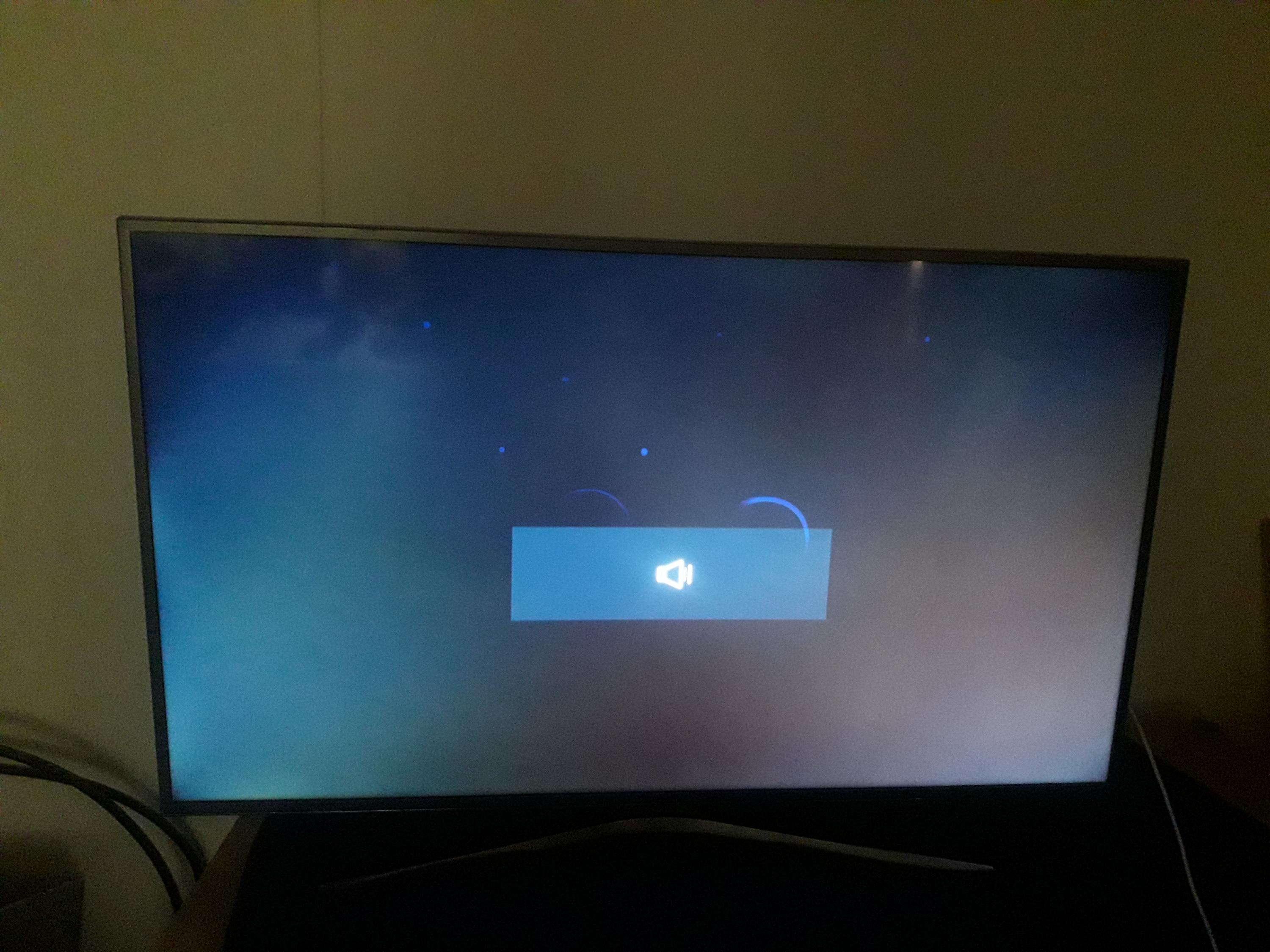

                        Despite long inactivity in the thread, and not a answer to any of the previous posts, Im posting a similar problem that I recently experienced.
                        After replacing all backlights on a Samsung 55" UE55JU6875, I got blue marks and som blue dots in dark pictures, see attached picture. This is only visibel in dark pictures. Used suctioncups to lift of the screen, so the bowmarks is caused by this, but not the dots. Anyone have explanation on what causing this?

                          This looks like the spacers inside the panel have pressed against the panel under pressure, giving you such errors.

                                        I have found that misting the screen with a little spray bottle before applying the suction cups help a lot. I also use the smaller cheaper suction cups. The quality gives the sweet spot for applying to screens. Too cheap to have a strong bond/suction that would damage the screen but just strong enough to stay attached with the aid of water and a clean surface. I got mine from Harbor Freight.
