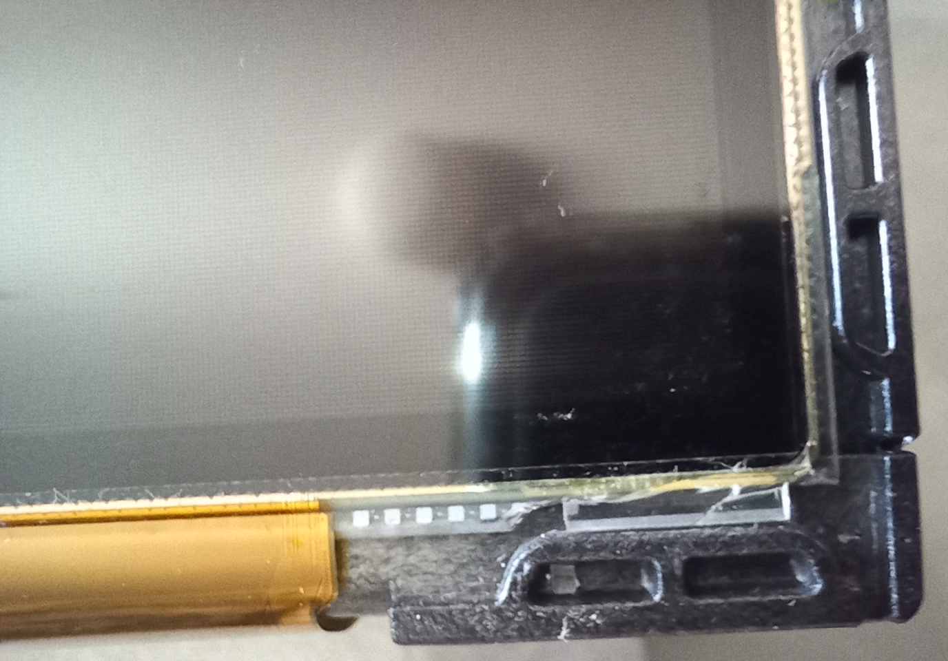

      I thought that my method of disassembling the panel with LCD screen looking down laying on the table was safe, until today. It’s very safe for disassembling, but reassembly can be catastrophic, because you don’t see how the LCD glass aligns with the backlight chassis guides. This is what has happened to a Samsung UE48JU6060K with a LSF480FN05-K04 LCD cell (attached image). When reassembling the TV, the glass was trapped by the black guide and cracked when pressed against the front bezel. Now that side of the screen is darker and has motion artifacts.
      So now I face either to stop repairing anything that implies opening panels larger than 40" (which basically means leaving the business), or either to find another way to disassemble/reassemble them.
      Suction cups seem to be risky and can produce mura effect or even break the glass due to excess of force. What do they use at factories to assemble the TVs? I guess that they use suction cups connected to a vacuum pump with controlled pressure.
      What about a set of smaller and simpler suction cups attached to a structure?
      I’m only interested in solutions that can be performed by a single person, because I work alone and nobody can help me. I’ve already ruled out TVs larger than 55", because I can understand that a single person cannot safely lift a 65" glass.

        Re: Removing large LCD panels
        I work by myself also with no help. And only broken screen with suction cups that failed.
        Personally I don’t work on anything smaller than 50” as there’s just no money to be made for me.
        Every screen is different. Some have no bezel and are glued. Some lift right out.
        You just have to figure out what works best for you and what you’re comfortable with.

          In this video we can see a chinese assembly factory of LCD TV. At minute 10:00 there's a contradictory view: first, a worker grabs a large LCD cell by hand and places it over a light table for testing, and after that, a machine with about 12 computer controlled small suction cups moves the cell over a pre-mounted backlight. Before that, it rotates 90 degrees to let a worker peel a protective sheet.
          In attached picture we can see a cheap chinese tool with simple suction cups. Anyone uses this?
            Originally posted by Chungalin
            https://www.youtube.com/watch?v=_-cKfX3WmSM
            I believe the panel she is handling still has protective film on it. Possibly both sides. That film may give the LCD increased rigidity so I can be handled as shown. At 10:45 you can see the film being removed prior to being assembled into the display assembly.
                I use the big double suction cup technique . Sometimes you will get like a circle mark on the screen if it has been on the for a long time, but it goes away in a short time. I always clean the sdie of diffusor that points to the leds , because it is known there for dust to settle. Also when putting back the screen , check for fitment on every corner , make sure the plastic saddle is clipped all the way around , and then you can put the bezzle on the screen. Pretty straight forward , i made a video showing the full process with some advices here and there , but i still havent posted it. Also i would prefer to have an air compressor nearby or some elctrical blower to clean before putting back the screen.
                  this ones are perfect...easily lifts 50" to 60" panels. Larger I did not try but I cannot see any problem.
                    2 suction cups and put to the side of chassis - my bench is long enough for that. Before cups I had large piece if cardboard, Id lift a corner and slide the cardboard in.
