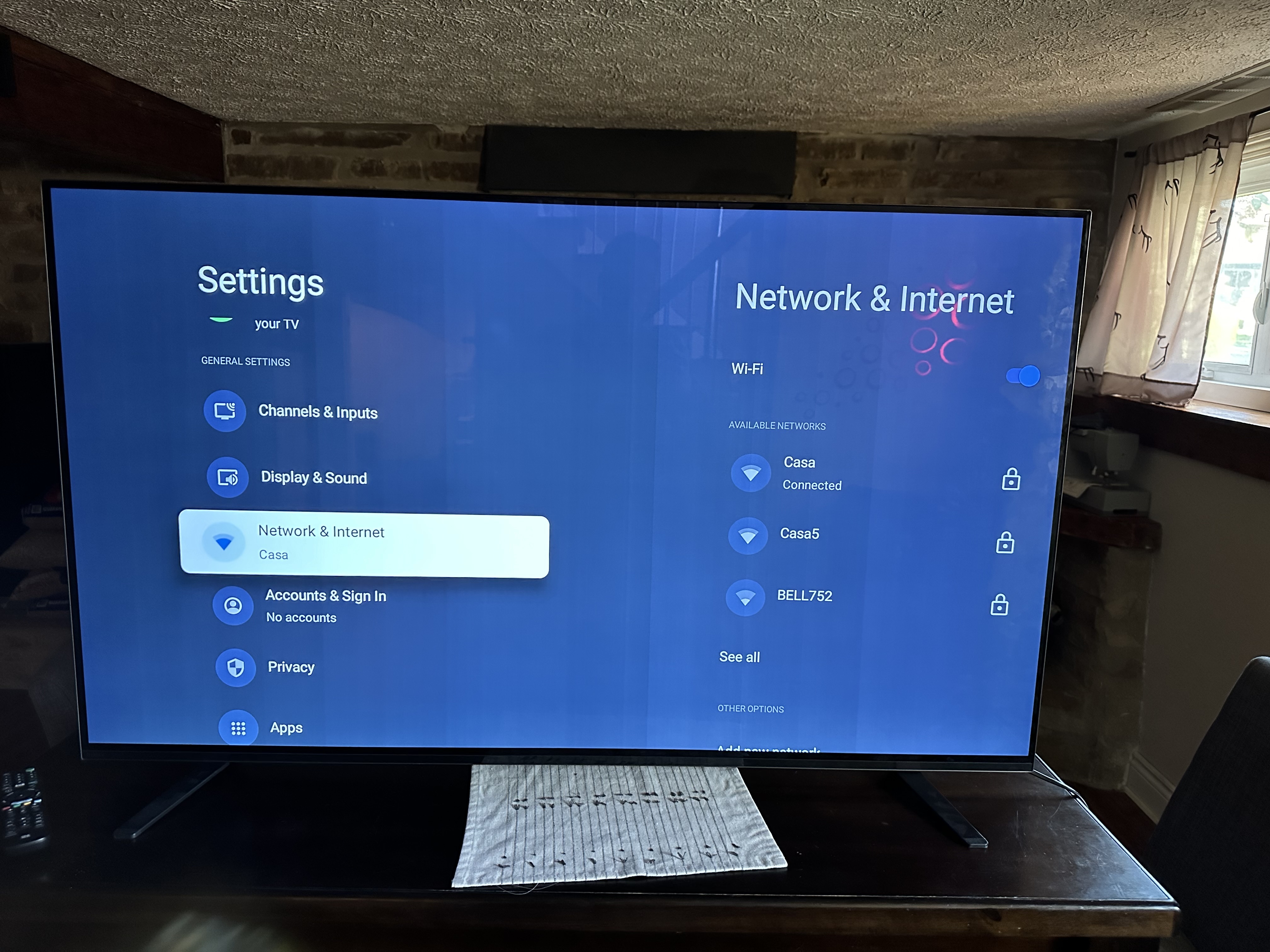

              hahah, i fixed the damn tv ! Woop! A hard reset fixed it. So at the end, it was just a bad cap. Pretty happy camper
              • cheebster
                • May 2008
                • 376
                #127
                Question; i've got some grey banding on the screen in the menus, this is an android tv which i don't know much. Is this normal ? I'm not sure i put back the original TCON in it.

                  #128
                  this happen because you removed all 4 ribbon cable and when you put them back you switched it places.... by time and pixel refresh get better
                  could you show the Cap place for refrence
                  • cheebster
                    • May 2008
                    • 376
                    #129
                    Hello, didn't remove the 4 ribbons at all, yes see my previous posts i posted a picture of it

                      #130
                      i wrote to you the reason caused this look ... if you didn't, then some one ells before you.

                        #131
                        Carefully clean the contacts on the bottom and top of these 4 cables, also replace the lvds cable...

                          #132
                          will not help if they changing places.. also new ribbon will not help. because each channel are from Factory calibrated with mAm., need WB calibration adapter., or each time pixel refresh they will get better
                          • cheebster
                            • May 2008
                            • 376
                            #133
                            The cables were not removed they were really sticked to the board there, from factory. Maybe i'm using the wrong tcon, could this cause the bandings ? Or the LVDS cable that looks like sh1t.
                            • Diah
                              • Feb 2013
                              • 6503
                              #134
                              if you are so sure 100% then as yours ribbon photo there are damage with 2 wide lines from both side.. this will reduce the Ohm. so the mAm calibration will be effected-

                                #135
                                Originally posted by Diah
                                put back yours original t-con if you didn't missed with it
                                after that you do hard reset by pressing the joystick down then plug in wall remove only after changing front LED from white to green
                                by the way i wrote to you before... did you put the Original T-con? if yes then change the ribbon at least the result will be more better

                                  #136
                                  You put almost certainly the spare tcon, you need the other one, but you have to reset again
                                  • cheebster
                                    • May 2008
                                    • 376
                                    #137
                                    Ok, new set of cables didn't fix it (can't hurt). Put the original TCon in, banding is gone, image is perfect (well it's pretty clean). Sucess! Thanks for the help.. 🍺🍺🍺
