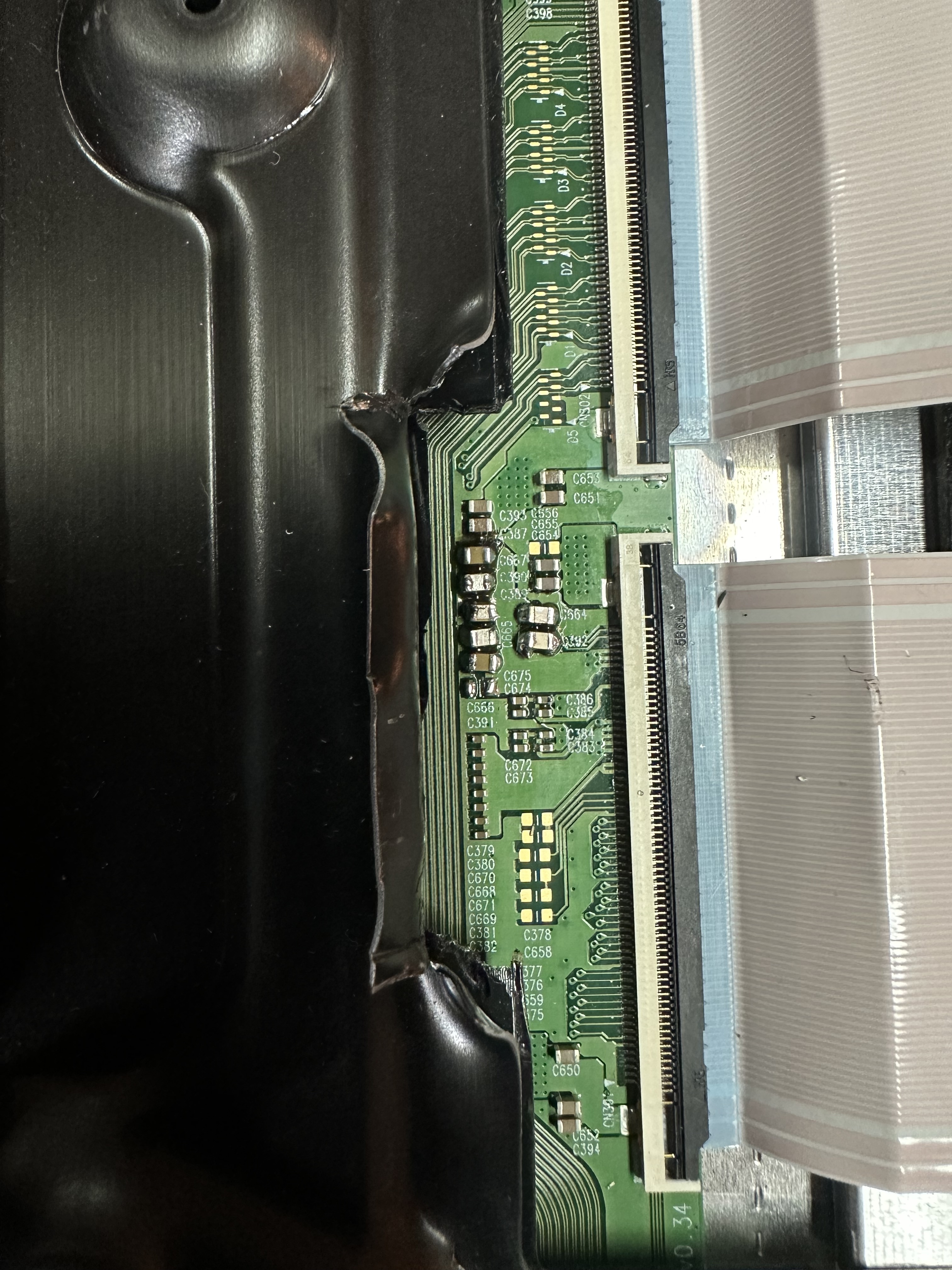

                        • thetomma
                          • Oct 2024
                          • 6
                          • Poland
                          #112
                          Originally posted by Davi.p
                          1) have you checked or not to witch line the shorted caps belongs to?
                          2) with this evdd disconnected have you checked the basis supply lines if are present or shut down? Are you able to find and check them?
                          3) you cannot inject svdd line alone from what i remember, this is dangerous for the cof, you need first to supply the vcc line, that is 3,3v i think
                          1. I checked i think all caps on tcon, none seems to be shorted, also fuses seems to be ok.
                          2. I havent checked power supply lines yet, you mean measure voltage on lines from power source board to tcon when tcon is connected to evdd and whe in disconnected?
                          3. Thanks for warning, by the way evdd is the same as svdd?
                          By the way on old tcon i found PCB in that area has a bit different color, it looks like it was high temperature there or some liquid: Click image for larger version

                                #115
                                Oh well, got some progress here, cutted the metal plate so i could see the caps just a bit lower where the 4 lvds cables go from tcon to the panel, and found a shorted cap! Removed it, and tv doesnt blink anymore but no display, but ive got a butchered lvds cable from main to tcon. Gonna order a cable and see if it fixes this one!
                                • Davi.p
                                  Hobbist Tech
                                  • Sep 2009
                                  • 4278
                                  • Italy - Milan
                                  #116

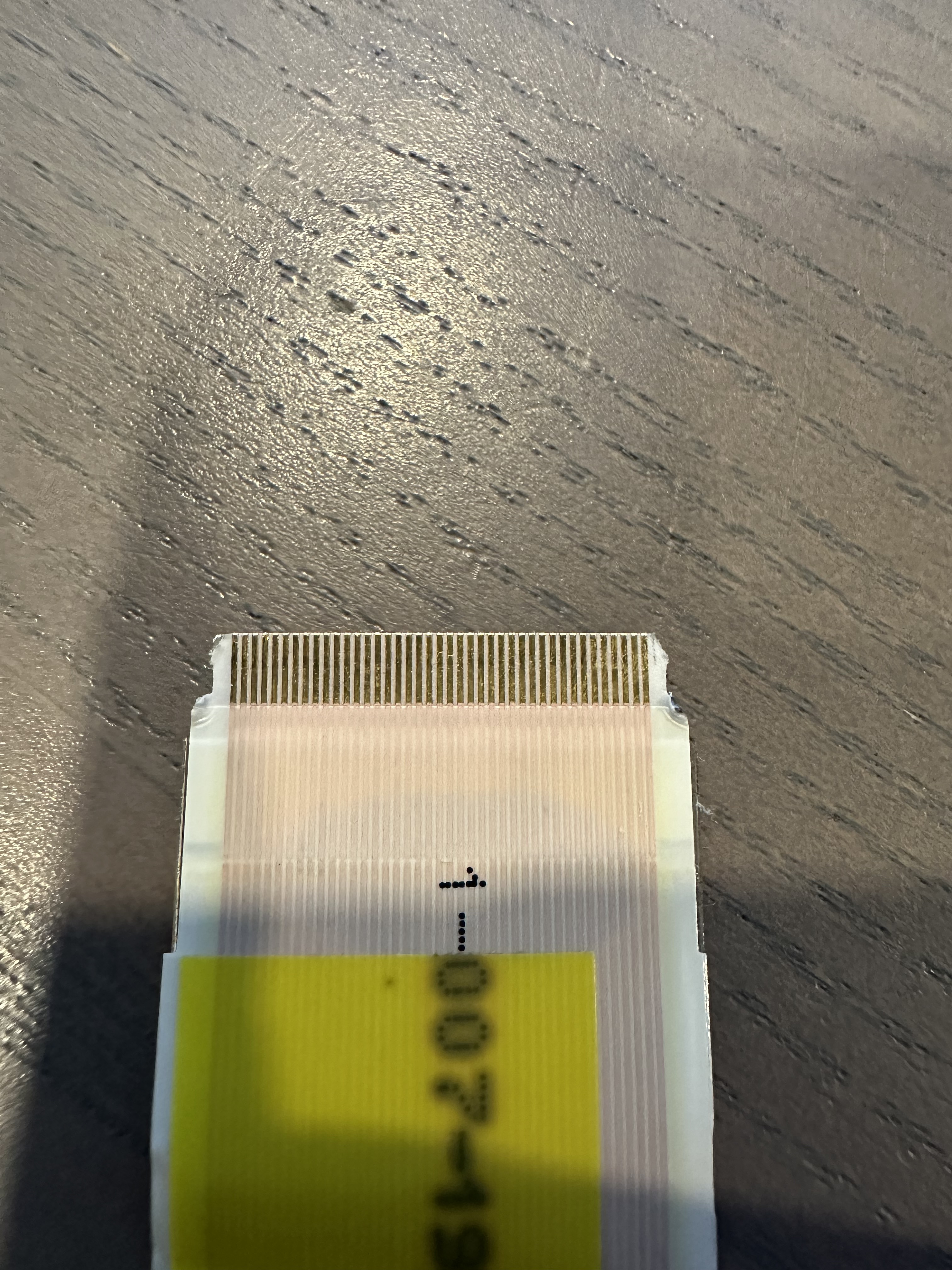

                                        Originally posted by lotas
                                        This is not a simple T-CON (LG), and you can't just put it into standalone mode.
                                        Here is the method posted by diah here;
                                        If you got at first test EVDD Lower than 24V then drop down... and the VIN remain at 12V or also drops down ... then do the next
                                        Second Test: ( running the power boards and the panel as stand alone )
                                        1- disconnect the Main boards totally from Power boards and from the T-CON ( mean disconnect the socket coming from the power boards & disconnect the 2 LVDS between Main boards and T-CON .. unplug them from T-CON Side )
                                        2- Disconnect the T-CON from Power boards ( unplug 2 sockets VIN & EVDD )
                                        3. RUN POWER BOARDS as Stand alone ....
                                        make bridge with R value 100 to 1K Ohm ( if the STBY 3.3V you can do it direct with out R but need to be sure 100% of the pins label )
                                        A- STBY & Power_ON ( this will turn on REG12V ON )
                                        B- STBY & TCON_12_ON ( this will turn on TCON_12V ON )
                                        C- STBY & EVDD_ON ( this will turn on EVDD V On Max 24V )
                                        if you confirmed all 3 Voltage in A,B,C you have ... then complete
                                        4- RUN The panel Module as Stand alone
                                        A- Feed the T-CON with VIN & EVDD V which you got at above points B & C
                                        Are you saying this wont work with these models ? All i get is a black screen with either original or replacement t-con, even with that panel test mode.
                                        I'm wondering if i should get a replacement set of cables. I attached 2 pictures, one is where i found a shorted cap, and second is the condition of the cable (can't even align it right it's so messed up, pins might not even be touching the socket pins properly.
                                        Also wondering, is the missing CAP (the one that was shorted) an issue ? They were all connected together, figured out missing one wasn't a big deal, maybe guess wrong.
