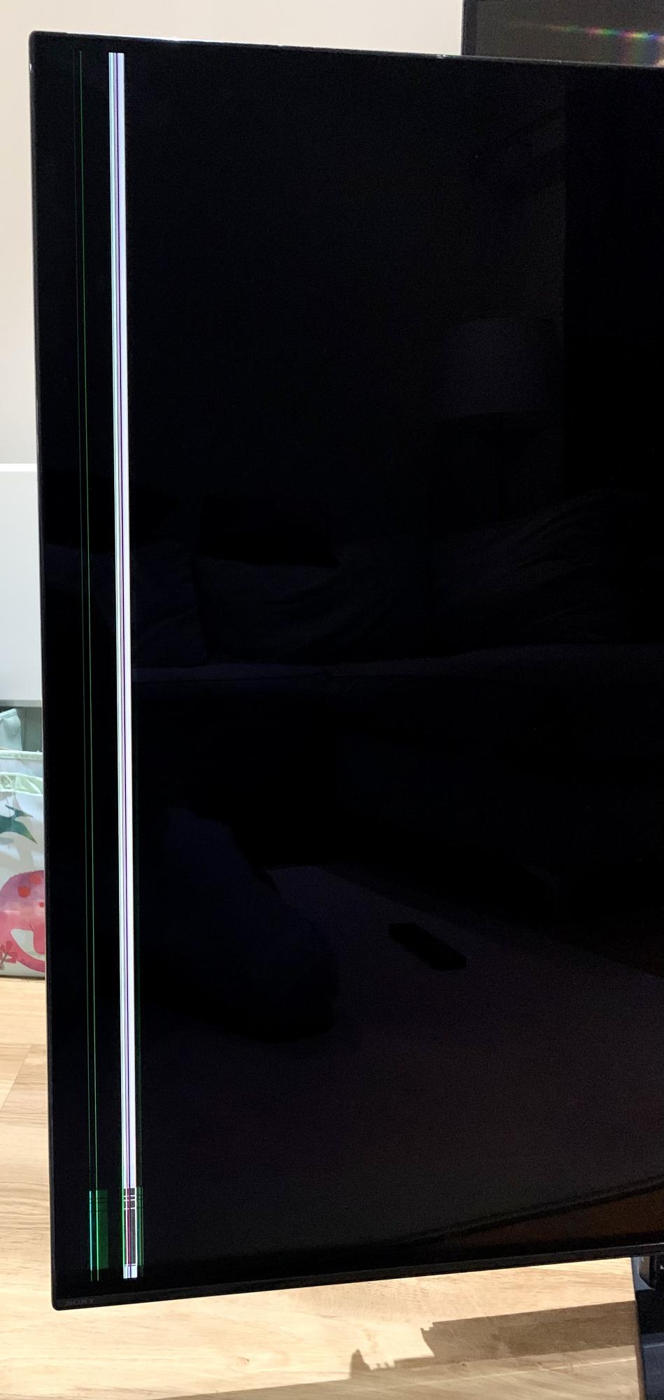

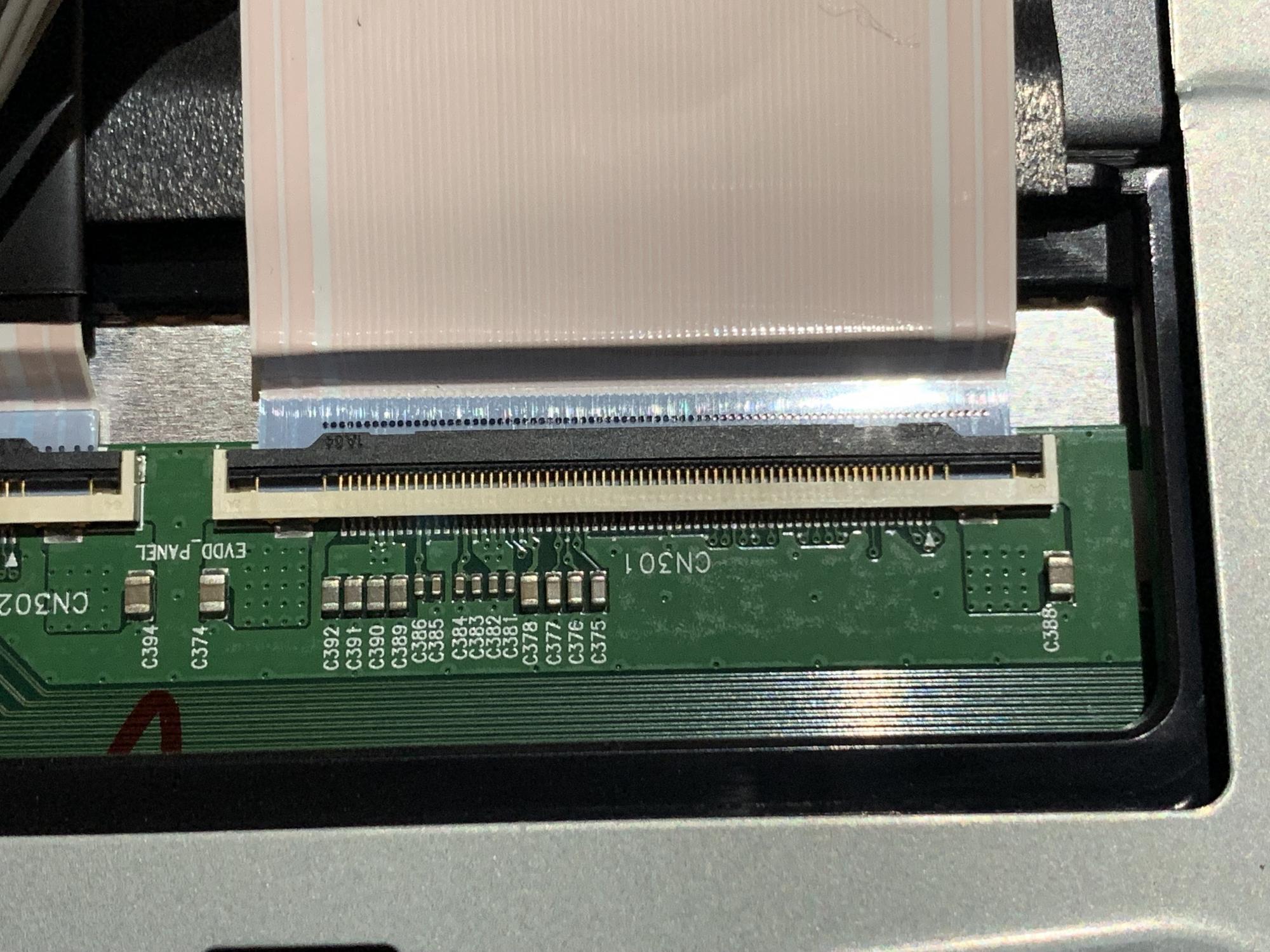

            Hello, Diah. Can you help me? I have exact same TV as topic starter and it does blink 4 times red. The problem looks like tcon is throwing an error to motherboard (when panel starting up) and it shuts down evdd. For a moment it does show a line on a screen and then powers off. Very briefly. And then blinking red 4 times. So what ive done is I jumpered EVDD_ON with TCON_12_ON on PSU board disconnecting a wire from motherboard so it wont pull it down again. And disconnected 2 flex cables from tcon to motherboard so it wont go into red blinking mode. And it powers on, music is playing and it shows me that line constantly (that was briefly before). So basically when tcon is getting its 12.6v and 21.96v voltages it powers up panel and shows me a line. Why and how to fix it? Is it tcon failure or panel is shorted or something? Also is 22v evdd is normal voltage?
            Adding photo of the line (when EVDD is forced ON)

              #46
              Re: Sony OLED XBR65A8G no video, PSU problem?
              Originally posted by flusher
              Hello, Diah. Can you help me? what ive done is I jumpered EVDD_ON with TCON_12_ON on PSU board disconnecting a wire from motherboard so it wont pull it down again. And disconnected 2 flex cables from tcon to motherboard so it wont go into red blinking mode. And it powers on, music
              this is wrong test.. follow exactly the stand alone test as i wrote in post #4 no more or less... show me what you get on screen

                That doesnt make any difference as I have unplugged mainboard from tcon already. But just to double check I did exactly what you said in that post. I jumpered STBY with TCON_12_ON + EVDD_ON + I had to add POWER_ON (otherwise it wont produce any voltage at all). I have everything else disconnected. Just tcon and psu jumpered. And it does show exactly the same line as above I posted. Please take a look at the pinout and jumper setup. Any further advice?

                  yours photo
                  the line on the left side or the right side... ?? yours photo cut the rest of the panel.. please upload close photo of yours T.CON after you take out the metal shield,

                    [the line on the left side or the right side... ?? yours photo cut the rest of the panel.. please upload close photo of yours T.CON after you take out the metal shield,
                    the vertical line is on the left side. the rest of the tv is black. so there was no point to attach whole tv picture, just so you can see that line clearer in zoom. I can add one more thing. When motherboard is connected and screen lights up for a blink of a second I do see greeny screen and a that line. Without motherboard there is no green. I will remove metal shield and add tcon photo soon

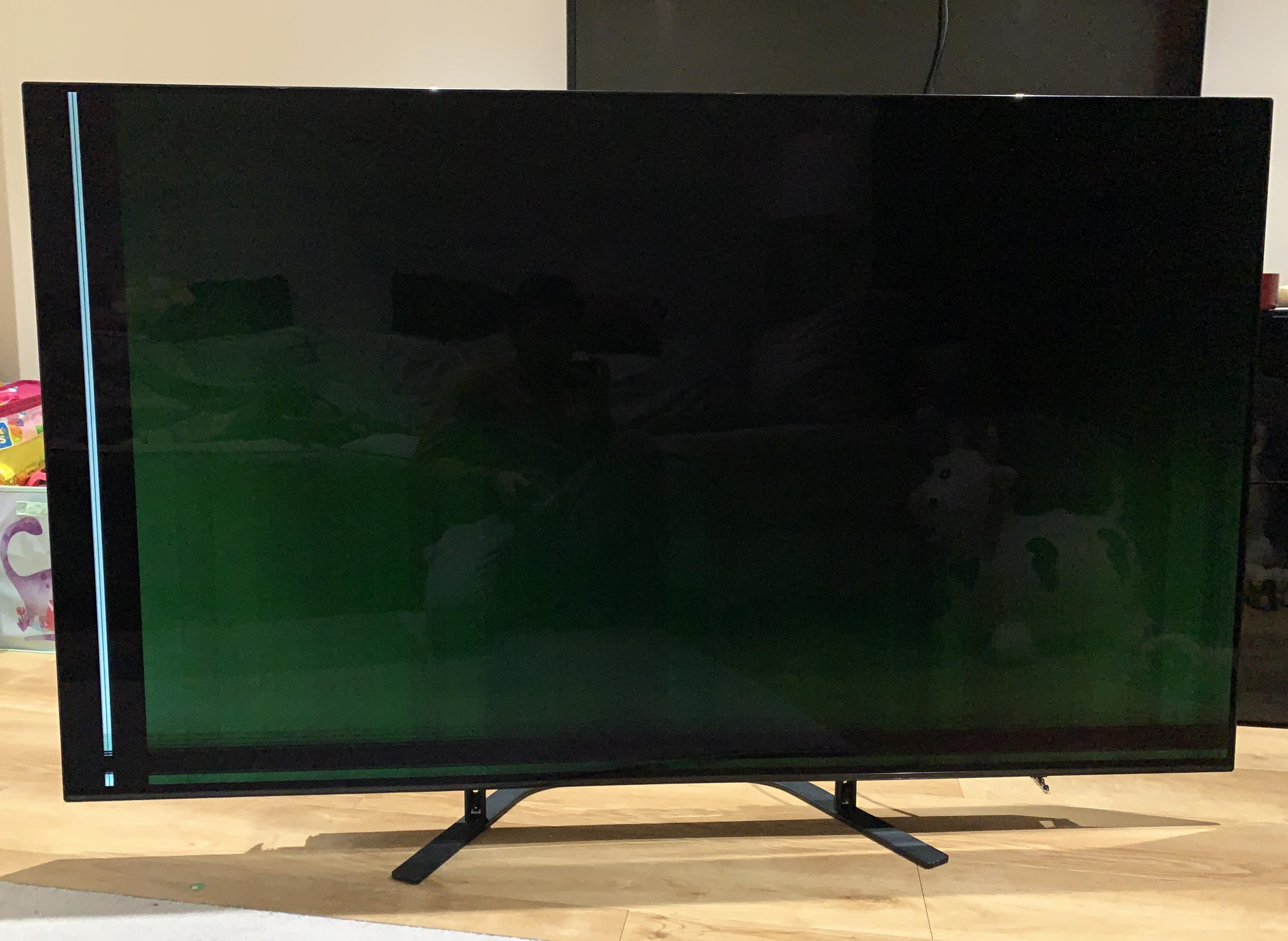

                      you mean the green and the line showing for short time when you are turn on the tv as every things in place... no jumpers at all... right ??
                      when you test the panel as stand alone.. you get only the line which out green.. right ??
                      but why your first photo showing only the line no green...?? are you just now for first time saw the green after you run panel as stand alone... i want to understand why you upload first photo with only line !!!!

                        ok, to avoid any language barrier i will speak as short as possible.
                        when ALL connected, NO jumpers - I am getting that GREEN SCREEN and LEFT LINE as above photo for a millisecond then TV SHUTDOWNS 4 RED BLINKS
                        when ONLY PSU and TCON are connected using JUMPERS - I am getting LEFT LINE ONLY - all screen IS BLACK as first photo
                        i did not upload photo with green because i read what you said to other people that first thing we need to power panel and tcon standalone

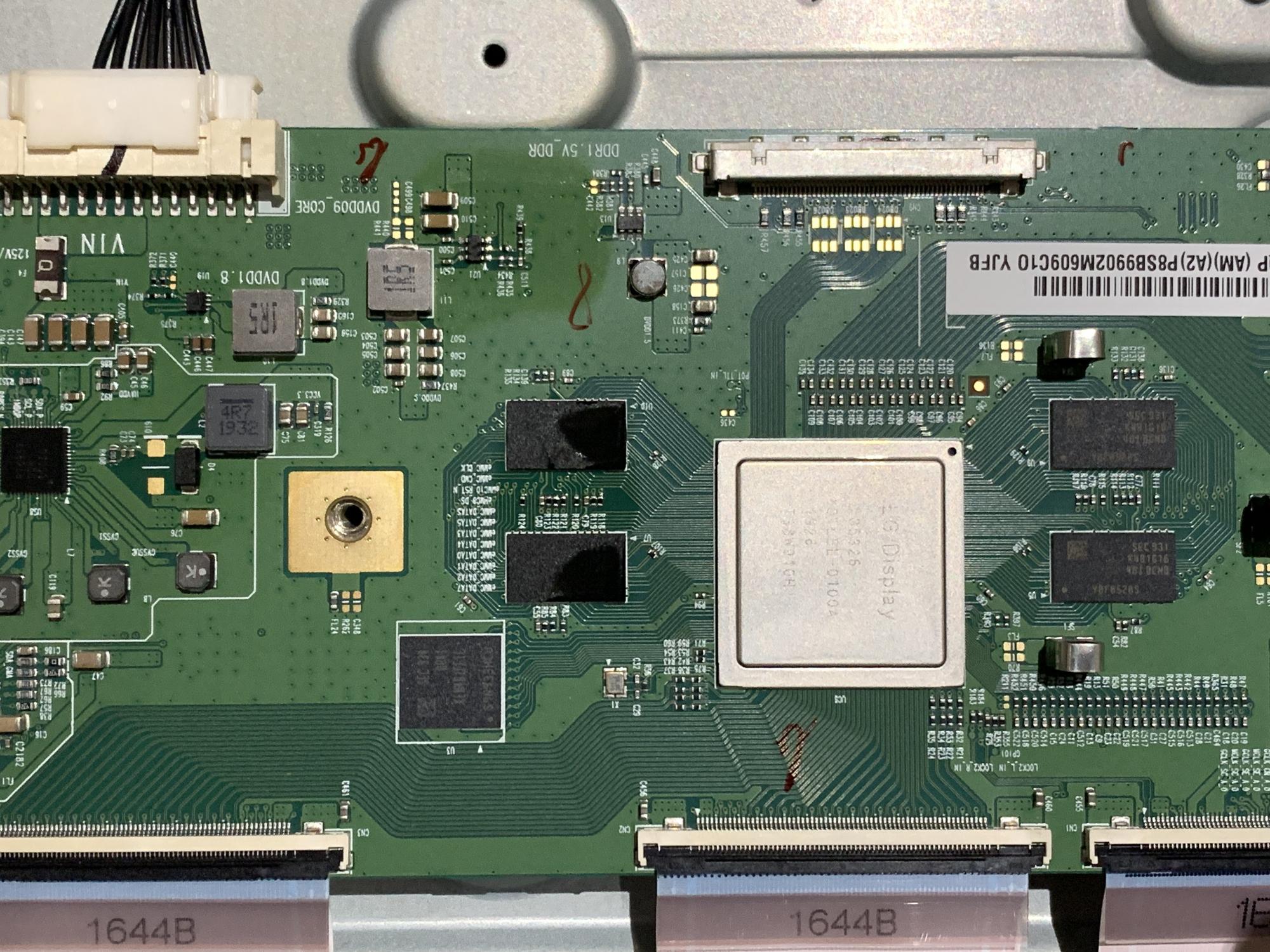

                                  also if you look from the tv back. the last ribbon cable on right side. the left of it you have 2 wide line let say 1-2 , after them to the right pin 4-5 / pin 7-8 / pin 10-11 /are the return syncs to the t-con. i am not sure if your panel module version match this diagram. the idea to let the TV run normal and we block this return between the panel and T-CON driver boards. to avoid the T-con turn off and send error to MB.. if we reach this point you will be sure 99% what happen to the panel.

                                      the photo i upload wasn't to t-con socket.. its for the second socket panel buffer right side boards

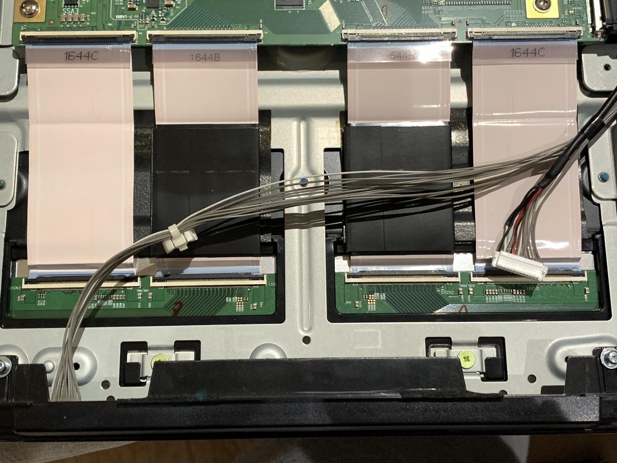

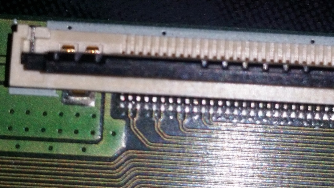

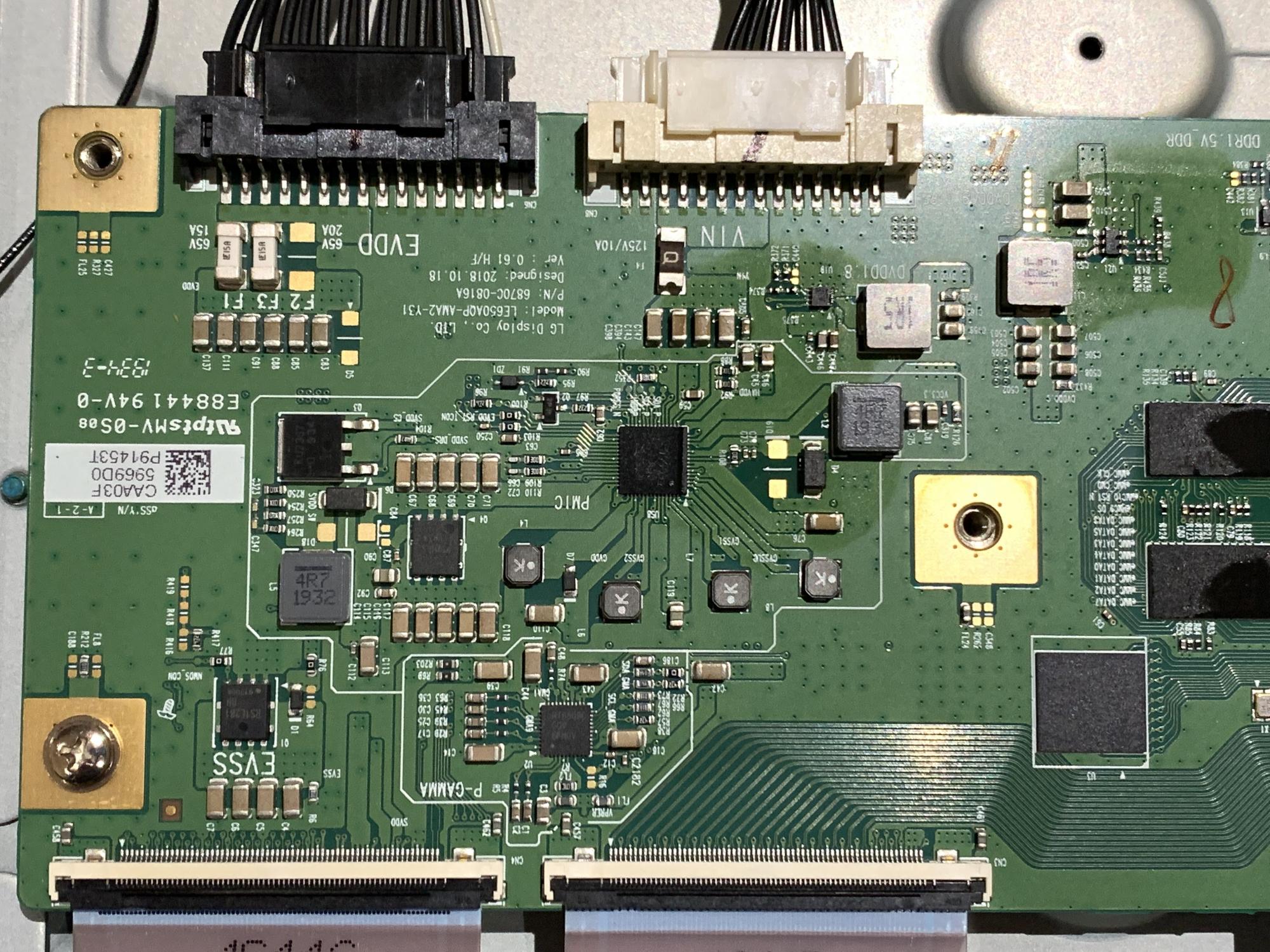

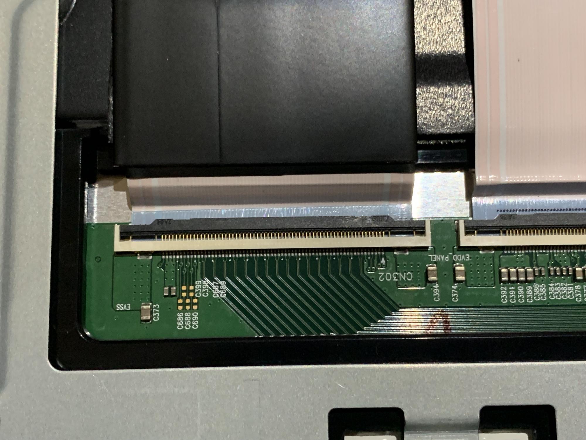

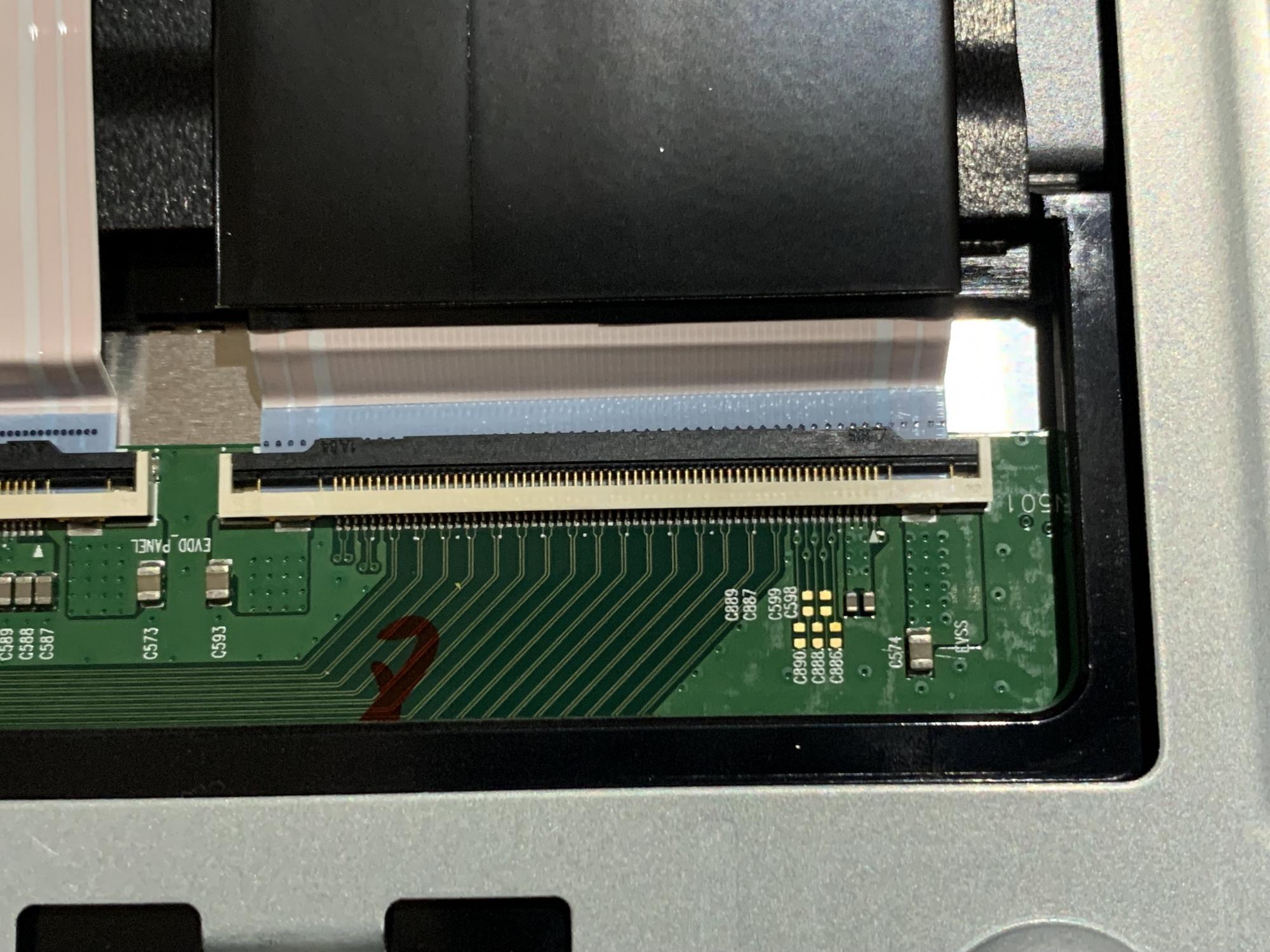

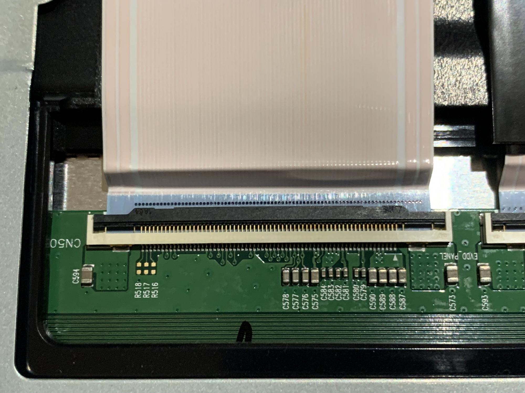

                                          #60

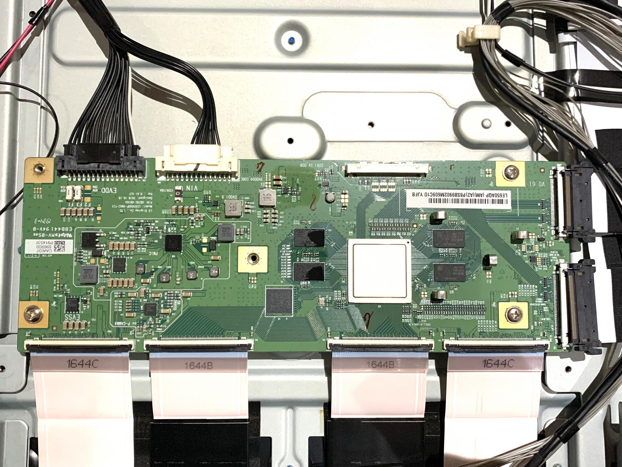

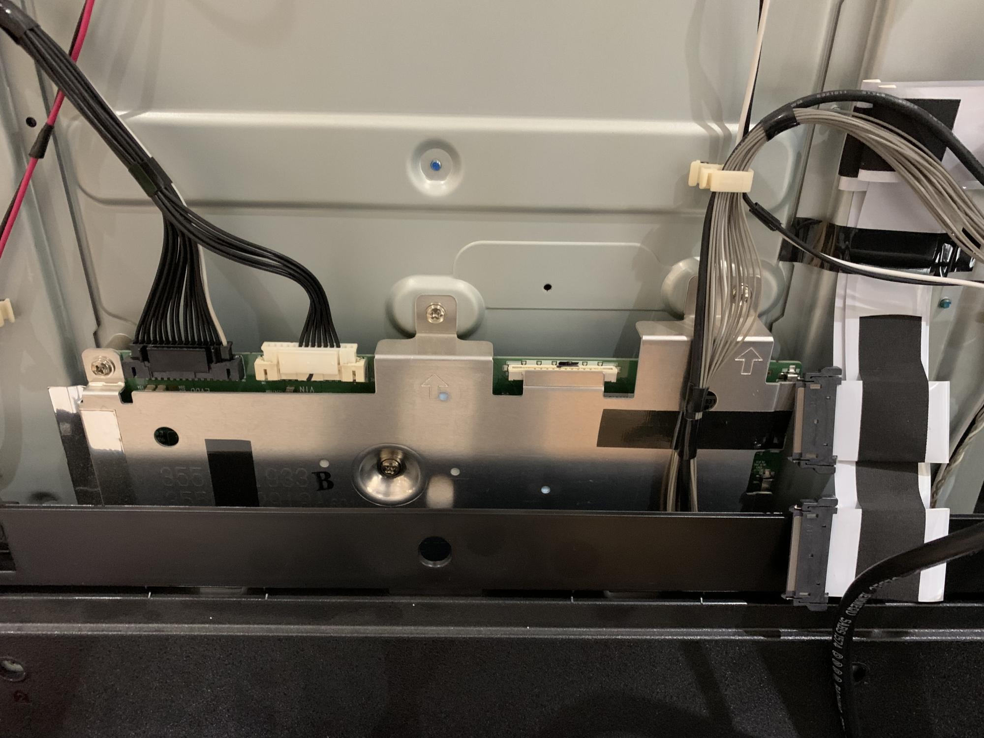

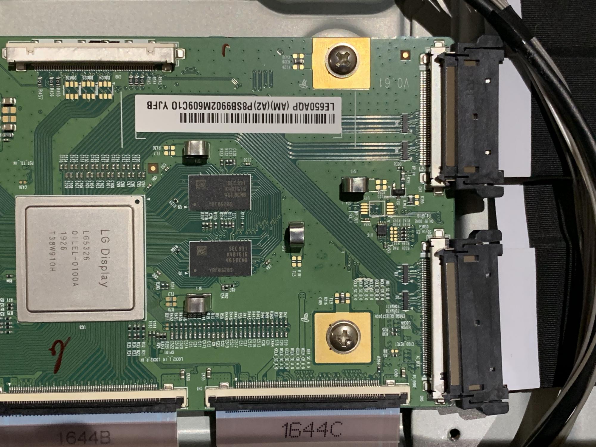

                                          here is the photos of tcon and lcd connection. ignore wet spots on tcon as it is silicone thermal pads on metal shield (considering its normal).
                                          not really sure what should i isolate and on which flex
