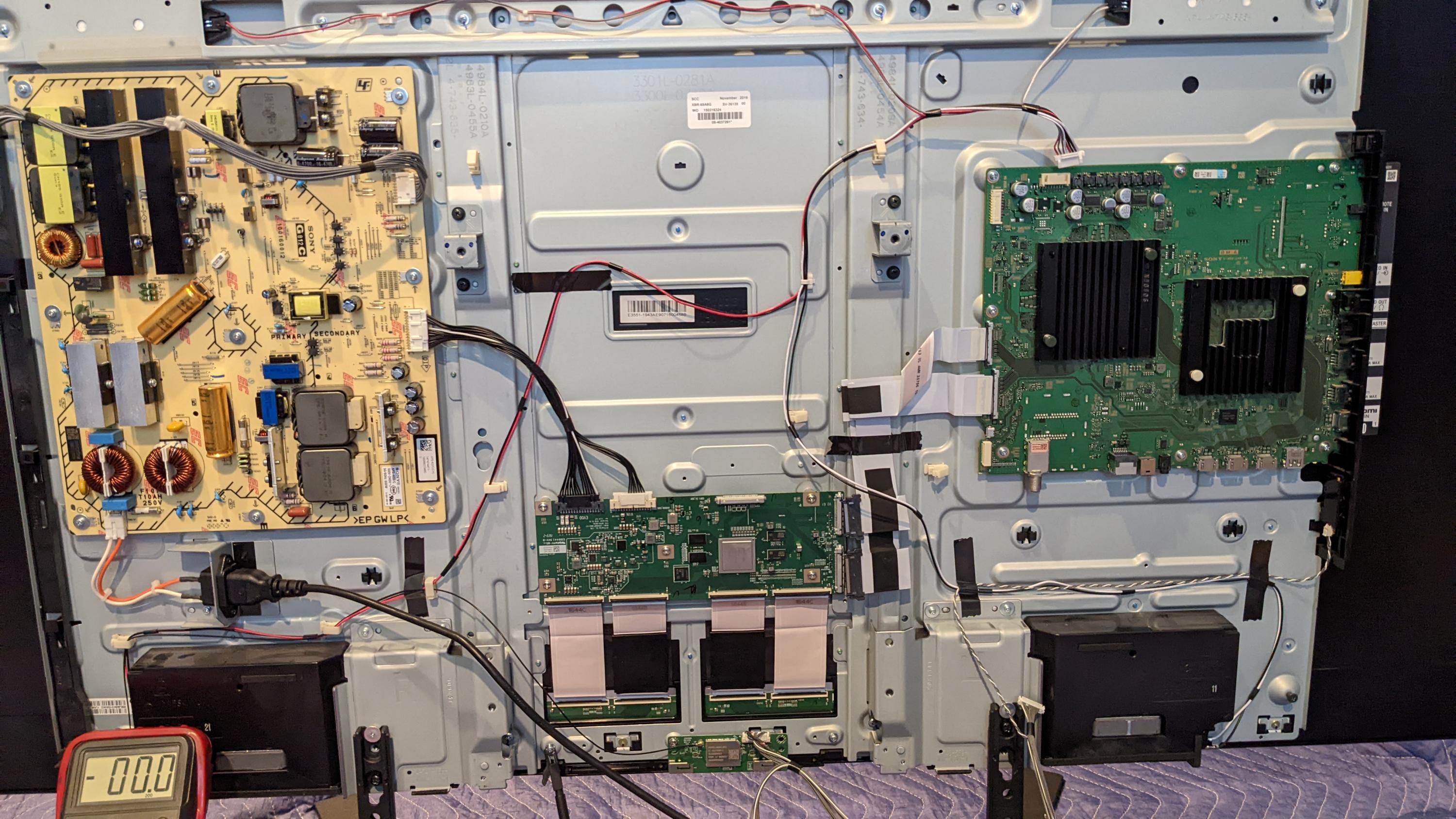

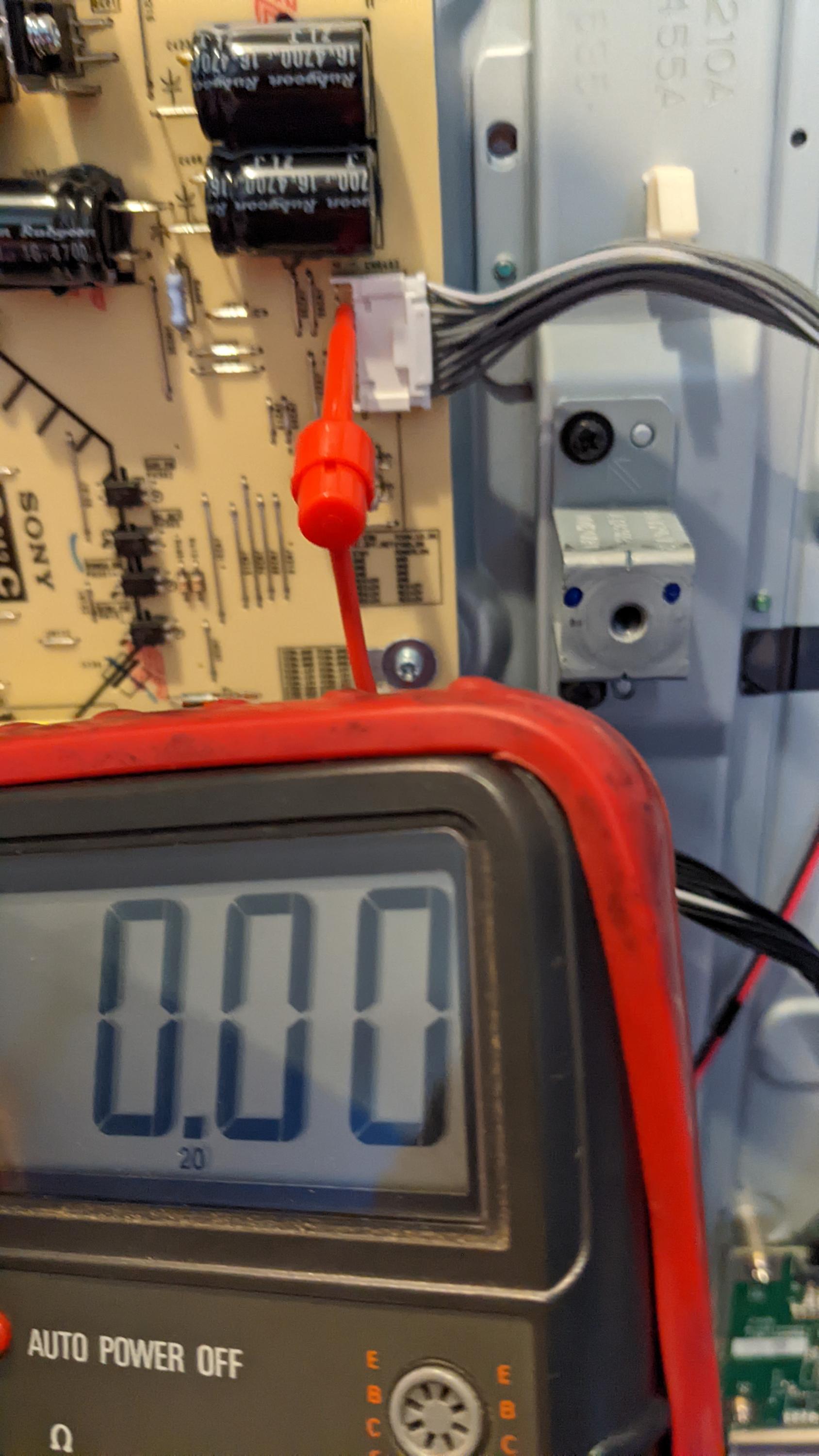

                              With everything back to factory configuration I am not getting any voltage on anything. I am getting very frustrated and will try again tomorrow and provide a full write up of all the troubleshooting I have done thus far.
                              The most concerning to me is when following your initial steps to power on the screen via the bridge/jumpers did not work, but the PCB and TCON were getting the correct voltage.
                              Thank you again for your patience. I apologize my steps were not detailed and bulleted. I will provide better write up tomarrow.

                                Diah as promised attached is a detailed write up of the troubleshooting steps and results. Thank you again for your assistance.
                                Symptom:
                                TV randomly restarting with increased frequency overtime until eventually would not power on
                                Issue: TV will not power on. No LED. No Signal from Optical Audio Out
                                Troubleshooting:

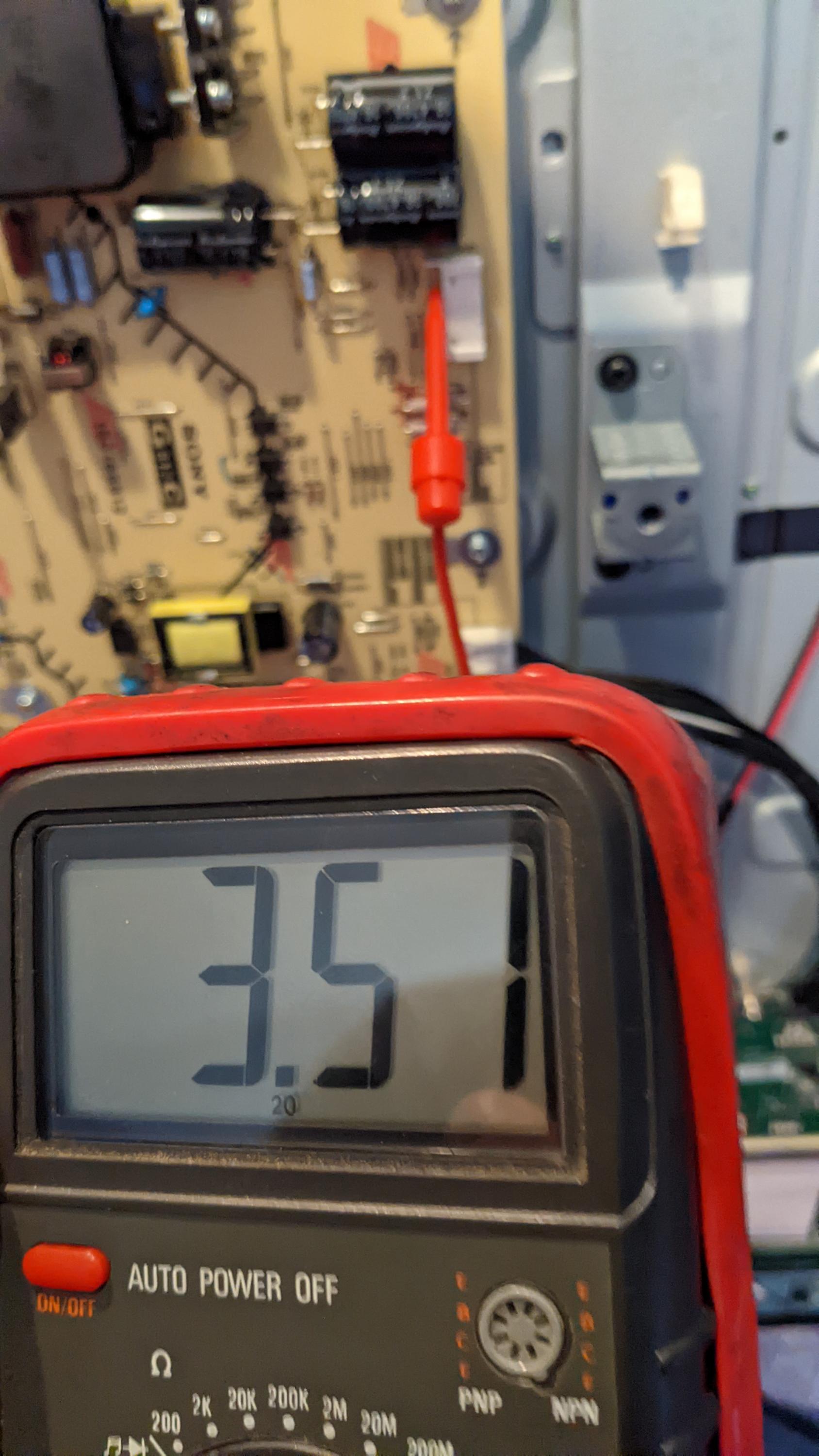

                                Task 1: Removed back panel and tested voltages on PSB
                                Result 1: No voltage present on cable terminals going to main board or T-CONN
                                Task 2: Removed PSB cables going to main board and TCON board
                                Result 2: Only voltage present on board terminal to main board was the Standby PIN at 3.5 volts
                                Task 3: With main board and TCONN power cables removed from those boards, made pigtail to bridge/jump Standby, Power On, TCON ON, EVDD ON
                                Result 3: Note: When I plugged the pigtail in I could hear an audible click at on PSB board.
                                Voltages observed below:
                                *PSB Terminal to Main Board*
                                Row 2 Volts Row 1 Volts
                                BL_ERR 0 TCON_12_ON N/A
                                AC_OFF_DET 0.49 EVDD_ON N/A
                                STBY N/A Power ON N/A
                                GRND N/A GRND N/A
                                GRND N/A GRND N/A
                                GRND N/A GRND N/A
                                REG_12V 12.8 REG_12V 12.8
                                *PSB Terminal to EVDD and VIN*
                                TCON_GRND N/A TCON_GRND N/A
                                TCON_12V 12.8 TCON_12V 12.8
                                EVDD_GRND N/A EVDD_GRND N/A
                                NC EVDD_GRND N/A
                                EVDD 22 EVDD 22
                                EVDD 22 EVDD 22
                                EVDD 22 EVDD 22
                                EVDD 22 EVDD 22

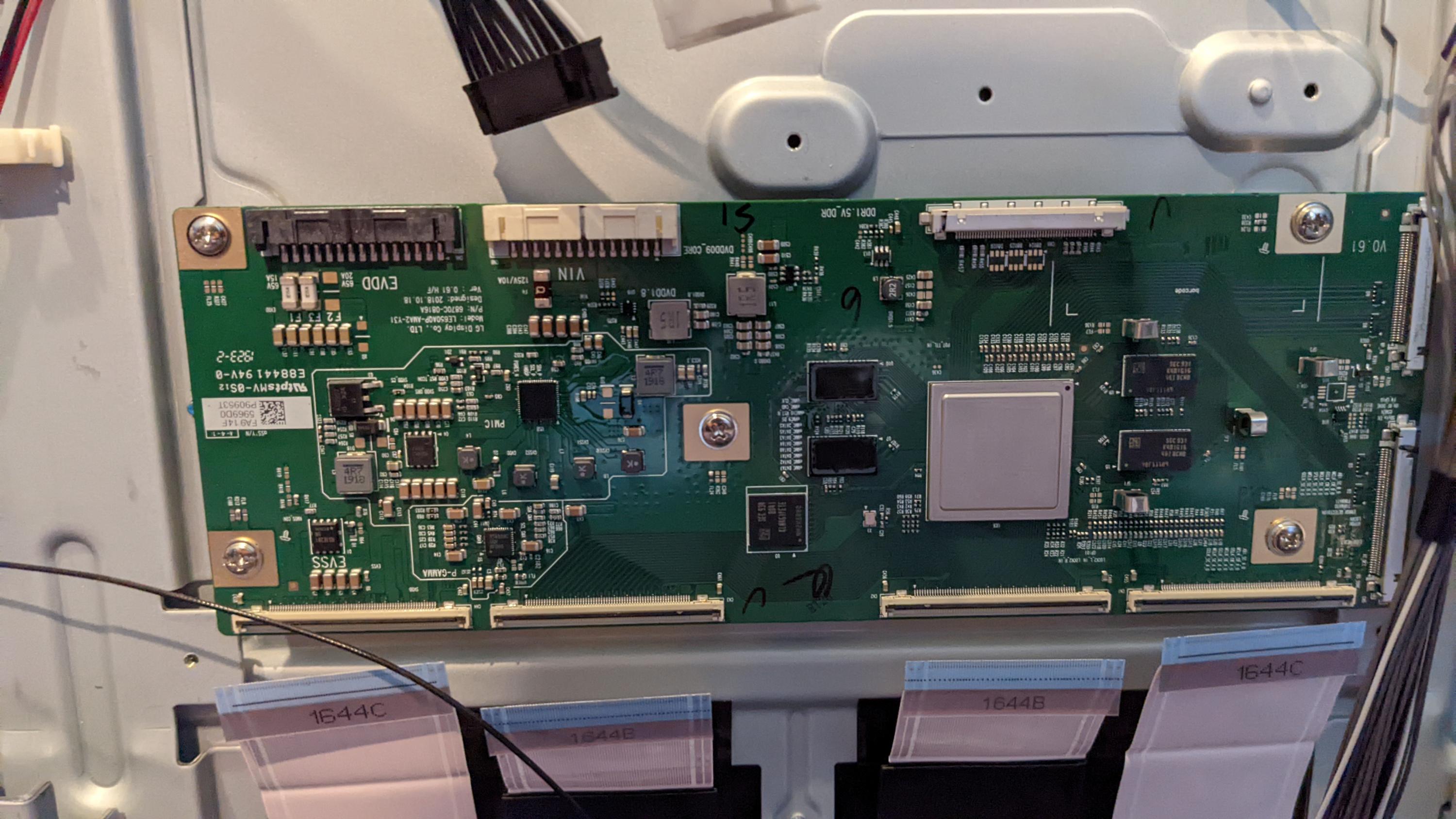

                                Task 4: Unplugged the two LDVS cables going from TCONN board to Main Board and plugged in pigtail to energize the PSB
                                Result 4: TCON EVDD terminal was receiving 22 volts from PSB and VIN terminal was receiving 12 volts from PSB. Screen did not power on
                                Task 5: Ordered new main board and installed and reconnected all connectors. Installed Optical Audio Cable. Powered on and left for 30 mins. Also tried to power on with button and remote.
                                Result 5: No change. Voltage was null across the board on the PSB terminals to the main power board and TCONN board as it was in Task 1 Result. No signal at optical audio cable. No audible click at power supply.
                                Task 6: Reinstalled original Main Board and began unplugging components like the WIFI card and IR sensor and plugging in the main power cable to the wall.
                                Result 6: I was able to read 12 volts coming from the PSB to the MAIN board taking the reading at the main board but am unable to duplicate this result nor did this allow the screen to power on.
                                It seems like the PSB isn't receiving the signal to energize the Main / TCONN circuits. And even when the TCONN was energized with the bridge/pigtail screen didn't power on.
                                Any further guidance you could provide would be greatly appreciated.

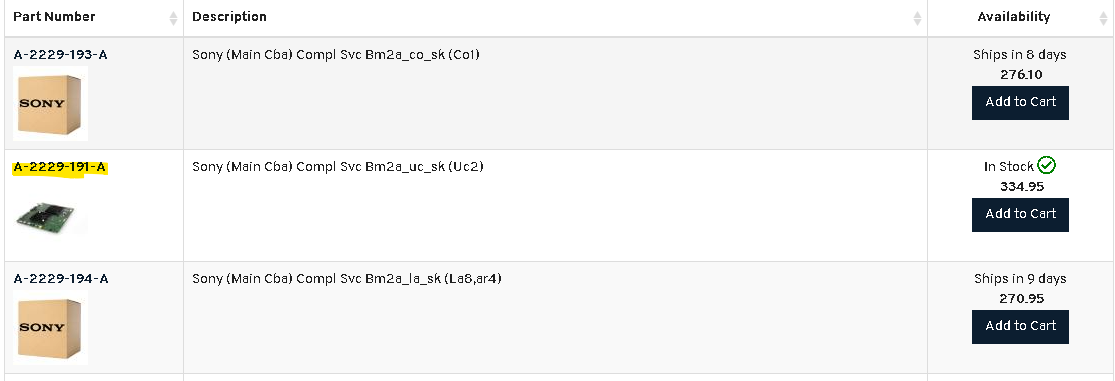

                                  yours replacment main board which you call it before ( brand new ) is defect or beelong to other serie which it could be the socket on it which connect to PCB had differnet wiring pin asigment rather than the original.
                                  2- yours PCB as i wrote before OK.
                                  3- yours Original main boards ( defect ) no start signal sending to PCB to turn on EVDD & VIN
                                  dont do any things ells just bring working MB.

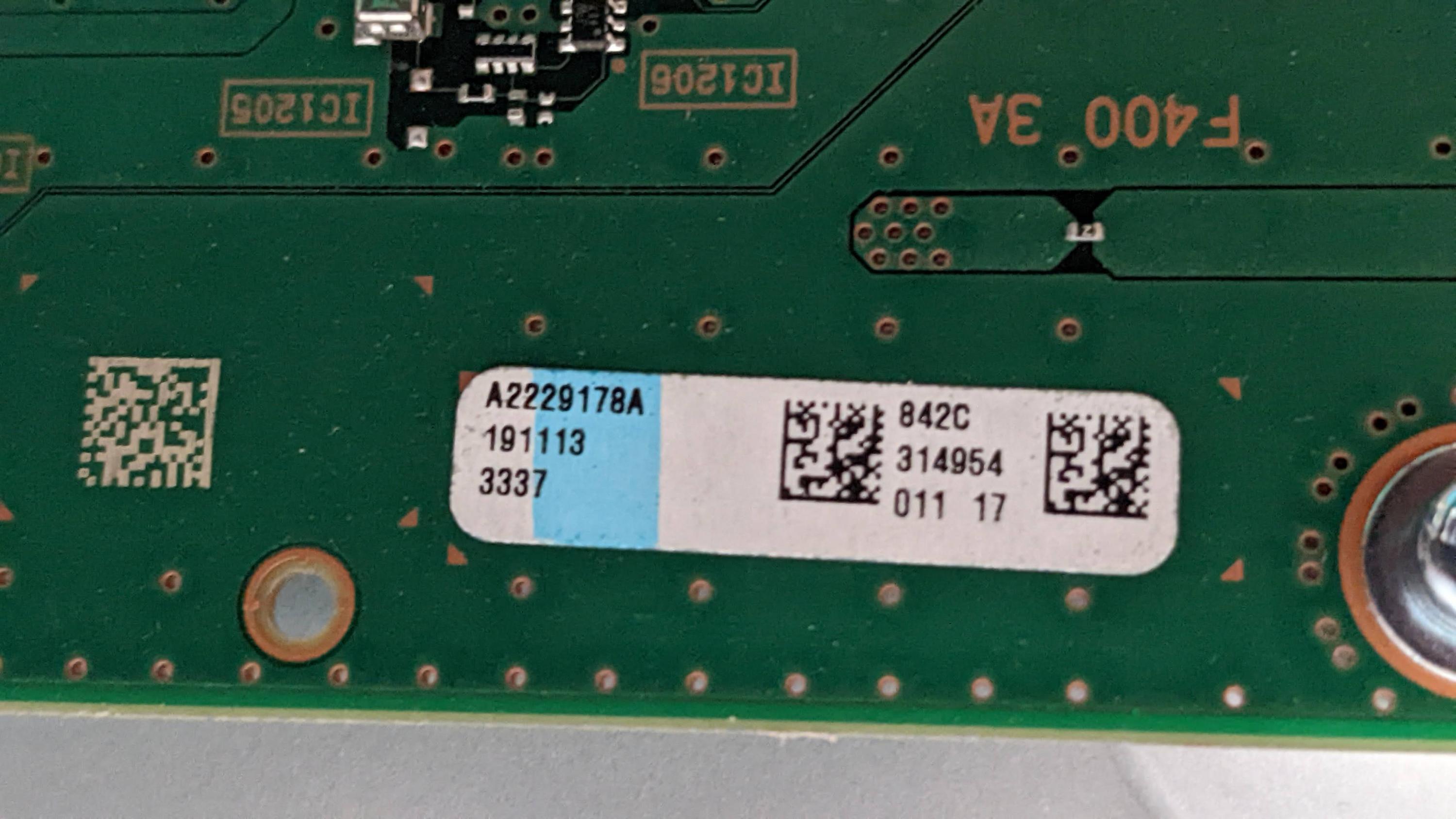

                                      Diah, now that you mention it. There are 3 Main CBAs compatible for this TV. See attachments. Did I order the correct one? Like I said, it looked identical, but now I am second guessing myself.
                                      • Diah
                                        • Feb 2013
                                        • 6357
                                        #39
                                        Re: Sony OLED XBR65A8G no video, PSU problem?
                                        post very clear focused photos of the socket which it goes to PCB and around of the original and replacement Main boards
                                        • mcl360
                                          • Dec 2021
                                          • 13
                                          #40
                                          Diah, I took the TV to a repair shop and they indeed confirmed what you said. The main board was bad and had a short in it.
                                          I have confirm that the replacement board I ordered and installed before I took it to them that wouldn't power on was the correct board.
                                          I am trying to make sure the replacement board I ordered was indeed bad before I take the TV back as I do not want to pay them $650 to do something I can do for $300.
                                          All the part website say that you have to perform a firmware update on the board after installing or the TV will not power on. Is this true?
                                          Secondly, the shop was recommending that I get a new Flexible Flat Cable 41P (LVDS cable) part number 1-912-894-11 (because one of the ears on the ribbon torn upon removal from the board but Sony no longer manufactures. Would the same connector (Part Number 1-007-198-11? ) from the next model A8H be compatible?
                                          Original Part: https://encompass.com/item/12297577/Sony/1-912-894-11/
                                          Possible Substitute: https://encompass.com/item/12556227/Sony/1-007-198-11/
                                          Thank you again for your support. I definitely owe you a beer.
