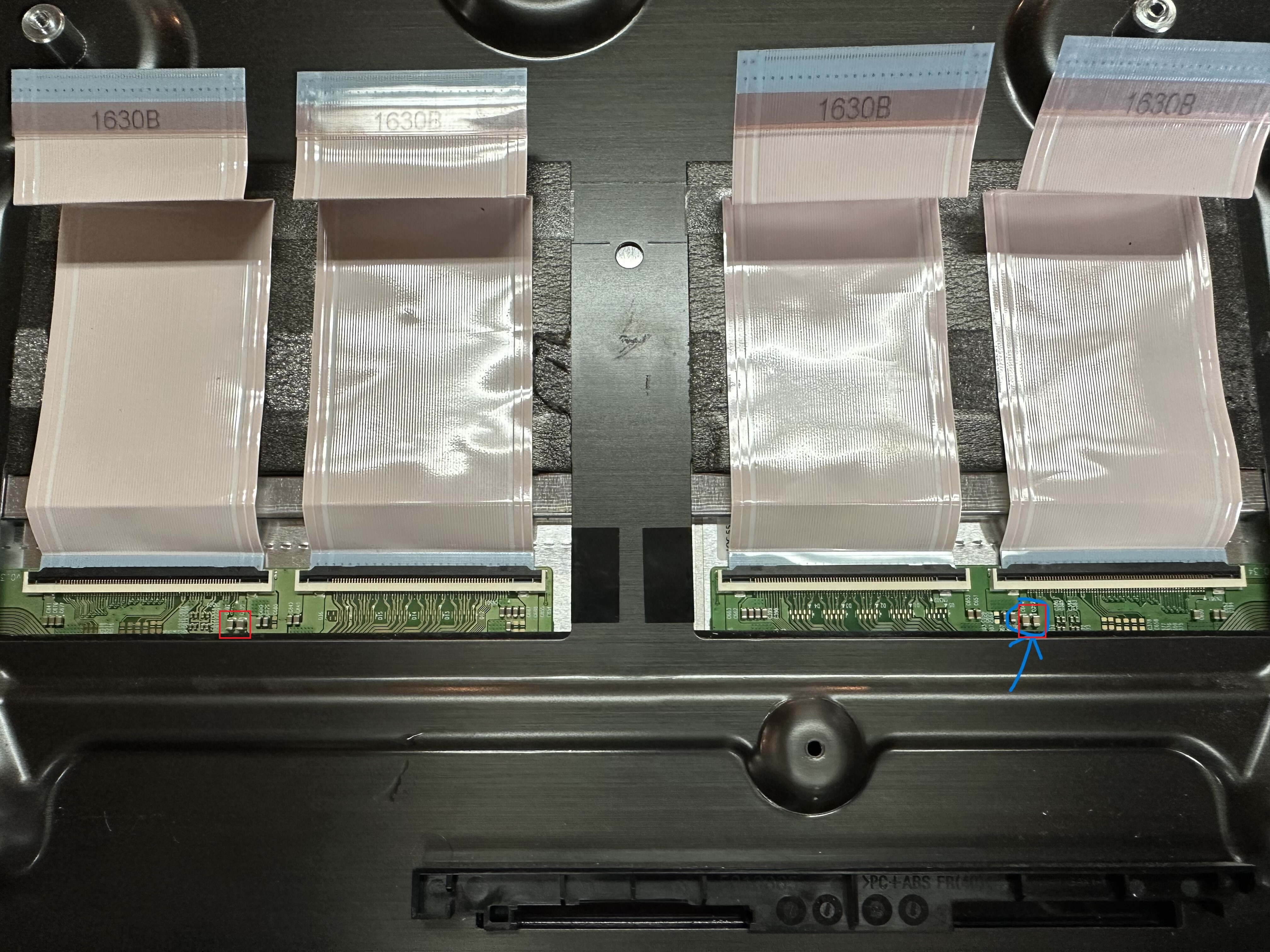

                                  Hello, so doing a bit of poking around on this one i've found 2 shorted caps on the small area of the exposed panel pcb. Here is shown on the pictures the 2 caps corresponding to pins 4-6 of the flex on the tcon side, which goes to Q6 on the T-CON. Dead short on these 2 ! They are the 2 largest caps so i guess they are bigger voltages lines powering the backlight or the cells, seems to be closer to evdd connector. What does that mean ? No clue, short inside of panel itself ? I could inject voltage on the lines after removing caps and see if house catches fire ?
                                  • cheebster
                                    • May 2008
                                    • 373
                                    #97
                                    Here is a better closeup picture of where these lines goes, to SVDD side of the Q6. What is SVDD ?
                                    • Diah
                                      • Feb 2013
                                      • 6357
                                      #98
ID:	3480153 they are related to EVDD
                                      on the panel buffer boards 4 ribbon disconnected compare with ribbon 1. if they are different behavior lift one side of the cup carefully and check one by one.... if the short remain mean inside the panel,
