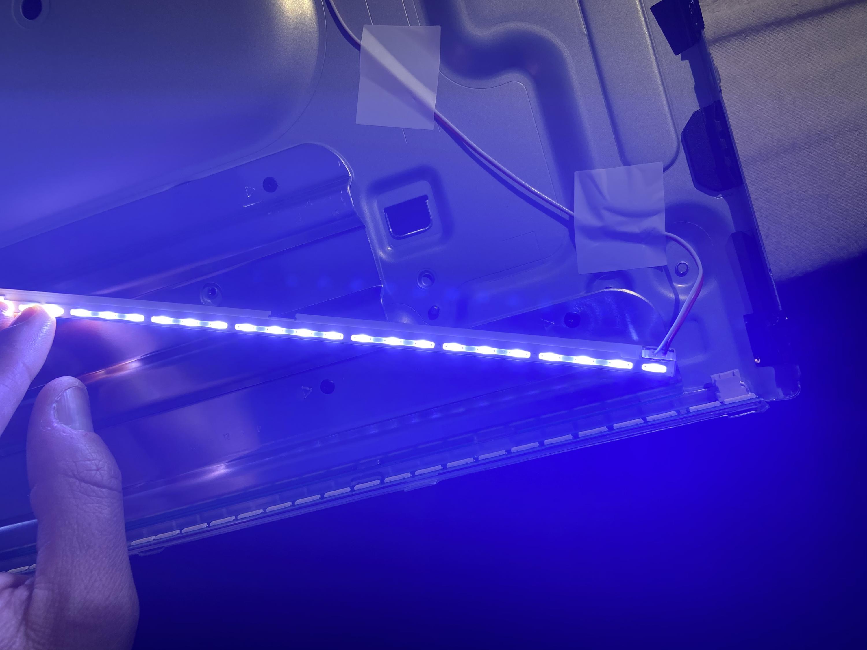

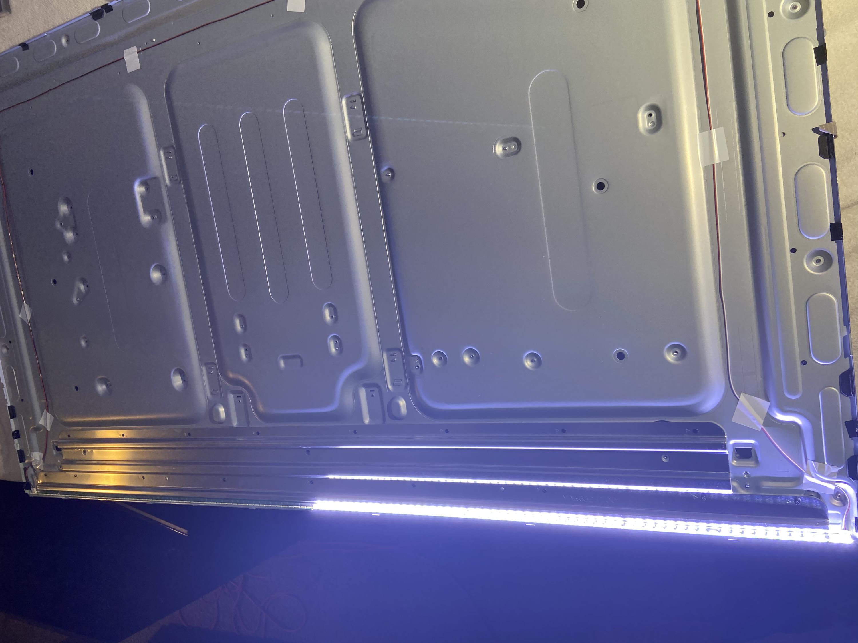

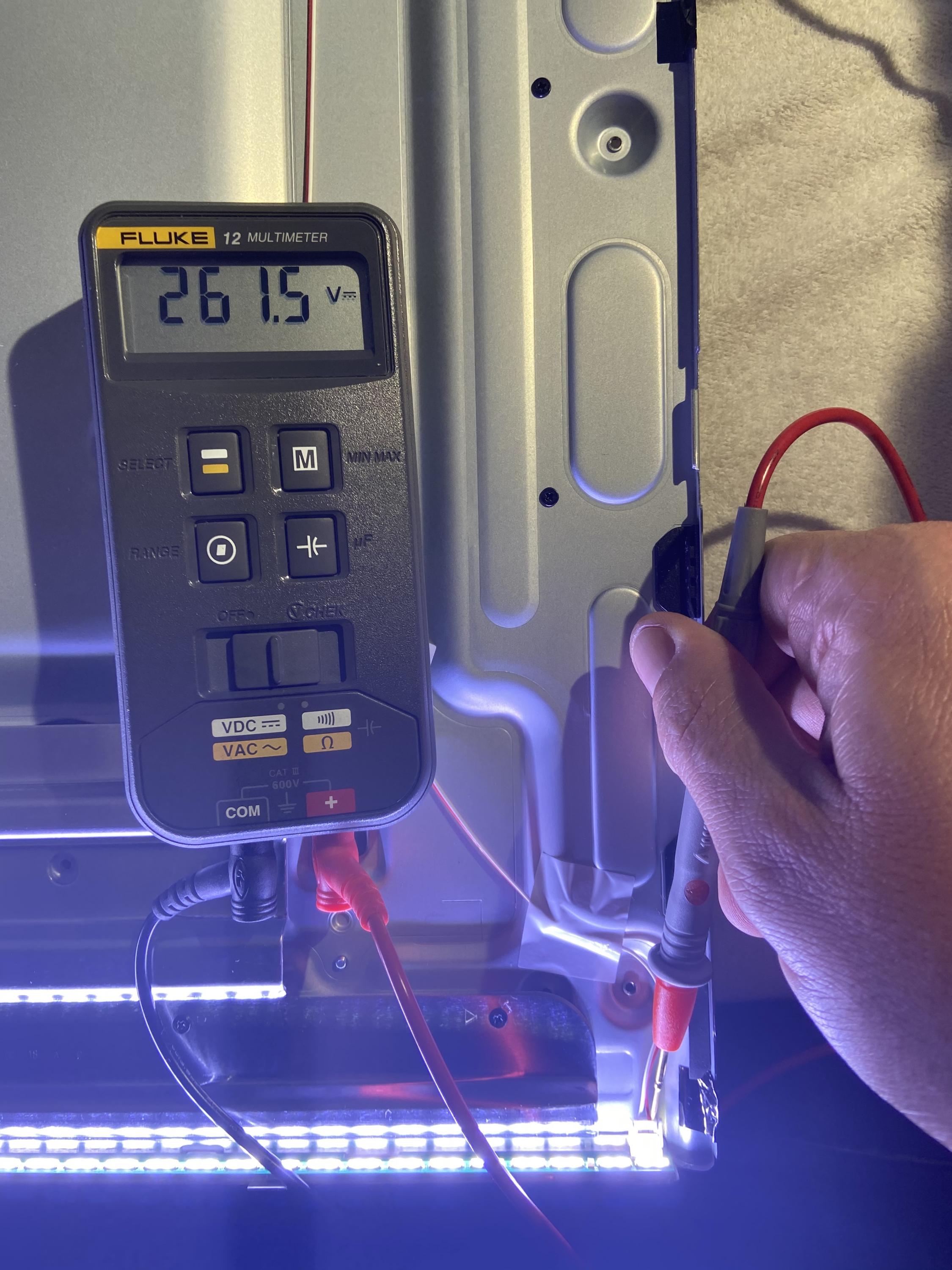

    I have this LG 55UH615A with half screen is Dark. This is an edge lit TV with 2 small LED strips that run along the bottom of the TV. When I got it, only one half of it was lit. Also, there was a buzzing noise coming from the power board. I ordered new LED strips and also a replacement power board. Installed both and I'm still getting the same problem. When I test the wires going to both LED strips, Im getting solid, non fluctuating voltages from the power board and also at the connectors plugged into the LED strips. I tried to rule out if possibly the new LED strip on the dark side was bad. I took the old strip that was still good and plugged it into the side that lights up, and it lit up the strip, but when I plugged it into the other side... nothing.
    Any one with suggestions or ideas of what else I can try, I would really appreciate the help. I'm completely stumped on this.

      Re: LG 55UH615A Half Screen Dark, Replaced LED's & Power Board, Completely Stumped
      The power board was buzzing before I replace it, so I thought the old LED's were causing the buzzing on the board. So I replace the LED's first, but board was still buzzing after and the LED's were dimly lit. Still only on 1 side though. So then I thought to replace the power board. Once the new board arrived, there was no more buzzing and the LED strip was at full brightness, but still only just one side. When I test the side that doesn't light up, I get steady 261.6v out of the red wire and a steady 201.1v from the black wire, but the LED strip still doesn't turn on.

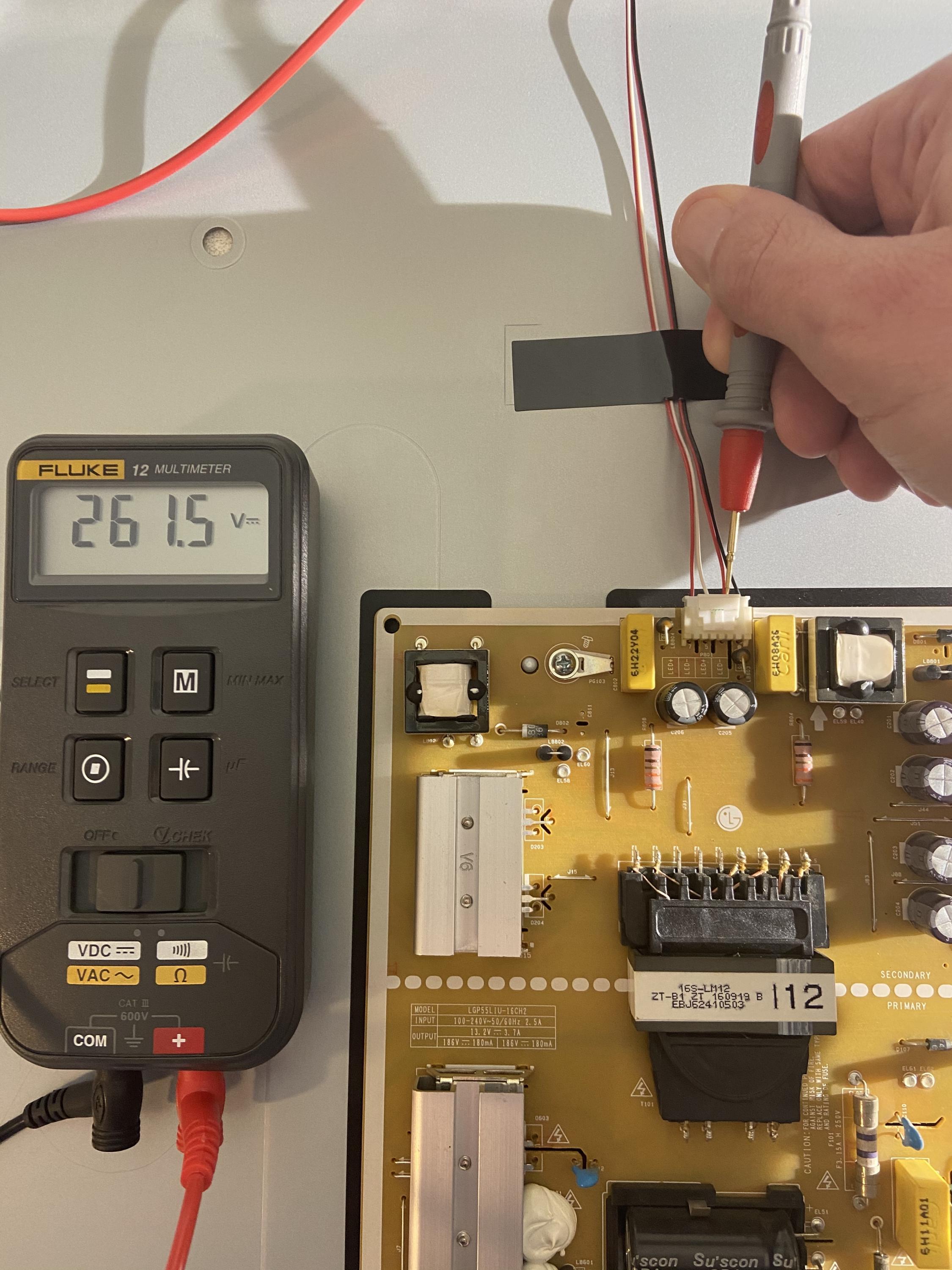

          i don't understand, you have only two cables output but referring to the ground you have 260v on red and 200v on black? i think between red black must be higher until 260 when full brightness.. anyway check those cabling..

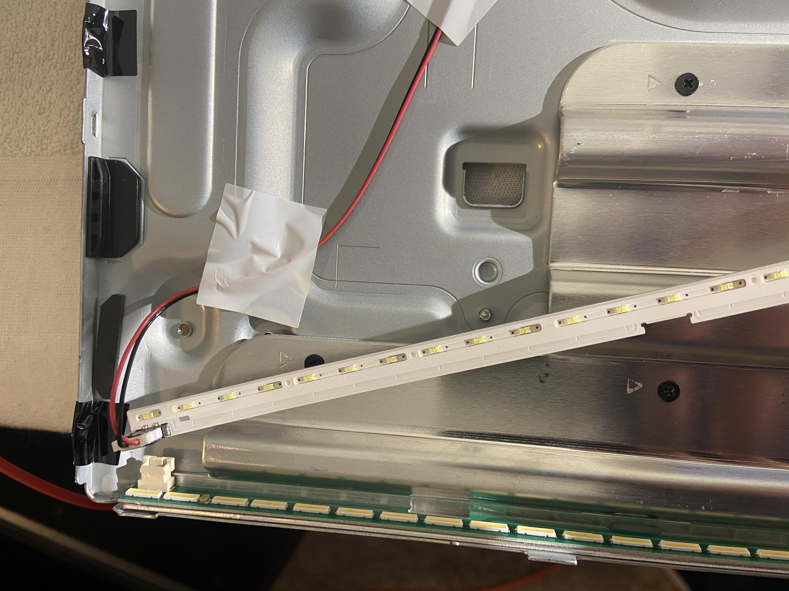

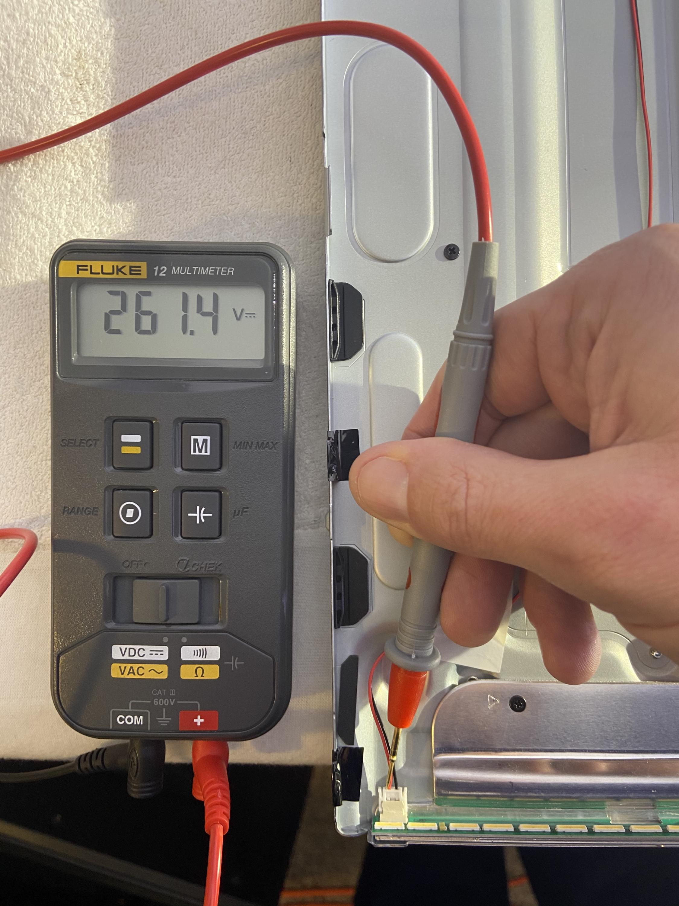

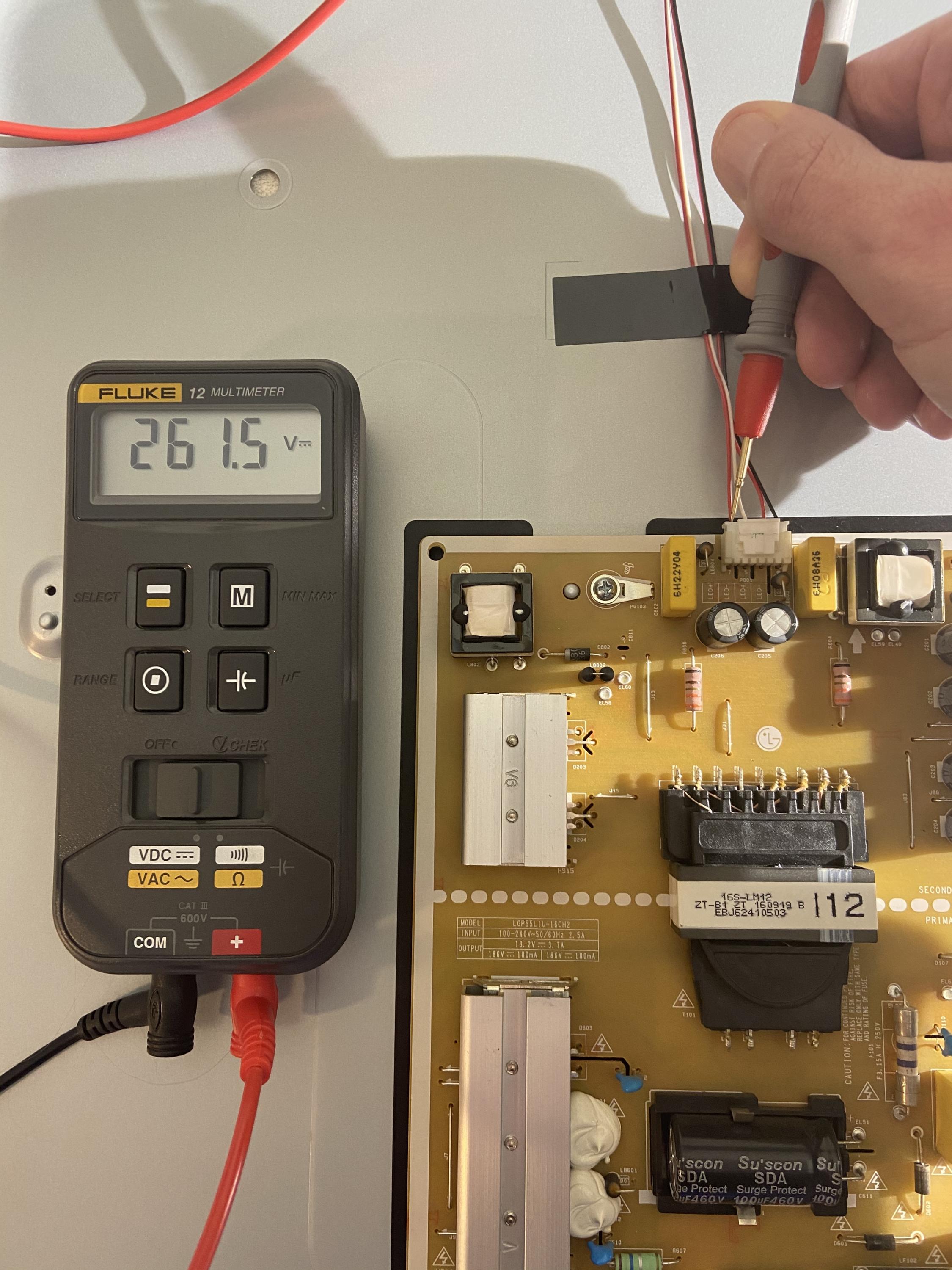

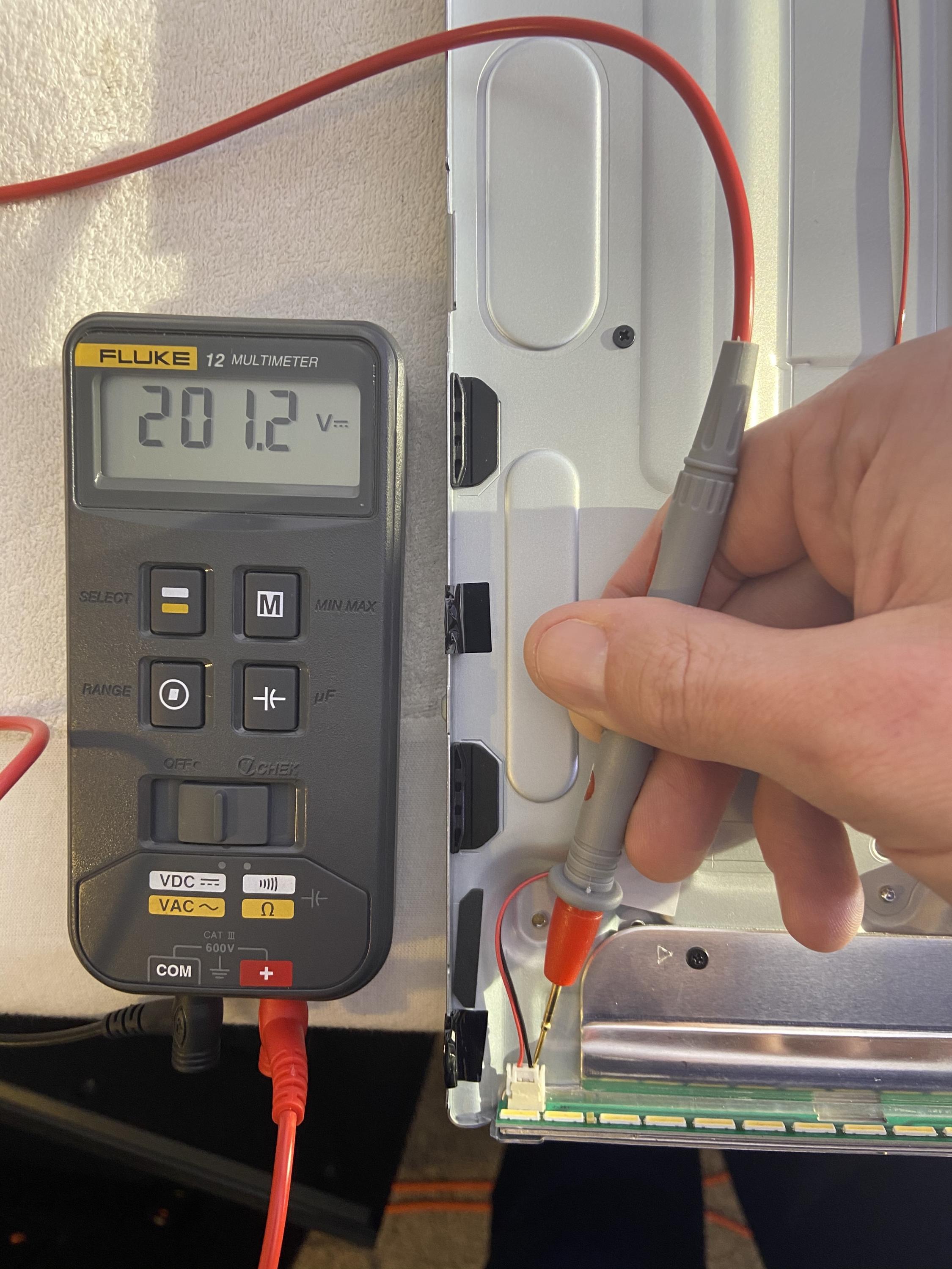

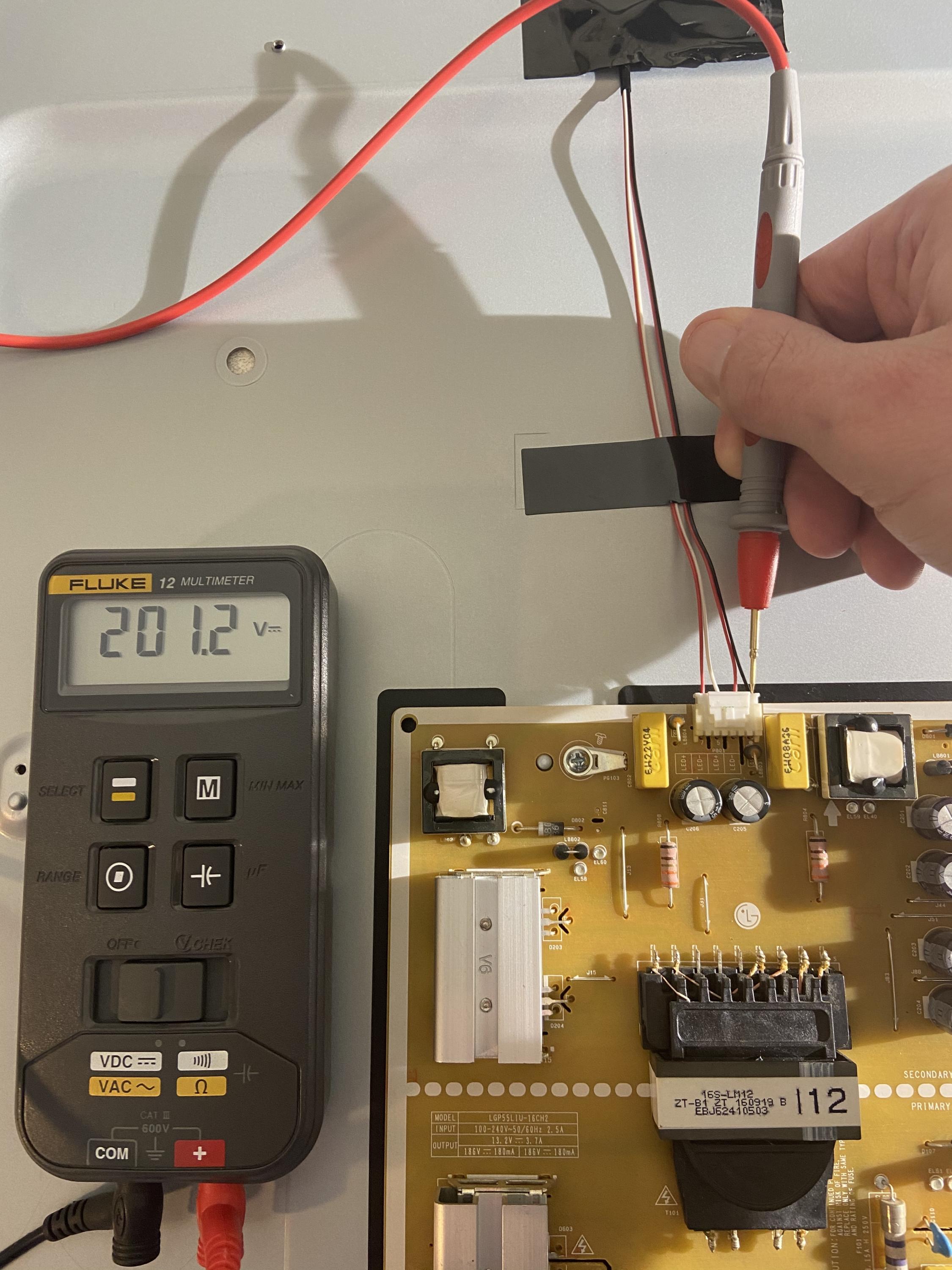

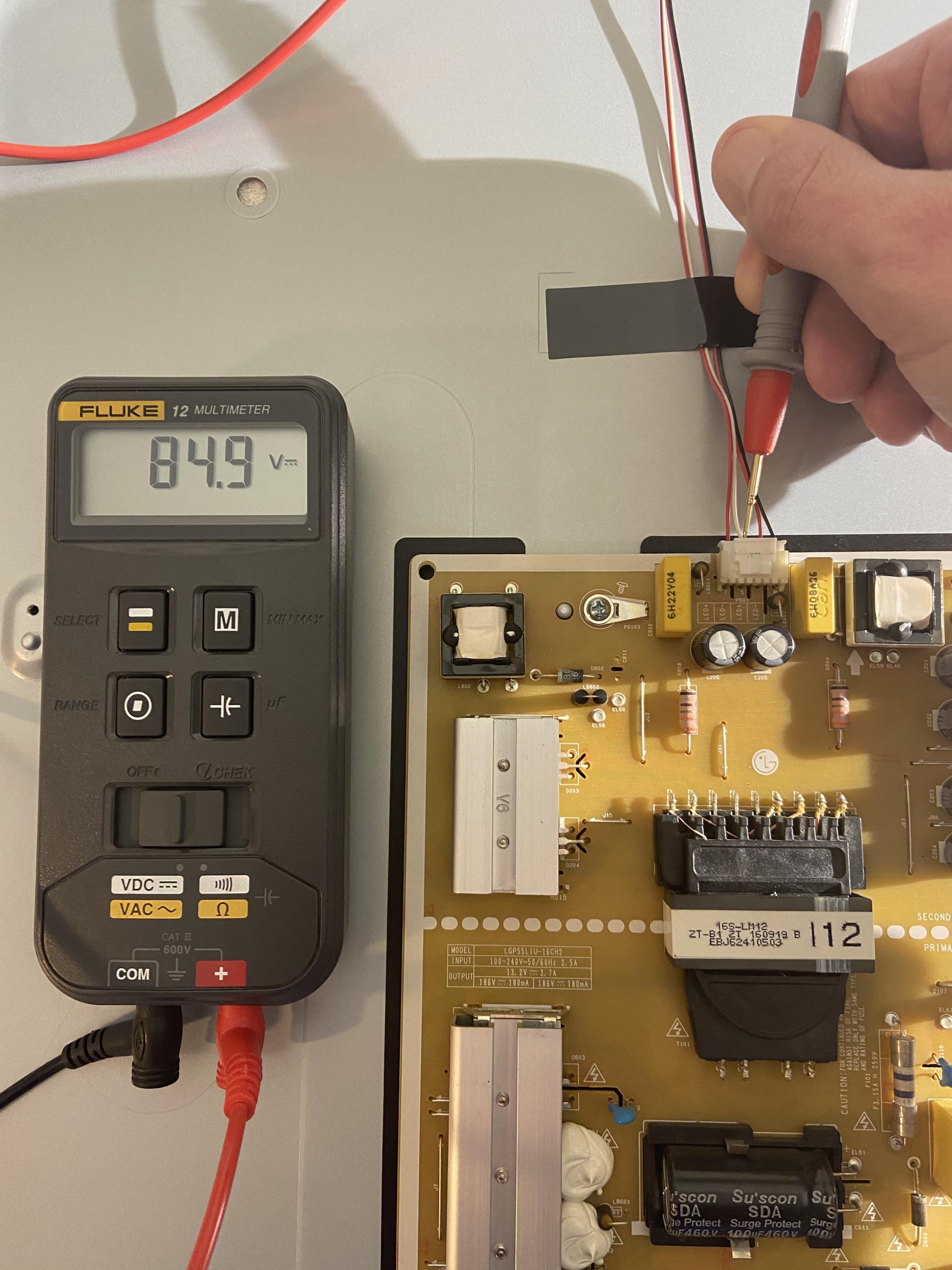

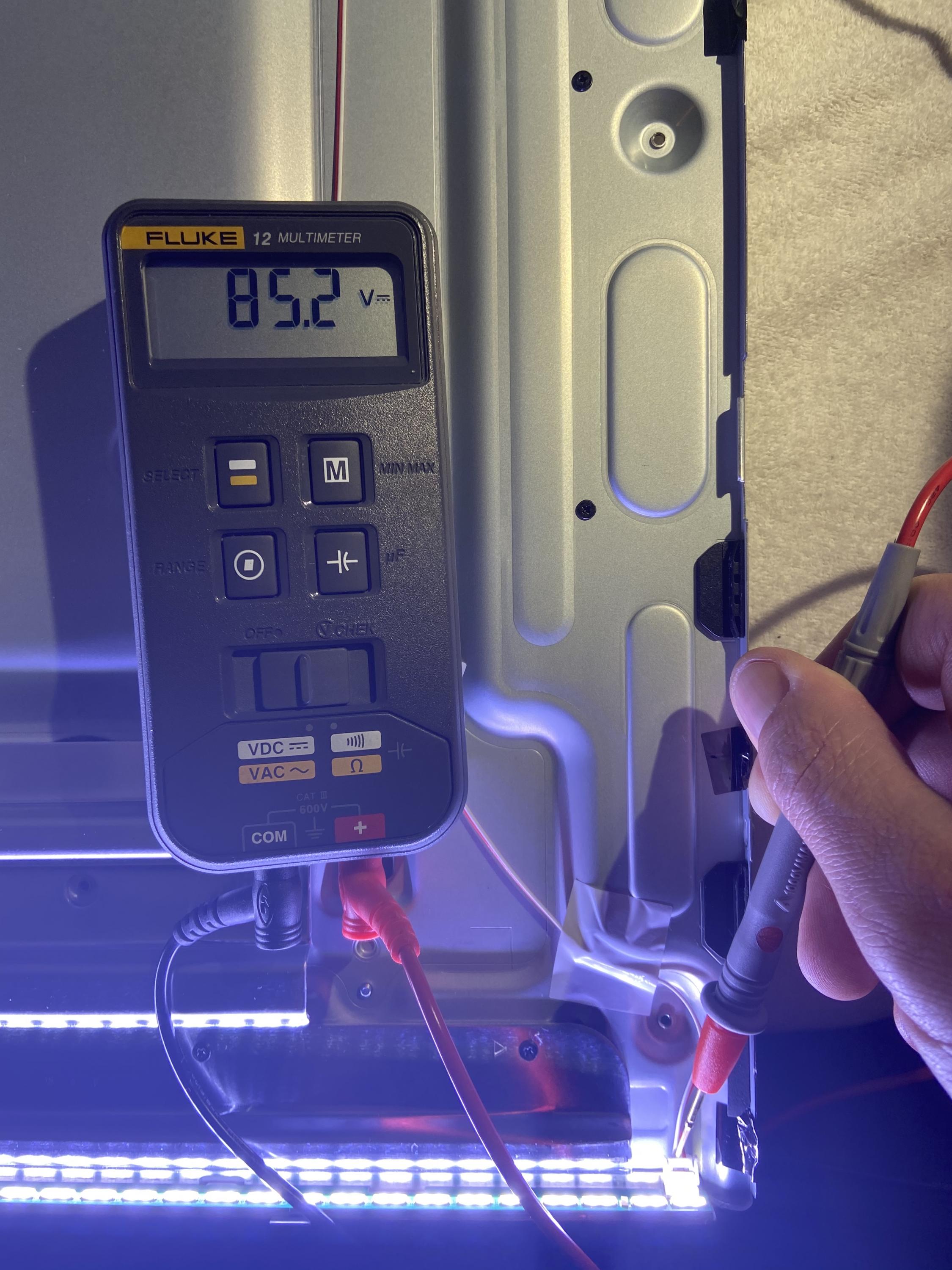

            I have attached photos of my multimeter readings of all the wires coming out from the power board and also going into the LED Strips. I also have a photo where I plugged in the old strip on the side that works showing that it lights up, but when I plug the same strip into the bad side, it doesn't light up. I just don't know what else could be the fault causing this problem. If anyone knows, please advise.
              from the photo of the strip socket i can tell yours replacement strips are for right side not the left... you need to flip wires of - + to let it work... but then how you will fit it ?
                Hi! Ok now is very clear, forget my diagnisis of cabling, by your photo you have 2 led driver output channels, one working at 75v , and one not working at 60v. Time to search for a schematic of power board. If you can't find it at least post two extraclear pictures of top and bottom.

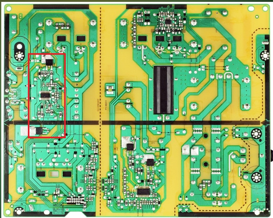

                    Have you checked Q801, Q802 and what is the part number of IC801

                                • yoxardas
                                  YoXarDaS
                                  • Jul 2015
                                  • 4
                                  thank you all, I figured it out finally, the IC801 aka MAP3516 was the bad guy, I checked all components near it and everything was fine, the fact that the dimmer side responded laggy when adjusting the brightness from settings made me suspicious about this ic so I have changed it and now it works flawless.
