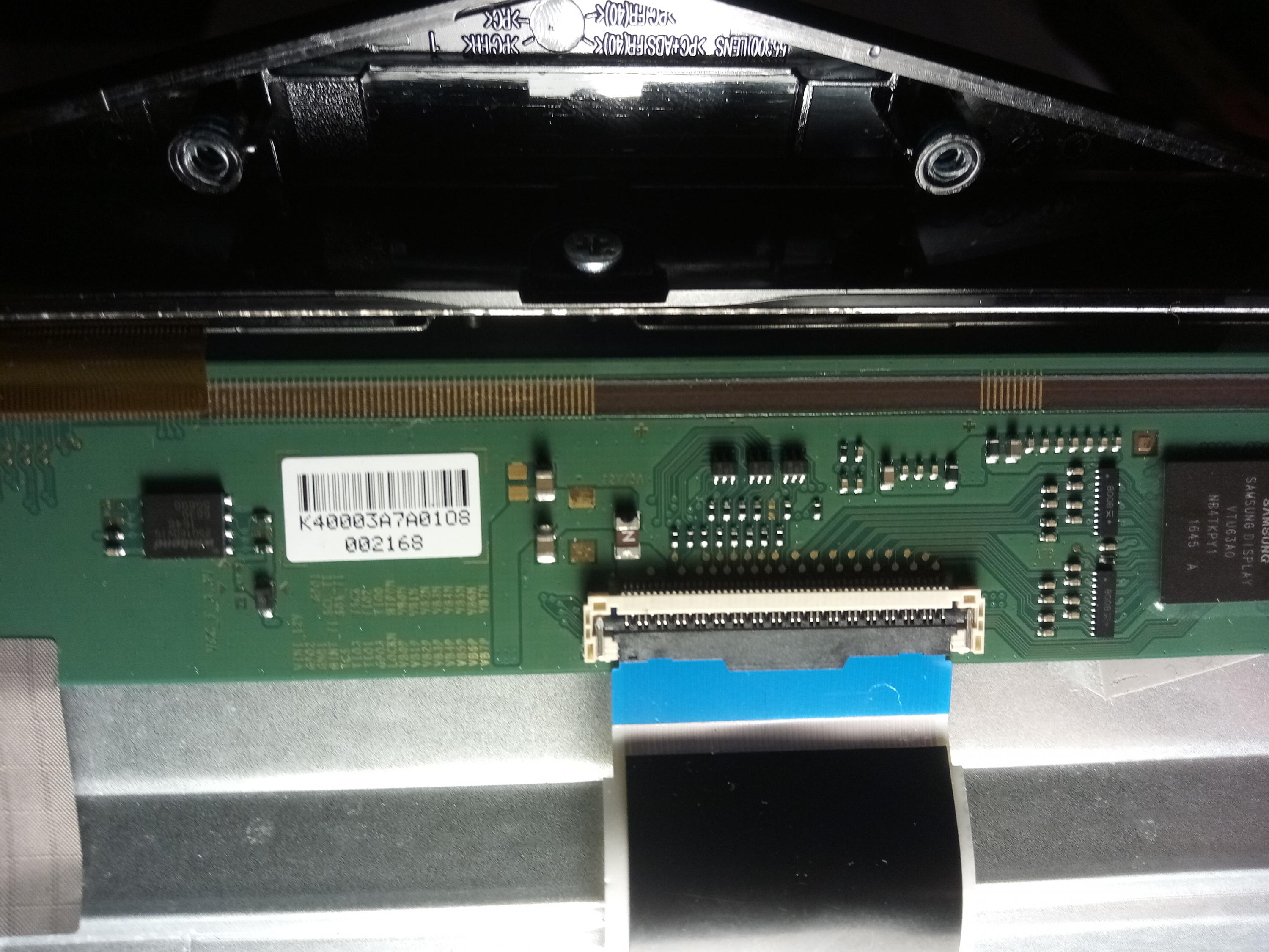

      If you can post some photos of your boards and also one showing the interconnection may catch peoples attention.

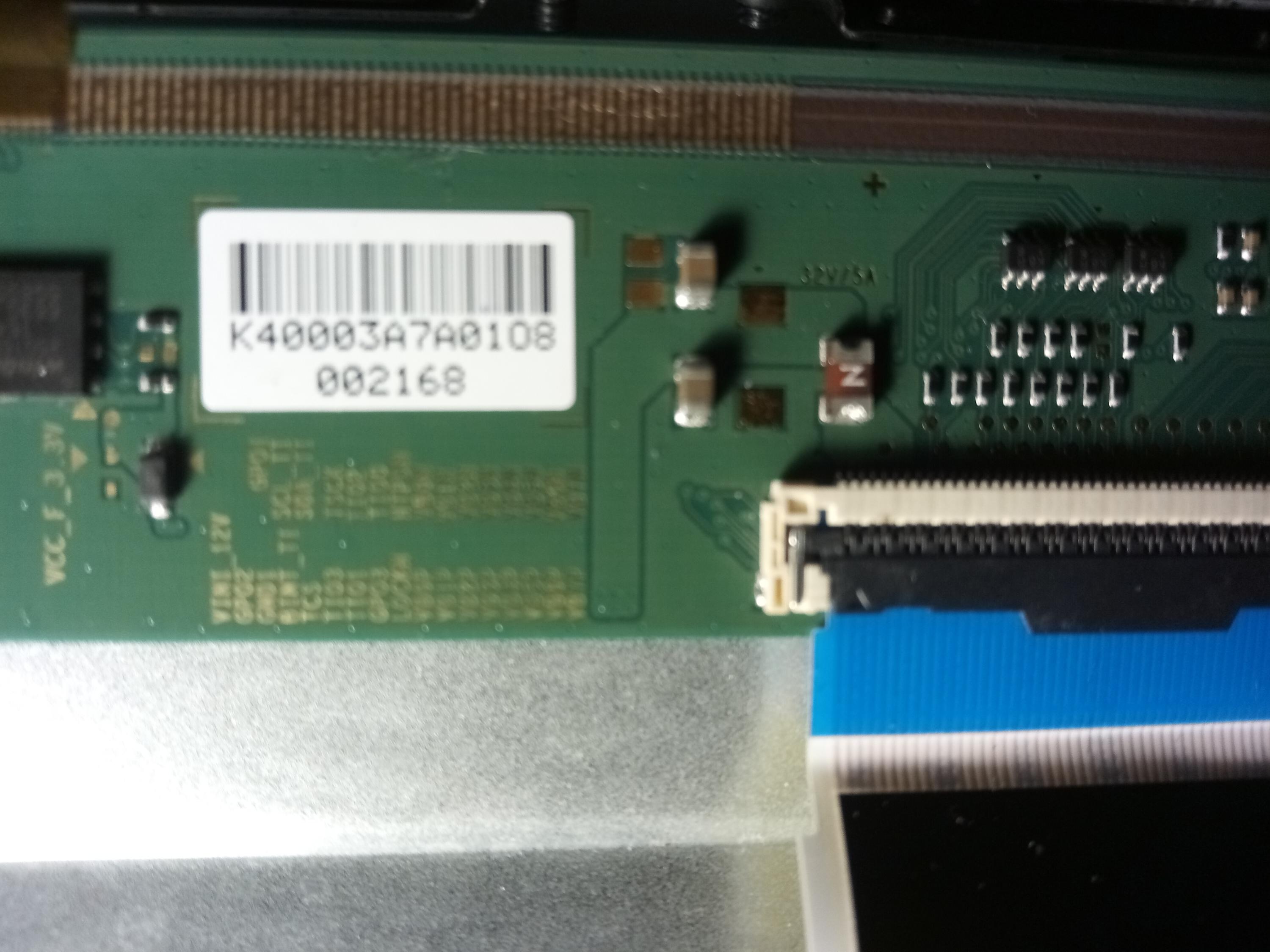

        here are some pictures pic 6 shows clearest image of the chips i need info on thanks

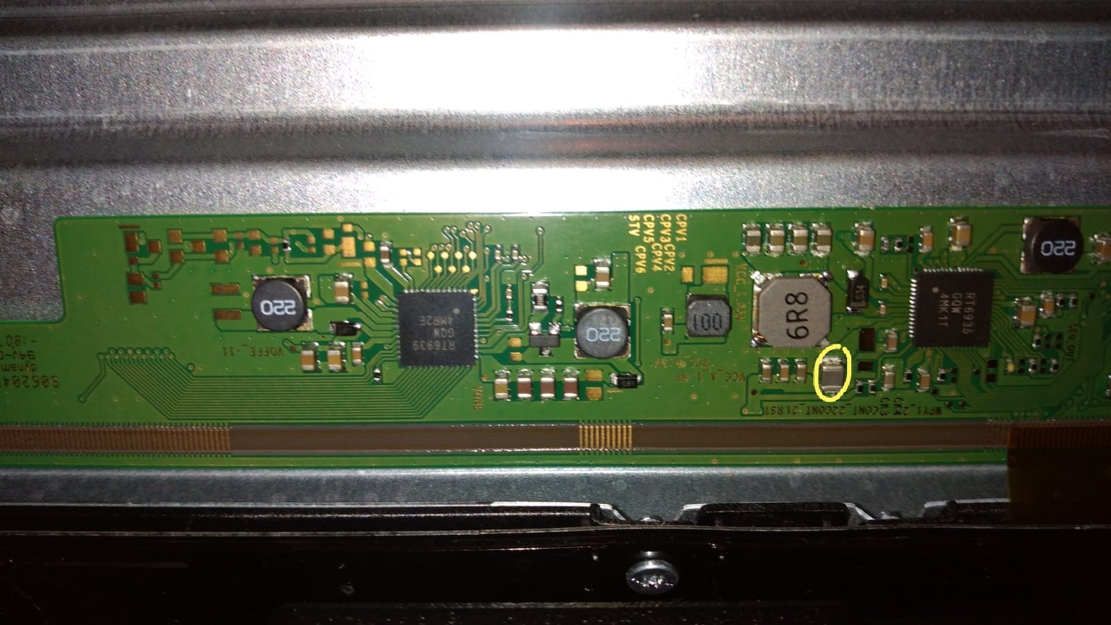

          @jimbofz I've got same problem on a different TV set, Toshiba, same Vestel integrated tcon sh@t. I found one cap straight connected to 6935 which was shorted, replacing it didn't made any difference. problem is, there is no way to find values for them as there is no markings on. Actually somebody suggested the problem might be on the actual logic board as, at least in my case, the interaction with the remote is limited. basically I can get only power on/power off response. I've started a thread couple of days ago here, so keep in touch if we have any updates.

            1 can you check the tensions on the points indicated?
            2 Can you check if you have short circuits on the points indicated?
            3 can you please insert a picture of the panel tag?
            4 you can put a retro tv label photo please

                thanks for trying to help
                all the following are zero volts,
                vcc 3.3v, vone, voffe, 1,8v, hvydd,
                hvin is ok at 12v
                ive removed the 4 caps in parallel as there was a resistance of 250ohm to deck
                the caps are fine they measure 22uf each ,
                i then removed the coil marked 6r8
                as i thaught there may be a short underneath it,but the coil is fine also .
                all the other missing voltage test points are not s/c and threre is no short between them
                if you look to the right of the 4 caps in parallel the next cap (same size)has 12 volts then theres two tiny components (one a cap the other black is a resistor) then theres another cap and across it i have 5volts .i think theres something o/c feeding one of the chips or possibly a enable start up volts missing

                  hi mate, the cap is the one marked in the picture attached. If I hook mine to an input source it will scan and autocomute on that particular input and sound will come through, however limited interaction with the remote is observed. I cannot do anything else than power on/power off. As soon as I finish setting a more suitable workshop than the floor of my living room I'll continue investigation. If you can tell me the value of the capacitor it will be great, very much appreciated.
                  as well I'm considering buying a logic board as it is a good candidate for failed items category

                    the component circled in yellow is not a cap its a fuse ,its confusing as it looks like a cap bur slightly bigger and grey in colour whereas the caps are usually beige ,with regards to your fault are you using the original remote control as some will opperate in/out sby ,but may not have correct codes for as example volume ,just a thaught.
                            thank you for your reply, very much appreciated. So my "capacitor" is actually a fuse so it should have 0 resistance

                                  after replacing removed components and checking all cap values ,i now have the following voltages on the red arrows you put on the pic ,starting from left to right 1.07v then 12v and earth across cap
                                  next the cap below the 220 coil12v
                                  the cap on left of 4 caps in parallel vone .25v
                                  the cap to right of chip rt6939 12v
                                  and finally the cap above the220 coil voffe .24v
                                  so on the marked test points i now have:voffe .14v bad
                                  vone .25v bad
                                  1.8v good
                                  3.3v good
                                  vcc1.05v good
                                  hvadd ov bad
                                  hvdd 12v good .
                                  do you have any idea how to find the enable pin for the ic ,
                                  i assume it must go high to turn on the ic and start the vone and voffe voltages?
