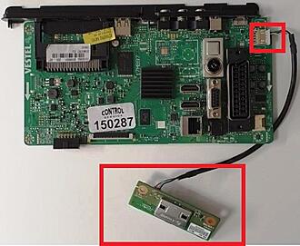

                show me please the module

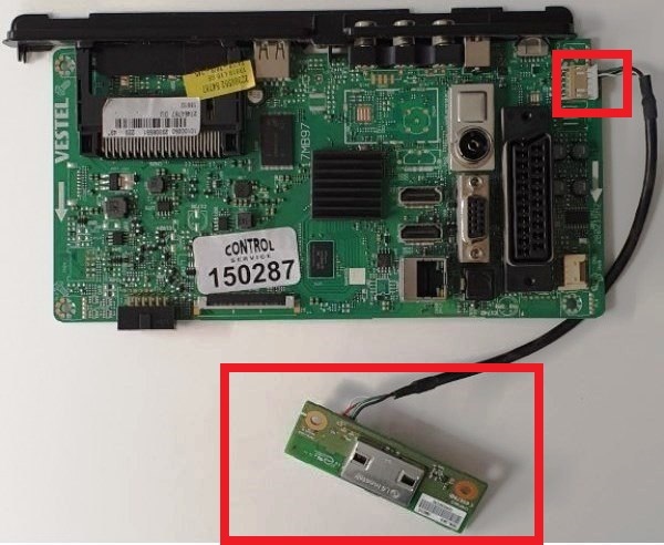

                      this is his boards and the wifi module.... its wifi direct ( Direct / view / Link and normal 2.4 WLAN function ) had nothings to do with BT. but if he like to add he can add USB BT the linux will install it driver if its kind of plug in driver.

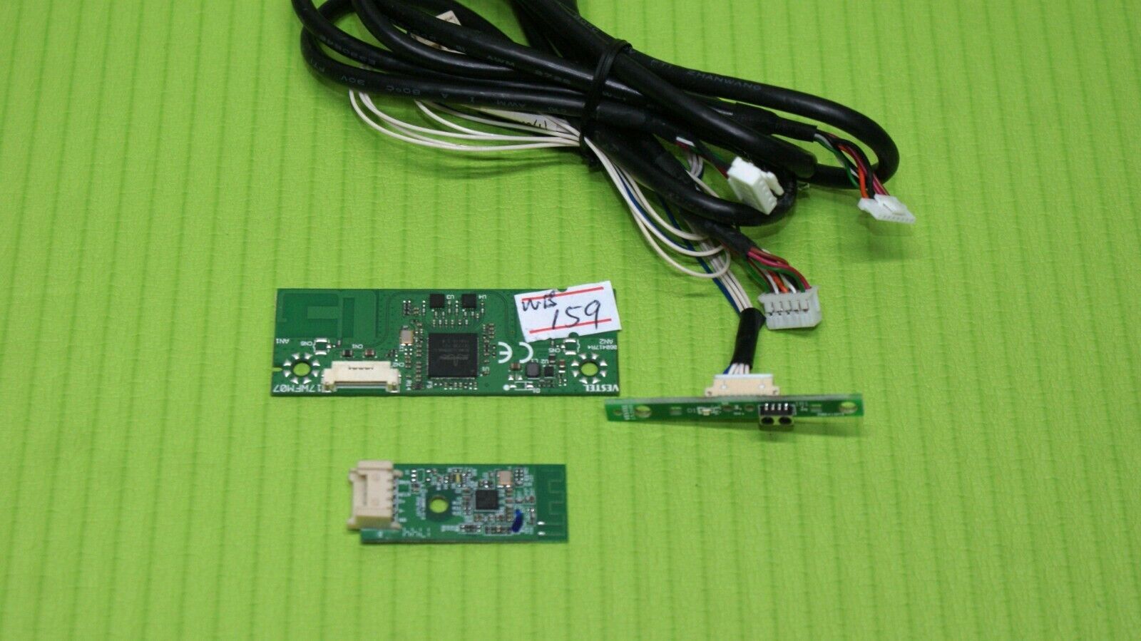

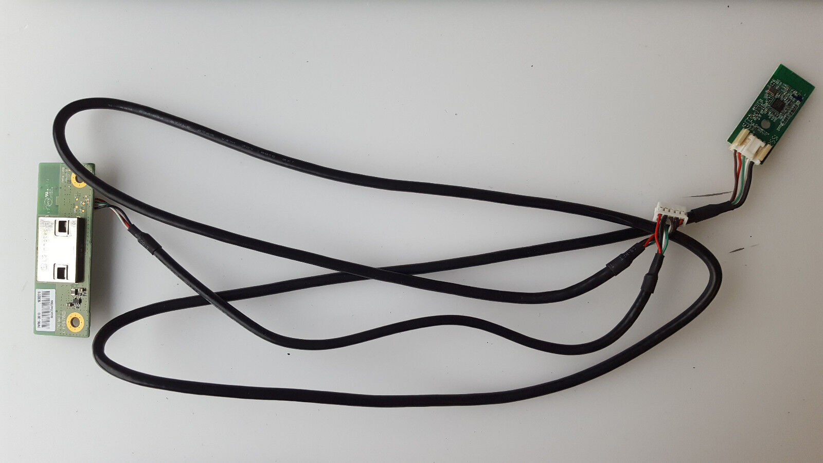

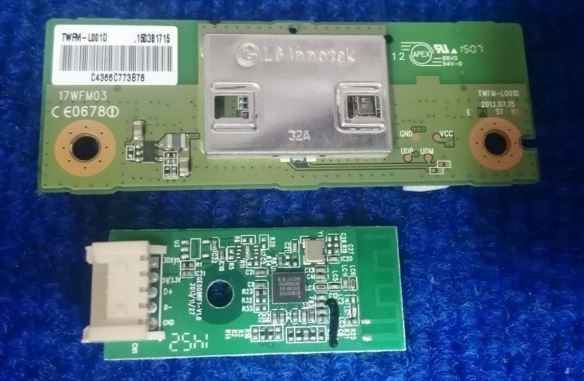

                              It can also be equipped with WI-FI + BT.
                              • vinceroger69
                                • Mar 2012
                                • 6714
                                • uk
                                yes there are a few wifi + bt boards available for this tv model number on uk ebay
