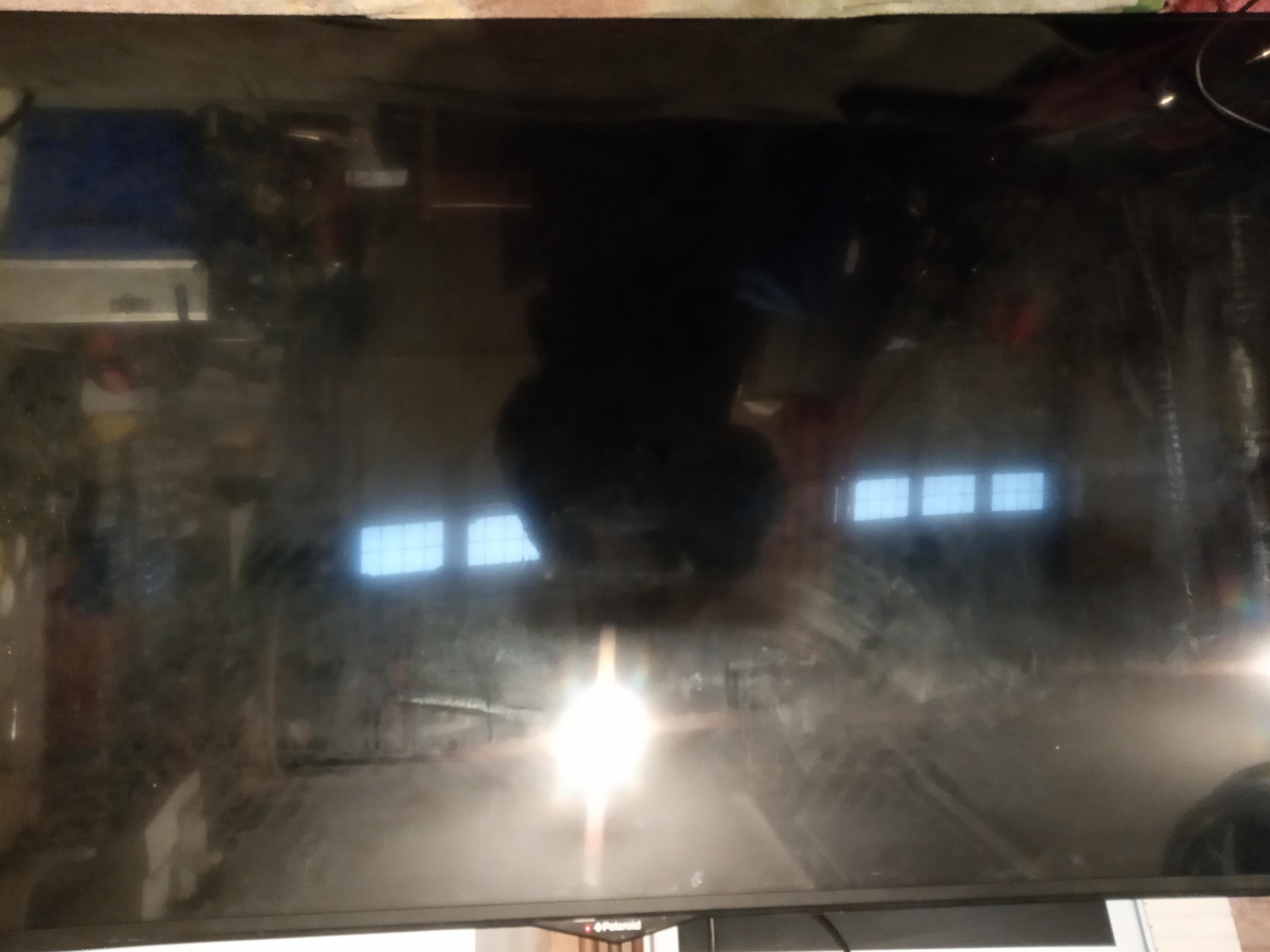

      here is pic of screen the only thing you can see is my reflection in my workshop the light from window reflected
      the tv is upside down on workbench
      screen has very dark blue with no picture image

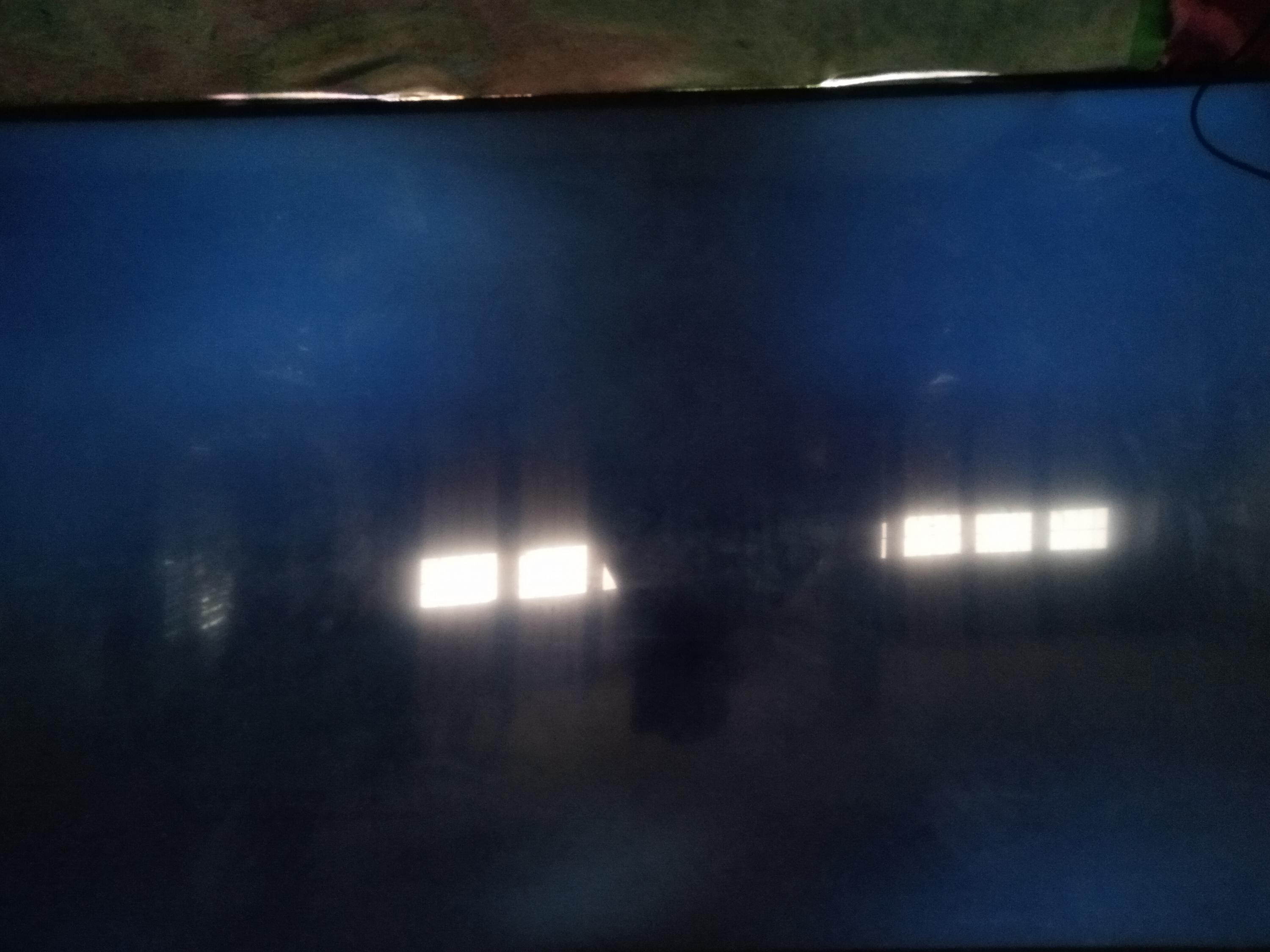

        #63
        Re: intergrated tcon board ic rt6939 vestel polaroid p55up0277a
        unplug lvds socket and take a picture please.

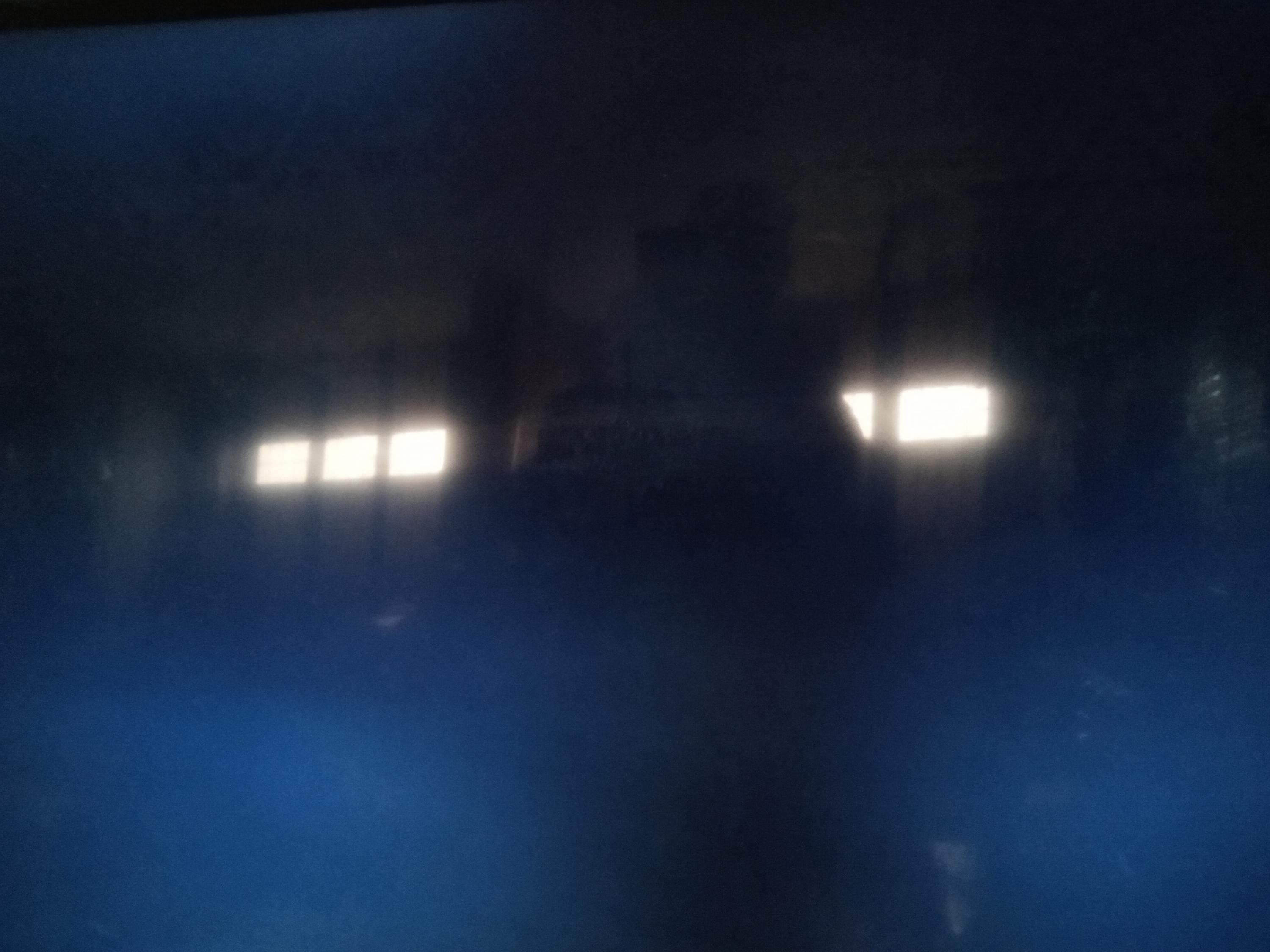

          #64
          heres pic with lvds unplugged ,it looks just the same

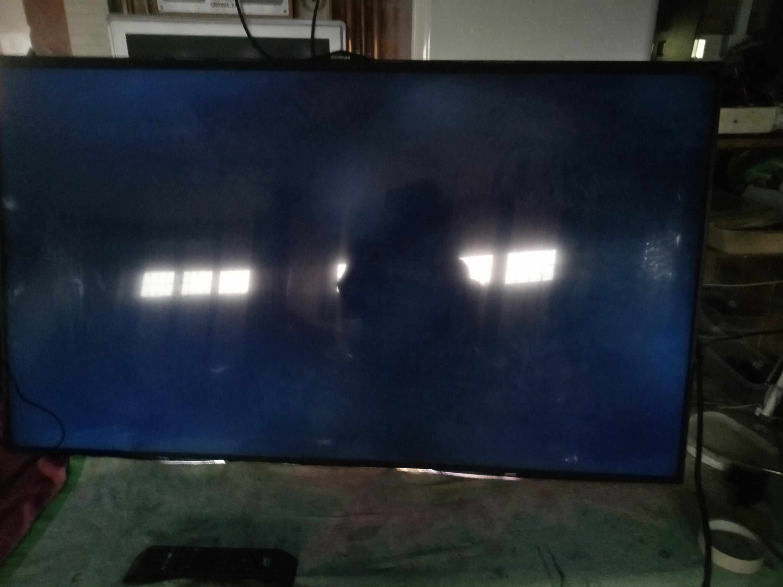

            #65
            Why leds shining blue?
            unplug lvds socket. Turn on tv and plug a dvd or receiver via scart. if you hearing sound panel is faulty. if still same...good luck.

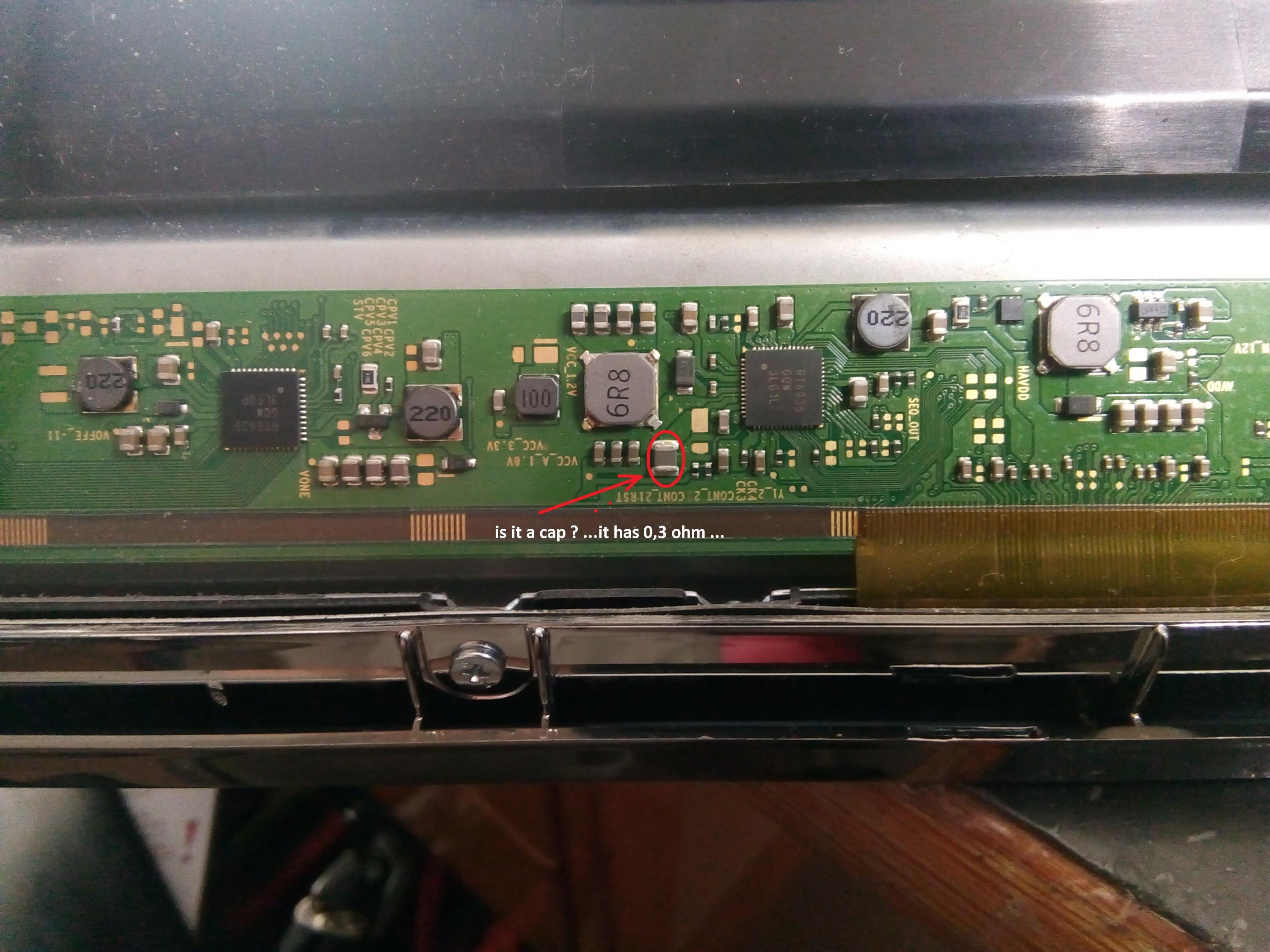

                    #69
                    Does anyone have some information about this capacitor, on the same t-con board from the discussion above ? Thanks !

                      #70
                      sorry to waking this post again... I have the exact same issue and my tcon has the same components -RT6939 GQW. Its an MI tv and even I thought it was a cap that was shorted but now after reading this post I learn that its a fuse. Did you find a solution to this? I need help urgently.
