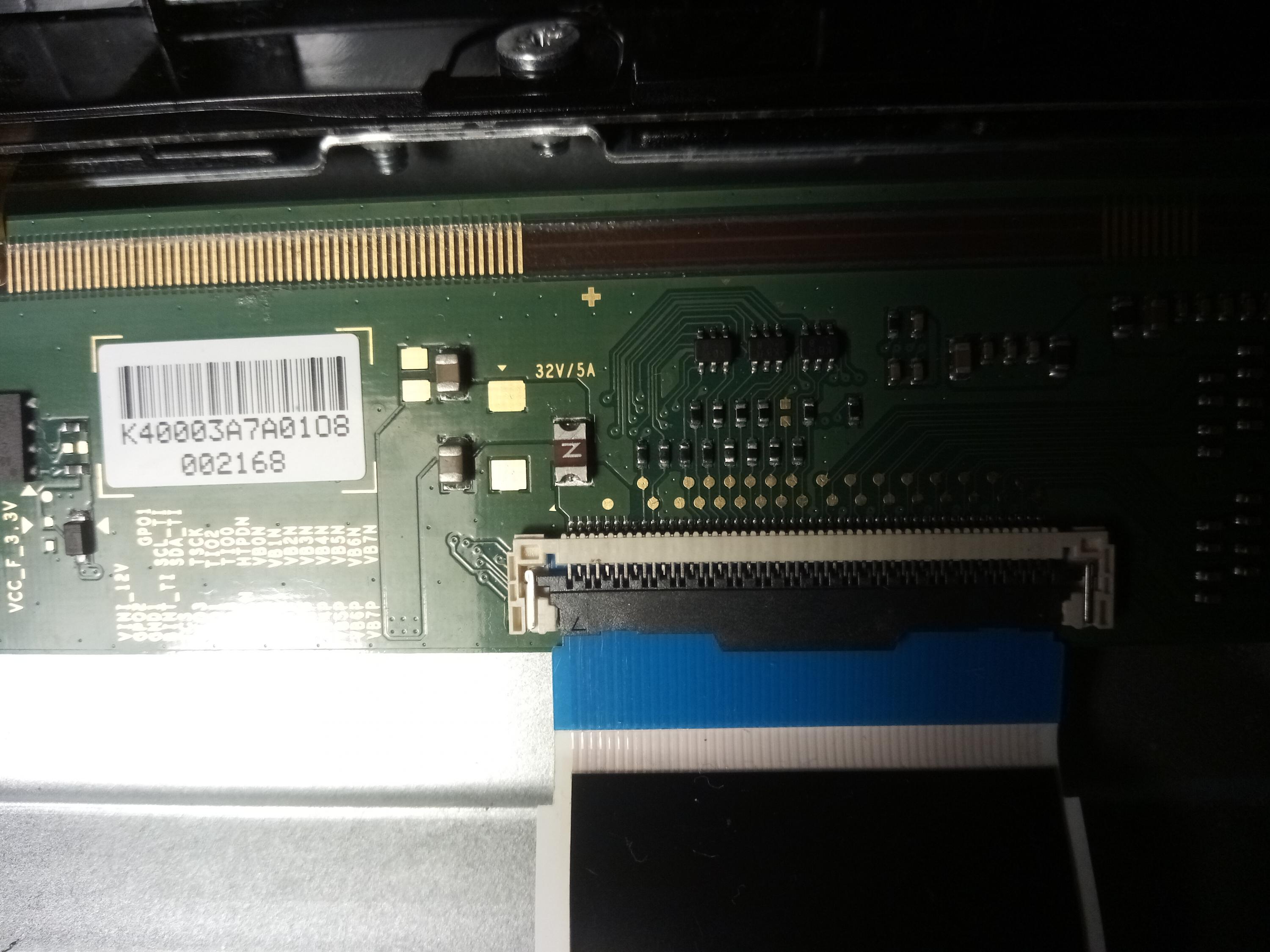

    Re: intergrated tcon board ic rt6939 vestel polaroid p55up0277a
    for this cheap sets / mainboards don't have extra video processing ICs also usually all signal come from Main IC direct via LVDS to the panel.
    if you could upload focused photos on the main boards and the LVDS sockets from up and down side if there any remark on the pins.

      Diah misunderstands me. Your panel is short circuited. I replace this ic but still not working. I send tv to panel repair workplace and they replace cofs.
      https://yadi.sk/i/_6VKMJQ4rQYiAA This is circuit diagram of mb120.

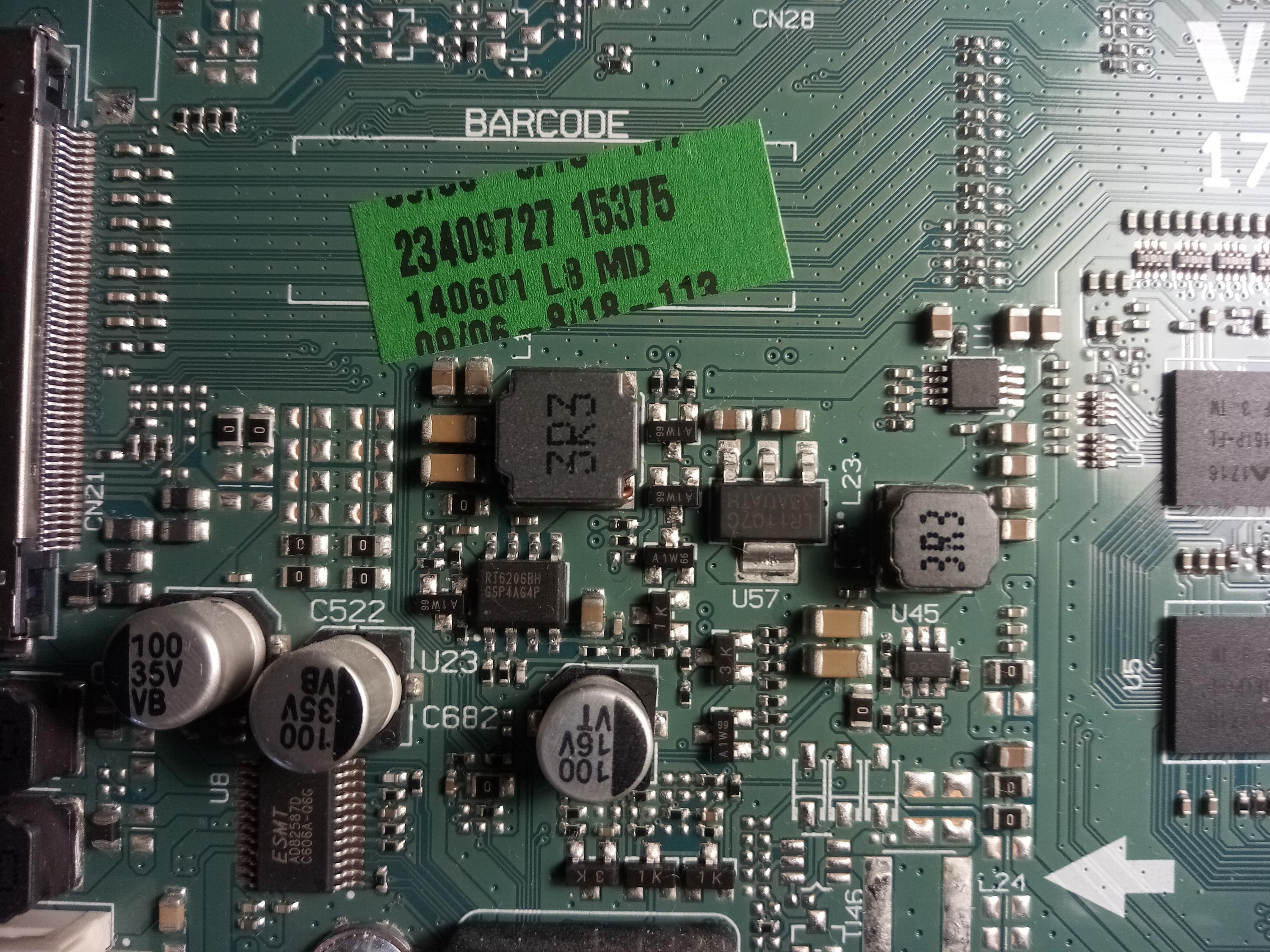

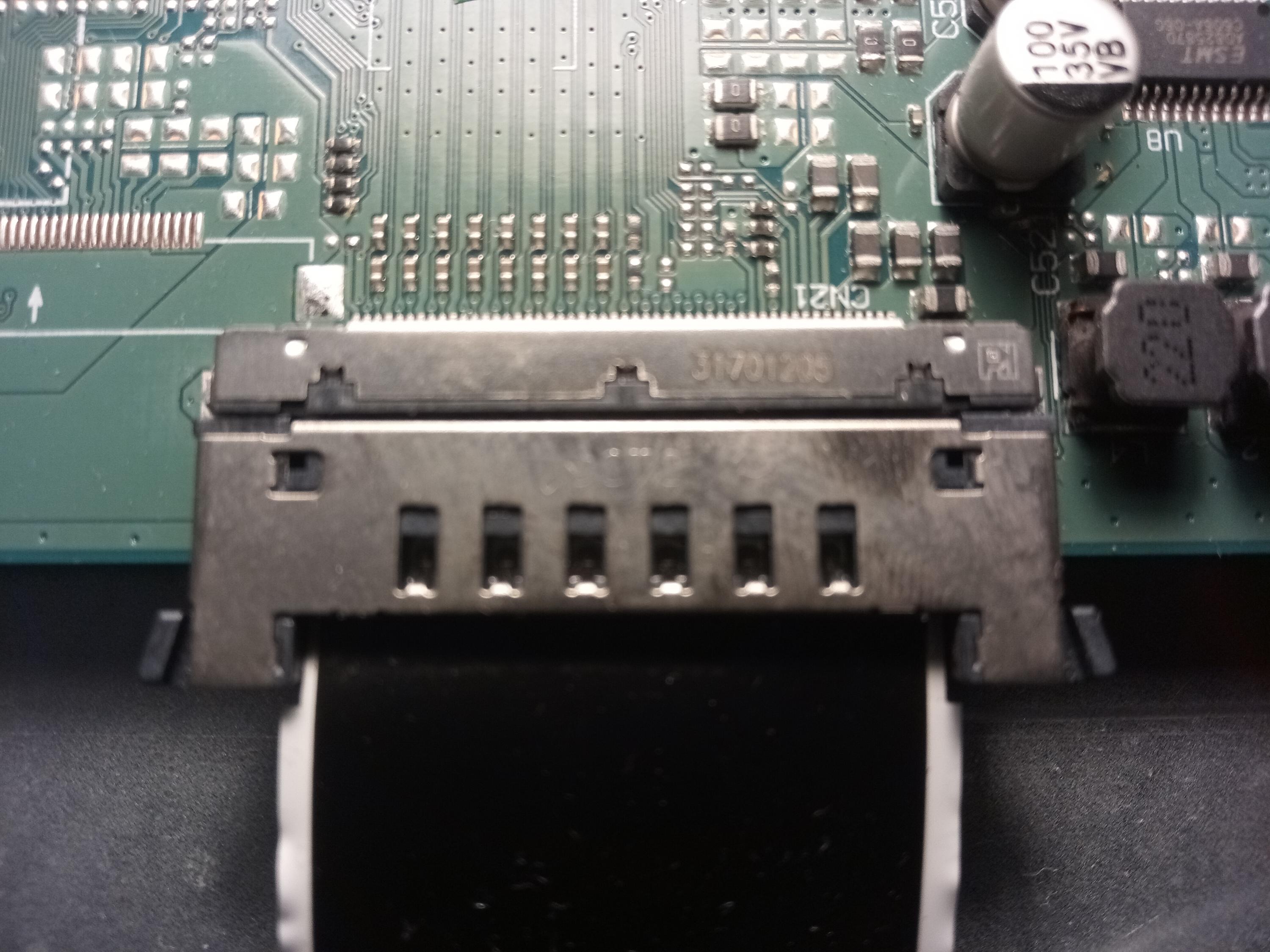

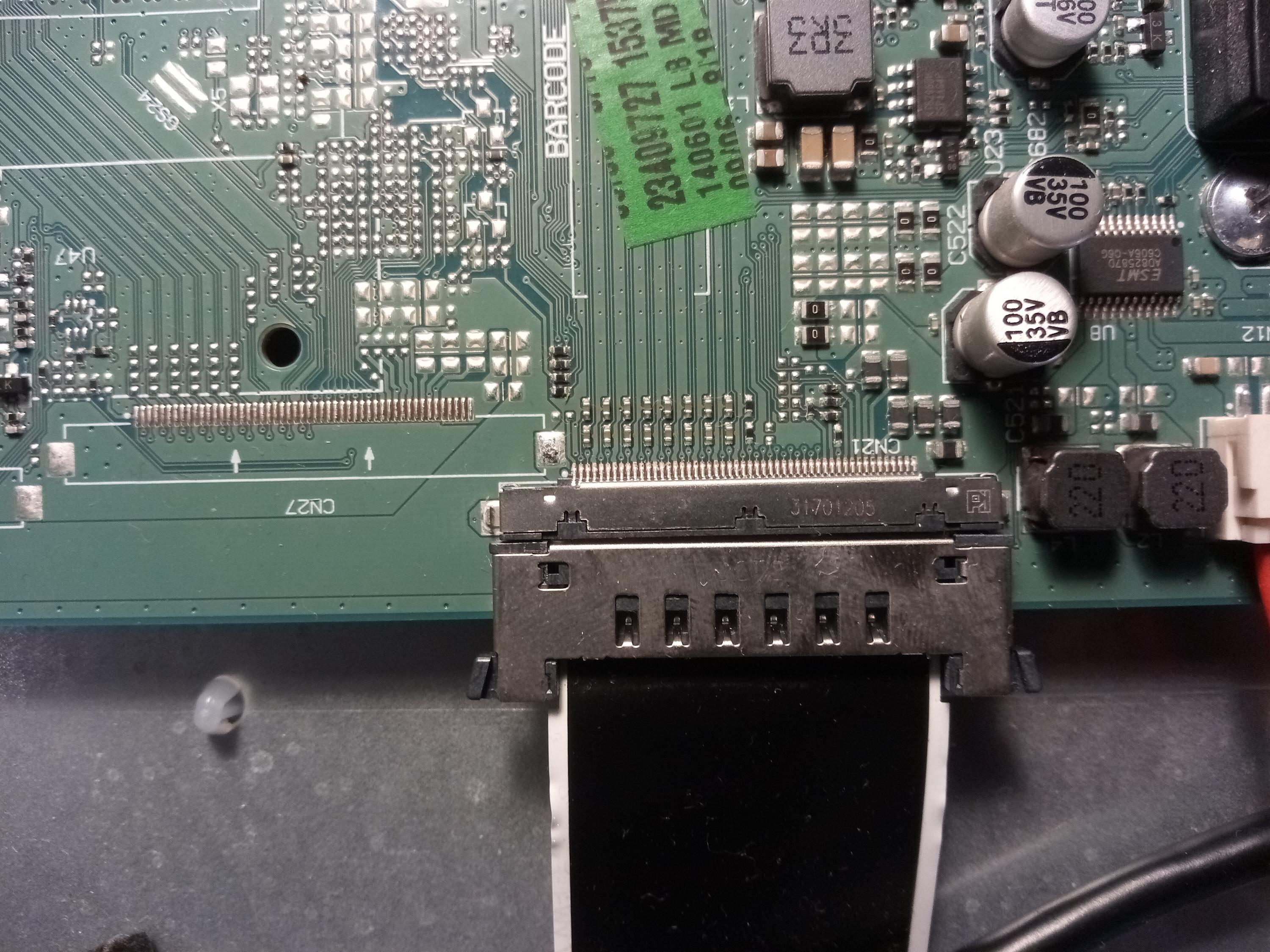

        • jimbofz
          • Apr 2013
          • 539
          • uk

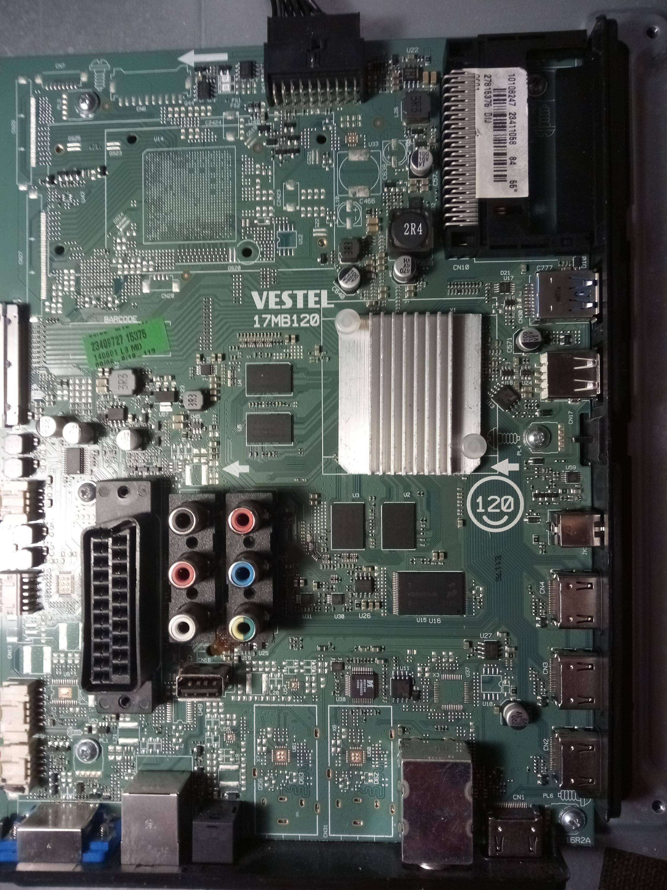

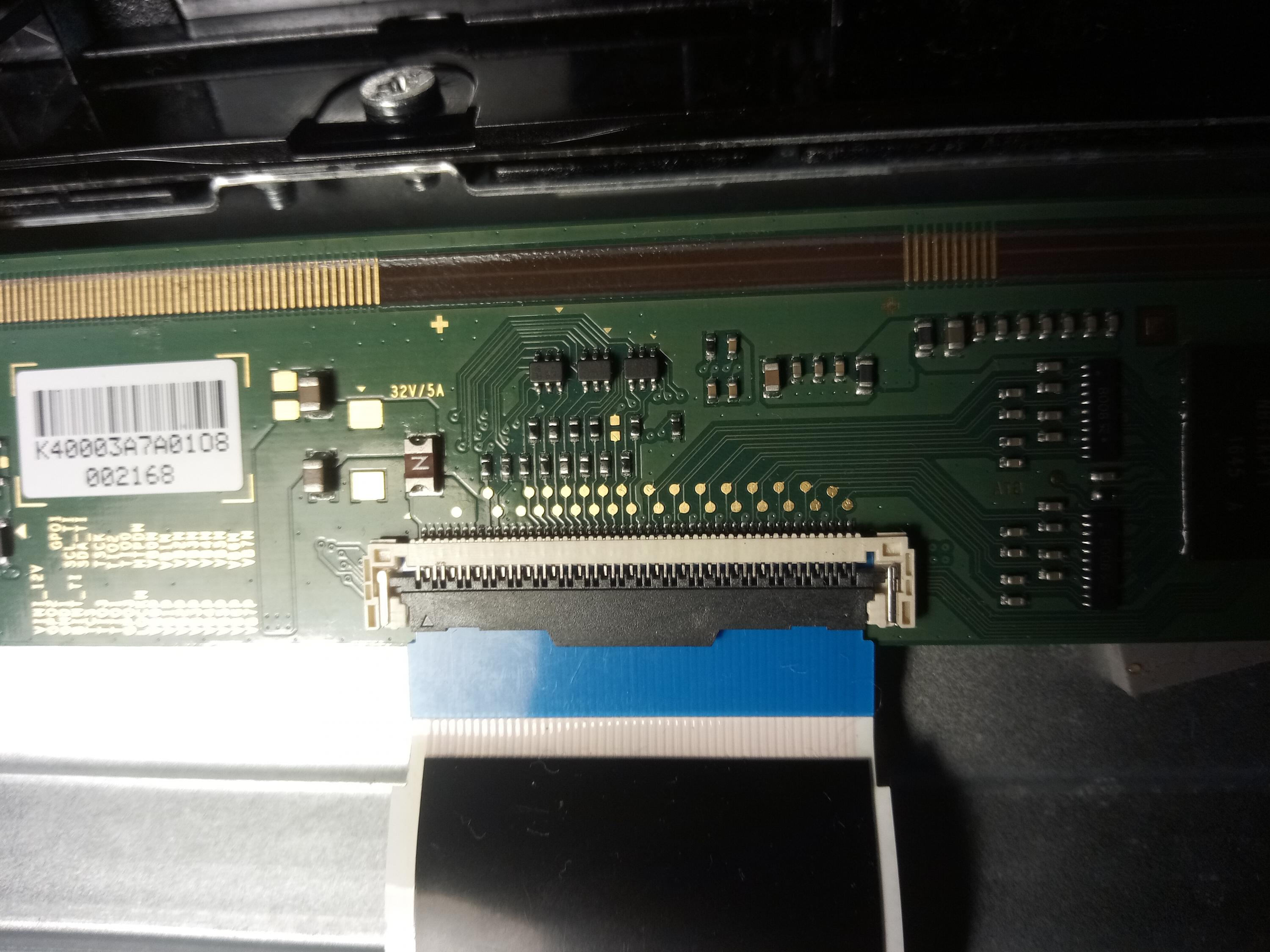

          heres the pics ,
          ive studied cct vbyone/lvds options
          and found r440 shown as : L dim en pin 22
          on the main board socket for lvds pin 22 is earth
          and pin 30 doesnt appear to have any connections to it ?
          after removing main board and tracing pin 30 ?
          i must be missing something

              could you locate on boards the U12 the MFC SPI 4Mb ?

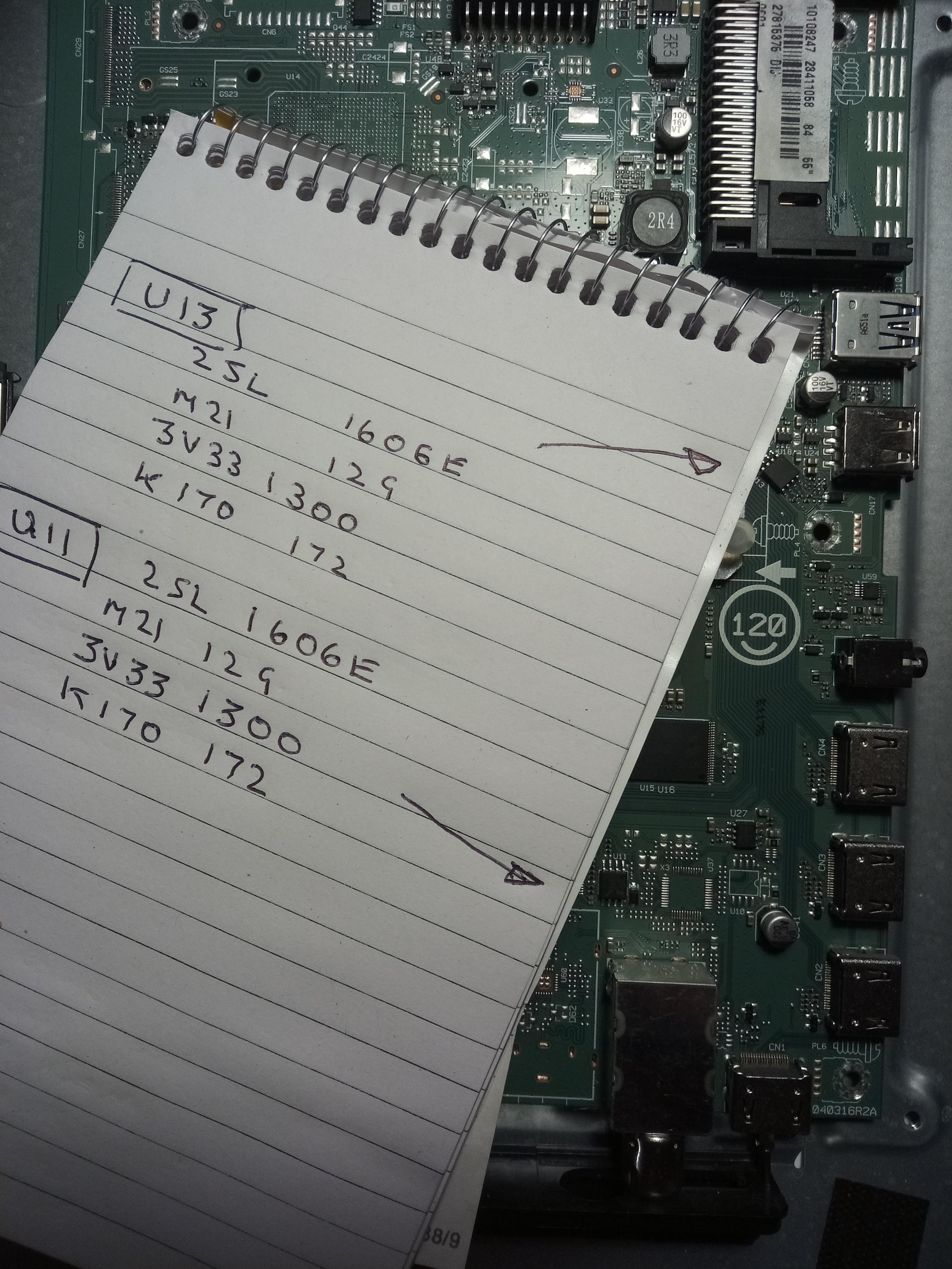

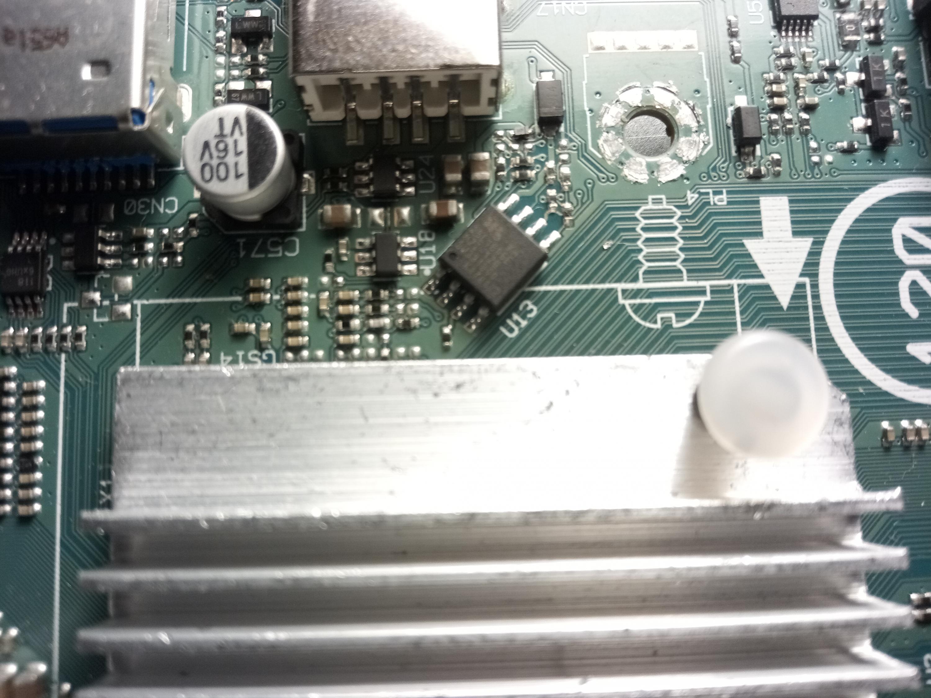

                  on my 17mb120 theres a u11 and a u13 ,but no u 12?
                  but on the circuit diagram u 12 ie shown.

                      #30
                      are you sure ? on the downside did you check too.. look on number of it in schematic and look after all SPI with 8 pins
                        U12 is spi of U14. Your chassis have single lvds option and don't have U14.
                        I insist on cof failure.
                        https://www.badcaps.net

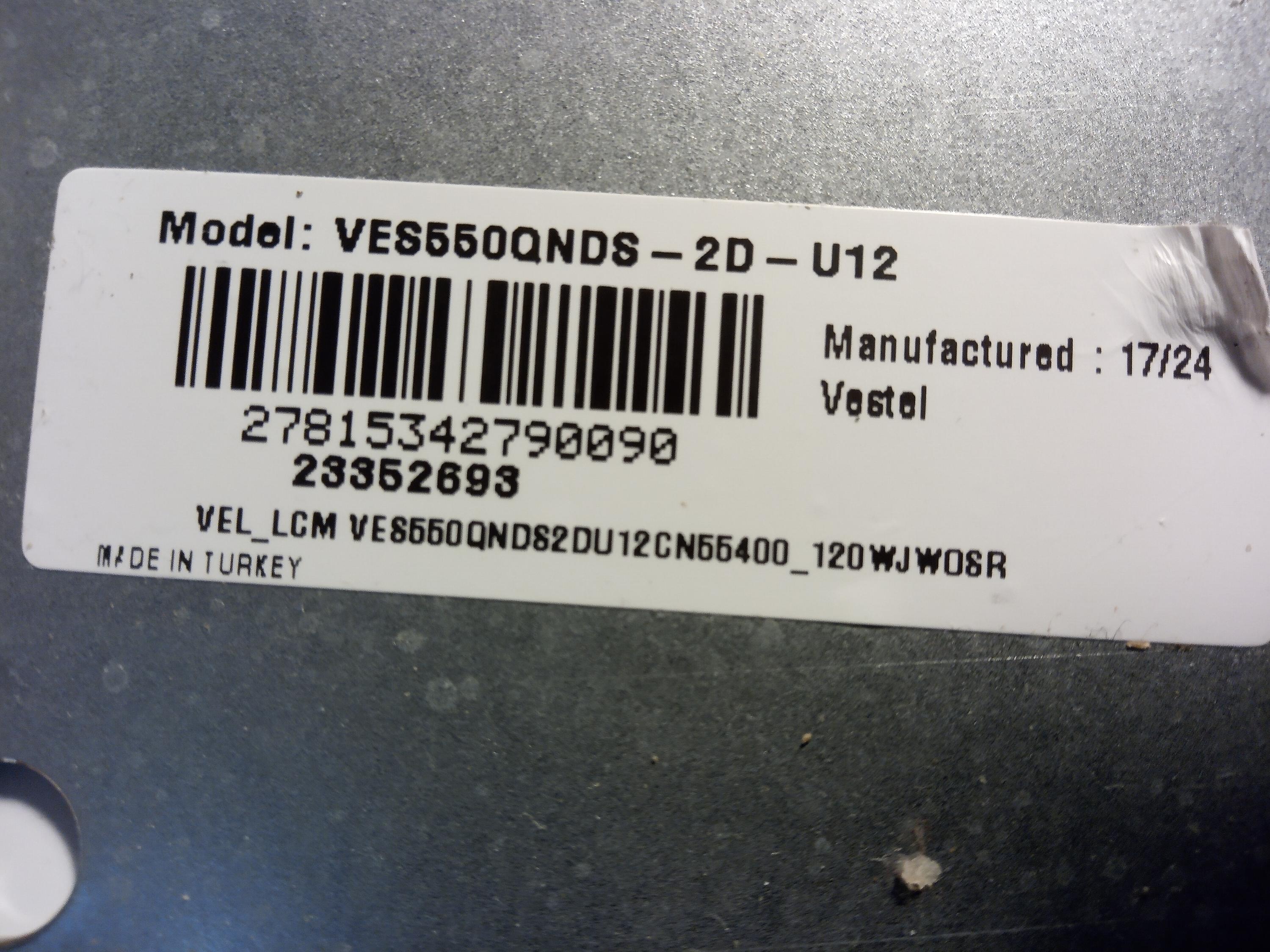

                              my panel type:ves550qnds 2d u12

                                are you sure this label related to Panel Type ? not BL strings Type?
                                • jimbofz
                                  • Apr 2013
                                  • 539
                                  • uk
                                  #36
                                  this is the label from inside tv

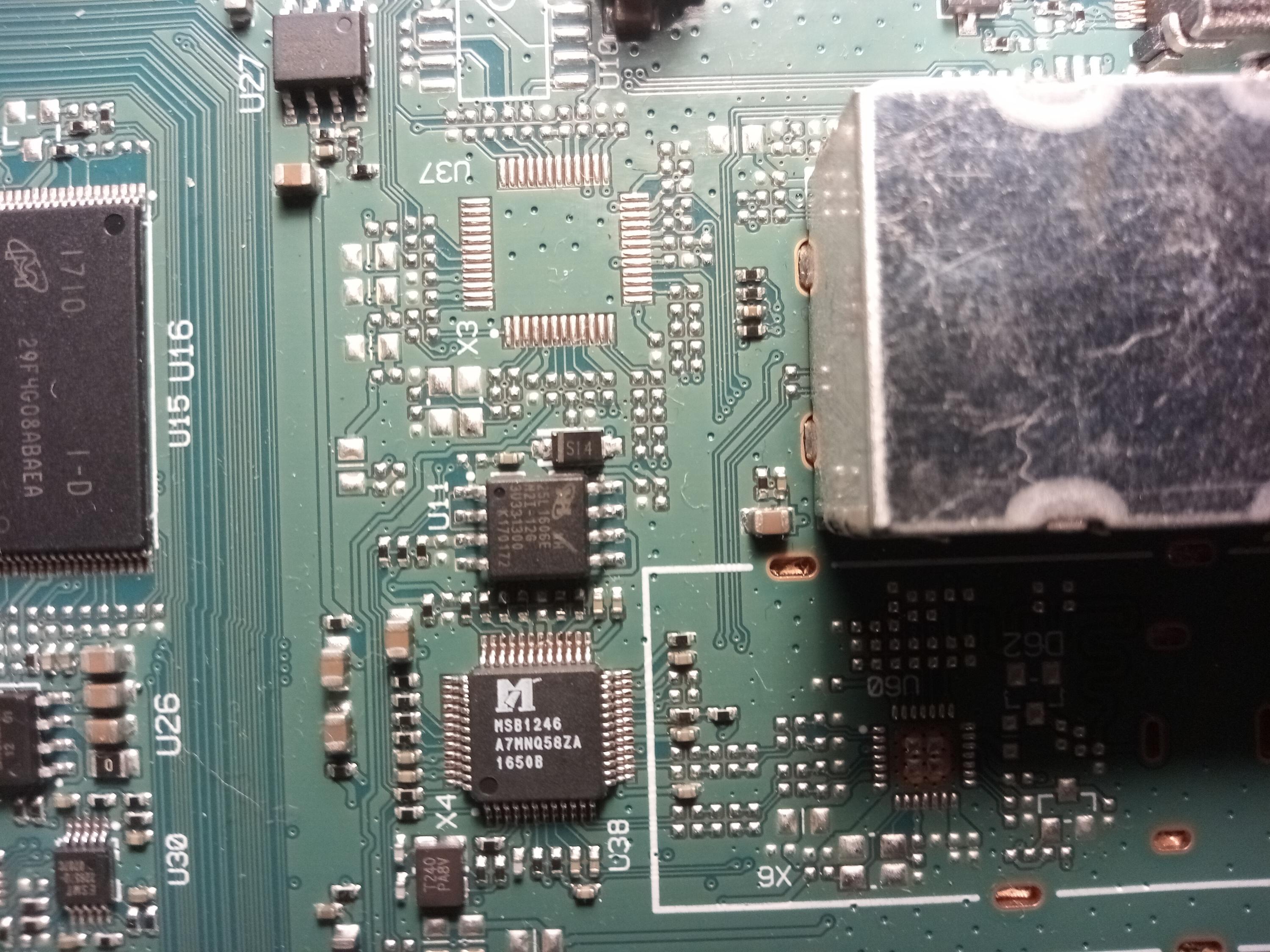

                                  • Diah
                                    • Feb 2013
                                    • 6439
                                    #37
                                    okay.. i am little confused.. where are yours MFC SPI ?
                                    can you tell how many SPI you have on boards .. 8pins with label No had part on it 25L ?
                                    • jimbofz
                                      • Apr 2013
                                      • 539
                                      • uk
                                      #38
                                      here are some pics of main board hope it helps thanks
                                      • Diah
                                        • Feb 2013
                                        • 6439
                                        #39
                                        good work... so U11 yours MFC SPI.. do you have programmer CH341A ?
