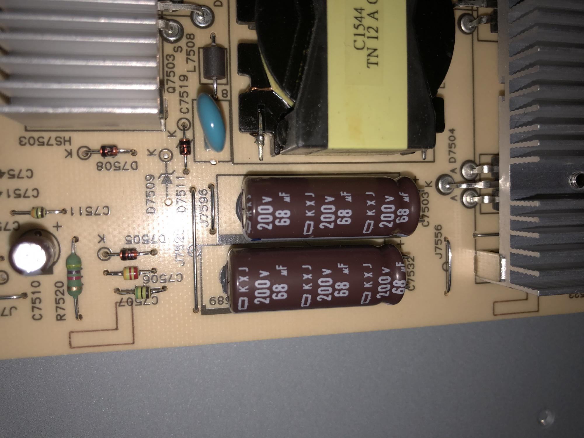

    Re: Sharp Aquos 80" TV ~ Model # LC-80LE844U ~ Not operational

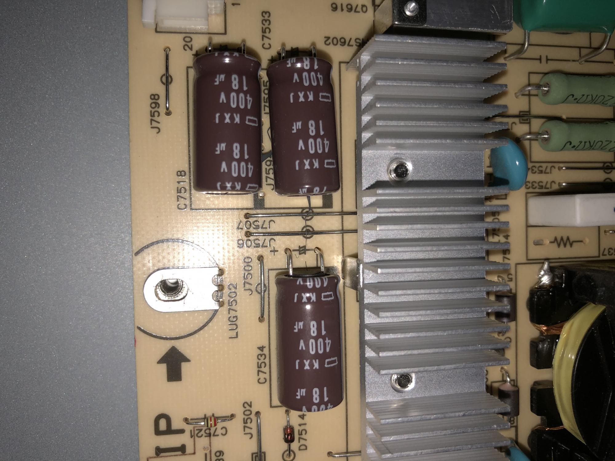

    Is that even an LED backlight? Looks like CCFL inverter caps! (those blue components)
    The model code appears to indicate a later-with-LED-version, right before Hisense bought the Sharp TV division, IIRC.

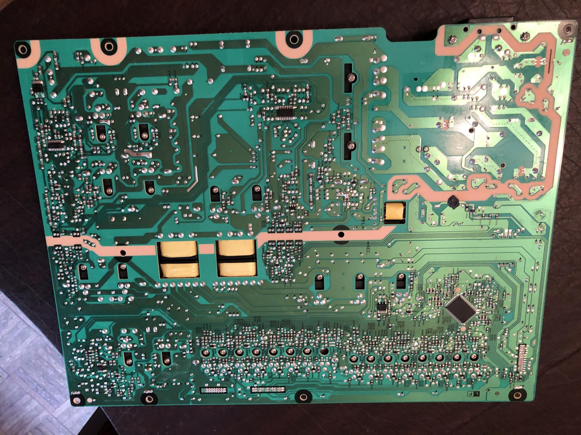

      Yes, I have been doing the resistance measurements with the power off. The DMM readings behave the same way when I have power off as they do when I was also measuring a fuse that was completely off / outside of the board (as I had taken a fuse from another set that also proved good (beeping) but had the same "momentaryily up then back down to 000 readout).
      • kca
        • Feb 2016
        • 529

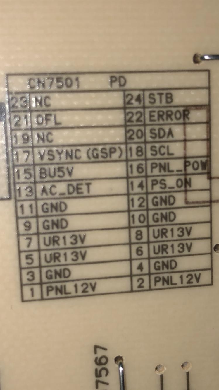

        I did all of the readings this morning you asked for, budm, both on the ODD numbered pins and the EVEN numbered pins. I will just simplify the result and say that there were NO readings at all on any of these 24 pins. Did see the chart you referred to printed on the board. There are similar charts for the L1 and L2 connectors that lead to the backlights, so all of those charts will prove useful whenever we can get power to those pins. As of right now, though, there is no reading on any of the 24 PD Connector pins nor on any of the L1 or L2 pins.
        I also thought it might prove useful if I tried to get a VDC reading from any of the medium-sized capacitors that are positioned in the upper left-hand corner of the board and in the same sector as the L1 and L2 connectors. Interestingly, there were NO readings coming off any of the three caps nearest the L1 connector (18uf 400v) and similarly NO readings coming off the two caps nearby (68 uf 200v).
        Does that tell us that the problem lies somewhere between the three operational filter caps I measured before (47uf 450v) that were getting readings in the 160's (and still are, as I measured all three again this morning) and the upper-left quadrant of the board where these other caps offer NO readings at all?
          I am not sure, RJARRRPCGP, you may well be right. I just quickly assumed there were backlights involved. I can do a little more research on this particular Model # and provide you with a more definitive answer.

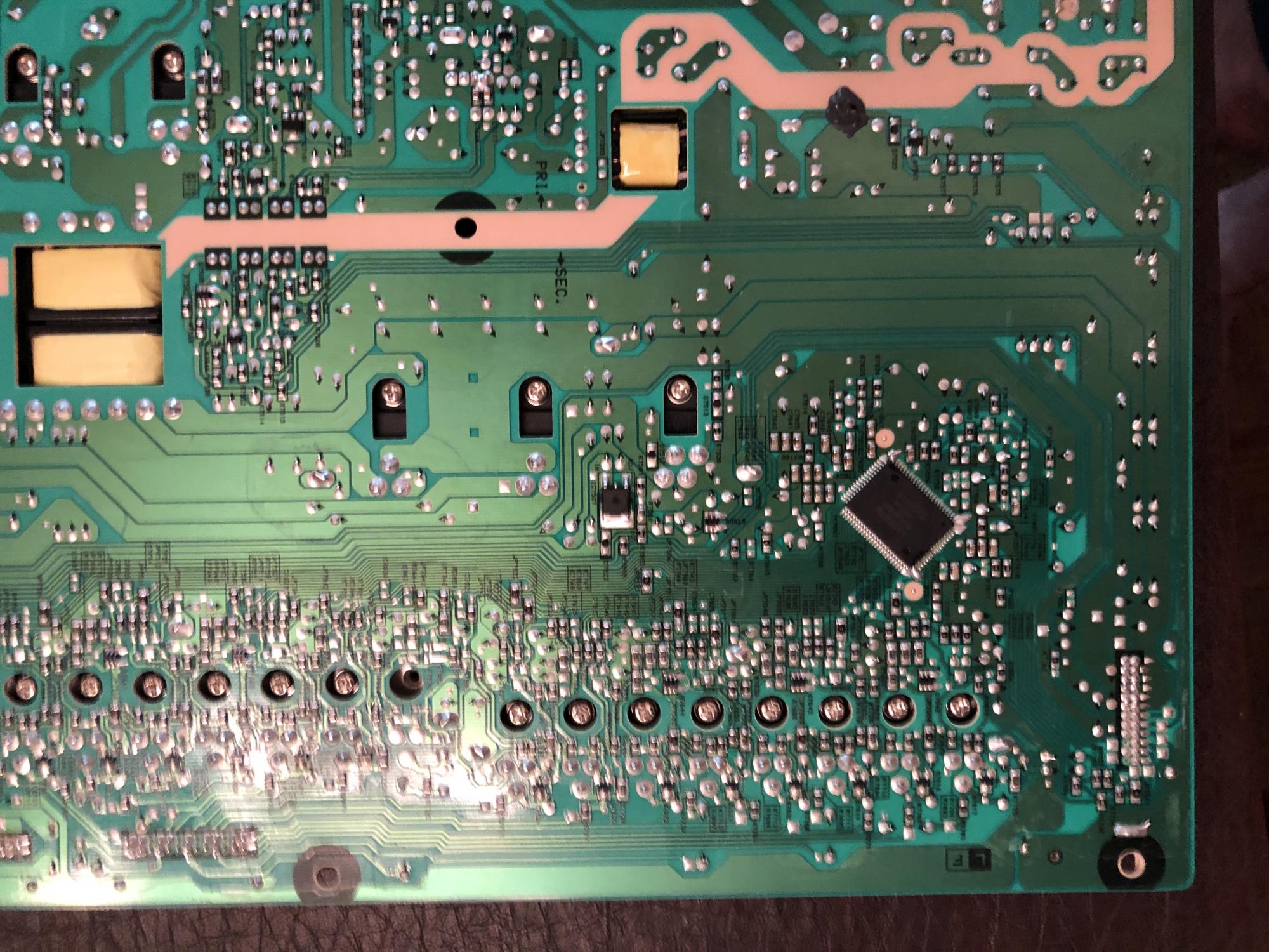

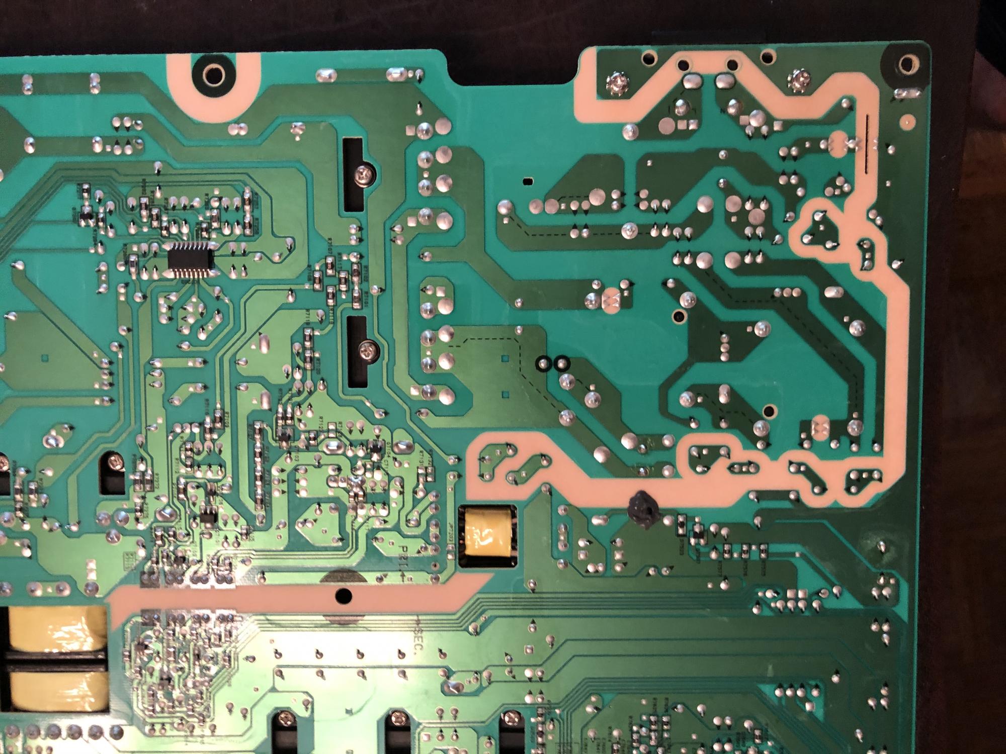

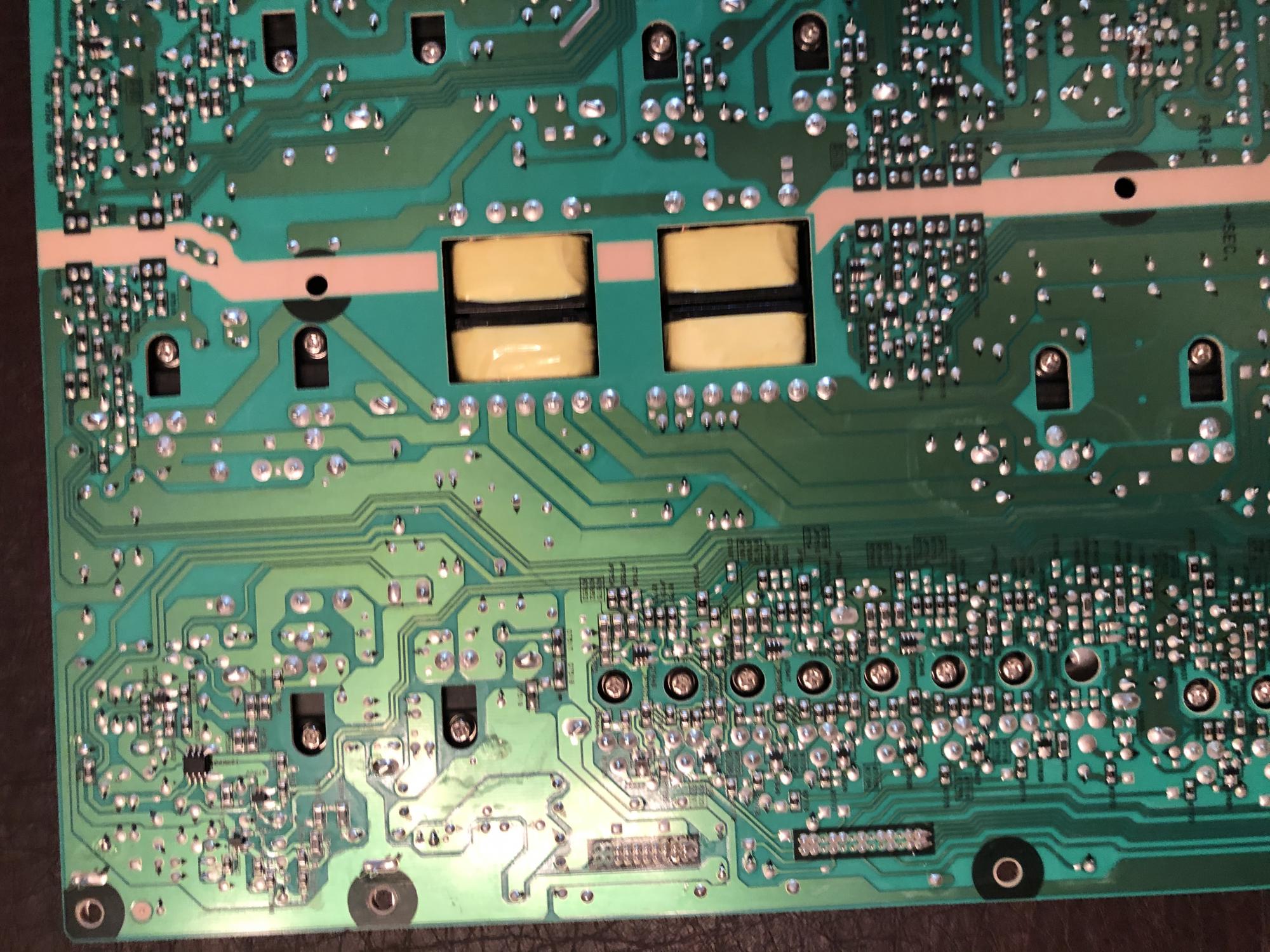

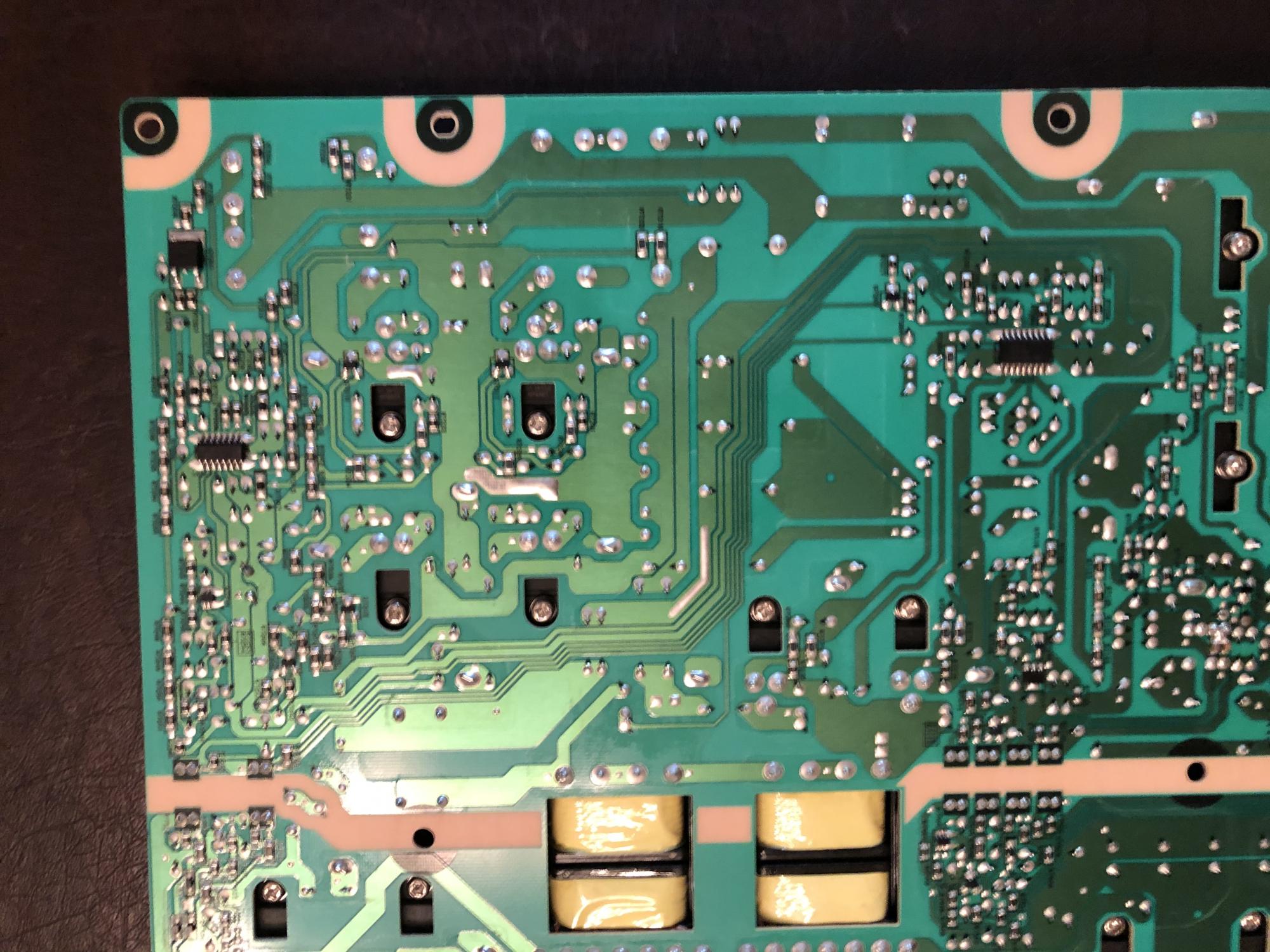

              More images that I hope help:
              • kca
                • Feb 2016
                • 529
                I did not find any obvious burn spots on either the front or the back of the board, even with looking at the back through a magnifying glass.
                Not sure what I can or should test next.

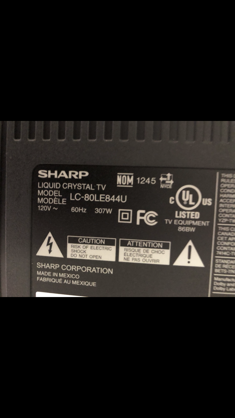

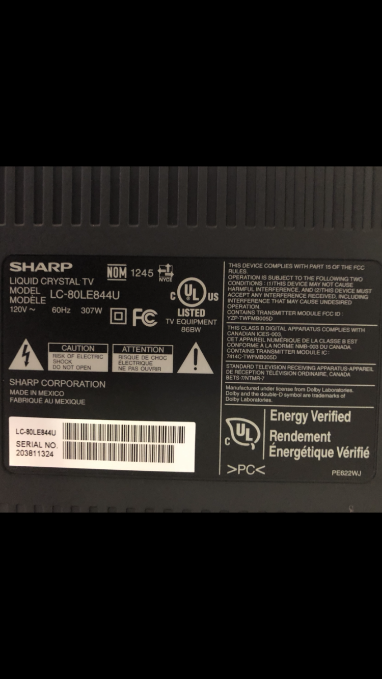

                  RJ ~
                  Everything I can find labels it as a LED-backlit LCD TV. Including this spec sheet from cnet:
                  https://www.cnet.com/products/sharp-...ed-tv-full-hd/
                  I will add a pic of the back panel label itself below. Are you seeing something on that label that would indicate other than LED backlit and, if so, what implications does that have (i.e., how does that affect the Power Supply Board and that fact that it is not operating right now)?

                    #29
                    Actual Back Panel Label w/ Model # info:
                      Did just notice, though, that there is no specific Date of Manufacture on that label. That's a bit odd.

                          #32
                          I see what looks like a time of manufacture. "1245". Looks like week 45 in 2012.

                            #33
                            Ahhh ..... yes, the 1245 makes sense. Thanks, RJ.

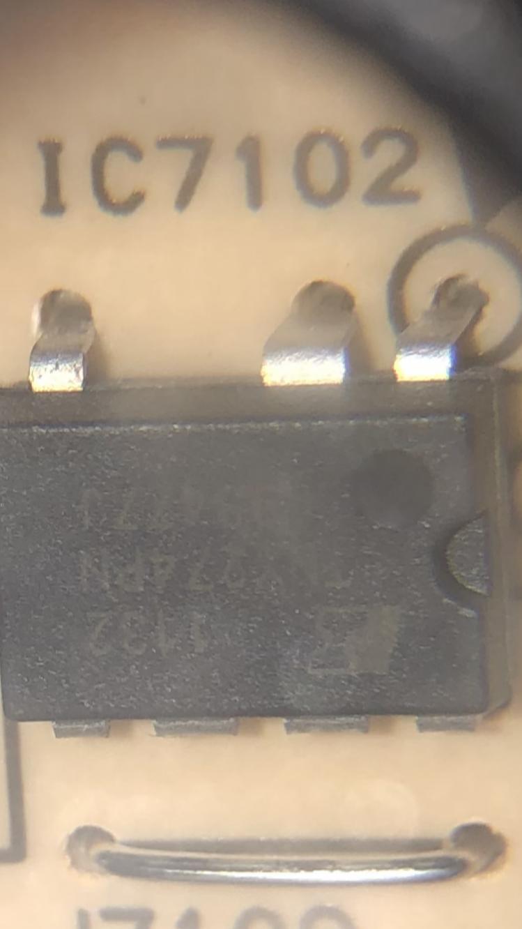

                                    #37
                                    Right now we have to find out why you are not getting the standby Voltage, that needs to be fixed first.
                                    I did not look at all the pictures to trace out the standby power supply section (IC7102, Xformer T710, D7501) yet, it is going to take time to trace that out, someone else beside me can spend time doing that too.
                                    Please provide the P/N as printed on top of SMPS IC7102.

                                      #38

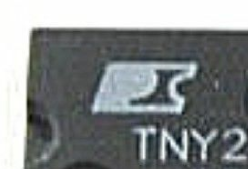

                                      Hey budm ~
                                      The P/N for IC7102 reads on top:
                                      1132
                                      TNY274PN
                                      93477J
                                      This link below seems like a good match w/ the 7-pins in play. Can see why you are focusing on this, budm, as it appears to be an AC / DC converter chip.
                                      https://www.mouser.com/ProductDetail...r-Integrations

                                        #39
                                        Has this same logo on it also:
                                        • kca
                                          • Feb 2016
                                          • 529
                                          #40
                                          Here's the best image I could get of it:
