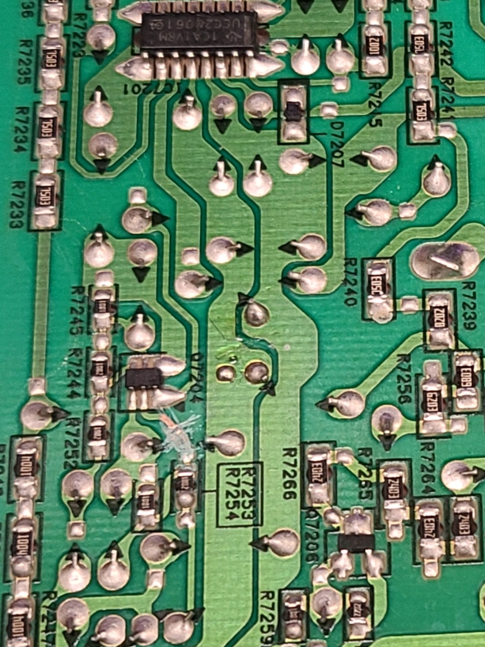

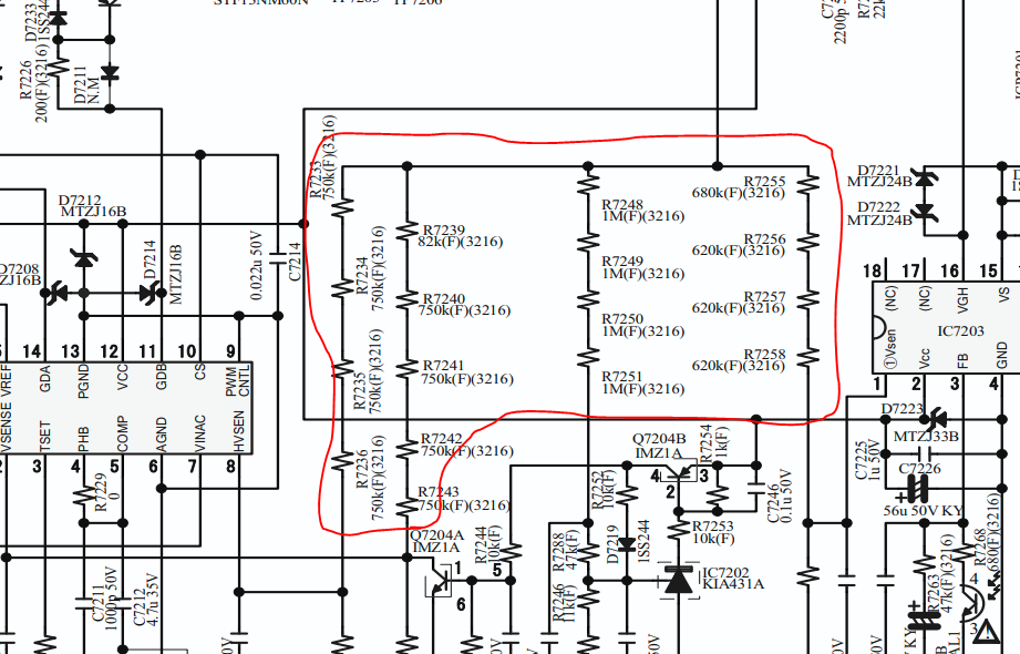

This post is about a problem that gives almost the same failure symptom, but definitely has a different origin, which, for the life of me, I can't figure out.
What is happening is the board starts, the relay clicks, the PFC raises momentarily to somewhere above 300V - like 310V or so, but not 380V-400V it should go, at least not by the Fluke, the secondary DCs all show up as they should and then, practically immediately, the PFC starts going down, apparently turned off.
The PFC driver is UCC28061 and it is definitely not the issue.
It's been a while since I last spent a night chasing this before giving up, but today yet another one of those board showed up with the same issue.
Unfortunately I can't find my previous notes, but I do remember I found the following: If I cut a certain track of an IC in the surroundings of the PFC driver the PFC stayed on and produced 396V as it should.
I got to this track while chasing the signal causing the shutdown, but that's what I remember from it...and the suspicion it may be some of the high voltage dividing resistors to have gone off and cause all this.
This is one of those nasty issues where things aren't exactly failed so you can just track down the short and take care of it (not that those can't have nasty side issues to kill your sleep, but it's less often).
It's luckily not a problem where you have to wait an hour for a spontaneous shutdown either - it's quite persistent and reproducible.
Yet in several multi-hour attempts over the pat few months I've failed to nail it.
Any help will be appreciated and I wouldn't at all mind paying for the knowledge...I am by no means novice to electronic repairs, but I don't quite consider myself professional either, even though most people probably would consider me such.
It's just that I know real professionals and I know I am not their level...and likely never will be.
I am just someone who usually finds solutions to problems and this one I so far can't.
