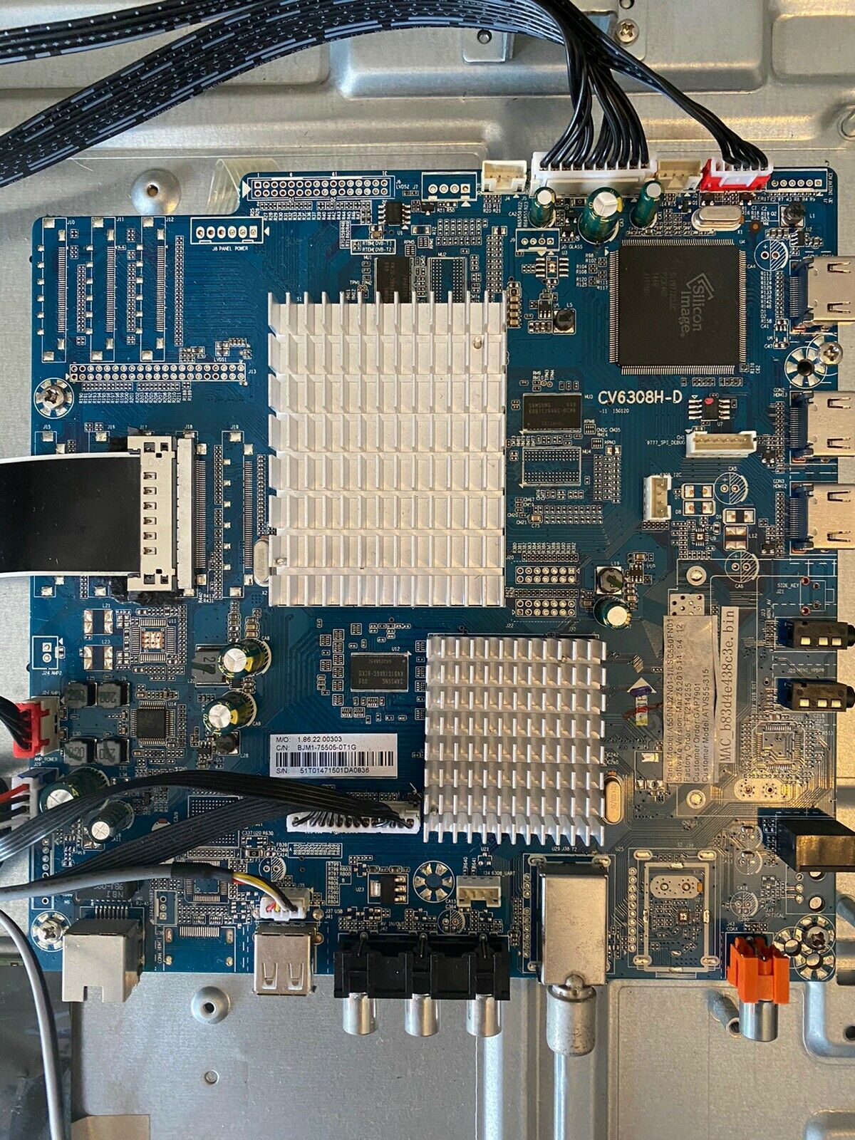

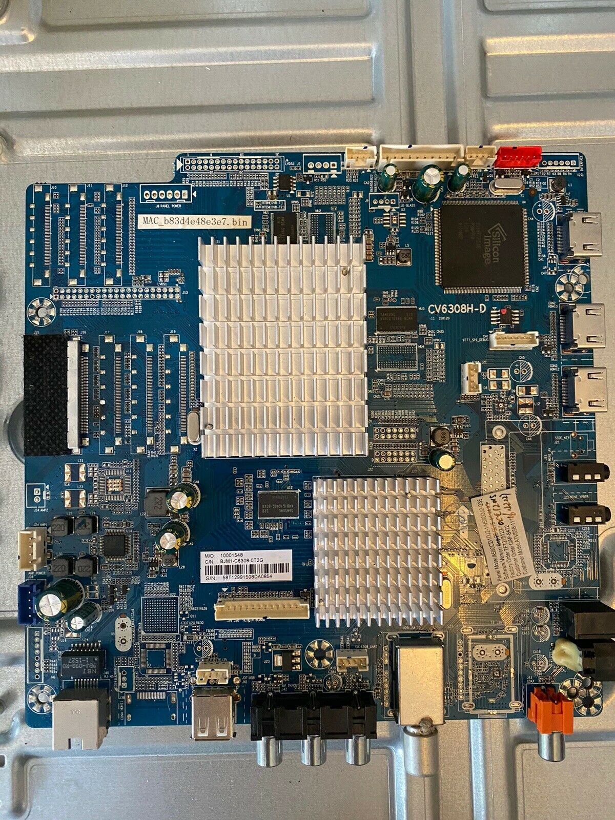

              He finally got back to me withe the photos of the boards that shows the stickers.
              The tv my board came out of was a 58" (which was clearly stated on the ad) and I wasn't aware but it seems that his tv is a 55".
              This is the text i showed on the ebay ad...
              I have a Main Power Board from a Bauhn 58" UHD Smart TV ATVS58-1115
              Part Number: CV6308H-D
              Used in good condition
              This may also be compatible with Akai TV Main PCB AK5515 P/N:AK5515UHDSM-MB, but please do your research I am not 100% certain of this.
              This item was removed from a 100% working TV with cracked screen
              Now Im not 100% sure that i am responsible for him grabbing the card thinking it would work in a different size panel because it had the same board number?
              Am I still responsible and have to refund him the money?
              I advertised it as a 58" tv, and although I said it may be compatible with an akai 55" (I saw the same board for sale on an ad for that tv), I did advise to make sure it was compatible as I wasnt sure?
              I have attached the photos, the one that has connections is his board.
                Re: Bauhn ATVS58 Mainboard issue
                As you can see, the LVDS connector location of your board for 58" panel is not the same for his 55", that means the pinout for the 58" panel and the 55" panel are not the same thus difference location for the LVDS connector.
                You now can see that the barcode numbers are also not the same.

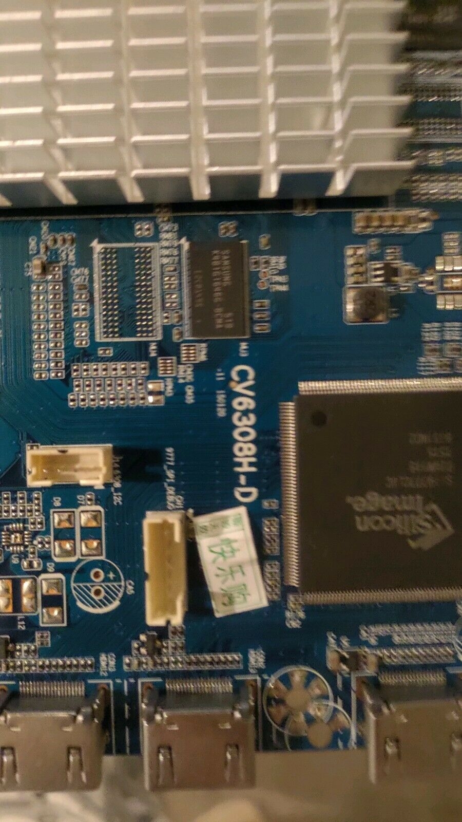

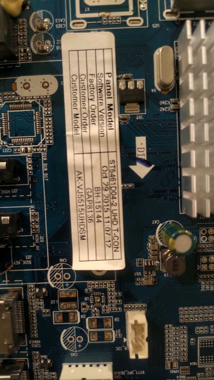

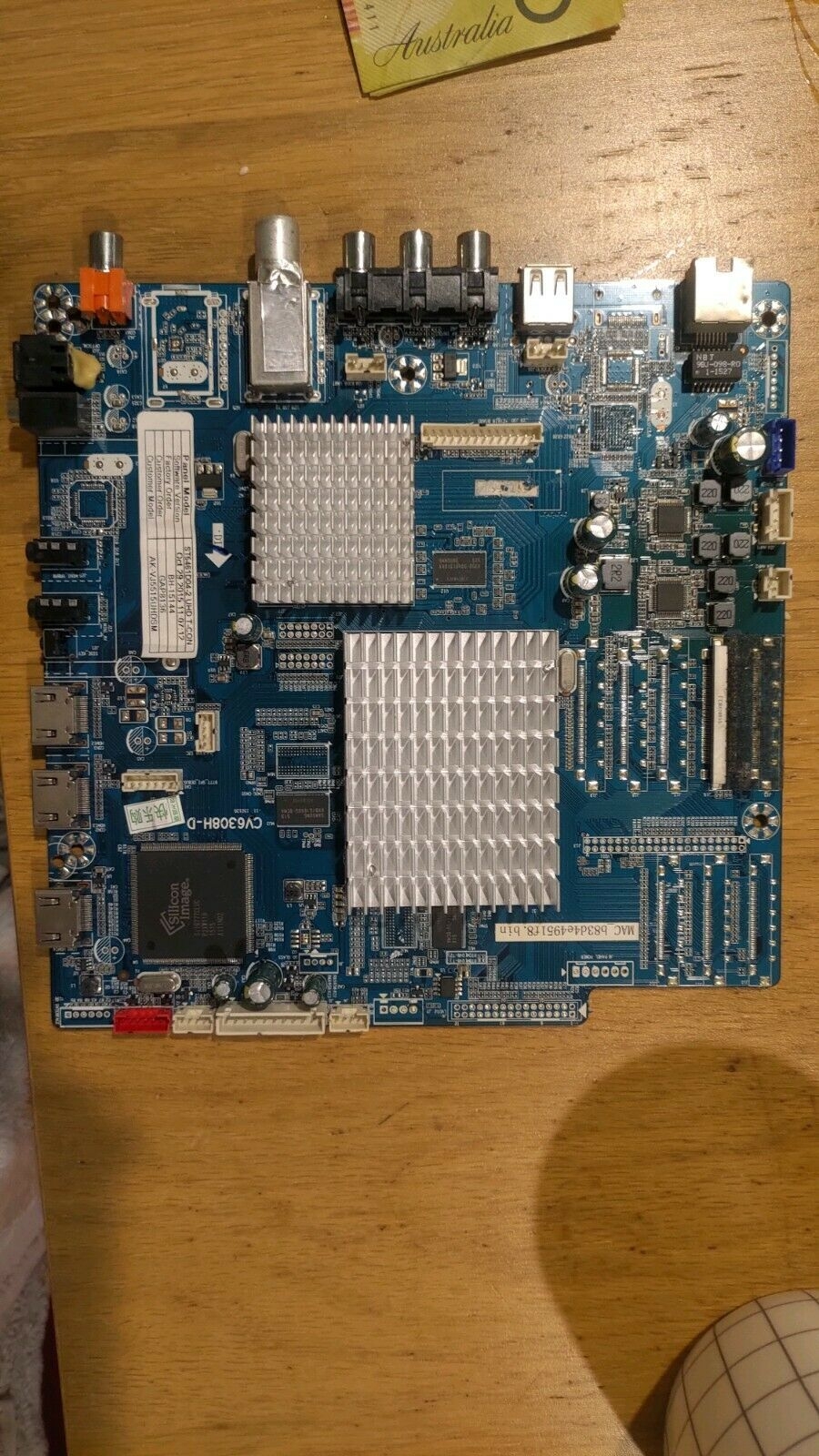

                        Would this card be suitable for him?
                        But then with his bootloop issue im not even sure it is the mainboard that is the issue
                          #32
                          His board:
                          https://www.badcaps.net/forum/attach...0&d=1595849900
                          Your suggested board in question:
                          https://www.badcaps.net/forum/attach...4&d=1595890494
                          As you can see, your suggested board has Sub woofer amplifier parts installed, and may be also some other component as well, you can see extra 2-pin speaker connector, so the board is not make for his TV model.
                          I also wonder hwy the barcode sticker is missing.
                          Your suggested board with the sticker indicating what LCD panel MODEL T-CON is made for: ST5461D04-2
                          Does he know what the LCD panel he has?
                          Since the board are not stuffed the same then we cannot tell for sure if they are compatible with each other or not.
