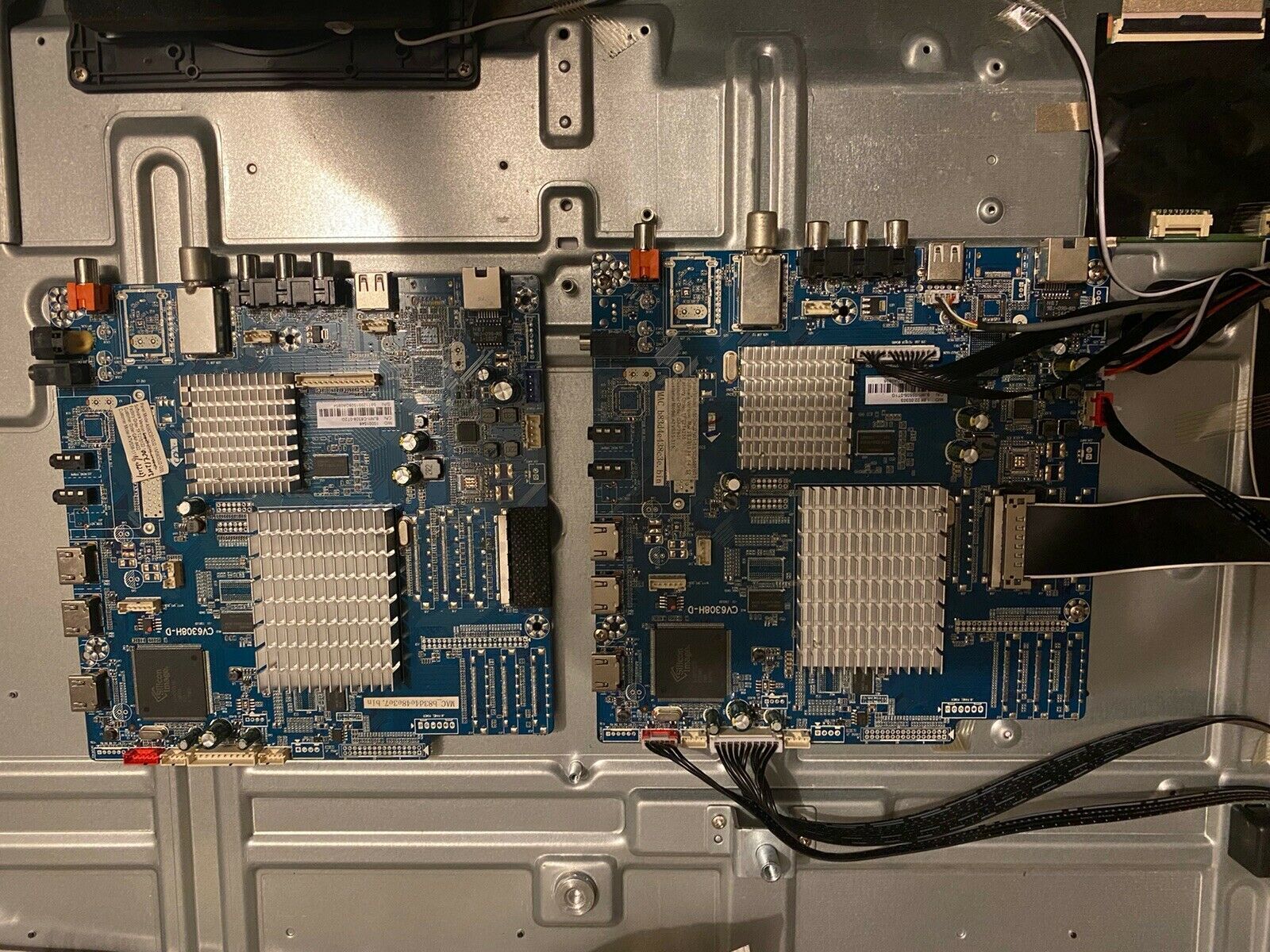

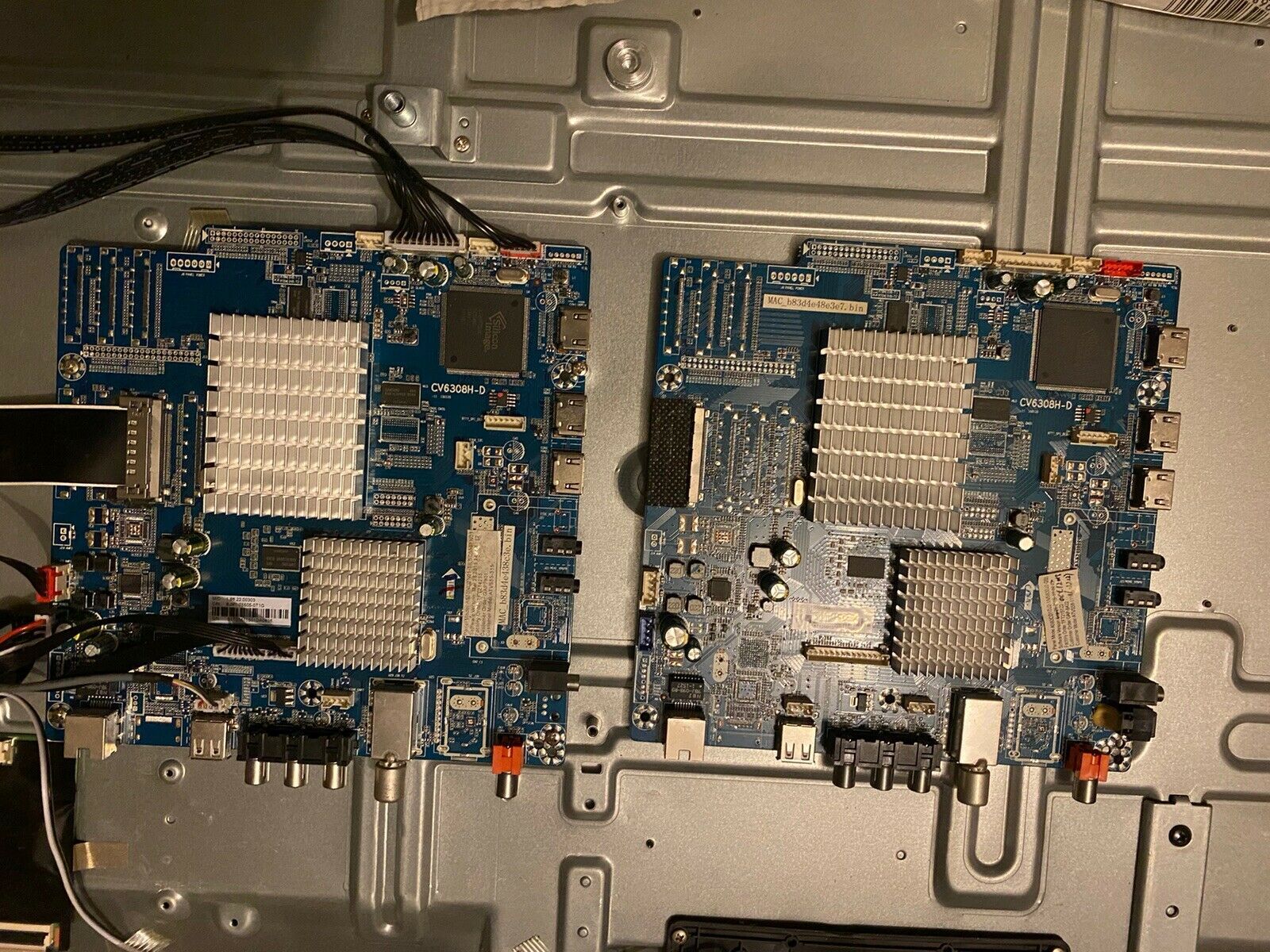

                                Im a little confused.
                                I asked him to send me a pic of the 2 cards together and he has sent me these photos.
                                They say the same model number but there are differences.
                                The cable connector next to the largest heat-sink is in a different position on both boards?
                                One has 2 black connectors on the side and and the other has 1?
                                Would this make one not work in the TV? I mean, the model number (CV630H-D) is the same, but I cant make out part number to check that.
                                Can anyone see anything in these photos that I should be suspicious of?
                                The board that is connected in the pics is his original board.

                                  Re: Bauhn ATVS58 Mainboard issue
                                  You need to go by the P/N on the barcode sticker for the PCBA.
                                  Both PCB's have the same blank PCB # CV6308H-D, but the PCBA's are not the same.
                                  Blank PCB can be stuffed to make many PCBA for the needed TV models.
                                  From the look of the two boards, the board has option for 5 model of LCD panels as you can see, the LVDS connector is not installed at the same location, so it can be that the VCC pins are not the same location for the LCD panel, that can be big trouble.
                                    Originally posted by budm
                                    From the look of the two boards, the board has option for 5 model of LCD panels as you can see, the two boards have difference location for the LVDS socket installed.
                                    so what you are saying is that my board is incompatible with his model tv and that is why it doesnt work for him as it was made for a different panel?
                                    So in essence, you cant just order a new board on ebay just using the mainboard model number?
                                      You have blank PCB P/N and version printed on the board, CV6308H-D, then you have PCBA (PCB Assembly number) on the BARCODE sticker, as I indicate blank PCB can be stuffed to make many PCBA's for many TV models.
                                      You can also see that the LVDS connector is not installed at the same location, that main board can be made to be compatible with 5 kinds of LCD panel as needed for each TV model or series.
                                      I hope his T-CON board is not damaged when he plug his LVDS connector to your main board since VCC pin of the LVDS connector may not be the same pin out, or your main board can be damaged too.
