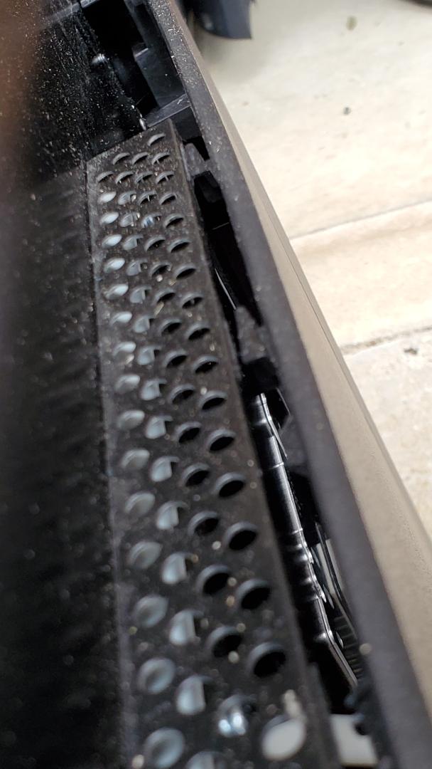

                      • petehall347
                        • Jan 2015
                        • 4431
                        • United Kingdom
                        #51
                        Re: Remove rear panel Sony Bravia KD-65X7500F
                        • viewerau
                          • May 2020
                          • 305
                          #52
                          Looks like the right tool so far.....
                          Signature:Seemingly hopeless tv fixer

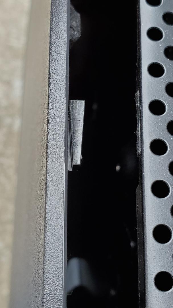

                          • nomoresonys
                            • Jan 2013
                            • 12220
                            • U.S.
                            #53
                            EUREKA you have finally found the right tool

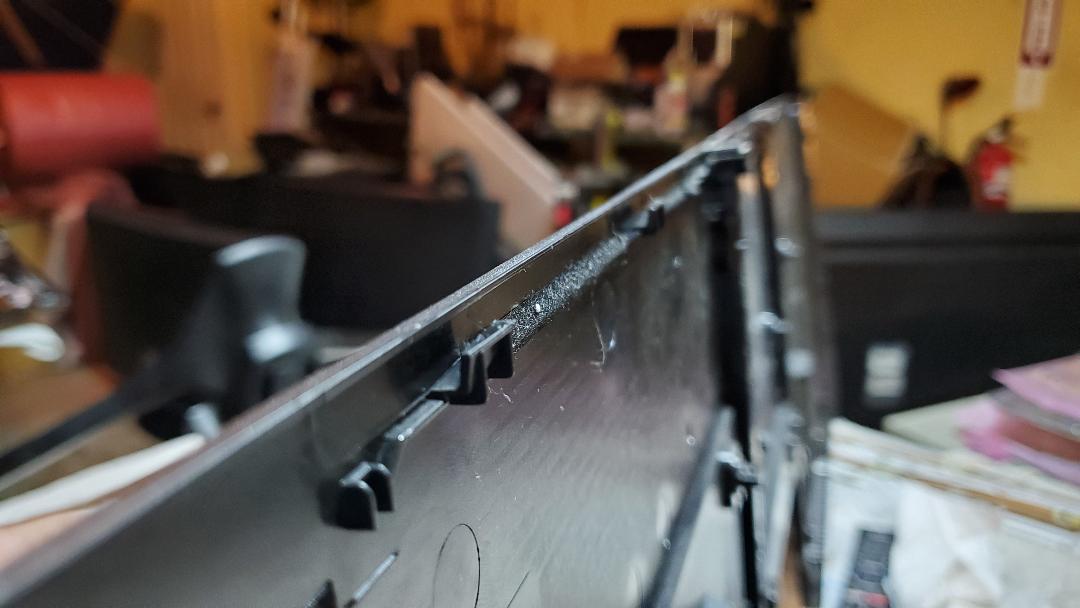

                            • brucetv
                              • May 2015
                              • 281
                              • united states
                              #54
                              Here is another picture of one of many ways Sony engineers like to make your life miserable as a Tv technician. The first picture is a Sony XBR-65x930D and on it it has plastic clips that slide under that top metal vent to release so on it after all the screws are off you push the back cover DOWN after the bottom comes out. Fairly easy on this model. On Sony's some time there will be a slider release on the left and right you slide up and THAT releases the cover after all the screws are out. And then there is the nightmare flat head sliders that wreak havoc on your day and you just want to go out and take a sledge hammer to a customers tv that hasn't paid for his repair for 3 months. Here is a excellent artist rendition of what these look like and on these types you have to push the back cover up to slide those slots off those tight ass screw heads. Never a dull day with a Sony. Next time I see one with the "slots from hell" type covers I'll take a picture and add it to this forum. ====> Sony engineers
                              • viewerau
                                • May 2020
                                • 305
                                #55
                                Thanks brucetv....I really do appreciate your effort, and will try again tomorrow.

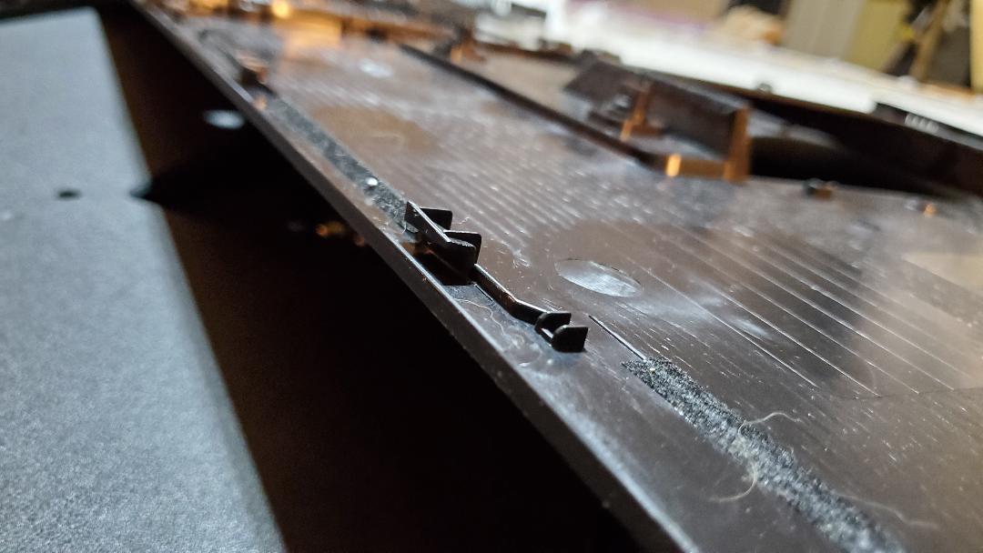

                                • brucetv
                                  • May 2015
                                  • 281
                                  • united states
                                  #56
                                  Here is another example of Sony's over engineering. On this type you have to pull the bottom out and then the back cover pulls down. These clips stubbornly fit into the slots in that metal vent. I wish all manufactures would just stick with screws only, no friggin clips and crap like this guys tv. Who gives a shit what the back of the tv looks like.
