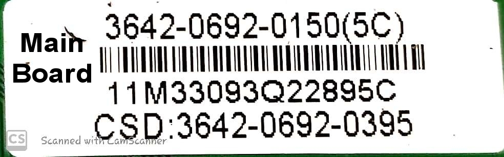

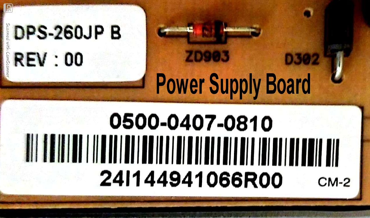

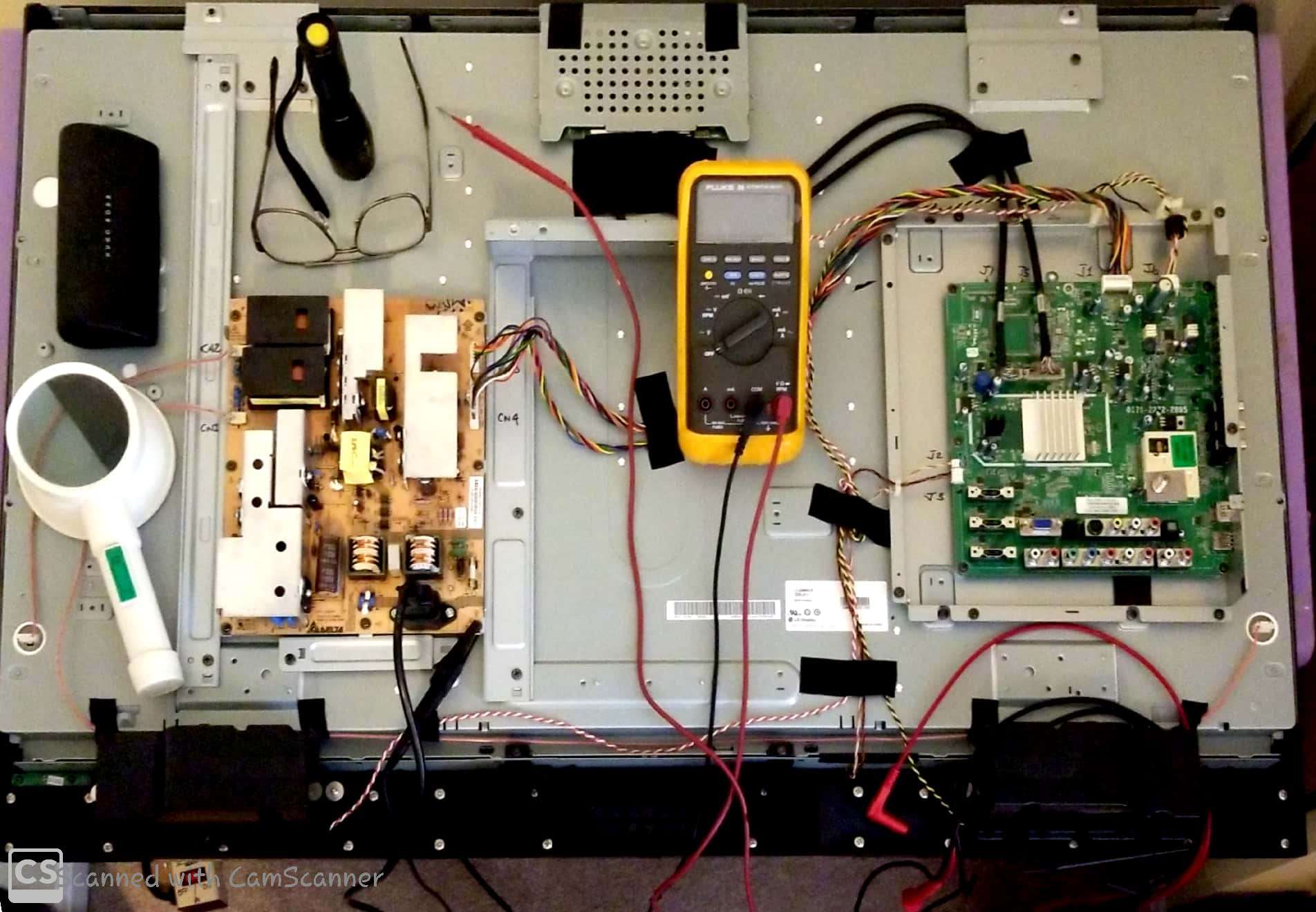

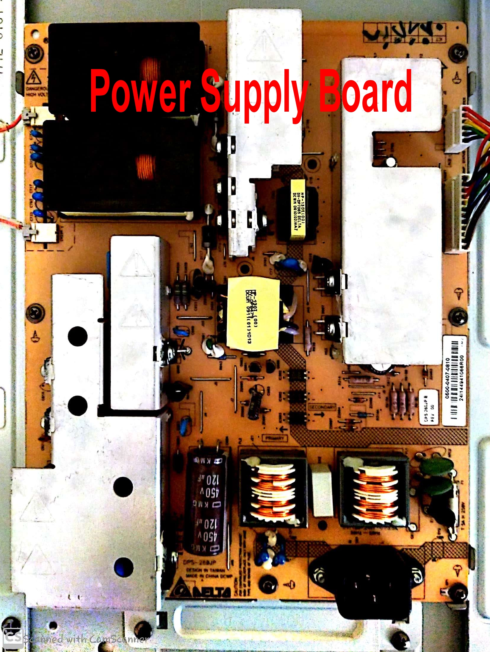

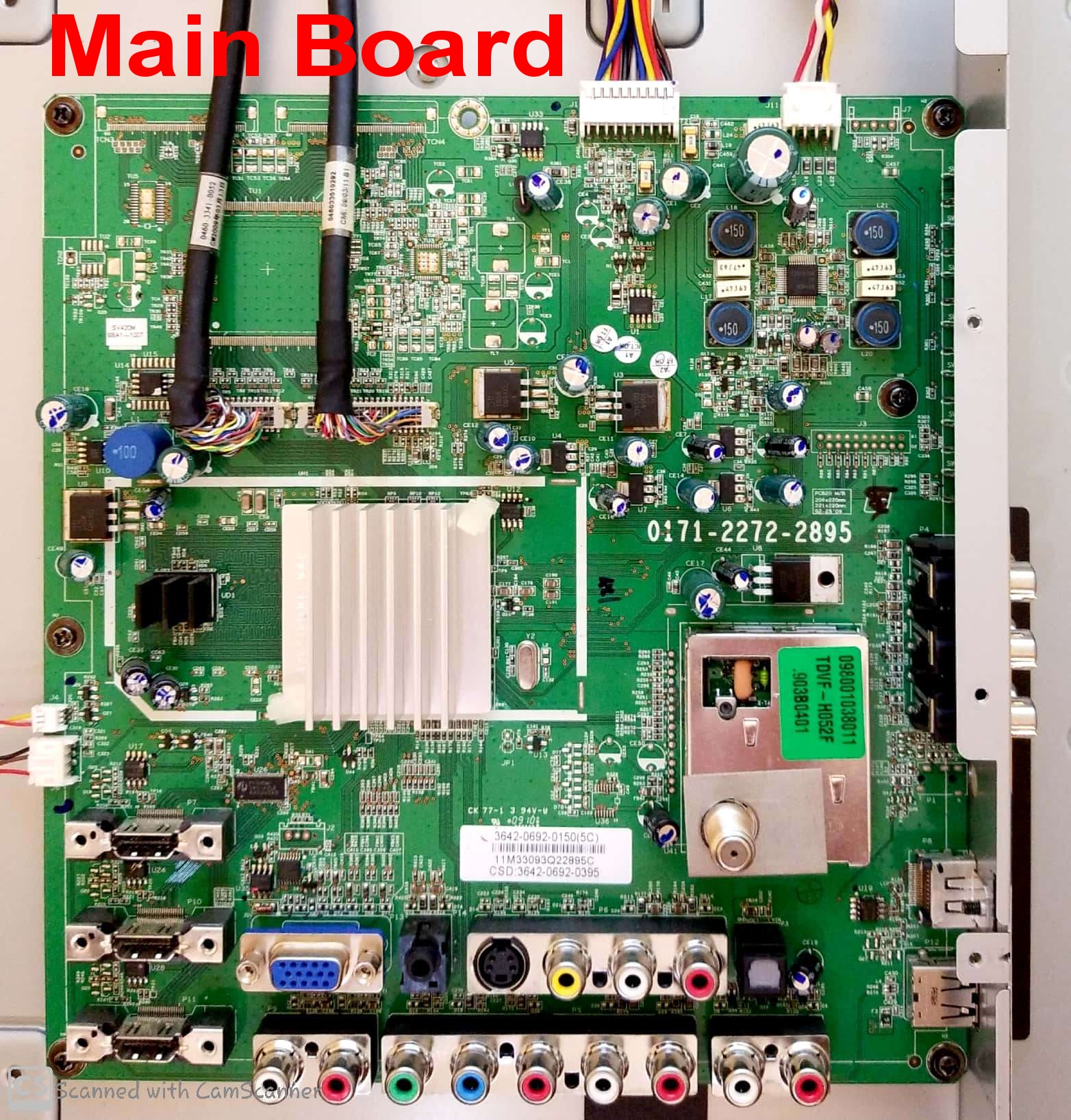

        I've also attached some pics, and will try heating/cooling the EEPROM, hopefully later today.

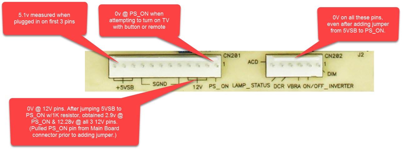

              Also, I've attached a pic of all the readings from the Pwr Supply connectors.
              I'm not sure I understand the CN202 connections, which thus far all stay at 0v. I'm thinking that based upon CN201 supplying PS_ON to the main board, it should then return an Inverter_On signal to CN202, correct?
              Not sure about these pins on CN202:
              ACD?
              DCR?
              Thanks again for all the great insight! I'm learning!

                The pins on CN202 control the backlight, ON/OFF_INVERTER turns the backlight on and off. DIM controls the brightness of the backlight. LAMP_STATUS tells the main board if the backlight is on or off. The other pins like VBRA,ACD,DCR are not used on this model.
                CN201 does not SUPPLY PS_ON to the main board, it is the control line FROM the main board to turn the power supply ON

                  So to clarify further,
                  • the 5.1VSB from the Pwr Supply board is supplied to the Main board, and
                  • once the PS_ON signal is sent back to the Pwr Supply board from the Main Board (by activating the On/Off switch or the remote),
                  • this is the input to the Pwr Supply board to wake up and produce the 12V output, which then is also sent to the Main board, correct?
                  I suspect that the Mainboard will then signal the Pwr Supply to turn on the backlight by sending a signal to ON/OFF_Inverter, correct?
                  To prove out the backlight, can I jump 5VSB to the ON/OFF Inverter pin at CN202, through the 1K resistor like I did to get 12V out at CN201?

                    Make sure the cable from powerboard to mainboard is unhooked, when you try it you will need your first jumper in place then your on/off inverter to 5vsb probably also need one from dim to 5vsb, so 3 resistors.

                          Yes unhook both, you are self testing the powerboard and backlights.

                                Right, the test in post #10 will supply the 5v to inverter on/off to see if the backlights come on and stay on, may need a resistor jumper on dim to 5vsb too.

                                  So jumping 5VSB through a 1K resistor to the ON/OFF Inverter pin in addition to the PS_ON pin lit the backlight up just fine. I did have the harness from the Power Supply board disconnected from the Mainboard, so I assume that's why the orange Vizio Logo was not on. (Previously just plugging in the set illuminates it orange indicating 5VSB is good.)
                                  At this point, knowing that the backlights work and both the 5VSB and the 12V signals from the Pwr Supply board are there, can I assume the Pwr Supply is good? (Should I load the 12 output to make sure it doesn't crash, or does verifying the backlight prove out the 12V rail is good, in and of itself?)
                                  I'm thinking that with all the previous measurements made on the main board regulators, that I can be pretty sure now that it is the U14 EEPROM?
                                  Is this a good assumption, or is there more I can do to rule anything else out?
                                  Thanks Again!
                                    Re: Vizio SV420M Yellow Logo and That's All She Wrote!
                                    Power supply board is fine, try new EEPROM, just make sure to get the right one for your main board.
