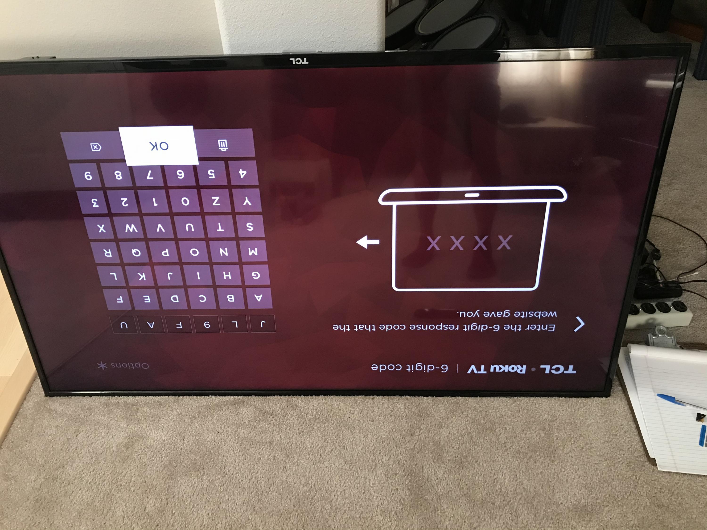

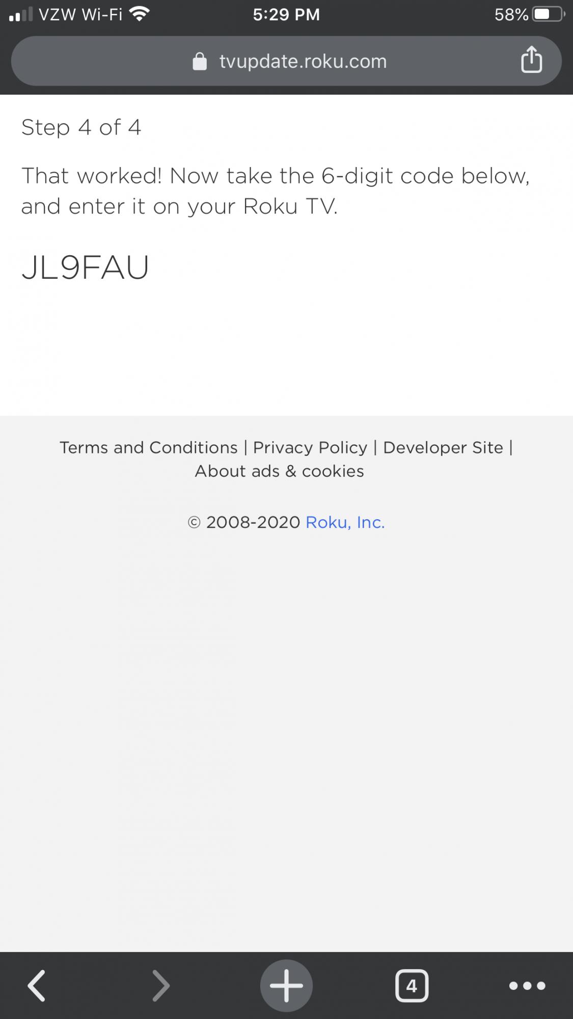

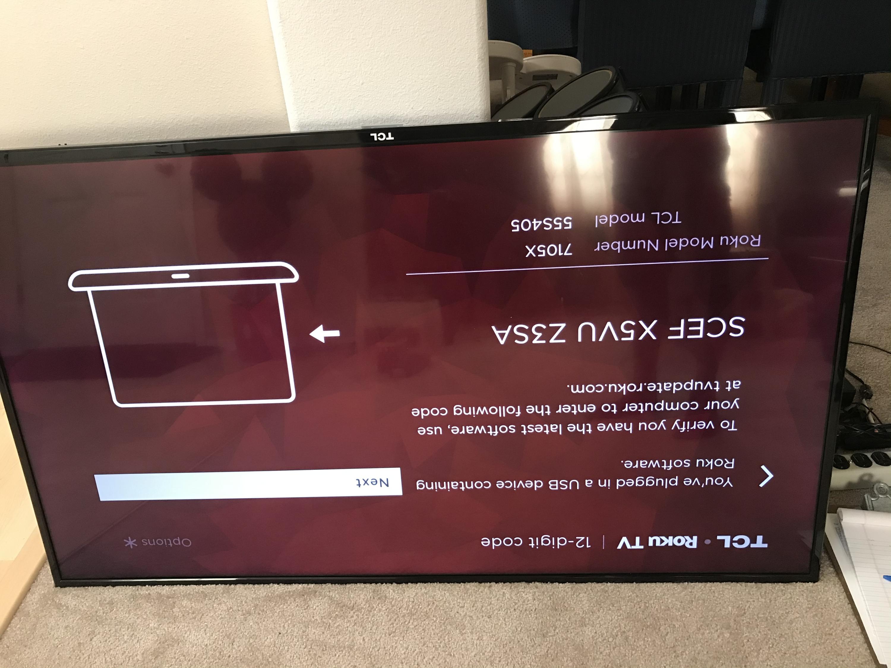

              There is 5V on the USB port. Regarding Post #81 about the light blinking on the USB stick - i was using a USB stick that didn't have a light. I swapped to one that does - nothing happens - there is no "access" blinking on the USB stick when you plug it in. It just stays illuminated (e.g. "idle"). It's a SanDisk USB stick.
              Anyway, I placed the guts back inside the TV and closed up the cover yesterday afternoon. I turned it on for the last time before i kick it to the curb. -- The screen worked (for that time anyway). I grabbed the USB stick, plugged it in to observe the behavior of the stick and what happens on the screen.
              From the USB perspective - the USB stick light doesn't show "activity." when you plug it in - again, it just stays illuminated -- "idle." The TV screen doesn't show anything indicating that an update is in progress or that it detected a USB stick was inserted with an update file. I had to manually go into the settings and find the software update menu.
              From there, i selected the offline update option, THEN it read the USB stick (the light on the USB stick flashes accordingly). The screen then gave me the 12 digit code. (See Pic1).
              I entered this code on the tvupdate.roku.com website. It gave me a 6 digit response code that i entered on the TV. (Pic 2, Pic3). Then it updated.(PIC4) When it got to 100%, it had a "update successful" message followed by indicating that it will reboot.
              Well... after the reboot, i was back to the same non-functioning screen state. The TV was still "ON" (i can hear the clicking sounds when i increase/decrease the volume).
              I think I'm done with this TV. Thank you for the help and suggestions and for being persistent through the last two weeks. I really appreciate it.
