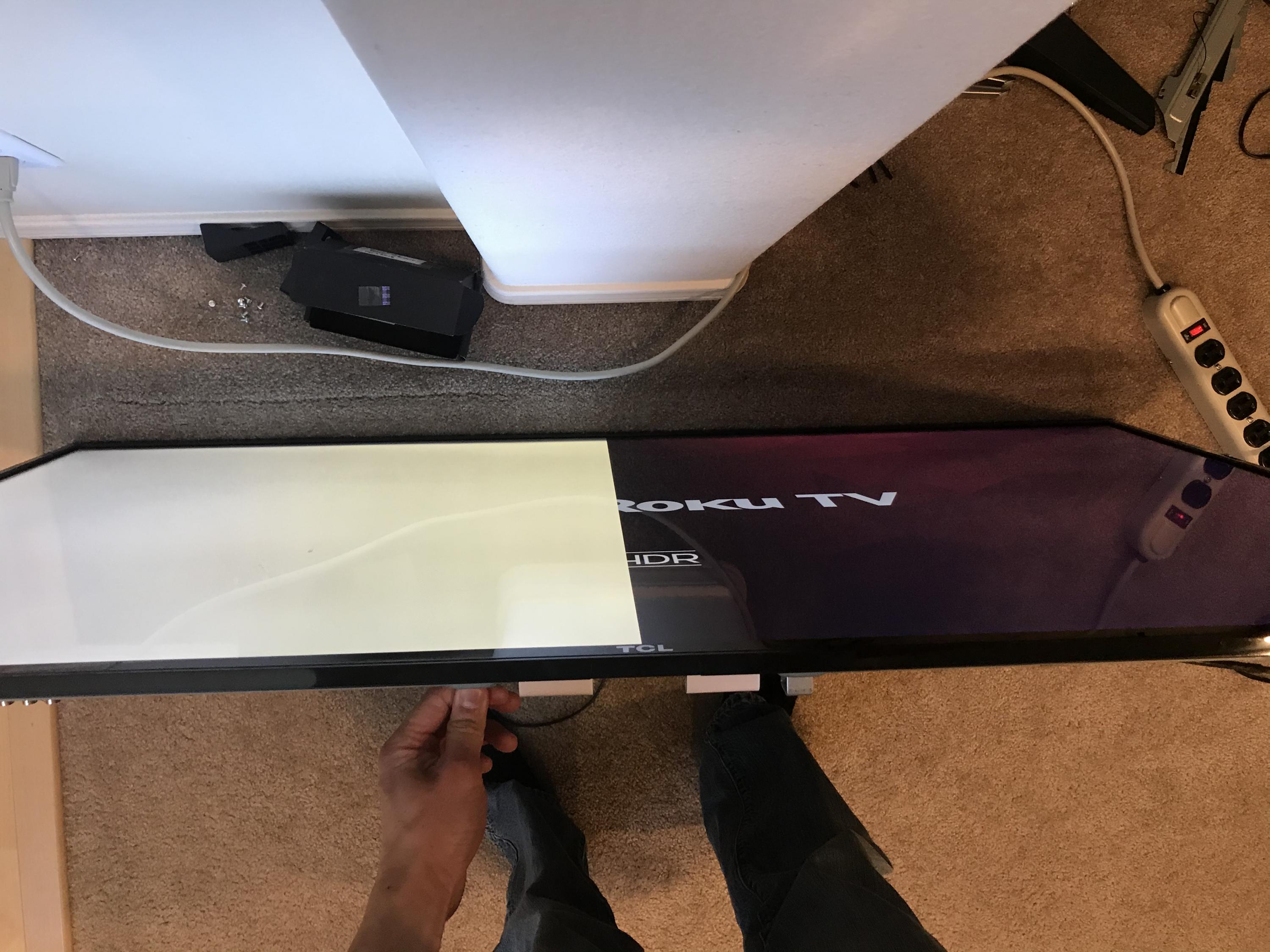

                                    I had a few minutes... i powered on the TV and the screen came right up (see first pic). I powered it down and disconnected the "left" side of the screen. The right side stayed up - left side was perfectly white. (pic 2).
                                    I powered it down again and swapped the cables (left connected, right disconnected) - no dice; i reconnected it again - no dice. No video displays again.
                                    While the full screen was "working" and actually displaying something, i ran my fingers across each tab -- pushed on it a little bit to see if i can get the image to change. Nothing changed. Did this twice.... no difference.
                                    With the unit not displaying video again, i ran my fingers across the tabs once more - no difference. Slowly pushed on each one hoping something would happen. But nope.
                                    I'll try the tape method today - soon, but what's the chance of success on this TV since it has side tab drivers?

                                      #38
                                      Re: TCL 55S405TBBA - backlights on, no video; T-con and main board replaced.
                                      what.... sorry for get this post... I didn't see the pictures and missed the part about seeing a picture... wow.... forget this ->
                                      not sure I understand the "power down" statement... oh, you mean cord disconnected in what ever state the set was in (ie. if operating, then it kind of keeps that state so that if you plug back in all you need is to do a "power button" start as opposed to wait for the thing to initialize... right?
                                      anyway, it does appear that the main board kind of thinks things are hunky dory and appears to power up and down, in terms of state lights, OK.... so perhaps things from the tcon out are a target.
                                      I think is you track down the vgl (which I will take as voltage gate low), that value should be more in line with -12v (guess). It is being loaded down or the driver has an issue.
                                        why the hell did you touch any cables ????? :-))))))
