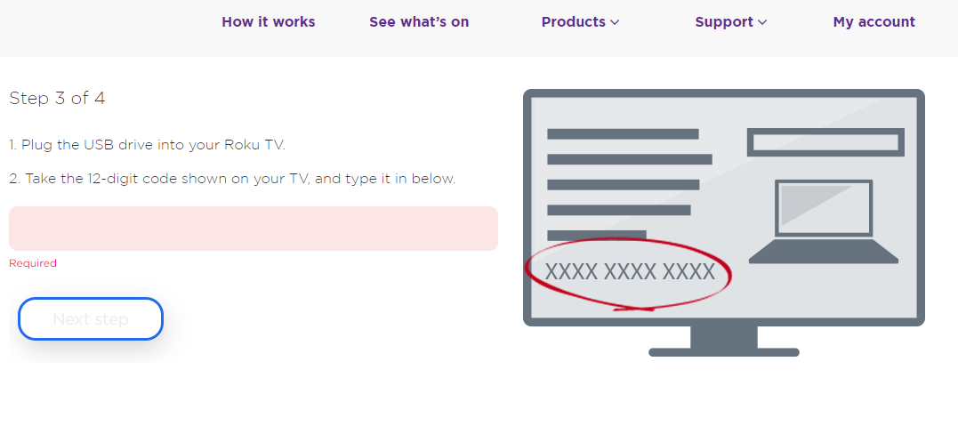

                                    Hey budwich -
                                    Please see the screenshot from the Roku site. Not sure what they want from this. I tried plugging in the USB with the update.roku file the root directory.
                                    When i plug in the USB, there is no behavioral difference for the status LED - nothing happens (the LED remains off).
                                    Regarding touching the caps / using my fingers as extra capacitance - I've tried that and the result didn't do anything different. Thanks for the follow up.
                                    -Thomas

                                      ahhh.... they appear to have a very interesting "protocol" to prevent loading of software either by choice or accidentally. I suspect the code causes a "launch exchange" between the roku (got the spelling right) module and the roku server system which maintains "compatibilities" among other things. So unlike other sets, it does even attempt to access and read the usb at the lowest level to see what's on it. Having said that, you did try the "firmware loading sequence" with your remote... right?

                                        #79
                                        Re: TCL 55S405TBBA - backlights on, no video; T-con and main board replaced.
                                        Hi Budwich -
                                        No, I did not try the firmware load sequence (e.g. manually going through the menus on the TV) since i'm "blind" without the display working. Per the instructions, it won't actually update until you get the 12 digit "check code" and the 6-digit "response" code
                                        Per the manual, the 12 digit code appears to be an "interlock" of sorts. Page 122 of the manual (LINK):
                                        • Step 4: When the download finishes, take the USB flash drive to the TV and plug it into the USB port. When you do, the TV validates the files on the flash drive and displays a 12-digit code.
                                        • Step 5: Write down the code and the web address, and take this information back to your Internet-connected computer.
                                        • Step 6: On the 12-digit code page, enter the code your TV displayed, and then click Next (This is what i call the "check code")
                                        • Step 7: On the 6-digit code page, write down the 6-digit code that appears, and then take it back to your TV. (this is what i call the "response code")
                                        "12- and 6-digit codes The USB update process uses a pair of codes to validate that you are authorized to install an update, and to ensure you are not attempting to install an old, unsupported version of the system software."
                                        • Step 8: Using the TV remote control, select Next to move to the next screen, and then use the on-screen keyboard to enter the 6-digit code. When finished, select OK. The system update begins. Do not remove the USB flash drive until the TV restarts.
                                        Holy moly, thats one way to keep people from messing up the update.. TCL/Roku's version of checks and balances. The firmware update experiment will have to wait until the display decides to work again. No luck at the moment.
